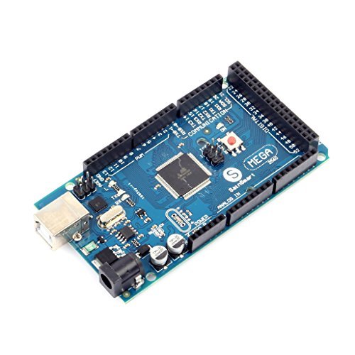

    So, it still hasn't been working. I'm not sure if I put this in the last log, but i'm ordering a new mega clone for a few reasons:
    1 - The problem is consistent with both shields, so that's not it
    2 - Having a few Megas around is never a bad thing. Especially if they're only like $10
    That being said, i posted my error code in the arduino forum, here: https://forum.arduino.cc/index.php?topic=541305.0;topicseen. That guy seemed to think it was a faulty download of the arduino ide, which would make sense because i can't upload to anything. This, however, is a problem. My mac is a 2009, so it's almost gone, and pretty much the only thing i can use. I'll have to get down to the makerspace one of these tuesdays.

    Hey, to all my 5 followers, if you even read these things, sorry i haven't logged anything in a while, i was working on my project for the science olympiad. Anyway, I was looking at Arduino Mega Clones, and Found one for like 15 dollars, so that's what i'm going for next. Also, I was thinking about my power from the wall wart, and if i'm going to make this thing autonomous, then i can't keep using that. I think i'm going to start using batteries.
    SainSmart MEGA 2560 Board for Arduino UNO Mega Nano DUE Robot R3 Duemilanove
