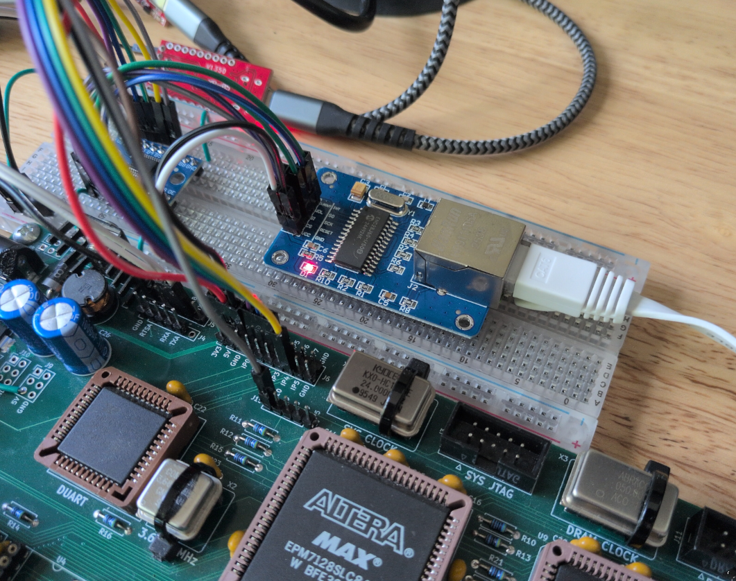

    SPI + ENC28J60 Networking
    DUART GPIO <-> level shifter <-> ENC28J60 ethernet
    And now for the fun one... There are so many peripherals that communicate over SPI. Having that interface available on the board opens up a world of options for connectivity, storage, sensors, etc.
    The only problem is that nothing on Mackerel-30 actually speaks SPI right now. Fortunately, Linux has a really solid bitbang SPI controller that can be easily implemented on top of just about any GPIO. I wired up the SPI code to the DUART I/O registers and, as with the IDE driver, every layer above it just falls into place.
    The cheap ENC28J60-based ethernet breakout board I have requires only a SPI connection plus a single interrupt line. There's a driver already available in the Linux kernel and it's one config option away.
    ~ # uname -a
    Linux mackerel 6.17.1-multi-00028-g5b42c9f55f18-dirty #1 Mon May 25 11:28:54 EDT 2026 m68k GNU/Linux
    ~ # ping -c 4 google.com
    PING google.com (142.250.65.78): 56 data...
