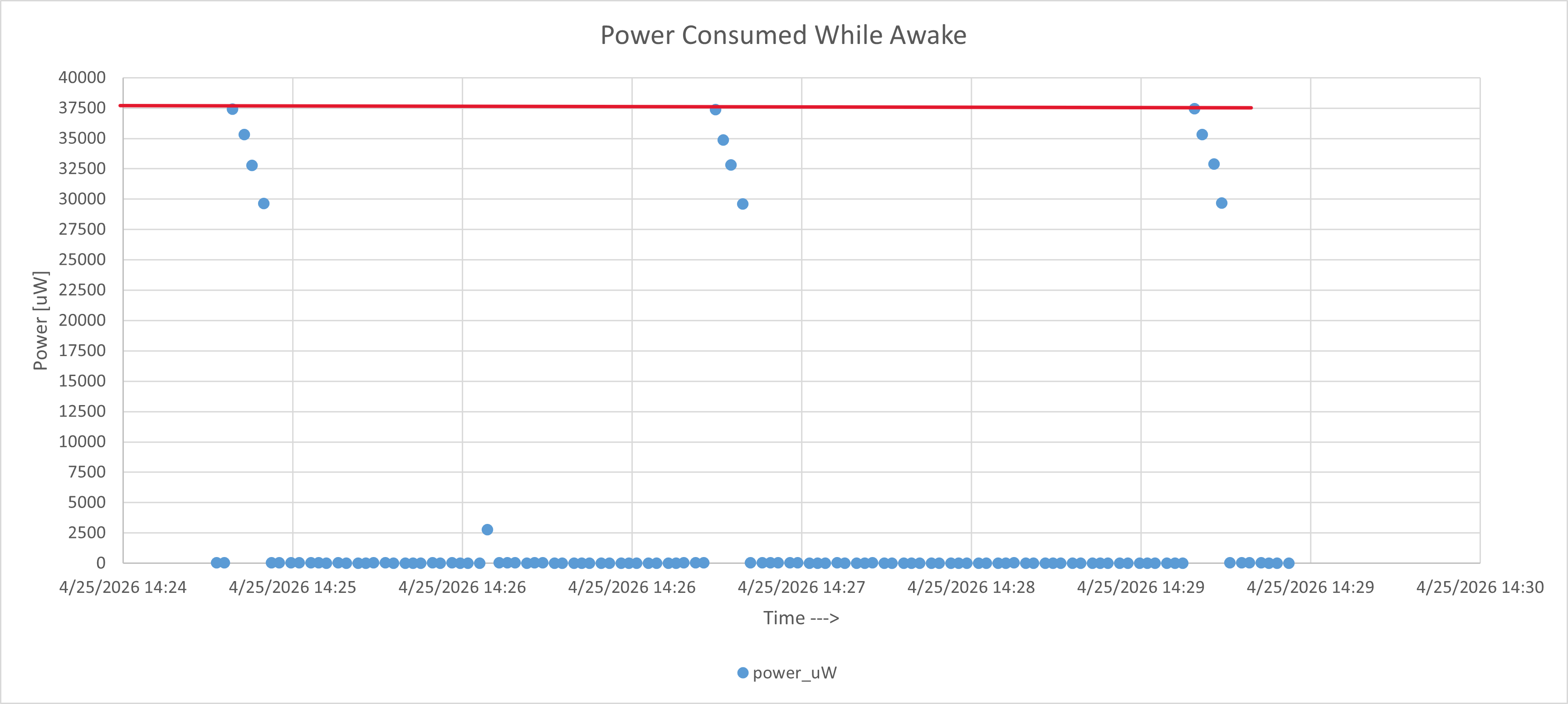

Power During Sleep: 24uW
  • Measured without solar. Powered from 3.8Vbat across 2 ohm shunt
Power During Active: 38mW
  • Same setup as above. This was the peak observed 1 second average.

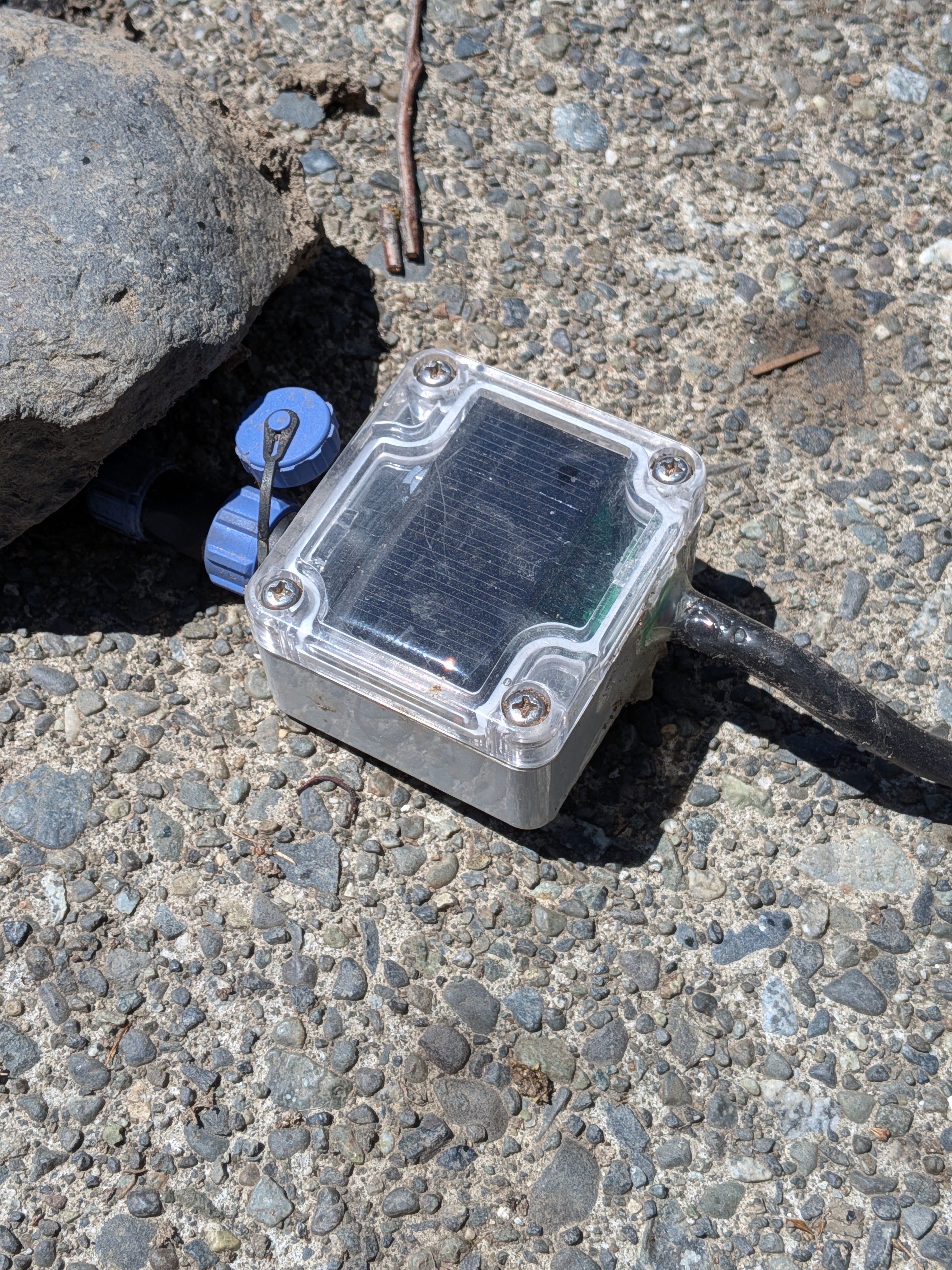

  • Field Testing
    Jesse Farrell • 06/29/2026 at 19:35 • 0 comments
    It's been a month or so since deploying the first unit in the field. So far it's been relatively uneventful, save one issue that cropped up in the first week (described below).
    I'm pleased to report that the well hasn't flooded, or run dry, once. The new valve (compared to the MVP) barely limits the flow, so it generally can keep up to the depletion rate of the water going to the various fields.
    The one issue I did have was with the cheap SP11 connectors I used. These connectors immediately leaked and caused the float switch sense circuit to detect an invalid state (both logic high). I've added it as an errata item for the REV01 PCBA, I have some tricks to avoid this issue in the future, but really, I just shouldn't use such a cheap connector.
    At the end of the growing season, I'll be bringing this unit back to the lab to see how bad the carnage is. For future growing seasons I'll likely conformally coat the PCBA.

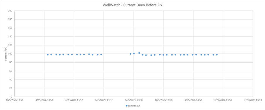

  • So how low-power is it?
    Jesse Farrell • 04/26/2026 at 02:19 • 0 comments

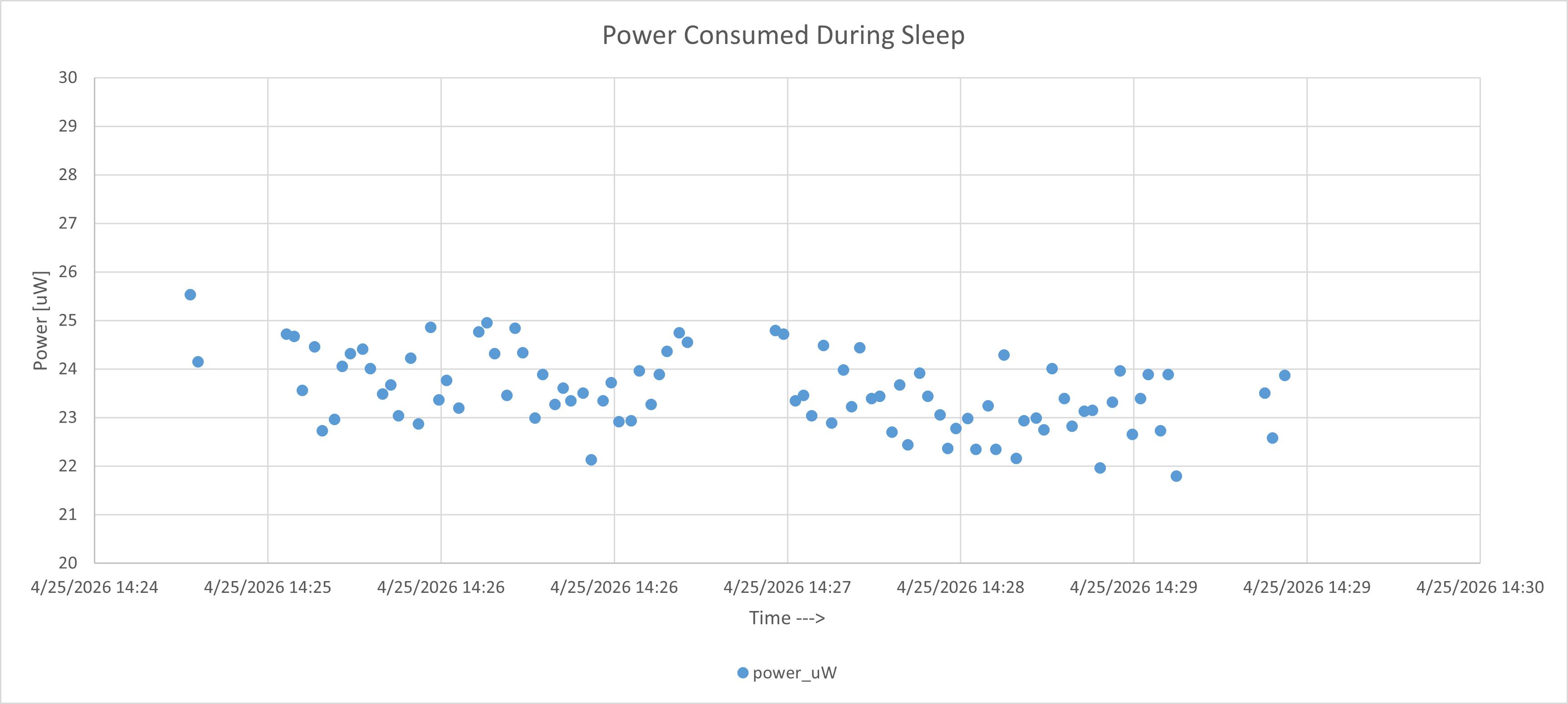

    TLDR -> 24uW @6uA during sleep

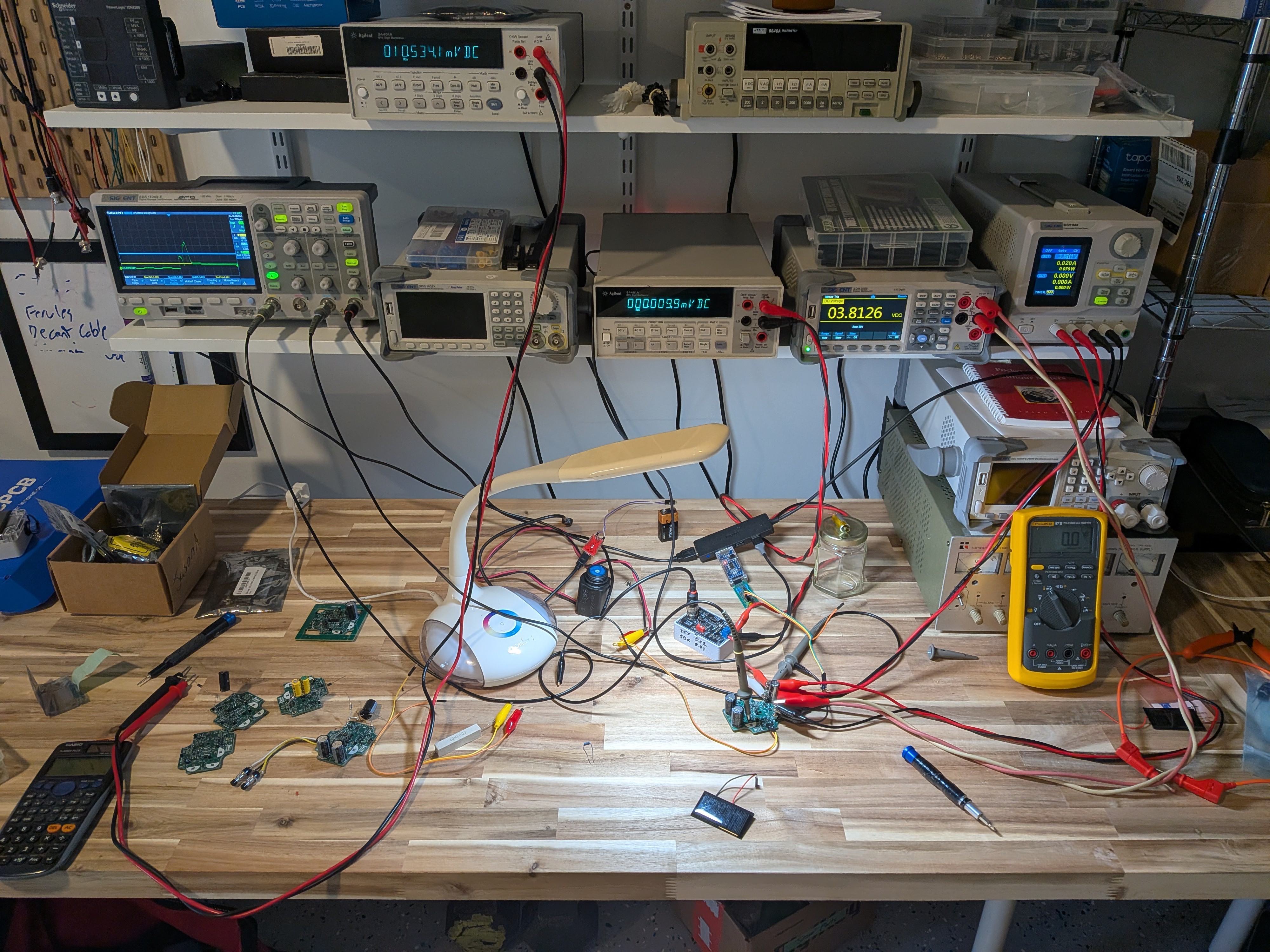

    I only received my REV01 PCBA on Thursday, and I was busy Friday night debugging and cleaning up documentation for the Green Powered Challenge.
    Now that the bugs are squashed, and documentation posted (in its admittedly unfinished state) let’s have a look at power consumption. After some flailing, I came to a setup for measuring uA’s reliably that played well with the WellWatch.
    Power is provided by a supply w/ sense wires connected to a 2 ohm current measurement shunt. The sense wires are key to stop the device from resetting itself due to voltage dips during solenoid switching (this is just an issue for my hacky setup where I don’t have a nearby battery to sponge the bursts of current). One DMM measures the potential across that shunt, and another DMM measures the potential across the 1000uF capacitor (the battery stand-in).

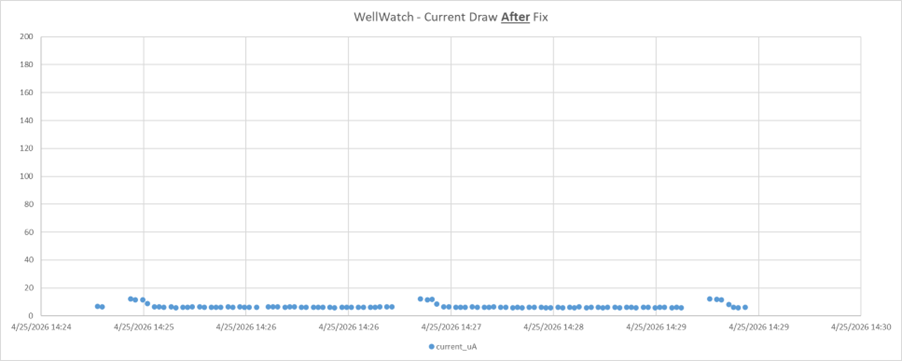

    When I first tested the system, it’s sleep current was 98uA (375uW). Not terrible, but not nearly as good as I expected or wanted. Luckily the culprit was fairly easy. The floating UART pin PB3 was hogging power. Driving it low (when not in debug mode) resolved my issue. I tried tuning a couple other parameters, but only really saw substantial benefits from this change.
    Fixing the UART issue reduced the current all the way down to 6uA (24uw). The gaps in the chart is where the device wakes up, and exceeds the bounds of this chart.

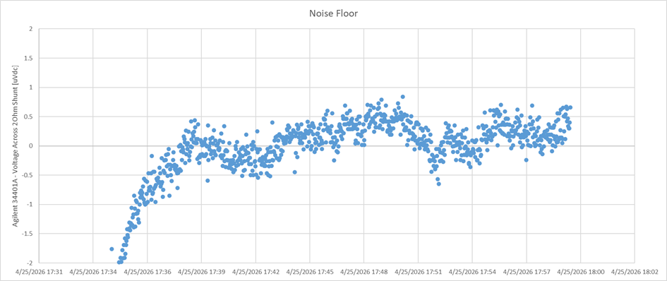

    At this point I was concerned about the noise floor of my setup. In the below screenshot I tested the same setup with the PSU unpowered. This makes me more confident about the 34401A’s mV measurement. We should be able to reliably read above 1uA, though there might be +/- 1uA of slop on that value.

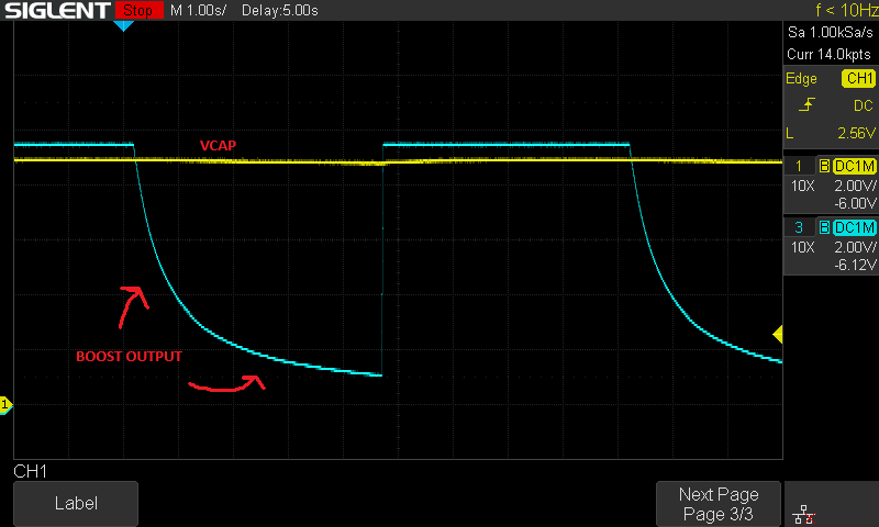

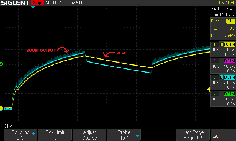

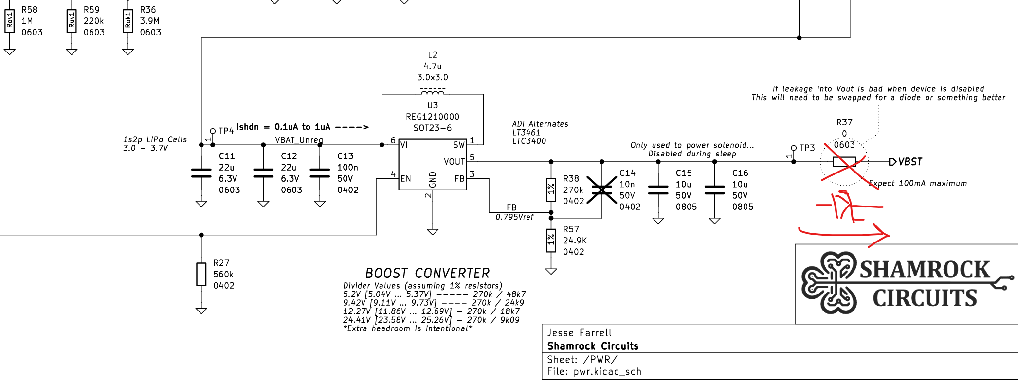

    Boost Converter Leakage
    While testing the drain on my pulse energy storage circuit I noticed self discharge was much greater than expected. Current was either leaking back into the boost converter output or across the H-bridge.
    Luckily past me saved present me's bacon. Somewhat anticipating this issue, I added a 0ohm resistor at the boost converter output. Replacing the 0ohm 0603 with a Schottky resolved the issue.
    Now when the boost converter is disabled the voltage across the capacitor holds steady.

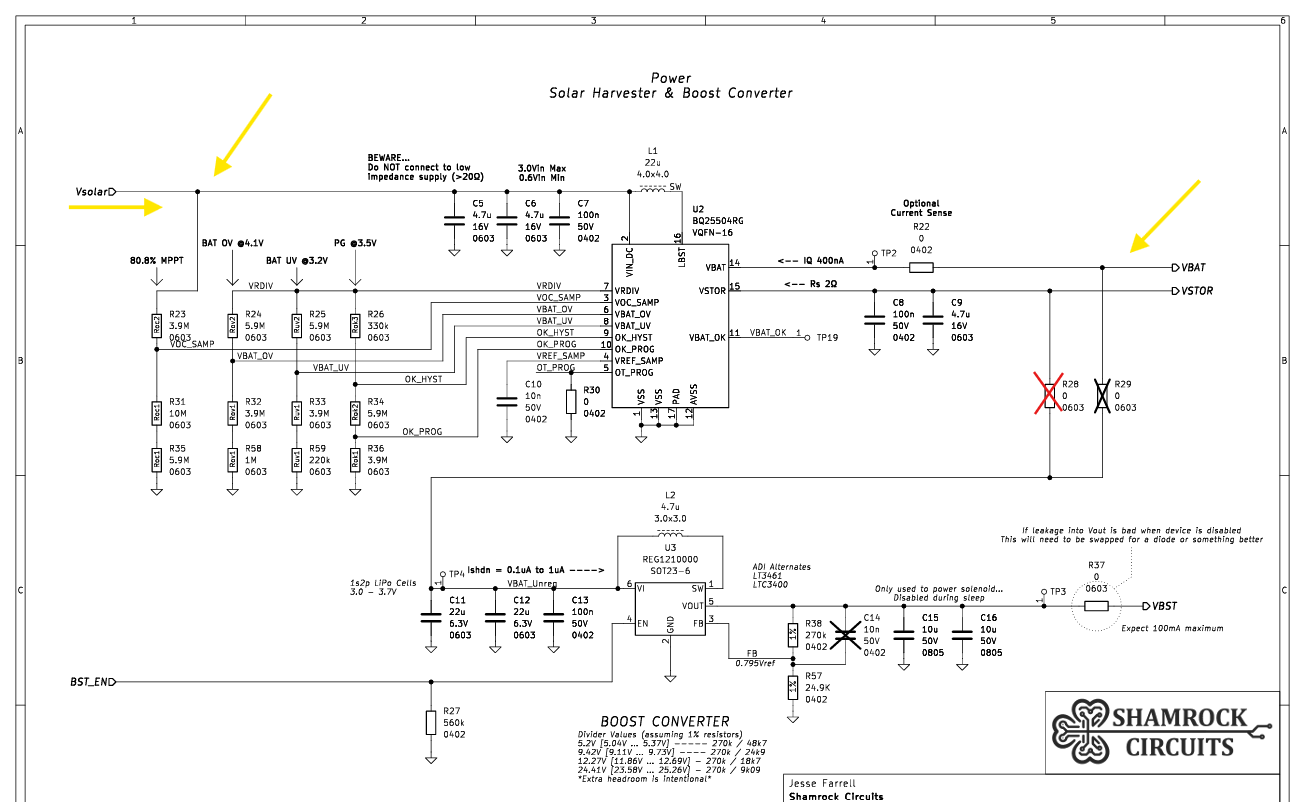

    VSTOR Loading & Startup Issues
    The system refused to boot from VBAT. Whether I simulated an "already charged" battery, or if I allowed the system to charge the battery itself, VSTOR refused to come up. Instead getting stuck around 1.6V.
    I initially suspected my voltage divider values on the TI BQ25504, but they seemed to match the schematic. After some datasheet sniffing, I found a critical note.
    If a system load tied to VSTOR discharges VSTOR below VSTOR_GEN or below VBAT_UV during the 32 ms initial MPPT reference voltage measurement or within 110 ms after hot plug, it is recommended to add an external PFET between the system load and VSTOR
    It seems like the BQ25504 is extremely sensitive to VSTOR loading during startup. I found that if I hold the solar panel directly against a bright light source, it drives VSTOR hard enough to overcome the meek ATTINY load. Once the system is past that 110ms window and fully booted, it functions normally without the extra light.
    The datasheet recommends adding an external PFET between the system load and VSTOR to keep the rail isolated until VSTOR is stable. I'll be implementing that to ensure the system can boot on REV01.

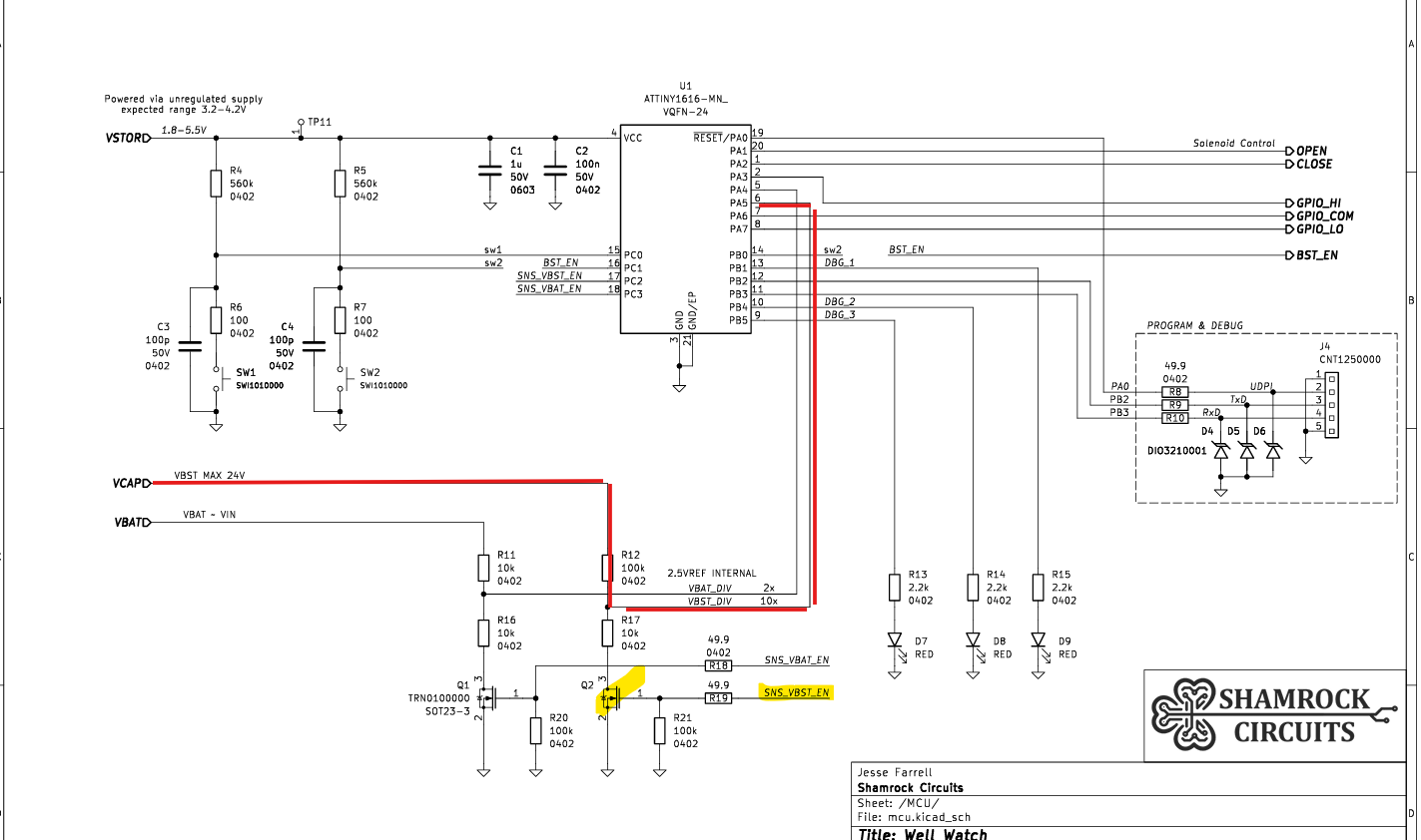

    ADC Overvoltage
    This was a "head-in-hands" moment during sparkup. I designed a voltage divider to measure the 24V VCAP signal, but I used a low-side switch (SNS_VBST_EN) to enable the measurement.
    When the low-side switch is OFF, the bottom of the divider floats, and the ATtiny1616 sees the full 24V signal (heavily current-limited, but still). I essentially slapped a high-voltage rail directly into a 3V GPIO. Probing VBST_DIV showed it pulled to VCC (3V), meaning the internal ESD diodes on PA5 were working overtime sinking about 60uA. Not ideal for long-term reliability or power consumption.
    For the next spin, I’ve added a high-side switch with an NMOS driver. Because of the double inversion in the hardware, the firmware logic remains identical. Easy peezy.

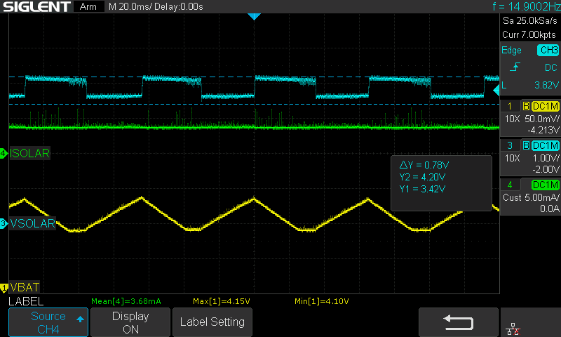

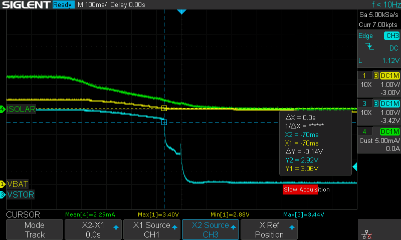

    Overvoltage Limit & Hysteresis
    For this capture, I probed Vsolar, Vbat, and the current into Vsolar. (Schematic above)
    We can see VBAT reaches its overvoltage limit at 4.15V. This is well within the expected range of 4.13V  [4.18V ... 4.09V]. The 50mV hysteresis also falls squarely within the datasheet spec (35mV typical).
    I was hoping to catch a glimpse of the MPPT (Maximum Power Point Tracking) at work here, but no dice. I suspect with a better light source I’d be able to witness the MPPT in action.
    Undervoltage Limit
    Using the same setup, I moved the VSOLAR probe to VSTOR to observe the disconnect behavior.
    VSTOR is successfully disconnected from VBAT when the voltage falls below roughly 3.06V. Impressively close to the expected 3.04V.

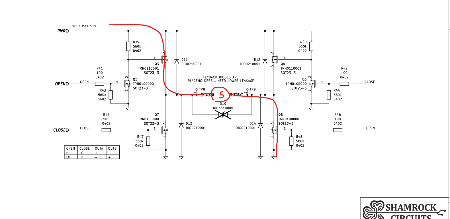

  • Testing REV00 – Solenoid Switching & H-bridge
    Jesse Farrell • 04/13/2026 at 00:55 • 0 comments
    I was bad and didn’t push my test results. Yikes…. Doing this retroactively now.
    With the REV00 boards in hand, it was time to move on to hardware validation. I had a slew of tests I wanted to run, but at the top of that list was testing the new pulse generation circuit. This includes the bulk cap energy storage, H-bridge, and output current limiter.
    The primary goal for this testing was to verify the circuit design and add any findings to the errata. So long as the solenoid toggles properly, I’d consider it a PASS.

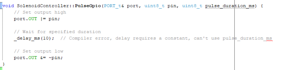

    Pulse Generation & Initial Logic
    First, I needed to write some firmware for toggling the H-bridge. At this point, I had already developed some code for an ATtiny dev board, so this was a pretty quick task. For early testing, I’m just using a dumb delay; in the future, this will be replaced with a proper sleep method.
    Initial No-Load Observations
    During this test, I had the bulk caps powered continuously from the boost converter. Findings below.
    • Slow Turn-off: There was a noticeable lag in the turn-off time. This was expected given the high-value pull-up resistors on the Q4/Q3 gates. I suspect adding a real load will "clean" this up by providing a discharge path.
    • Sloppy Timing: I set a 10ms pulse in code, but the scope showed a much shorter duration. It seems _delay_ms() is significantly off on this implementation. Since I'm moving away from this for later revisions, I'm not going to lose sleep (😉) over it yet.

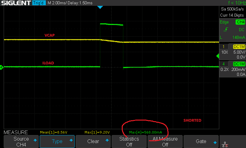

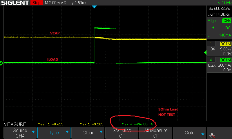

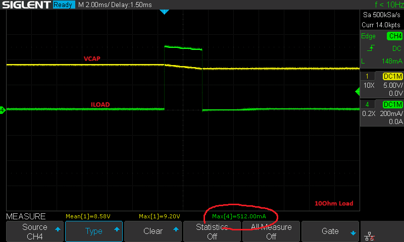

    Current Limiter Stress Test
    Before connecting the solenoid, I wanted to see if my current limiting circuit could actually limit properly. I used a current sense amplifier and a variable load across OUTA/OUTB. During this test, the boost converter was continuously enabled.
    Load Resistor [Ω] Peak Current [mA]
    10Ω 512mA
    5Ω 552mA
    SHORT 568mA
    Temperature Influence
    Since this current limiter relies on the Vbe of Q12, I was curious how bad its thermal influence would be. For a quick sanity check, I held a soldering iron set to 750°F (400°C) about 1cm away from Q12, then nearly touching the transistor's SOT-23 package.
    • At 1cm: No measurable difference.
    • Nearly Touching: The limit dropped by about 50mA.
    The expected temperature coefficient for Vbe is around -2mV/°C. In this system, that translates to:
    -2mV / 1.35Ω ≈ -1.48mA/°C
    Based on the 50mA drop, I only actually increased the die temperature by ~33°C. I suspect the PCB was pulling heat away from the chip better than I originally anticipated (still 33'C seems low). I’ll likely need to revisit this and saturate the whole system at Tamb in the future.

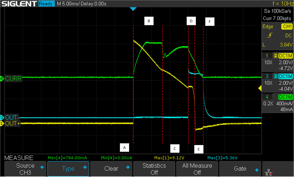

    Driving the Rain Bird Solenoid
    Now for the real test: the Rain Bird TBOSPSOL 9V latching solenoid.
    Initially, neither the positive nor negative pulses would engage the solenoid. The current limiter (set to 500mA) was working exactly as designed (which was the problem). After checking the coil resistance, I realized it's only 4.7 ohms. At 9V, that’s a theoretical draw of 1.91A! My 500mA ceiling was starving the actuator before it could flip.
    To get around this, I shorted R50 with tweezers to bypass the limiter. Afterwards, both positive and negative pulses worked perfectly. I’ll be removing this output current limiter in REV01.

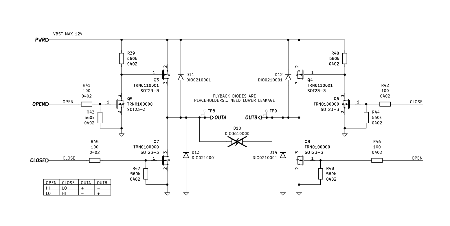

    Waveform Breakdown (The "Positive Pulse") Current Limiter Removed
    Analyzing the switching cycle reveals some interesting physics in the H-bridge:
    • Step A: Idle/Normal operation.
    • Step B: Voltage applied. Current ramps up following the inductor current formula. Note: my current sense amplifier is clipping the waveform here.
    • Step C: The "Trip": The current hits the threshold where the solenoid physically moves, momentarily changing the effective impedance of the coil.
    • Step D: Both OUTA/B go high, suggesting the H-bridge has been disabled. Note that when OPEN goes low, it switches Q8 faster than Q3 because Q3 relies on the pull-up R39. The bridge...

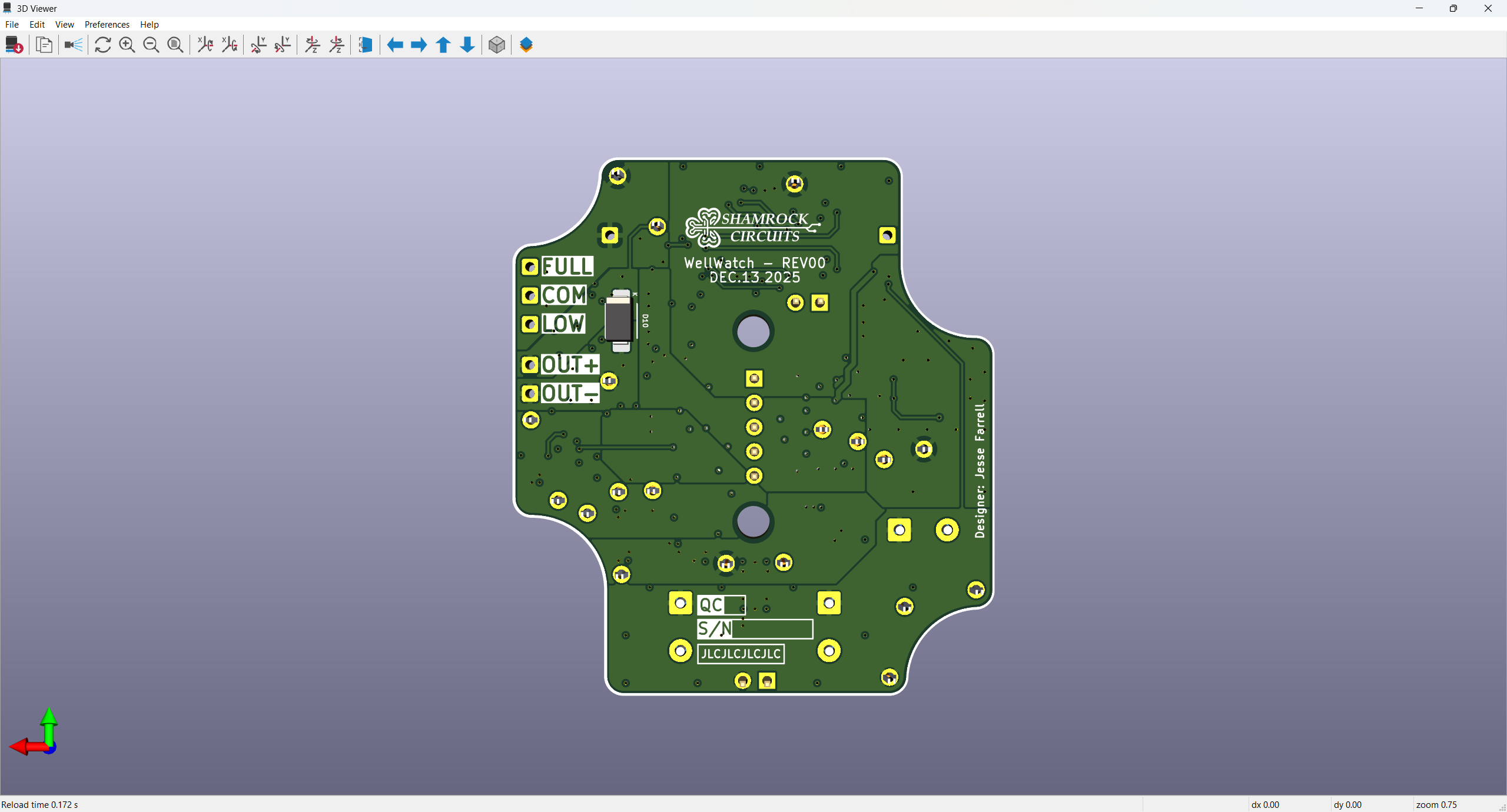

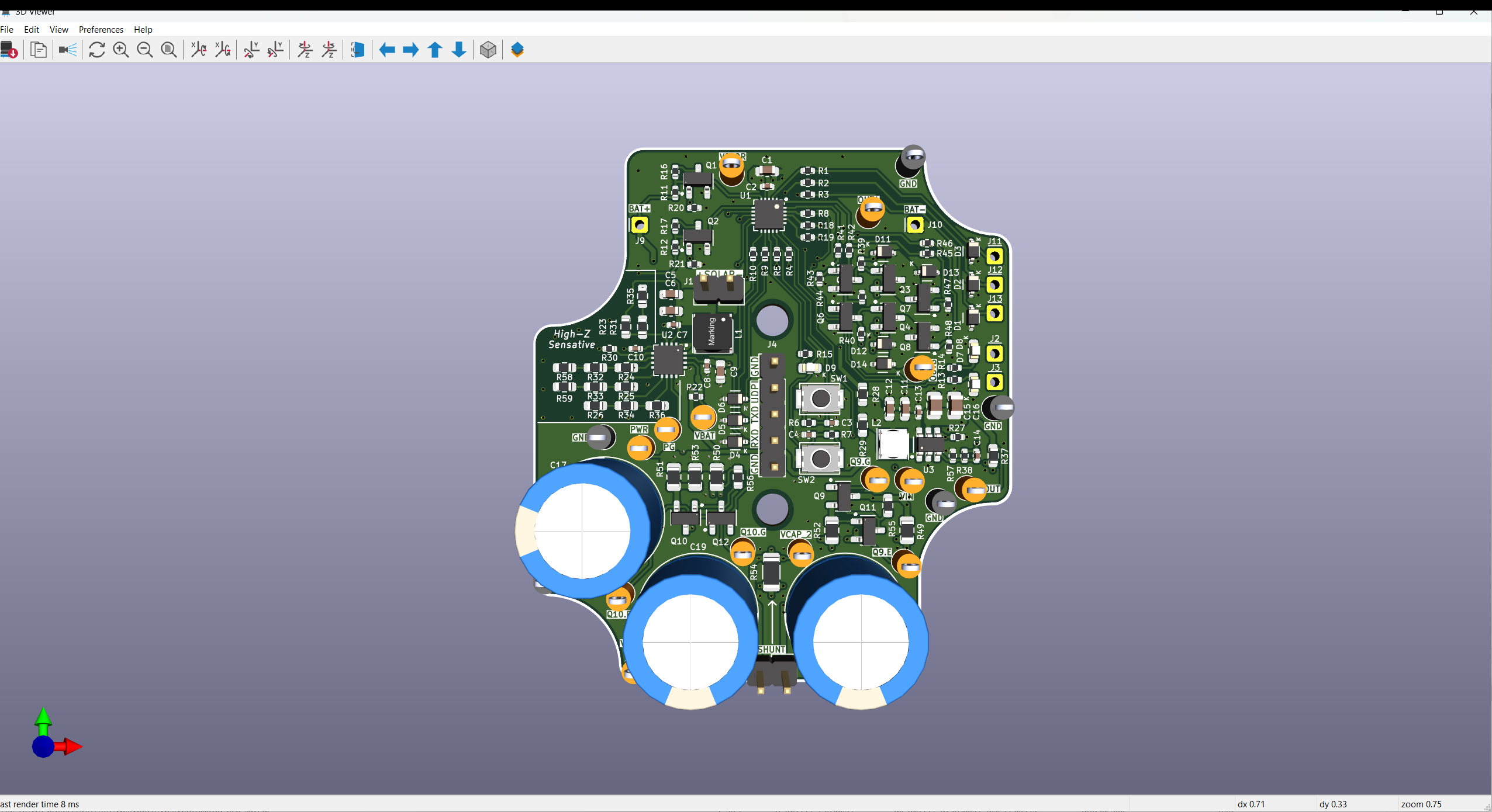

  • Design Update - PCB & SCH Work
    Jesse Farrell • 12/08/2025 at 00:57 • 0 comments
    With Christmas PTO fast approaching I thought I’d focus on finishing up some projects. My goal is to order PCBA to tinker with over the holidays.
    A quick overview of the “WellWatch” project. This widget essentially just monitors a float switch/gauge and toggles a solenoid accordingly (see the project homepage for why I’m doing this). Some challenges that make this project a bit more interesting is (1) the system will be operating from a Solar cell, and (2) it will support a variety of switching voltages.
    The core blocks of the system are shown below and include Power (PWR), Microcontroller (MCU), Pulse storage, and H-bridge.
    PWR – Harvests energy from solar cell and stores that energy in a single 400mAh LIPO cell. Battery voltage is exposed on VBAT, and a regulated version of VBAT is exposed on VOUT. When BST_EN is asserted, BST_OUT generates between 5 – 24V depending on the hardware configuration.
    MCU - The microcontroller block contains an ATTINY1616 which; controls the H-bridge circuit via SOpen and SClose (solenoid open/close), senses the state of the float switch via GPIO_HI, GPIO _COM, and GPIO _LO, and measures VBAT as well as the pulse energy storage capacitors.
    H-Bridge – This circuit is fairly generic. The only slight deviation from a jellybean H-bridge is the addition of Q6 and Q5 which allows me to control all 4 driver FETs with two signals, OPEN and CLOSE. I still need to fine tune my component selection to reduce the leakage presented to the PWR input.
    Pulse Storage – This is another energy storage circuit (not the LIPO battery!!) which provides the 50ms (typ) pulse of current required to toggle a latching solenoid. The schematic shows two active current limiting circuits. Capacitor charge current is limited by Q11/Q9, and capacitor discharge current is defined by Q10/Q12. Charge current will be configured to align with the capabilities of the boost converter, and the discharge current will need to be configured for the selected solenoid.
    Anyways… that’s the circuit and here’s the PCB I developed this weekend. I’m just working on some final cleanup. I also need to add a few extra 0ohm resistors to isolate each circuit block. Jumpers are great for debugging and general V&V work for an early design.
    One last thing… If you’re wondering why I set the board outline above, plan to assemble the project in this enclosure from polycase (https://www.polycase.com/wc-20). The LIPO battery is harvested from an old “disposable” vape. My current plan is to rest it ontop of the northern end of the PCB (TPs will need to be removed later). I still am somewhat debating using a LIC instead of a LIPO, but for now I’m prototyping with a LIPO.
