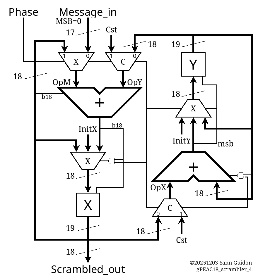

20251113: Architecture update
20250525: spinning #miniPHY off.
miniMAC is an extension and application of #PEAC Pisano with End-Around Carry algorithm because the PEAC algorithm replaces the checksum, the scrambler and the 4b/5b table usually employed by 100Base-TX, see

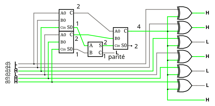

50. The new parity circuit
51. Permutations
52. Permutations 2
53. The last parity

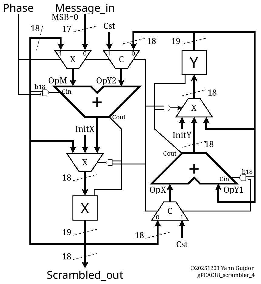

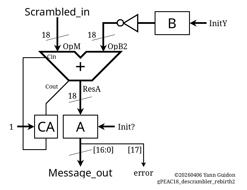

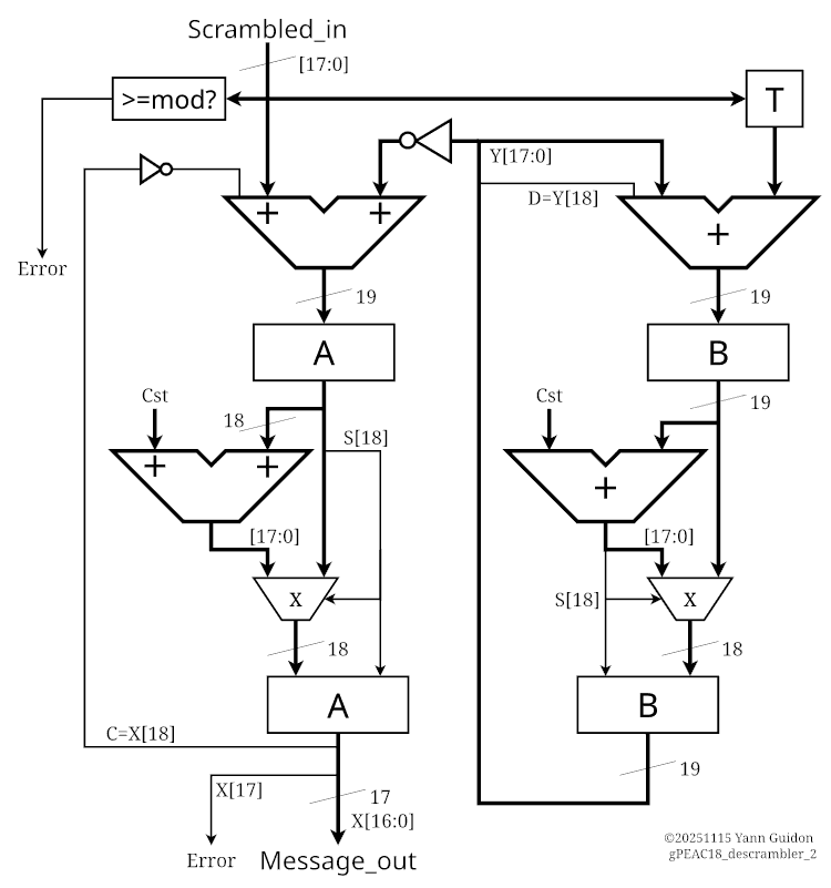

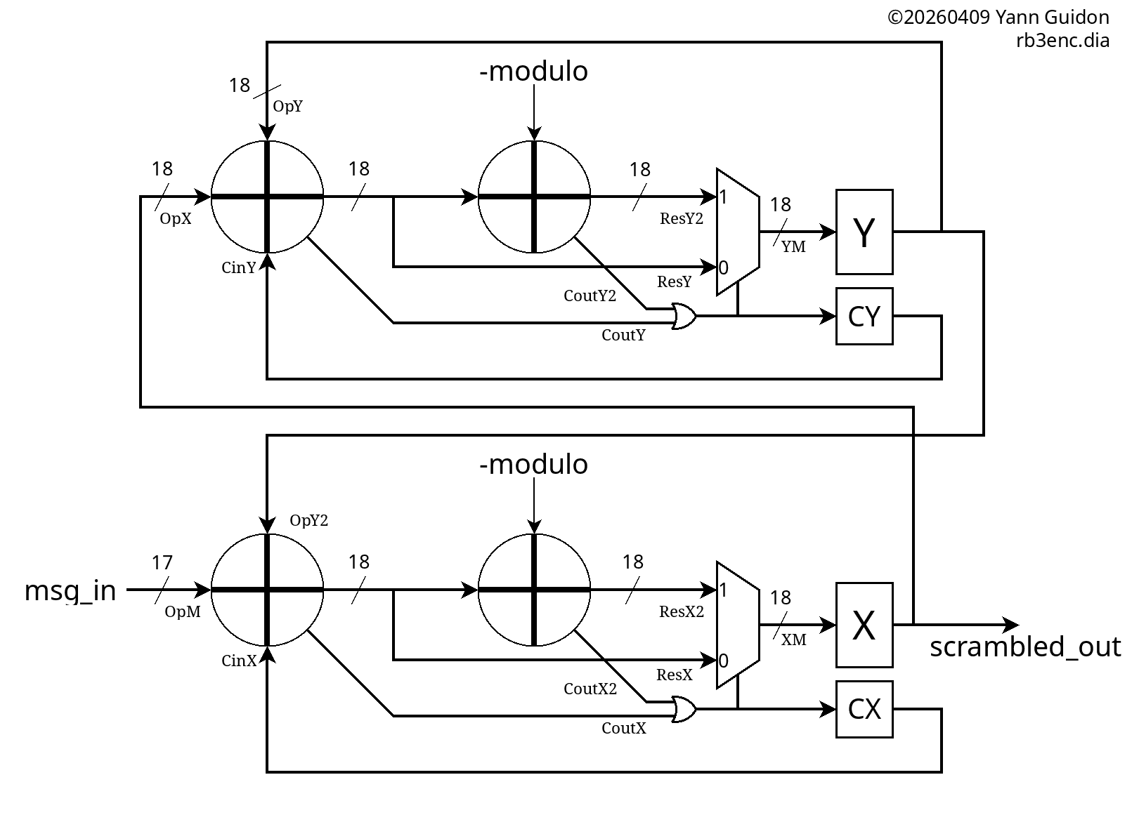

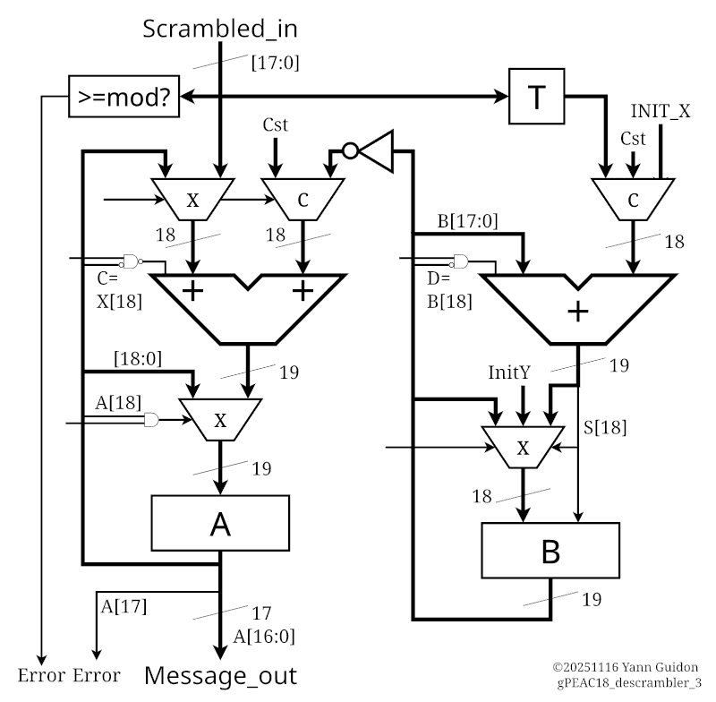

  • No more gPEAC ?
    Yann Guidon / YGDES01/04/2026 at 11:48 0 comments

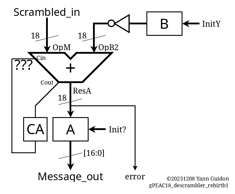

    The log 181. PEAC w18 is a mixed bag, there are good things but overall, the less good aspects stick.
    Given the great performance bump introduced by the Hammer circuit, I wonder why I still keep the gPEAC layer. There are two reasons: it's the best scrambler, and though the very long periods are great, more importantly it can't be "crashed" (which is a flaw of LFSRs).
    At a higher level, the system is stronger because it associates two circuits of different nature.
    But what if?
    Removing gPEAC removes the scrambler. Is it required ? Even though the miniPHY handles baseline wander (somehow, at least that's the expectation), and even if it uses a sort of convolutional error correction system, the spectrum still needs to be spread. Scrambling also helps a bit to increase error detection.
    LFSRs don't work well, they suffer from easy cancellation. Using the Hammer on the send side would be much better (and it's very tempting) but cancellation remains, even though a wider Hammer could provide hidden states. But it wouldn't work. It probably wouldn't improve error detection, which is already maximised.

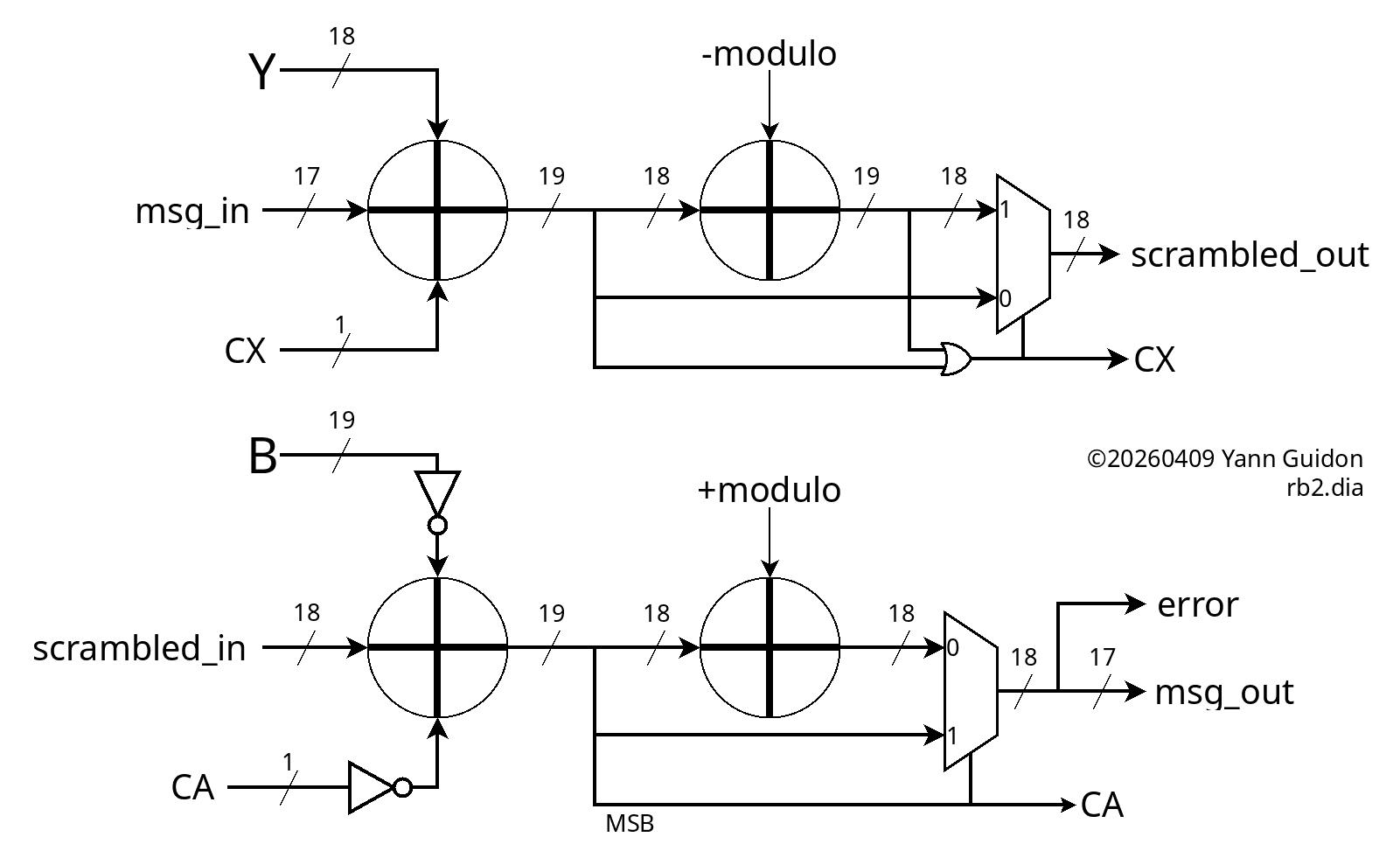

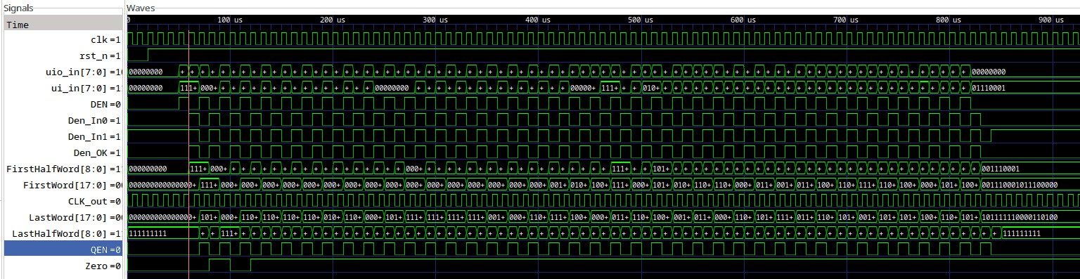

  • Success
    Yann Guidon / YGDES12/29/2025 at 17:03 0 comments

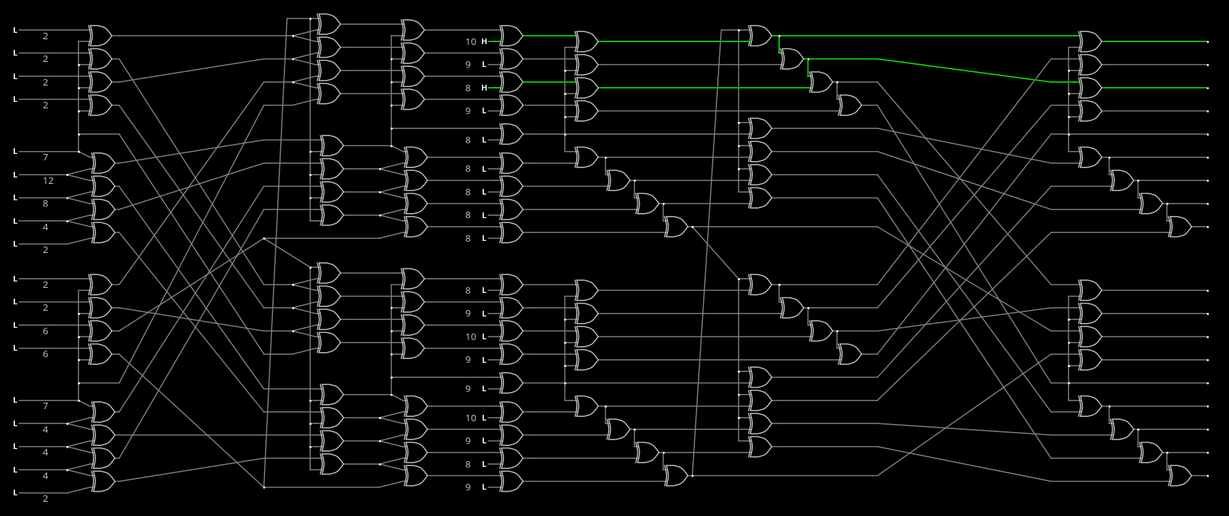

    The Hammer18 circuit fits well inside the NRZI unit and instantly delivers fantastic results. Just as expected. That will be my Christmas then!
    Here are the results after 10 millions of injected errors:
     1 : 2241925 - ****************************************************
     2 : 5543183 - ********************************************************************************************************************************
     3 : 1691752 - ****************************************
     4 :  369784 - *********
     5 :  112181 - ***
     6 :   32917 - *
     7 :    6360 - *
     8 :    1401 - *
     9 :     377 - *
    10 :      84 - *
    11 :      21 - *
    12 :      12 - *
    13 :       2 - *
    14 :       0 -
    15 :       0 -
    16 :       0 -
    17 :       1 - *
    The little 1 at the end is an initialisation bug in the program.
    Otherwise, the 4x slope is very apparent: the system has achieved true 2-bit-per-word performance!
    There is a little "bump" at the start, 1/4 of the errors are caught immediately, but the next cycle catches 1/2! Then every number is divided by 4 as expected.

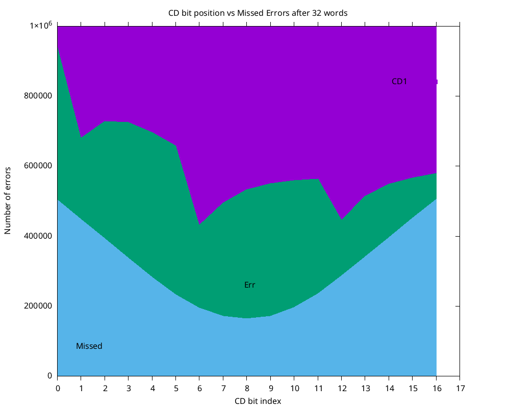

    • CD0:115 : 115 errors were not caught and passed as the first 0-filled word of a control sequence.
    • CD1:6443188 : 2/3 of the detected errors triggered the C/D bit and the rest of the word was not 0. That's 56027× the number of data that passed with a 0.
    • Err:3556696 : the rest (1/3) was caught as number errors: either the number was out of range or the MSB was 1.
    I'm still unable to explain why the CD bit catches 2× more errors than the other methods, though I'm not sure it matters. However, we have a way to extrapolate the error handling capability.
    10 millions (almost 24 bits) give 2 errors at 13 words, 3 more words (4^3=2^6=64) will give about one error in 640 millions (close to 1 billion).

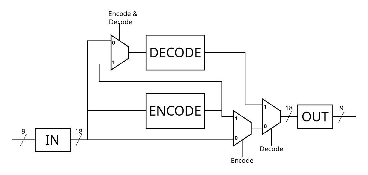

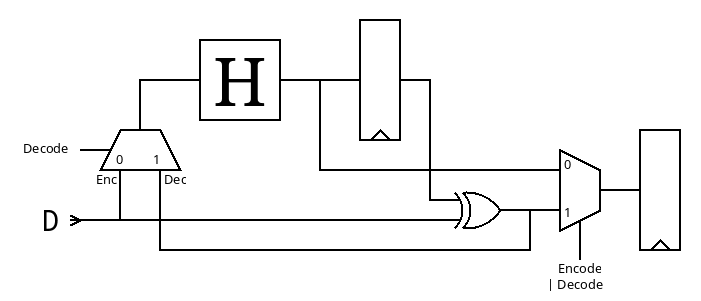

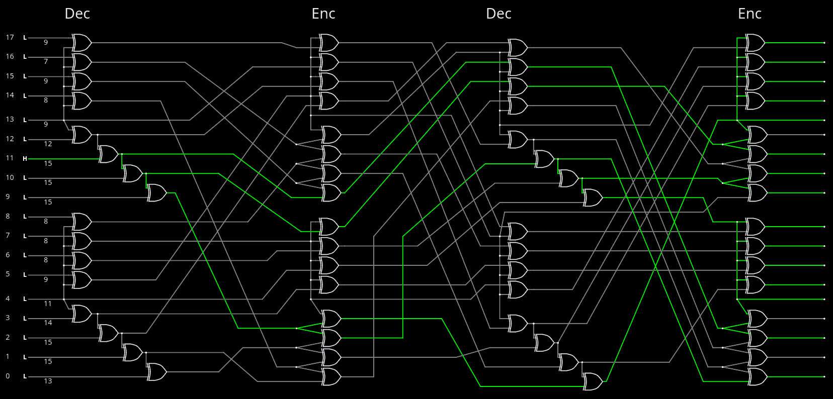

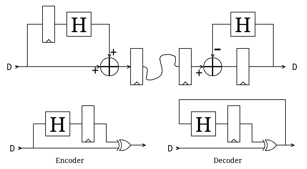

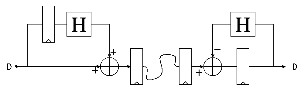

  • Looping the Hammer
    Yann Guidon / YGDES12/29/2025 at 00:29 0 comments

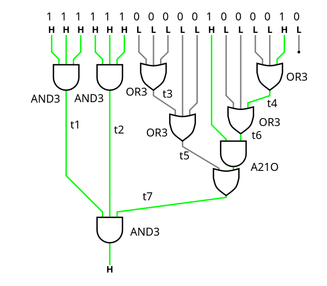

    I tried to feed the circuit from itself and see if loops appear, and how long they would be. I start with one bit set:
    • Start= 0 or 11  => cycle in 1777 cycles
    • 1 : 3556 cycles
    • 2 leads to 5 or 16 : 5334
    • 3 : not part of an orbit, leads to a 10668-loop
    • 4 : leads to 1
    • 6 or 8 : 10667
    • 7 : 2666
    • 9 : not part of a cycle, leads to a 889-loop
    • 10 leads to 6/8
    • 12 : not part of a cycle, leads to 10668-loop
    • 13 : leads to 5 or 16 : 5334
    • 14 : leads to 5 or 16 : 5334
    • 15 : loop in 2667
    • 17 : not part of a cycle, leads to a 762-loop
    Actually the lengths of the loops do not matter a lot (unless they are ridiculously short) since this would assume a stream of data=0 which can't happen due to gPEAC.
    The fact that the values change so drastically is a big improvement over the previous simple NRZ scheme, since this totally locks the error, while the NRZ could have its effect cancelled as soon as the next cycle if two bits are flipped at the same location on consecutive cycles.
    Since the expected buffer size (16 or 32 words max) is way shorter than the observed loop length, there is no need to optimise further, as it could only impede (a bit) directed attacks, not improve error detection in common cases.
    And I expect a big jump of error detection eficiency: this additional convolutional layer adds one word of latency but is the key to achieve true 2 bits-per word error detection: 15 words will lead to 1 chance in a billion of leaking an error, and 32 words (64 bits) will make it virtually impossible to pass in real life scenarios.
    This also means that a 32-word buffer is all that's needed. In high/medium error rates, there is no need to transmit "empty commands" anymore, saving 2 or 4 intermediate checksums, or about 1/16th of bandwidth! So this new unit is very important for efficiency overall, though it couldn't be enough all by itself, its proterties are complementary to those of the gPEAC layer. It's the pair that works together to reach the theoretical limit.
    That new unit also over-scrambles the transmitted data stream. This is not the intended function but it does it (somehow) anyway. So the data's properties must be re-evaluated and at least discarded. This implies that the #miniPHY should expect absolutely random data, no special case... This removes one of the (initially supposed) advantages of gPEAC but it's for the overall best.

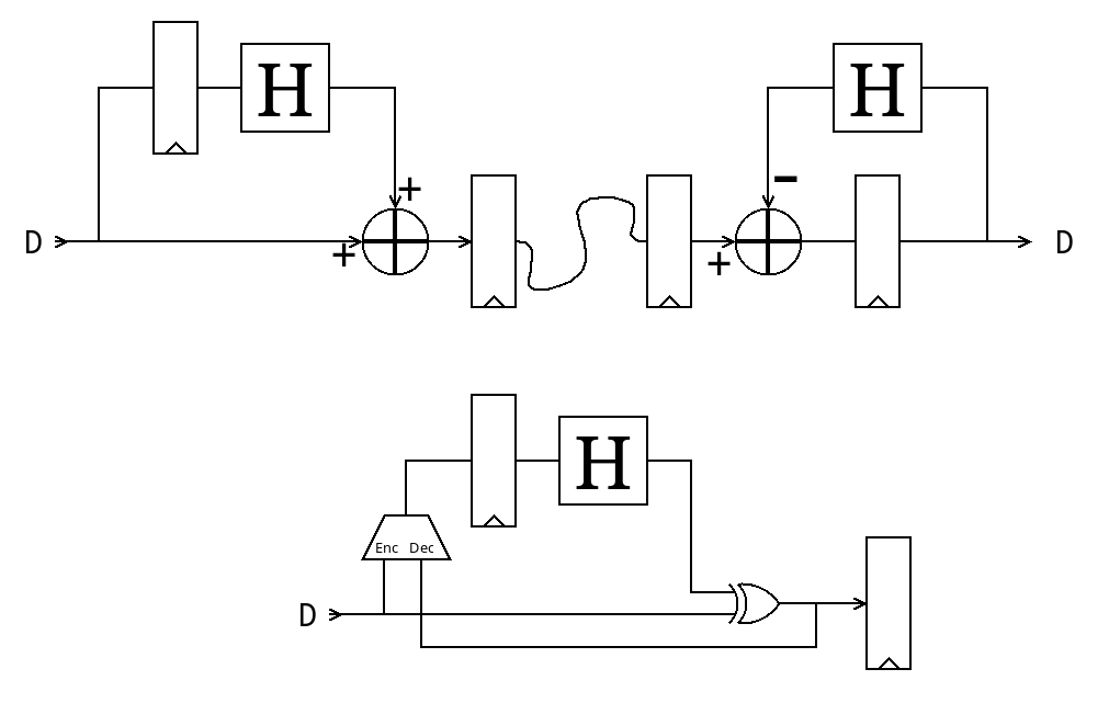

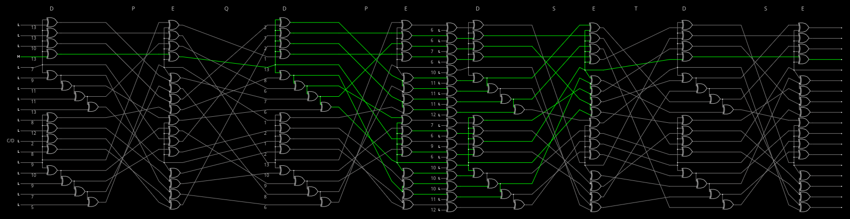

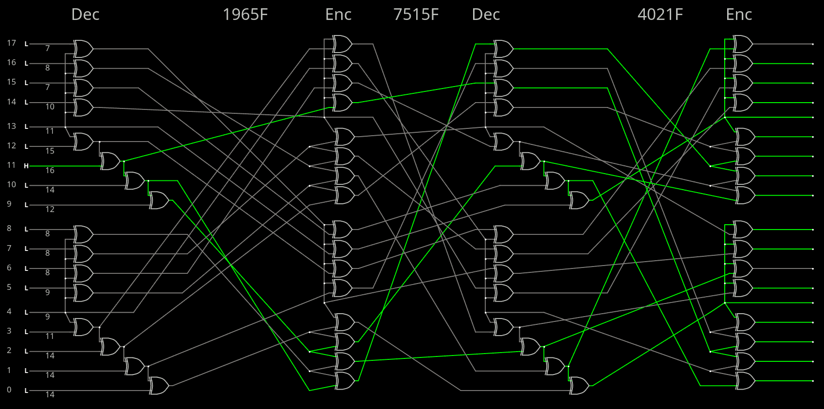

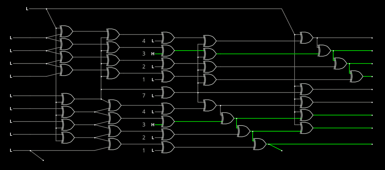

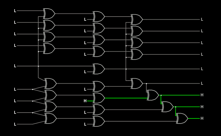

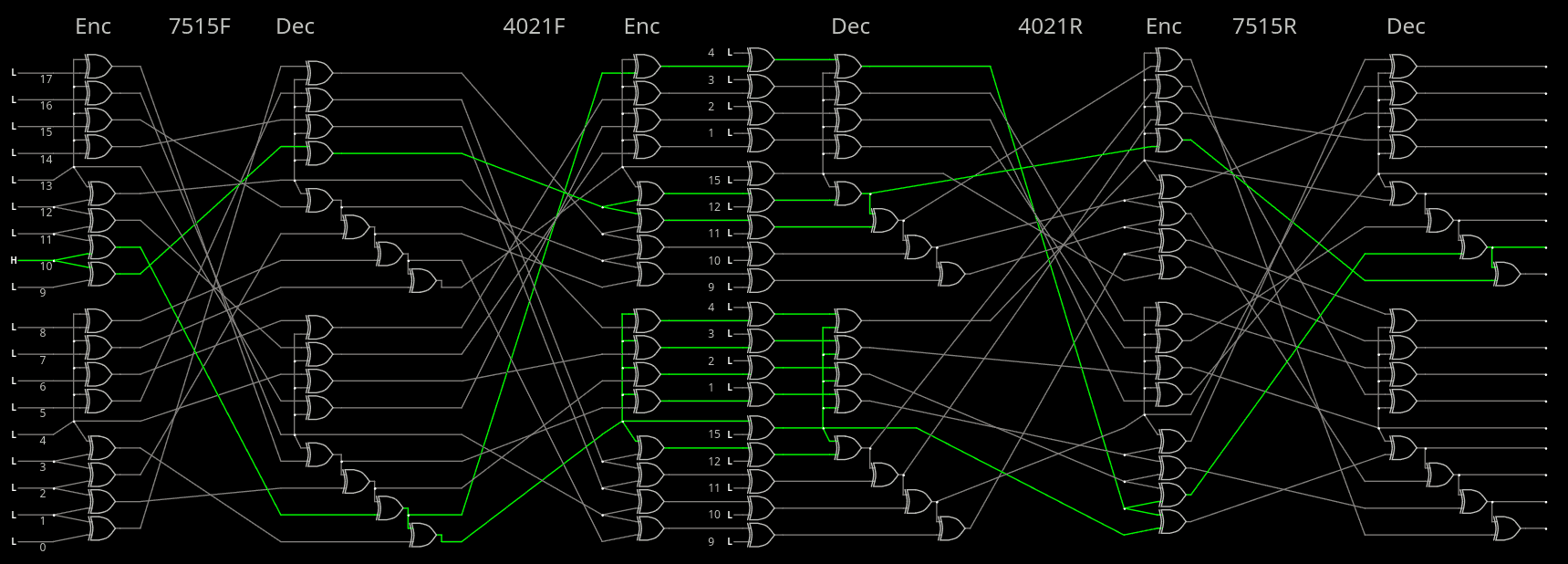

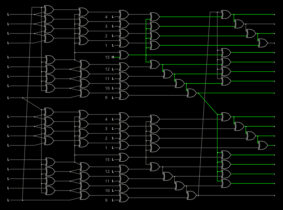

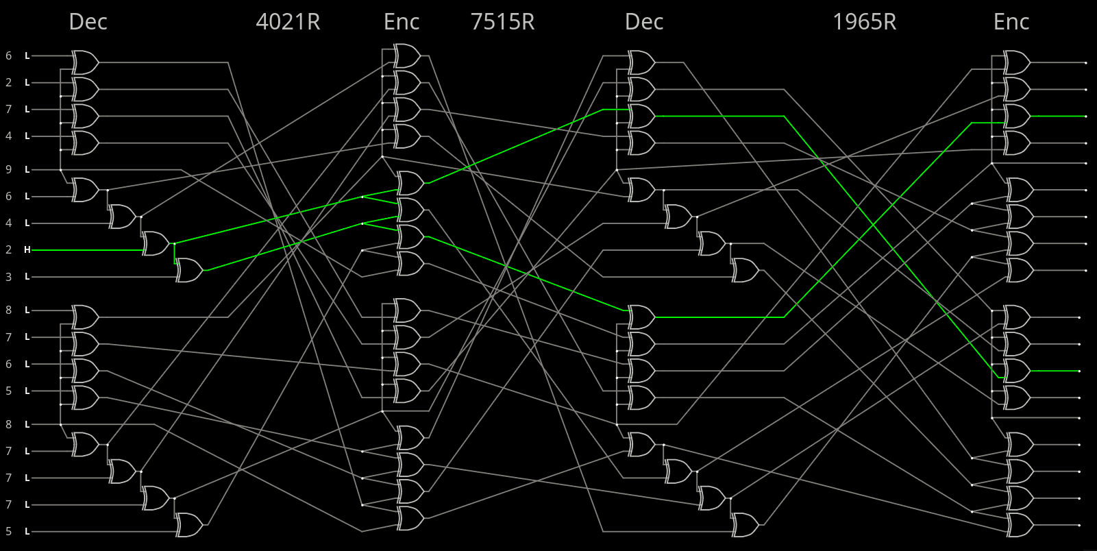

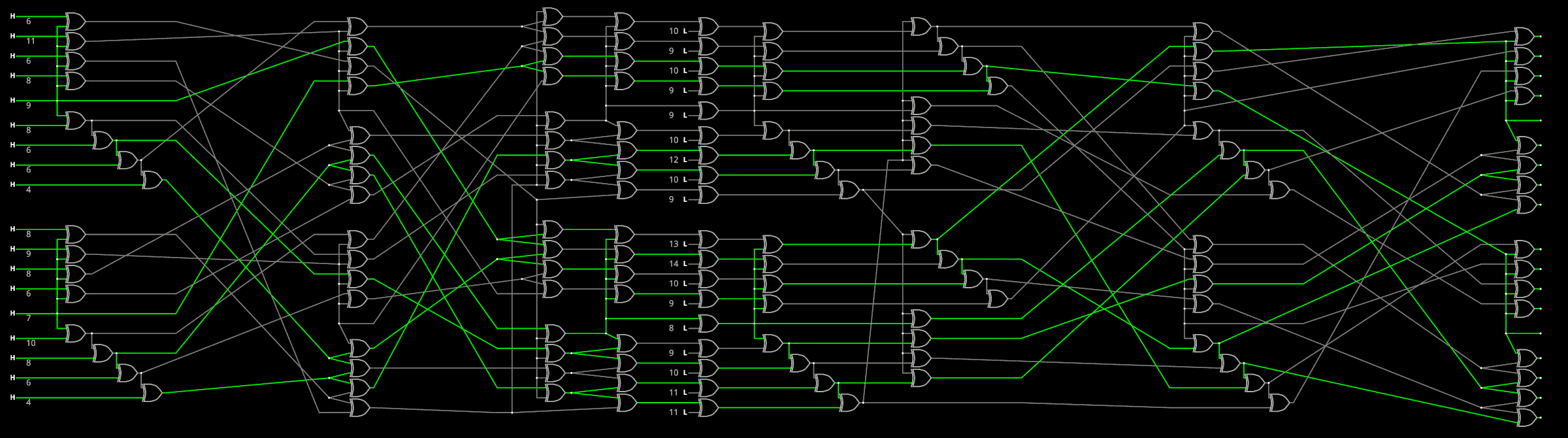

  • Hammer = Hamming Maximiser
    Yann Guidon / YGDES12/28/2025 at 04:52 0 comments

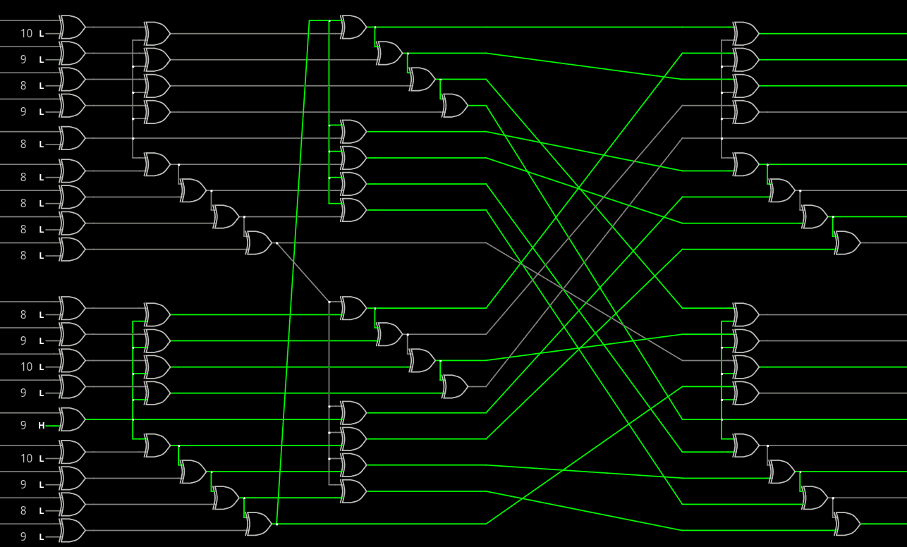

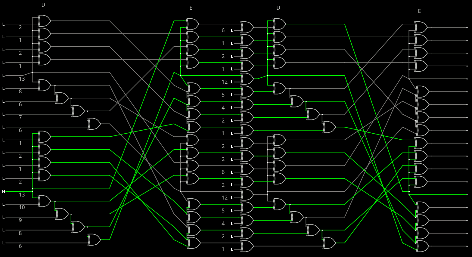

    So we have a unit that takes 18 bits and outputs 18 bits, whose values are as dependent from the others as permitted by only 64 XOR gates. Let's call it the H unit, because it tries to maximise the Hamming distance of the input word.
    This has been designed already, and I picked the encoder of a previous log:
    As noted before, it has some of the best possible avalanches I could find: 7 7 8 8 8 8 8 9 9 10 11 11 12 14 14 14 14 15 16 is not perfect but as good as it can be, within the constraints of parsimony of the project.
    We also know some of its flaws, by reading the avalanches of the reverse transform : a few combinations need only a few bits to flip only one bit, as indicated by the start of the avalanche sequence : 2 2 3 4 4...
    So, since the unit would be looped on itself, another permutation is required to amplify this even more, making sure these few weak bits are fed back to the strongest ones.
    But first, let's untangle this mess because there are a looot of crossings that would make P&R uselessly harder.
    The untangled circuit has had a weird episode.
    The score has changed ! 7 8 8 8 8 9 9 9 9 11 12 13 14 15 15 15 15 15
    The 16-bit avalanche has disappeared, as well as one of the 7-bits.
    However now we have five 15 and the sum of avalanches has climbed to 200 (vs 188 for the original version, max score is 18*18=324). I don't know how or why but that's good !
    Version with even fewer crossings :
    I checked : same behaviours, despite changing the place of the end gates.
    And now, the VHDL, and...
     0 : 13   110111011111011001
     1 : 14   110111011111011011
     2 : 14   110111101111011011
     3 : 13   110111101110011011
     4 : 10   010111100100110101
     5 :  8   110001101001001010
     6 :  8   000000011111111000
     7 :  9   101110111001000100
     8 :  8   111111000010100000
     9 : 15   111111011111111001
    10 : 16   111110111111111101
    11 : 14   111110111111110001
    12 : 11   001101111111010001
    13 :  9   000111100010110101
    14 :  7   110111000000100010
    15 :  9   111111000000101100
    16 :  8   100001001111110000
    17 :  9   000000011111111010
      total:195
    What the !!!!
    7 8 8 8 8 9 9 9 9 10 11 13 13 14 14 14 15 16
    5 fewer in total and 16 has appeared again, yet still only one 7,
    I give up.
    After all the minimum requirements are met and too much optimisation toward high numbers make combinations behaving inappropriately.

  • Proof, pudding.
    Yann Guidon / YGDES12/27/2025 at 09:04 0 comments
    After some computations, I'm sticking to the balanced configuration with 7-14 avalanche for both decoder and encoder, and I have chosen the first one specified below:
    14  188 168  14  7   14  7 - 1965 7515 4021
    Perm1965 =
     forward(  3  5  9 17 16 10 15 12  1  2  0 14  6  7 13  8 11  4 )
     reverse( 10  8  9  0 17  1 12 13 15  2  5 16  7 14 11  6  4  3 )
    Perm7515 =
     forward( 17  2 11  0  6 16  8  9 10 14  1  7 13 15  5 12  4  3 )
     reverse(  3 10  1 17 16 14  4 11  6  7  8  2 15 12  9 13  5  0 )
    Perm4021 =
     forward(  4 17  6  5  1 15  7 14 16 13  0  9 10  8 12  2  3 11 )
     reverse( 10  4 15 16  0  3  2  6 13 11 12 17 14  9  7  5  8  1 )
    There are 4 variants but they are just exposing the symmetries of the tiles.
    With these sequences of number, it's now time to implement the circuit, starting from the last layer (4021)
    A first obvious feature is that the end of each cascade loops back directly to a quad inverter, so it looks good.
    CircuitJS.
    Level 2, the middle permutation layer, implements Perm7515.
    Things start to look great!
    And finally the outer permutation Perm1965. But the circuit has exceeded the size of links so I have split the decoder from the encoder.
    Encoder:
    Decoder:
    The manual checks have found that the advertised numbers don't work as expected, and look like the previous two manual version I had created before. So a 5th layer and 4th permutation would be required for a full coverage but... Let's stick to the current config for now, because that's already a lot of gates.
    • Encoder: 7 7 8 8 8 8 8 9 9 10 11 11 12 14 14 14 14 15 16 is very good !
    • Decoder: 2 2 3 4 4 5 5 6 6 6 7 7 7 7 7 8 8 9 is lousy, worse than 121. MaxHam gen2 !
    The discrepancy has no apparent reason for now. But there is a simple workaround: swap the decoder and the encoder, so avalanche is better on the receiving side.
    Another "solution" would be to loop the circuits back for another round.
    3rd solution : use the highly efficient encoder in the loop of the NRZI converter, to form a combined unit.

  • MaxHam gen2
    Yann Guidon / YGDES12/25/2025 at 03:28 0 comments
    The previous attempt was very nice and taught me things, which I'll try to distill again, as I start coding it. Several insights affect this reboot:
    • I wanted to avalanche way too much early on
    • I should mix more at the first/outer layer
    • avoid "cancellation" by detecting "loops" of XOR that break the avalanches
    • alternate layer types so mixing is spreadier on the emitter.
    • 4 or 5 layers should be OK to reach H9 on both sides
    So we'll start with the "outer" layer:
    (please excuse the flaw at the lower-left quadrant)
    The Encoder layers stack becomes EDEDE, and decoder DEDED.
    For DE:DE, we have this sandwich:
    Avalanche for D-E: 1, 1, 1, 1, 2, 2, 2, 2, 6, 6, 6, 7, 8, 8, 9, 10, 13, 13
    Avalanche E-D : 1, 1, 1, 1, 2, 2, 2, 2, 2, 2, 4, 4, 5, 5, 6, 6, 12, 12
    Now what can we do ? Copy-paste of course ! With a little permutation that will associate the low avalanches with the high ones, and vice versa.
    The Permutation P is reversed by S, which are both used 2×, and the intermediary Q is reversed by T. So overall the complexity is kept low through the duplications.
    Encoder: DPE-Q-DPE
    Decoder: DSE-T-DSE
    Once you have the 9-bit tiles, they are duplicated and linked by permutations...
    The result is still 64 XOR gates and a quite powerful avalanche, both forward and backward. However one of the input avalanches only to 2 bits on the transmission side...
    Sender: 2, 5, 7, 7, 8, 8, 9, 9, 9, 10, 10, 11, 11, 12, 13, 13, 13, 13
    Receiver: 6, 6, 6, 6, 6, 7, 7, 9, 10, 10, 10, 10, 11, 11, 11, 11, 12, 12
    The sender has a bad bit with only 2 avalanches, which could be tied to the C/D bit. But that's a sub-optimal approach...
    There are two ways to go forward:
    1. add another layer. This increases latency, cost, complexity...
    2. explore the design space with an exhaustive method: let a computer generate many permutations and find the best parameters. This looks like the way to go...
  • Hamming distance maximiser
    Yann Guidon / YGDES12/23/2025 at 00:11 0 comments
    A better 3-layers error propagator :

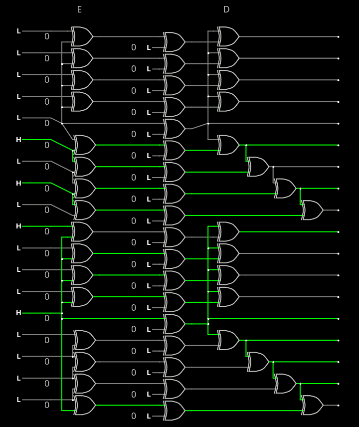

    Avalanche from a single-bit error can reach 14, and only one affects only 8. That's a success.
    However a whole bunch of inputs (7) still flip only 2 transmitted bits. In order to boost the avalanches there, the encoder should have a cascade too...
    So here is the new encoder, with its two cascades to mitigate the poor effect on the line.
    Two inputs only affect 4 bits. These can be allocated to the CD and MSB bits.
    Notice that from the data available, ALL errors with 1, 2, 3, 5, 12, 13, 14, 15, 16, 17 and 18 bits will flip at least 2 decoded bits.
    The whole pipeline is getting insane:
    Here is the link, I removed segments to keep the URL working.
    Total gates count for the encoder and the decoder : 64 XOR each. That's not insignificant but it's still way "cheaper" than the tens of words of FIFO that it saves, and even though the immediate error latency increases by one or two cycles, the worst cases are considerably reduced, without having to increase the avalanche in the PEAC scrambler.
    • Avalanche input-to-output: 4,4,6,6,6,6,6,6,7,8,8,8,8,8,9,9,10,11
    • Avalanche input-to-output: 5,5,6,7,7,8,9,9,9,9,9,9,9,9,9,10,11,11
    The worst-case error avalanche has decreased... but it's still manageable and it's a compromise for the size and the input avalanche. I'm sure there are better circuits but it's the best I can do in a day, it's a considerable improvement over the existing system.
    And now, VHDL is calling.

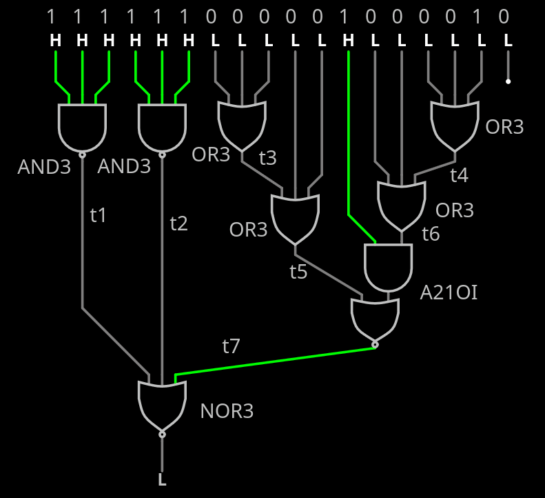

My approximate design parameters :
- Fclk = 100 to 130MHz (coming from "somewhere")
- 1 gate = 3 inputs max, approx 1ns (about 30% variation across voltage, process and temp variation)
- Input pins : some can do differential and dual-edge clocking, can be ganged to act as high speed comparators and create crude ADC. But their count must be kept low: 2 is nice, 3 is still OK, 4 has to be worth it.
- Output pins : can do differential and dual-edge clocking too

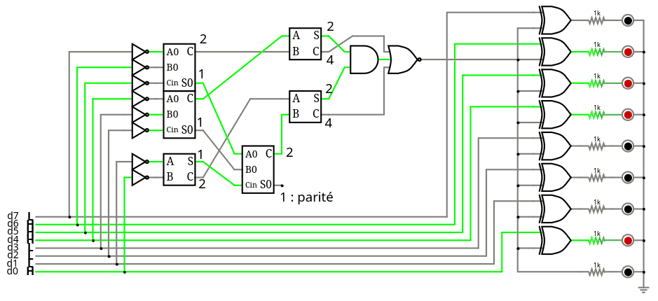

Yann Guidon / YGDES wrote 03/23/2025 at 19:30 point
20250323 !

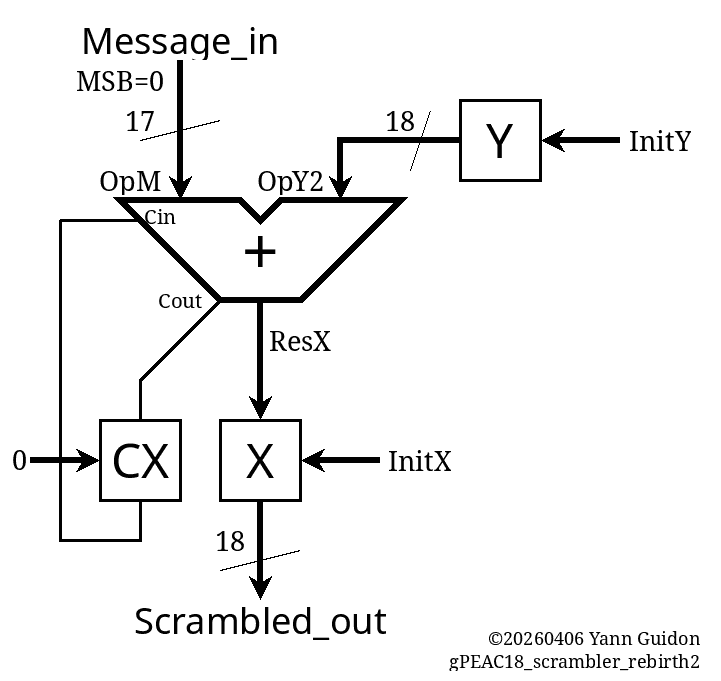

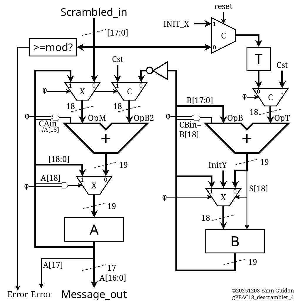

So far we got :
- a pretty good 16-bit scrambler with a very long period, no risk of crash and parallel implementation : easier operation, lower power and
- the scrambled word has 2 additional marker bits for flagging the data vs control words, also providing a "sticky" checksum flag
- the parity/flip stage performs pop count on the 2 halves, extracting a parity flag that alters the data markers, and flips whole bytes when the number of set bits is lower than 4.
Result :
- 16 data bits are expanded to 20, which is the same +25% overhead as 100BaseT
- Far better and faster error detection, both from the scrambler and the parity/popcount levels.
- The maximum length of consecutive 0s is 10 by construction. This effectively bounds the bandwidth in a strict F-F/10 range, which is an important design parameter for the coupling transformers and the working frequency. This figure changes depending on the modulation scheme, as MLT3 divides the main frequency by 4.
- Droop management will use the popcounts from the parpop level, and insert "correction" packets when the drift exceeds a (configurable) value.
