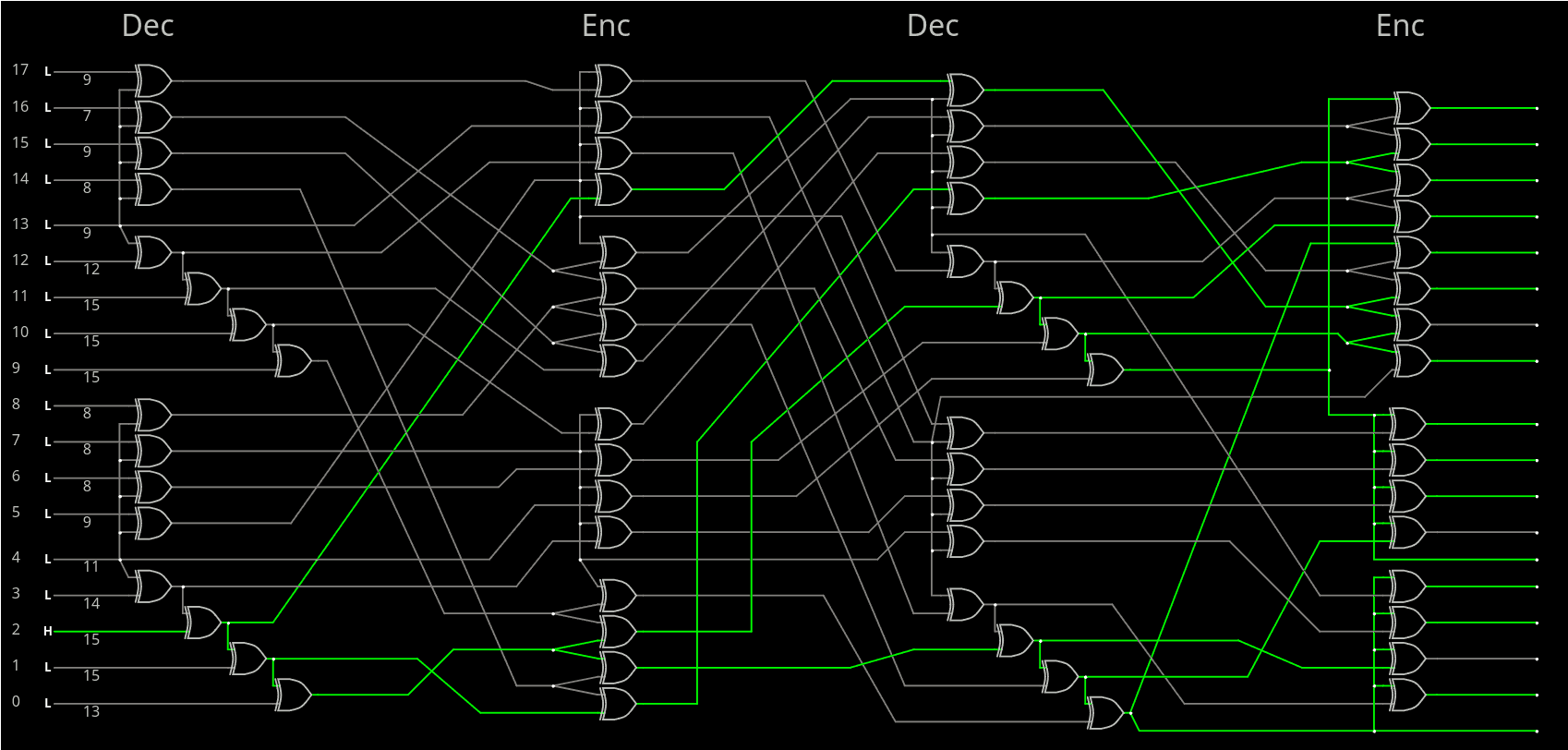

  • Hammer = Hamming Maximiser
    Yann Guidon / YGDES14 hours ago 0 comments
    So we have a unit that takes 18 bits and outputs 18 bits, whose values are as dependent from the others as permitted by only 64 XOR gates. Let's call it the H unit, because it tries to maximise the Hamming distance of the input word.
    This has been designed already, and I picked the encoder of a previous log:
    As noted before, it has some of the best possible avalanches I could find: 7 7 8 8 8 8 8 9 9 10 11 11 12 14 14 14 14 15 16 is not perfect but as good as it can be, within the constraints of parsimony of the project.
    We also know some of its flaws, by reading the avalanches of the reverse transform : a few combinations need only a few bits to flip only one bit, as indicated by the start of the avalanche sequence : 2 2 3 4 4...
    So, since the unit would be looped on itself, another permutation is required to amplify this even more, making sure these few weak bits are fed back to the strongest ones.
    But first, let's untangle this mess because there are a looot of crossings that would make P&R uselessly harder.
    The untangled circuit has had a weird episode.
    The score has changed ! 7 8 8 8 8 9 9 9 9 11 12 13 14 15 15 15 15 15
    The 16-bit avalanche has disappeared, as well as one of the 7-bits.
    However now we have five 15 and the sum of avalanches has climbed to 200 (vs 188 for the original version, max score is 18*18=324). I don't know how or why but that's good !
    Version with even fewer crossings :
    I checked : same behaviours, despite changing the place of the end gates.

  • Proof, pudding.
    Yann Guidon / YGDESa day ago 0 comments
    After some computations, I'm sticking to the balanced configuration with 7-14 avalanche for both decoder and encoder, and I have chosen the first one specified below:
    14  188 168  14  7   14  7 - 1965 7515 4021
    Perm1965 =
     forward(  3  5  9 17 16 10 15 12  1  2  0 14  6  7 13  8 11  4 )
     reverse( 10  8  9  0 17  1 12 13 15  2  5 16  7 14 11  6  4  3 )
    Perm7515 =
     forward( 17  2 11  0  6 16  8  9 10 14  1  7 13 15  5 12  4  3 )
     reverse(  3 10  1 17 16 14  4 11  6  7  8  2 15 12  9 13  5  0 )
    Perm4021 =
     forward(  4 17  6  5  1 15  7 14 16 13  0  9 10  8 12  2  3 11 )
     reverse( 10  4 15 16  0  3  2  6 13 11 12 17 14  9  7  5  8  1 )
    There are 4 variants but they are just exposing the symmetries of the tiles.
    With these sequences of number, it's now time to implement the circuit, starting from the last layer (4021)
    A first obvious feature is that the end of each cascade loops back directly to a quad inverter, so it looks good.
    CircuitJS.
    Level 2, the middle permutation layer, implements Perm7515.
    Things start to look great!
    And finally the outer permutation Perm1965. But the circuit has exceeded the size of links so I have split the decoder from the encoder.
    Encoder:
    Decoder:
    The manual checks have found that the advertised numbers don't work as expected, and look like the previous two manual version I had created before. So a 5th layer and 4th permutation would be required for a full coverage but... Let's stick to the current config for now, because that's already a lot of gates.
    • Encoder: 7 7 8 8 8 8 8 9 9 10 11 11 12 14 14 14 14 15 16 is very good !
    • Decoder: 2 2 3 4 4 5 5 6 6 6 7 7 7 7 7 8 8 9 is lousy, worse than 121. MaxHam gen2 !
    The discrepancy has no apparent reason for now. But there is a simple workaround: swap the decoder and the encoder, so avalanche is better on the receiving side.
    Another "solution" would be to loop the circuits back for another round.
    3rd solution : use the highly efficient encoder in the loop of the NRZI converter, to form a combined unit.

    • I wanted to avalanche way too much early on
    • I should mix more at the first/outer layer
    • avoid "cancellation" by detecting "loops" of XOR that break the avalanches
    • alternate layer types so mixing is spreadier on the emitter.
    • 4 or 5 layers should be OK to reach H9 on both sides
    So we'll start with the "outer" layer:
    (please excuse the flaw at the lower-left quadrant)
    The Encoder layers stack becomes EDEDE, and decoder DEDED.
    For DE:DE, we have this sandwich:
    Avalanche for D-E: 1, 1, 1, 1, 2, 2, 2, 2, 6, 6, 6, 7, 8, 8, 9, 10, 13, 13
    Avalanche E-D : 1, 1, 1, 1, 2, 2, 2, 2, 2, 2, 4, 4, 5, 5, 6, 6, 12, 12
    Now what can we do ? Copy-paste of course ! With a little permutation that will associate the low avalanches with the high ones, and vice versa.
    The Permutation P is reversed by S, which are both used 2×, and the intermediary Q is reversed by T. So overall the complexity is kept low through the duplications.
    Encoder: DPE-Q-DPE
    Decoder: DSE-T-DSE
    Once you have the 9-bit tiles, they are duplicated and linked by permutations...
    The result is still 64 XOR gates and a quite powerful avalanche, both forward and backward. However one of the input avalanches only to 2 bits on the transmission side...
    Sender: 2, 5, 7, 7, 8, 8, 9, 9, 9, 10, 10, 11, 11, 12, 13, 13, 13, 13
    Receiver: 6, 6, 6, 6, 6, 7, 7, 9, 10, 10, 10, 10, 11, 11, 11, 11, 12, 12
    The sender has a bad bit with only 2 avalanches, which could be tied to the C/D bit. But that's a sub-optimal approach...

    A better 3-layers error propagator :
    Avalanche from a single-bit error can reach 14, and only one affects only 8. That's a success.
    However a whole bunch of inputs (7) still flip only 2 transmitted bits. In order to boost the avalanches there, the encoder should have a cascade too...
    So here is the new encoder, with its two cascades to mitigate the poor effect on the line.
    Two inputs only affect 4 bits. These can be allocated to the CD and MSB bits.
    Notice that from the data available, ALL errors with 1, 2, 3, 5, 12, 13, 14, 15, 16, 17 and 18 bits will flip at least 2 decoded bits.
    The whole pipeline is getting insane:
    Here is the link, I removed segments to keep the URL working.
    Total gates count for the encoder and the decoder : 64 XOR each. That's not insignificant but it's still way "cheaper" than the tens of words of FIFO that it saves, and even though the immediate error latency increases by one or two cycles, the worst cases are considerably reduced, without having to increase the avalanche in the PEAC scrambler.
    • Avalanche input-to-output: 4,4,6,6,6,6,6,6,7,8,8,8,8,8,9,9,10,11
    • Avalanche input-to-output: 5,5,6,7,7,8,9,9,9,9,9,9,9,9,9,10,11,11
    The worst-case error avalanche has decreased... but it's still manageable and it's a compromise for the size and the input avalanche. I'm sure there are better circuits but it's the best I can do in a day, it's a considerable improvement over the existing system.

  • A reversible mixing primitive
    Yann Guidon / YGDES6 days ago 0 comments
    I think I have something interesting for the Hamming maximiser. Long story short, it's a "primitive" with 9 bits in, 9 bits out, meant to be used in layers with bit permutations between them.
    On Falstad's circuitjs: one layer.
    On the left, the encoder, on the right is the decoder, with an error injection layer.
    There are several zones of interest:
    • there's the "verbatim" bit, which has a pretty important fanout (6). It is not transformed and can be boosted in some way.
    • There are 4 "flippers", one layer deep. They could be made of slower, smaller XOR gates.
    • There is the "cascade" with gates that need more speed, and could be implemented with MAJ3 or things like that.
    Also not that the "flippers" could be merged as a XOR3 gate with the next layer.
    Conveniently the 9 bits are a divisor of 18, and it would work as well for 16 bit words (by removing one gate).
    The encoder could work well with 3 or 4 layers in the pipeline. The decoder could need a pipeline in the middle, because each primitive has a 4-XOR latency that could be too much...
    We'll have to check how many layers are required, and what amount and type of bit permutation are best.
    Here is a circuit with 3 layers, without the permutations (left unconnected so far)
    A more systematic and hierarchical version is built with these combined primitives, which can communicate with neighbours.
    The error inputs are anotated with the number of affected bits at the output.
    This is meant to be combined with other identical blocks, here two are enough. In this configuration the circuit yields an avalanche between 1 and 15 bits:
    And a 3rd layer evens this all out, mostly, thanks to some 2:1 interleaving:
    As a result, all injected errors trigger an avalanche of at least 8 bits.
    Still, 8 inputs trigger only 2 changes at the encoded word, meaning that certain 2-bit errors will trigger only 1 bit of output (de-amplifying them). The below case could be handled by more interleaving but it might not be pertinent/appropriate.
    Anyway it's getting pretty sick ! (circuit)
    So a 4th layer (with 3:1 interleaving ?) should be "good".
