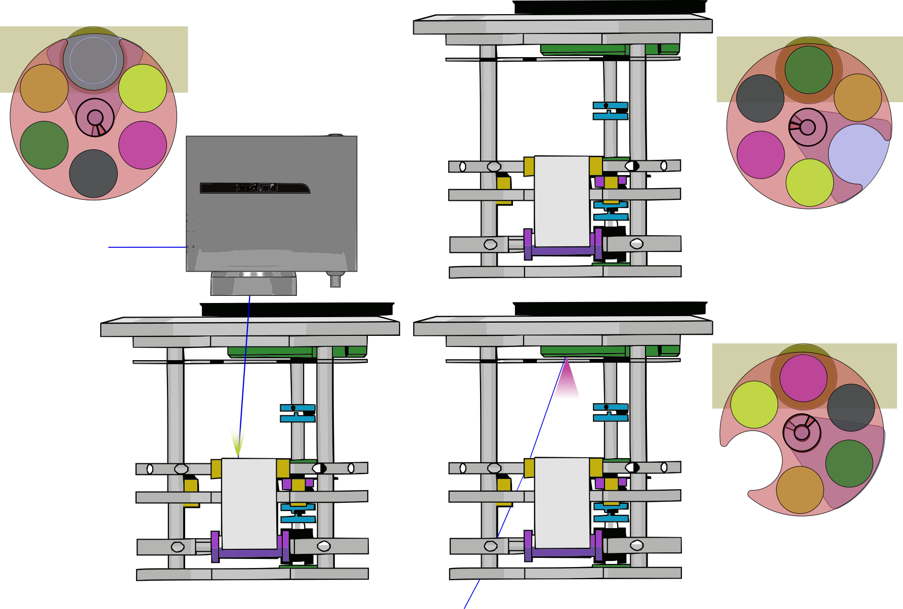

This simplicity allows a simple mechanical fixture to change the material being deposited:
Then just a set of rotations allows oneself to greatly expand the kind of materials systems to be explored, from single materials to multilayers, alloys, (non)uniform doping, reactive deposition.

    To make room for the intended alterations and new optical path, a whole new frame was fabricated:
    It holds the laser source, vacuum system, optics and everything needed for a working machine, except the rotary vacuum pump (to decouple vibrations) and control computer.
    The laser is held vertically, where the light from the source goes up towards an adjusting/steering mirror which reflects it in a 90º angle. Then, there are two alternative optical paths, depending on the position of a mirror which is located at the top of a moving carriage:
    For deposition, the mirror is positioned in such a way that light reflect downward again,
    towards a scanning stage which rotates on it's own axis in order to be able to steer the beam over the targets, providing uniform removal of material.
    This stage also holds a lens which focus the light onto a tight spot. It's worth noticing that in order to efficiently couple the radiation onto the target, it's very important to use appropriate optical elements which minimized absorption and unintended reflections. All the mirrors used are based on dielectric stacks, with reflectivity over 0.99 at 355nm. However, the lens is made of glass (a bit of absortion loses) and with a broadband AR coating, which might not be ideal either. The vacuum window is made of uncoated fused silica, which reflects quite a bit of light (even though incidence angles are rather close to normal). Better transmissive optics are on the way.
    This movement of the whole carriage was made so in order to keep at least one of the degrees of freedom of the scan parallel to the surface of the target, avoiding in principle at least variations on light spot size while scanning.

    Defining the process
    To being able to flexibly fabricate the intended structures, the following process was devised:
    One starts with a bare substrate, covered by the unmarked mask 'web'
    and a shutter between them. The target carousel is placed in such a way that it lets laser light pass through it. Either under vacuum or an unreactive gas, the apertures are defined.
    When the apertures are cut, the shutter is removed and the proper atmosphere is set onto the chamber.  Then the proper deposition process is performed (either from a single target or a given combination).
    Once the deposition step is completed, the mask web is moved until only unmarked tape covers the substrate.  This sequence may be repeated until the mask is completely consumed.
    Evidently the shutter is required to protect the substrate from debris and laser ablation. It quite a compromise, as the distance between shadow mask and substrate heavily influences the achievable resolution.
    As a solution, the mechanism is designed in such a way that whenever the shutter moves into place, it pushes the substrate stage onto a lower position. When the substrate is uncovered, the substrate stage  reciprocates back, with it's position determined by a simplified kinematic coupling.
    Now such mechanism seems to have a fair bit of degrees of freedom: Target carousel, shutter, and mask roll movement is required. However, they move in a fairly well defined sequence, so in principle all movements could be partially coupled to one another in order to reduce the required actuation elements.
