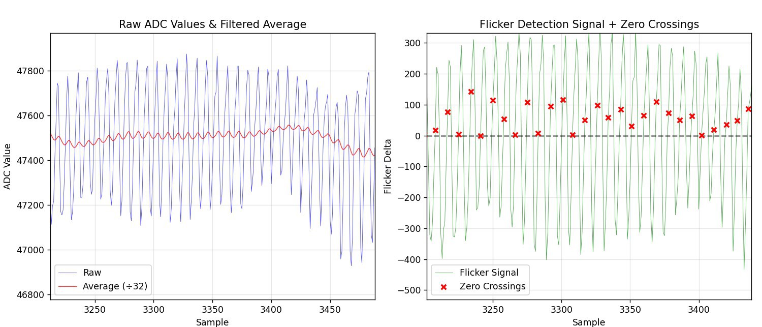

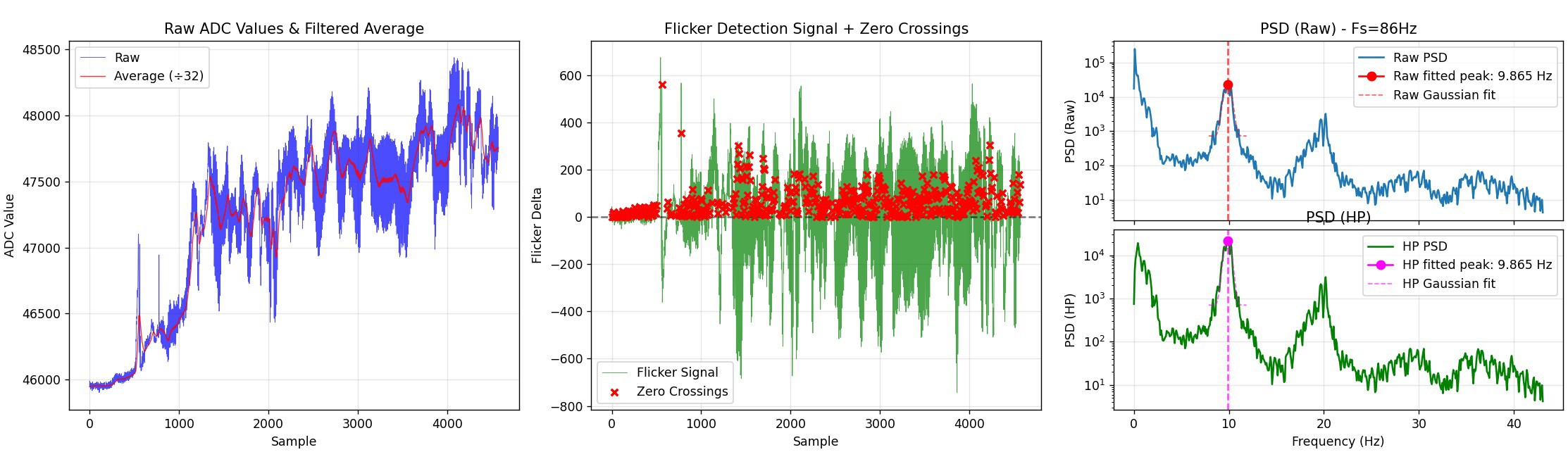

I recorded data traces with a Python tool from the monitor output and used a separate script to analyze data and prototype the signal processing chain. The sample rate is limited to around ~90 Hz due to the overhead of printing data via the debug output, but the data rate turned out to be sufficient for this case.
Signal processing pipeline: raw data, baseline extraction, and frequency analysis The image above shows an overview of the signal chain. The raw data (after 32x averaging) is shown on the left. The signal is filtered with an IIR filter to extract the baseline (red). The middle figure shows the signal with baseline removed and zero-cross detection. The zero-cross detector will tag the first sample after a negative-to-positive transition with a short dead-time to prevent it from latching to noise. The right plot shows the PSD of the overall and high-pass filtered signal, showing that despite the wandering input signal, we get a sharp ~9.9 Hz peak for the main frequency.
A detailed zoom-in of raw samples with baseline and HP filtered data is shown below.

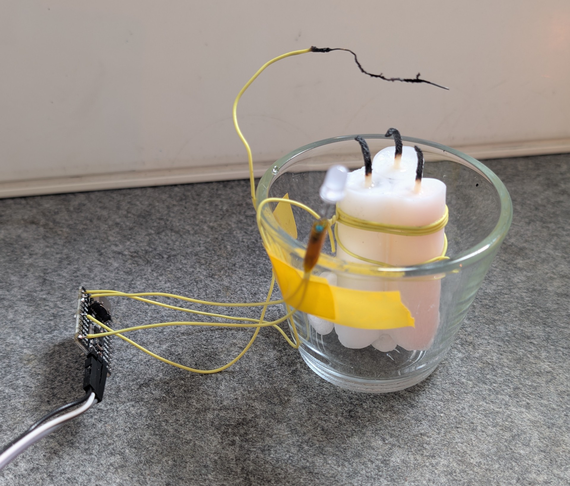

To implement the capacitive sensor, I opted to use a CH32V003 microcontroller with the CH32fun environment. You can see the full contraption below: the microcontroller is located on the small PCB to the left. The capacitance is sensed between a wire suspended in the flame (the scorched one) and a ground wire that is wound around the candle. The setup is completed with an LED as an output.
I also made some attempts with two wires in the flame, but did not necessarily get better results and the setup was mechanically much more unstable.
Complete capacitive sensing setup with CH32V003 microcontroller Reading out the sensor was quite straightforward using the TouchADC function that is part of CH32fun. This function measures the capacitance on an input pin by charging it to a voltage and measuring voltage decay while it is discharged via a pull-up/pull-down resistor. To reduce noise, it was necessary to average 32 measurements.

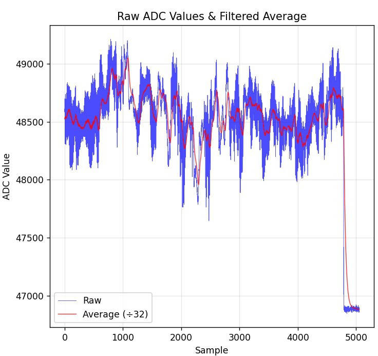

// Enable GPIOD, C and ADC RCC->APB2PCENR |= RCC_APB2Periph_GPIOA | RCC_APB2Periph_GPIOD | RCC_APB2Periph_GPIOC | RCC_APB2Periph_ADC1; InitTouchADC(); ... int iterations = 32; sum = ReadTouchPin( GPIOA, 2, 0, iterations );And indeed, it works! The sample trace below shows sequential measurements of a flickering candle until it was blown out at the end, as signified by the steep drop of the signal. The sampled data was transmitted as ASCII output via the console.
Capacitive sensing trace showing candle oscillations and extinction The signal has a lower amplitde than the optical signal and shows more baseline wander and amplitude drift—but we can work with that. Let's put it all together.

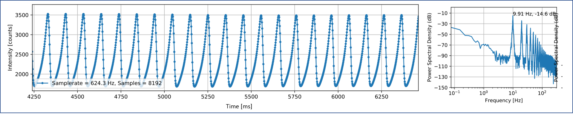

Two states of the oscillation cycle in bundled candles ---------- more ----------We can also record the brightness variation over time to understand this process better. In this case, I used a high-resolution ambient light sensor to sample the flicker over time. (This was part of more comprehensive experiments I conducted a while ago, which I'll write up in detail eventually.)
Plotting the brightness evolution over time shows that the oscillations are surprisingly stable, as shown in the image below. We can see a very nice sawtooth-like signal: the flame slowly grows larger until it collapses and the cycle begins anew.
On the right side of the image, you can see the power spectral density plot of the brightness signal on the left. The oscillation is remarkably stable at a frequency of 9.9 Hz.
Left: Brightness variation over time showing sawtooth pattern. Right: Power spectral density showing stable 9.9 Hz frequency This is very curious. Wouldn't you expect more chaotic behavior, considering that everything else about flames seems so random?
