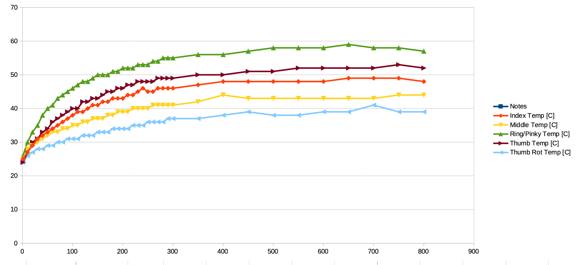

Our latest stress test pushed the hand through 500 open/close cycles of all fingers with a 330 unit force limit.
The result?
The hottest motor stabilized at a cool 58°C. Even after 800 cycles, the temperature held steady, proving the design is stable for continuous use.
This isn't a fragile lab toy: it's a platform ready for refinement.

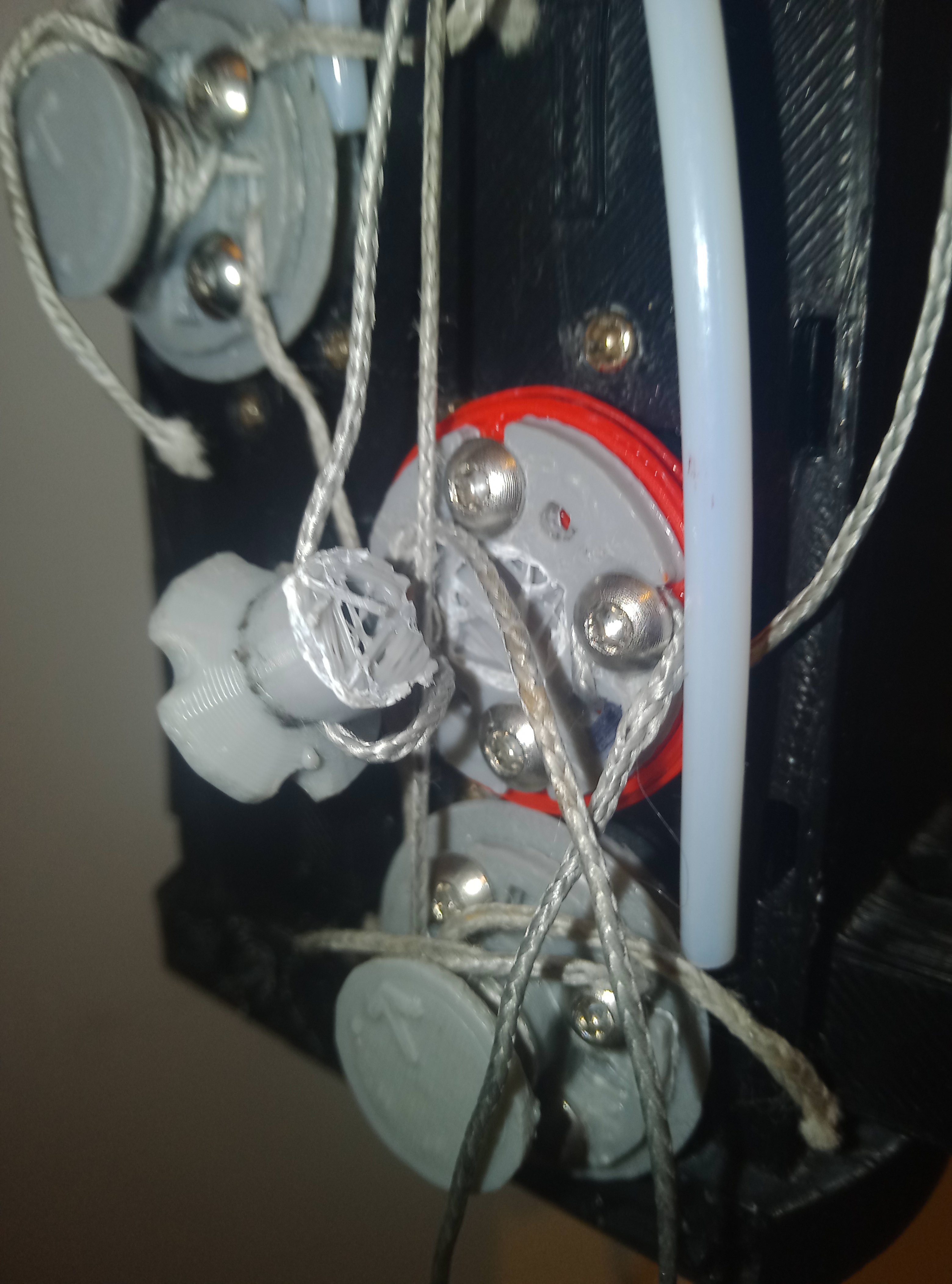

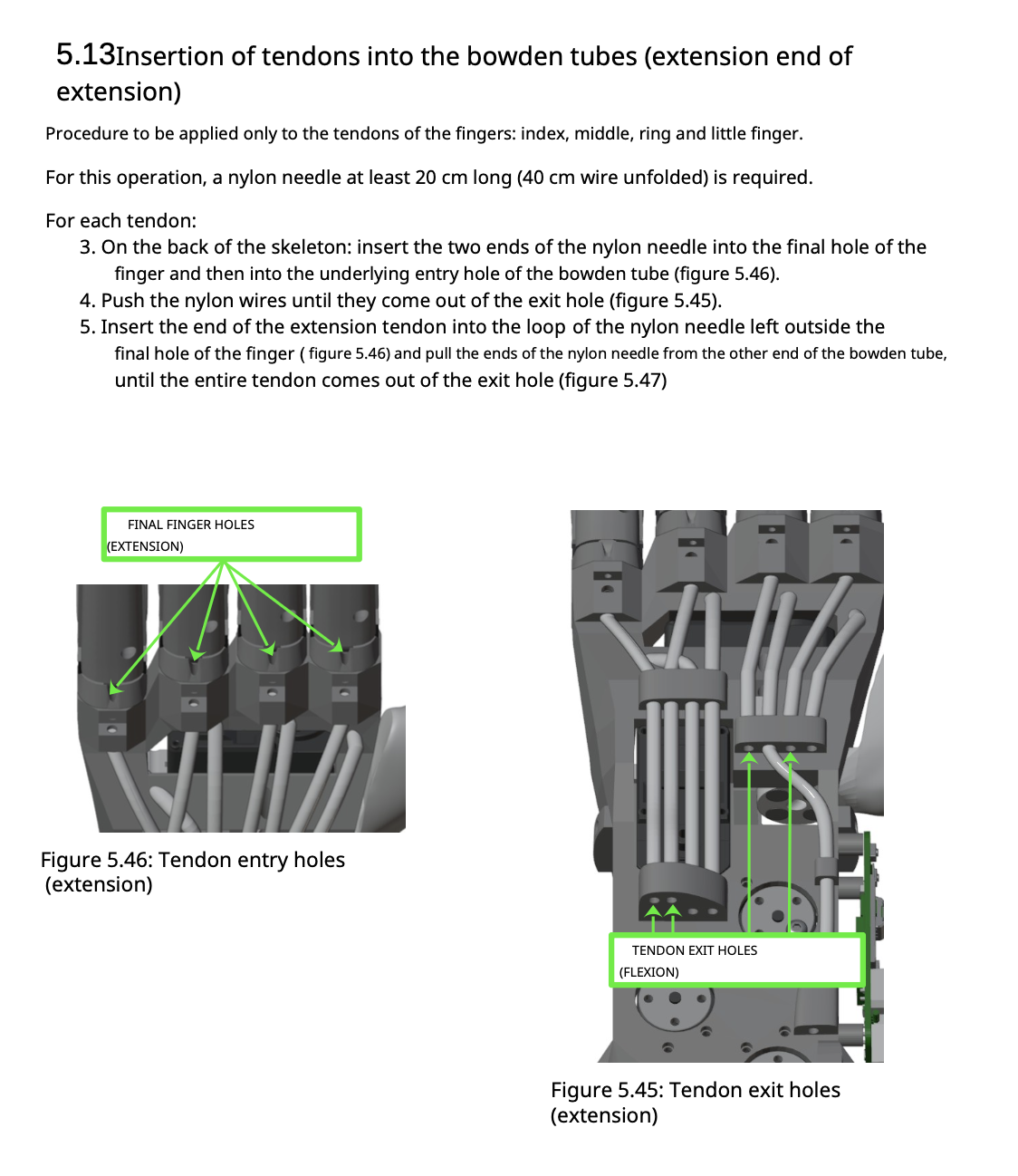

  • New Assembly Instructions and firmware
    Vittorio Lumare • 09/01/2026 at 10:58 • 0 comments
    The assembly instruction have been updated:

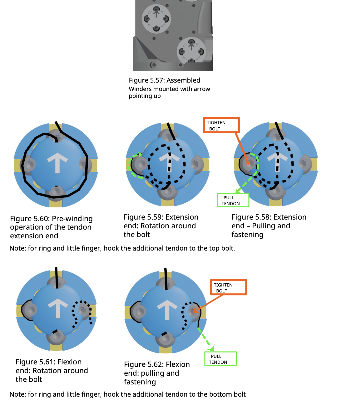

    • The method to attach the tendons to the thumb flexion spool changed
    • The document translation was improved, more respectful of the CE Regulation terminology.
    • The illustrations now are better, translated directly on the ODT format.
    The firmware was updated accordingly. Pinch grasp is more stable.

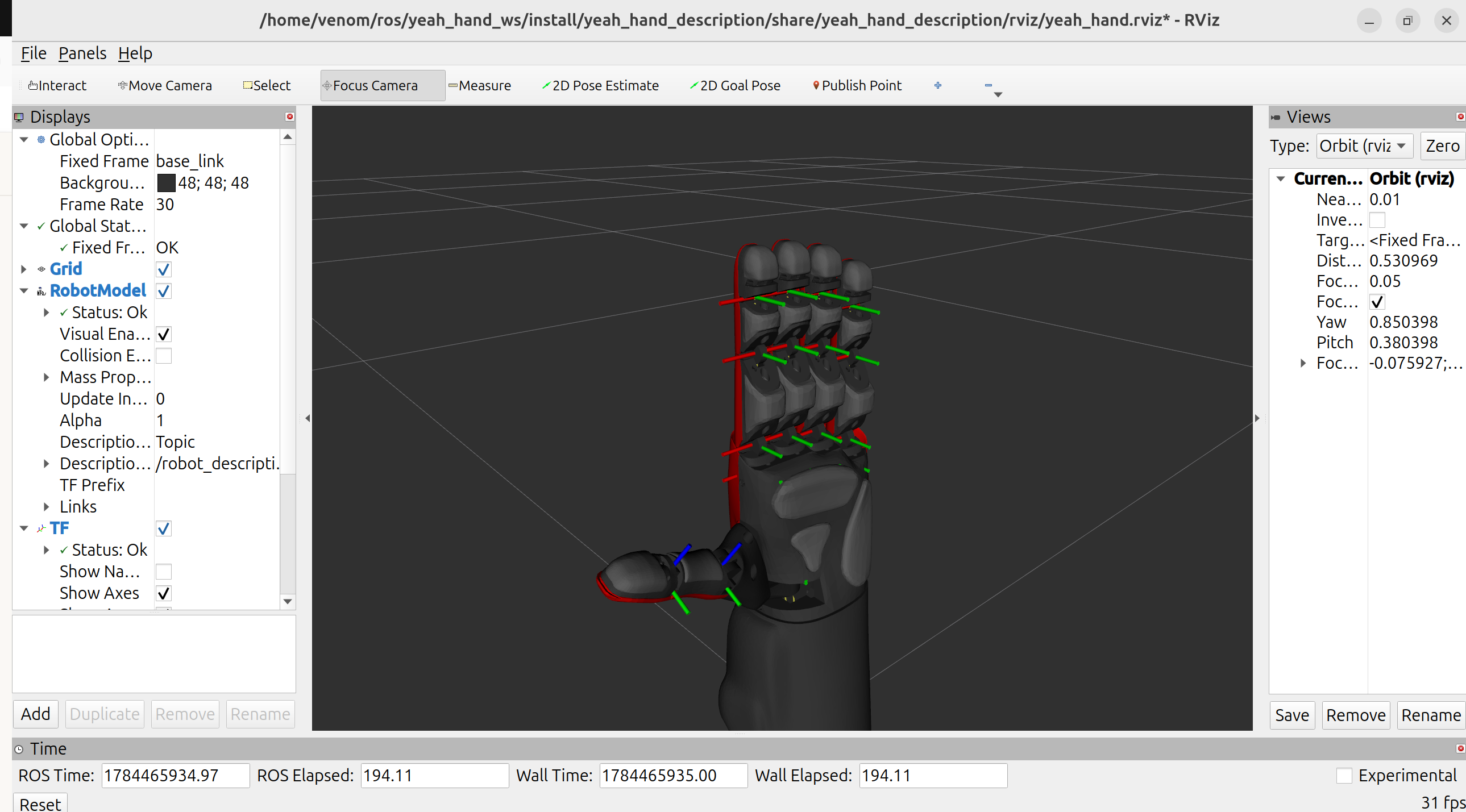

  • Updated ROS Driver
    Vittorio Lumare • 08/16/2026 at 20:33 • 0 comments
    We added a new feature to the ros driver: the 'load_limit' parameter, to set the maximum limit for the torque of a specific servomotor.
    Usage example (setting load limit for the index servomotor):
    ros2 param set /yeah_hand_system load_limit index_servo_joint.load_limit 500
    Code on Github repo.
  • ROS Driver Released
    Vittorio Lumare • 07/19/2026 at 13:02 • 0 comments

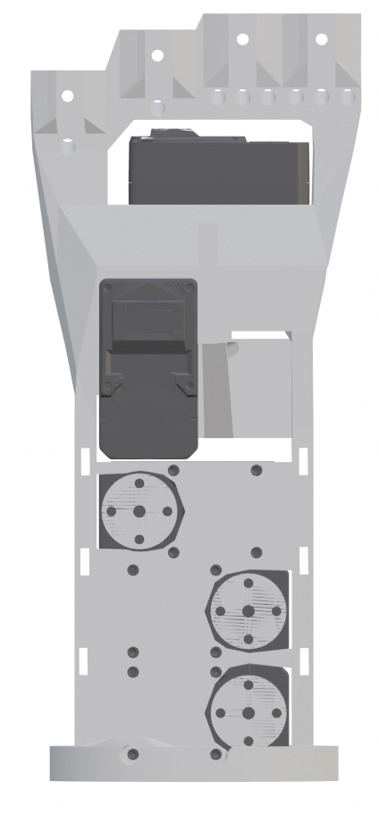

  • 1

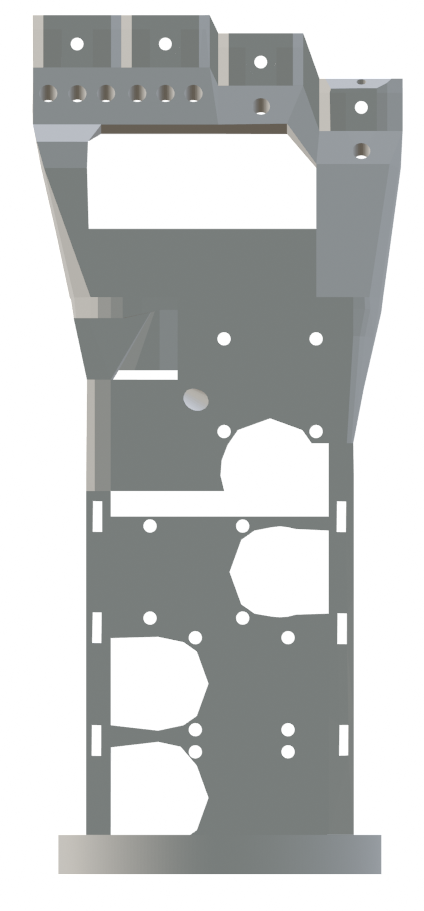

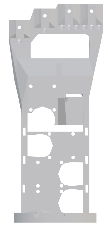

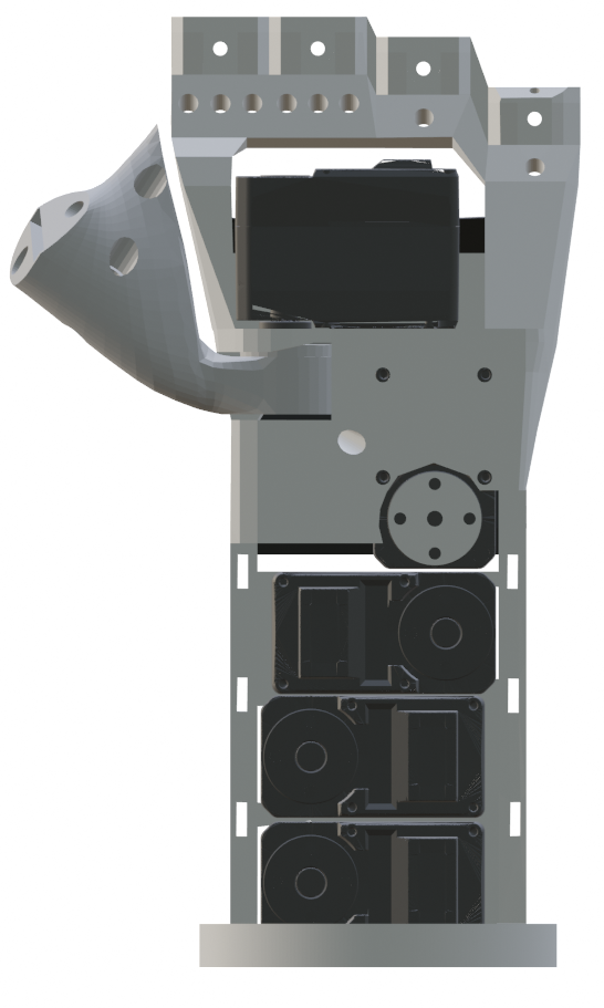

    Assembly : Initial Empty Skeleton
    The names of the holes and other parts are defined in the chapter Nomenclature of Parts.
    The assemblage consists taking the hand’s skeleton and to install on it all the components following a precise sequence.
    IMPORTANT: If the sequence is not followed correctly, all components already installed will have to be dismantled till the moment the sequence was modified, in order to resume again the proper order of the sequence because there are parts that cannot be assembled after others.
    Skeleton - front view
    Skeleton - back view
  • 2

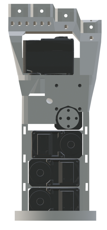

    Assembly : Servomotors Installation
    Note: each servomotors must be secured in its slot using 4 screws M2, 8mm long. TBD
    1. Install the Thumb Rotation Servomotor in the SSTR slot (Holes: MTR1, MTR, MTR3, MTR4)
      ◦ Note: Position the motor with the flange facing down.
    2. Install the Thumb Flexion Servomotor in the SST slot (Holes: MTF1, MTF2, MTF3, MTF4)
      ◦ Note: Position the motor with the flange facing the front side of the skeleton.

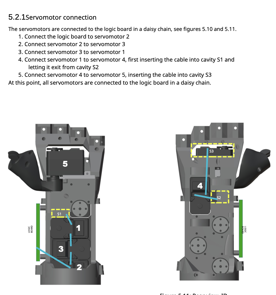

    3. Connect the servomotor in the SSTR slot to the one in the SST slot.
    4. Install the Middle Flexion Servomotor in the SSM slot (Holes: MM1, MM2, MM3, MM4)
      ◦ Note: Position the motor with the flange facing the rear side of the skeleton.
    5. Connect the servo motor in the SST slot. to the one in the SSM slot
    6. Install the Ring Flexion Servomotor in the SSR slot (Holes: MR1, MR2, MR3, MR4)
      ◦ Note: Position the motor with the flange toward the rear side of the skeleton.
    7. Connect the servomotor in the SSM slot to the one in the SSR slot
    8. Install the Index Flexion Servomotor in the SSI slot (Holes: MI1, MI2, MI3, MI4)
    9. Connect the servomotor in the SSR slot to the one in the SSI slot
    Left Hand – Servomotors Built-in – Front View
    Left Hand – Servomotors Built-in – Rear View
  • 3
    Thumb Base Installation
    1. Thumb Base on Thumb Rotation servomotor flange (4 bolts M3, 10mm long)    (Flange holes: SF1, SF2, SF3, SF4, Thumb Base holes: BT1, BT2, BT3, BT4)
View all 18 instructions
