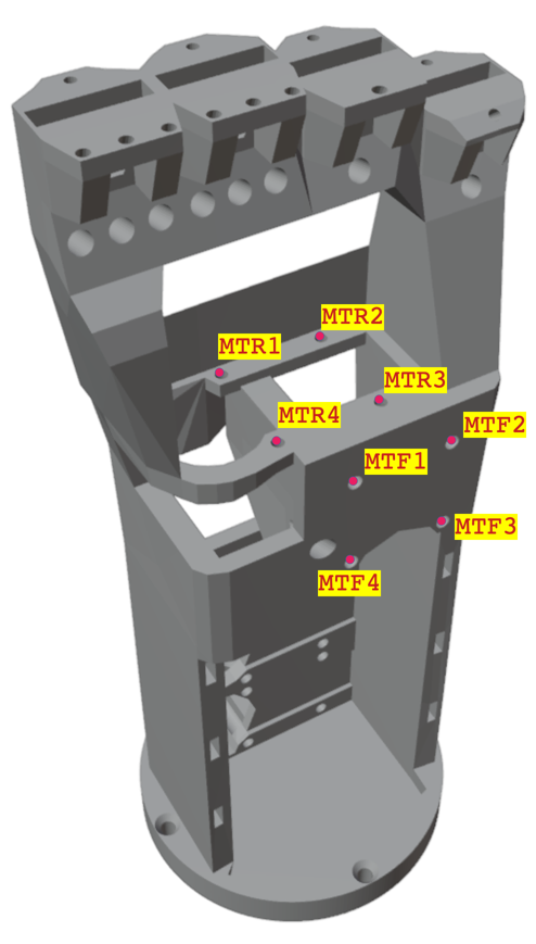

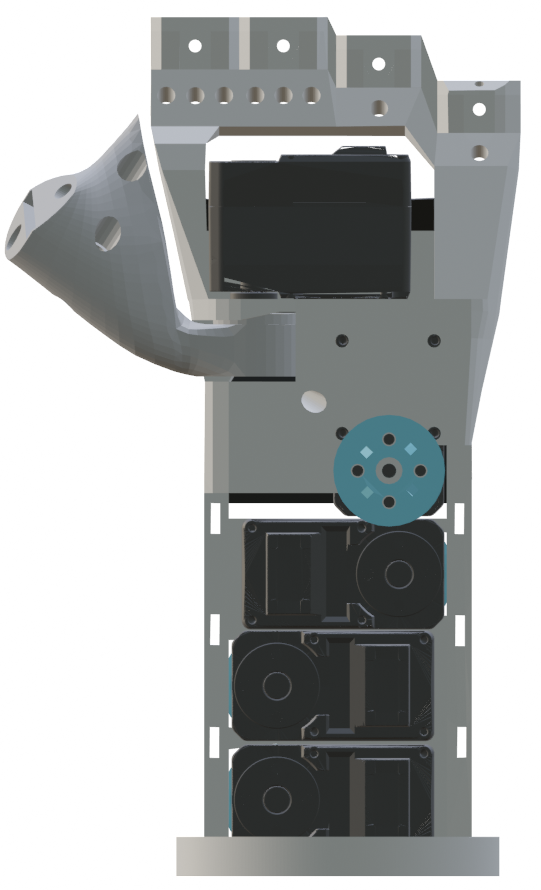

2Assembly : Servomotors Installation
Note: each servomotors must be secured in its slot using 4 screws M2, 8mm long. TBD
- Install the Thumb Rotation Servomotor in the SSTR slot (Holes:
MTR1, MTR, MTR3, MTR4)
◦ Note: Position the motor with the flange facing down.
Install the Thumb Flexion Servomotor in the SST slot (Holes: MTF1, MTF2, MTF3, MTF4)
◦ Note: Position the motor with the flange facing the front side of the skeleton.
Connect the servomotor in the SSTR slot to the one in the SST slot.

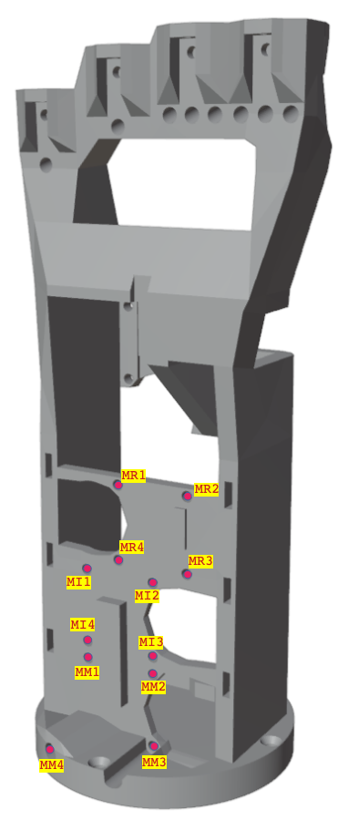

Install the Middle Flexion Servomotor in the SSM slot (Holes: MM1, MM2, MM3, MM4)
◦ Note: Position the motor with the flange facing the rear side of the skeleton.
Connect the servo motor in the SST slot. to the one in the SSM slot
Install the Ring Flexion Servomotor in the SSR slot (Holes: MR1, MR2, MR3, MR4)
◦ Note: Position the motor with the flange toward the rear side of the skeleton.
Connect the servomotor in the SSM slot to the one in the SSR slot
Install the Index Flexion Servomotor in the SSI slot (Holes: MI1, MI2, MI3, MI4)
Connect the servomotor in the SSR slot to the one in the SSI slot

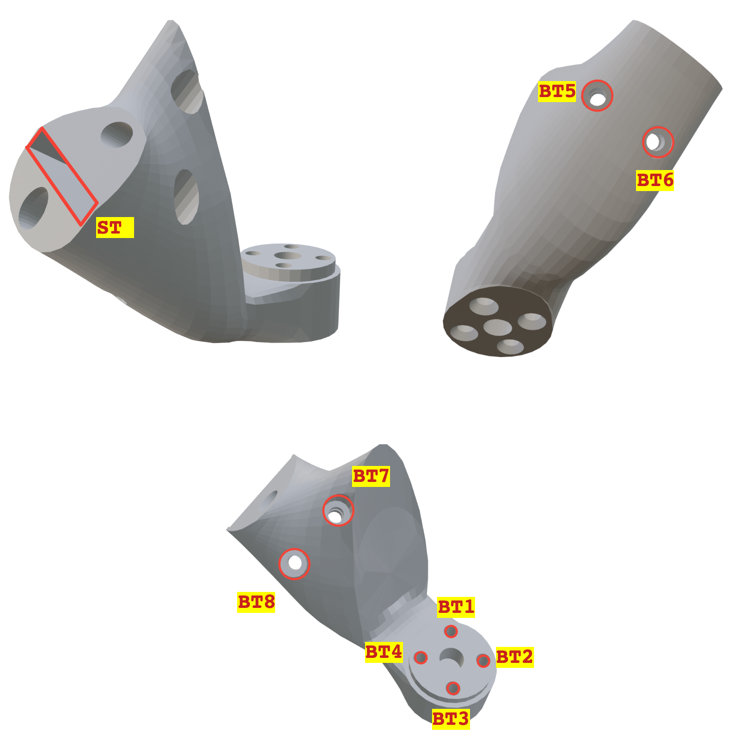

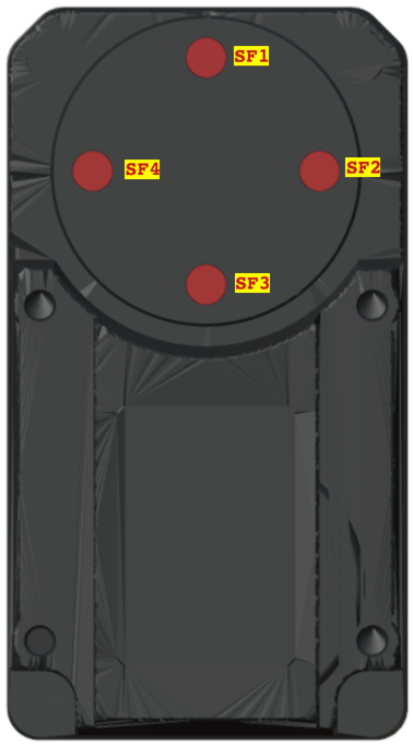

3Thumb Base Installation
Thumb Base on Thumb Rotation servomotor flange (4 bolts M3, 10mm long) (Flange holes: SF1, SF2, SF3, SF4, Thumb Base holes: BT1, BT2, BT3, BT4)

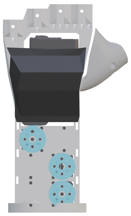

4Spools Installation
- Place a spool on the servomotor in the SST slot.
- Screw a spool with four hexagonal head bolts M3, 10mm long, (including a split washer).
- Place a spool on the servomotor in the SSR slot.
- Place a winder on the servomotor in the SSI slot.
- Place a winder on the servomotor in the SSM slot.

6Thumb Installation
Note: The thumb must be secured in its ST slot on the thumb base with 2 bolts M3, long 15mm. TBD: ADD STEP FOR THE BASE CONNECTOR
Insert the thumb into the slot, then the 2 bolts from behind (holes BT5, BT6), then the nuts from the other side (holes: BT7, BT8), and bolt it.

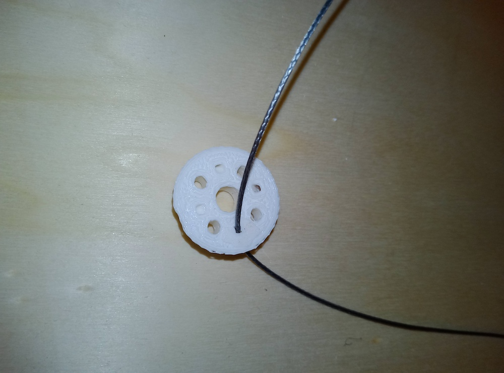

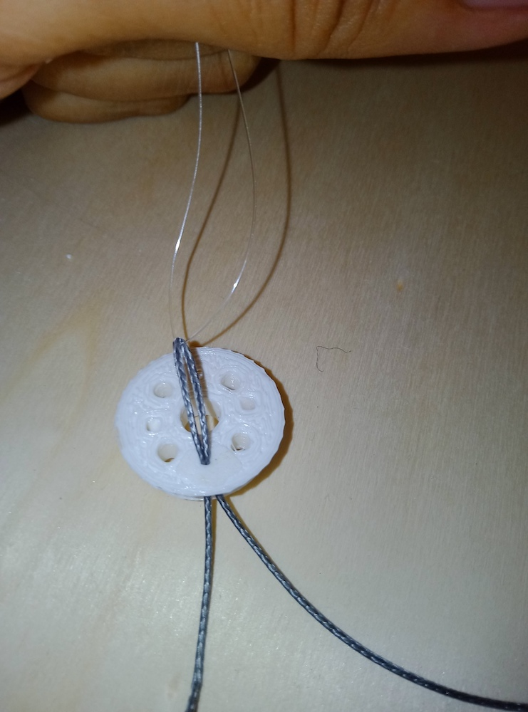

Usage of the Nylon Needle
Tendons are thin and difficult to thread, so a special needle is needed. This special needle is actually a nylon thread used as a needle. This method was chosen after multiple attempts, using various tools, as it proved to be the fastest, most reliable, and safest.
The following shows the procedure for threading the tendon through a hole using a nylon thread
(10cm, 0.35mm diameter) as a needle:
NOTE: From now on, we will simply refer to this sequence of operations as "Threading the
Tendon". It is implicitly assumed that this is done using the nylon needle.

Nomenclature of thumb servomotors holes
Nomenclature of upper fingers servomotors holes

Nomenclature of Thumb base slot and holes

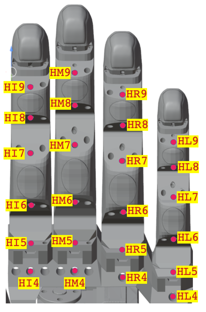

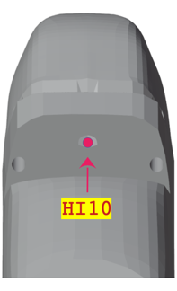

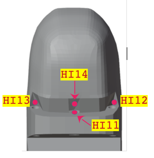

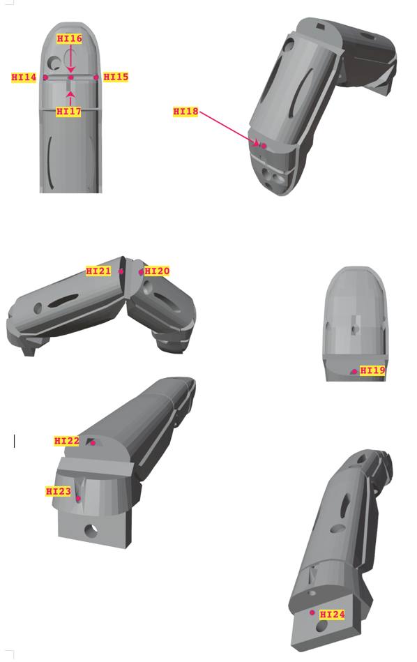

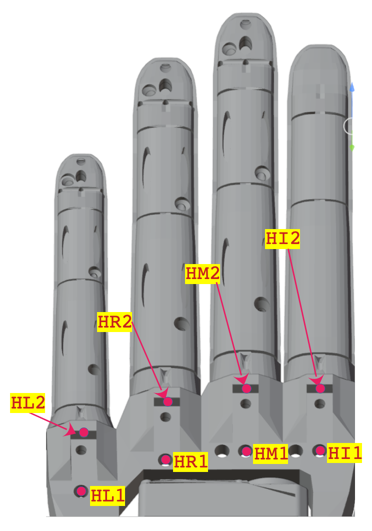

Nomenclature of tendon holes
Only the names of the holes for the index finger are shown. The names of the other finger holes can be obtained by replacing the prefix HI with the name of the desired finger. Below are the prefixes for the names of the other upper fingers (middle, ring, and little fingers).- Middle: HM
- Ring: HR
- Little: HL

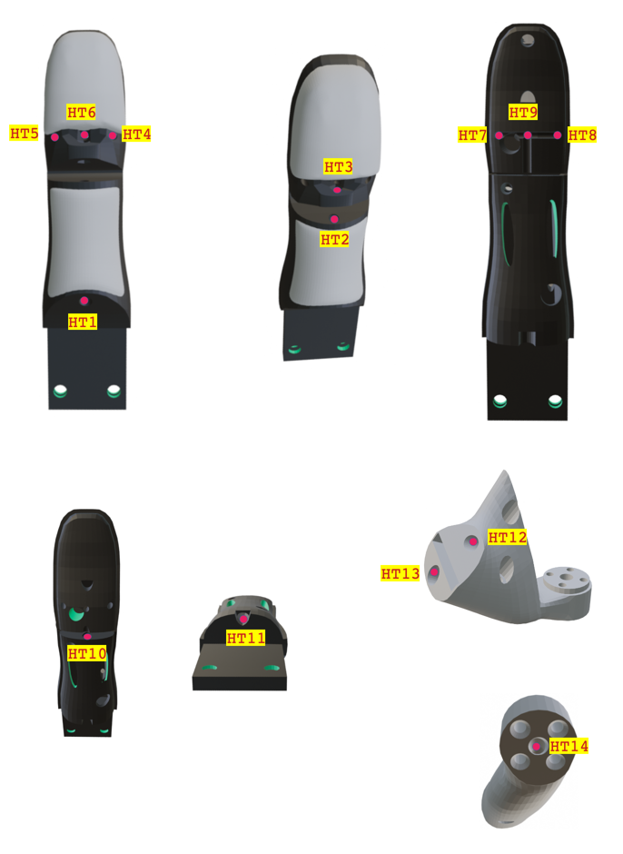

Nomenclature of thumb tendon holes

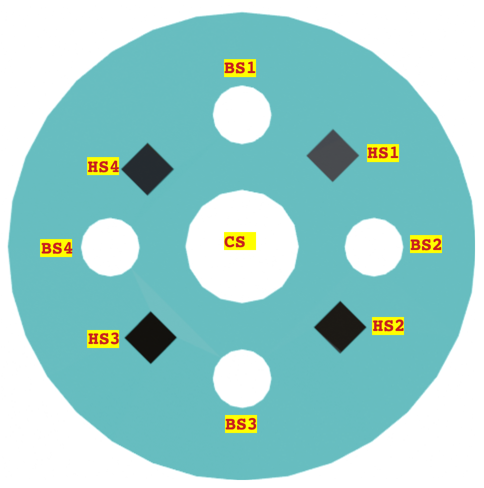

Nomenclature of spools holes
