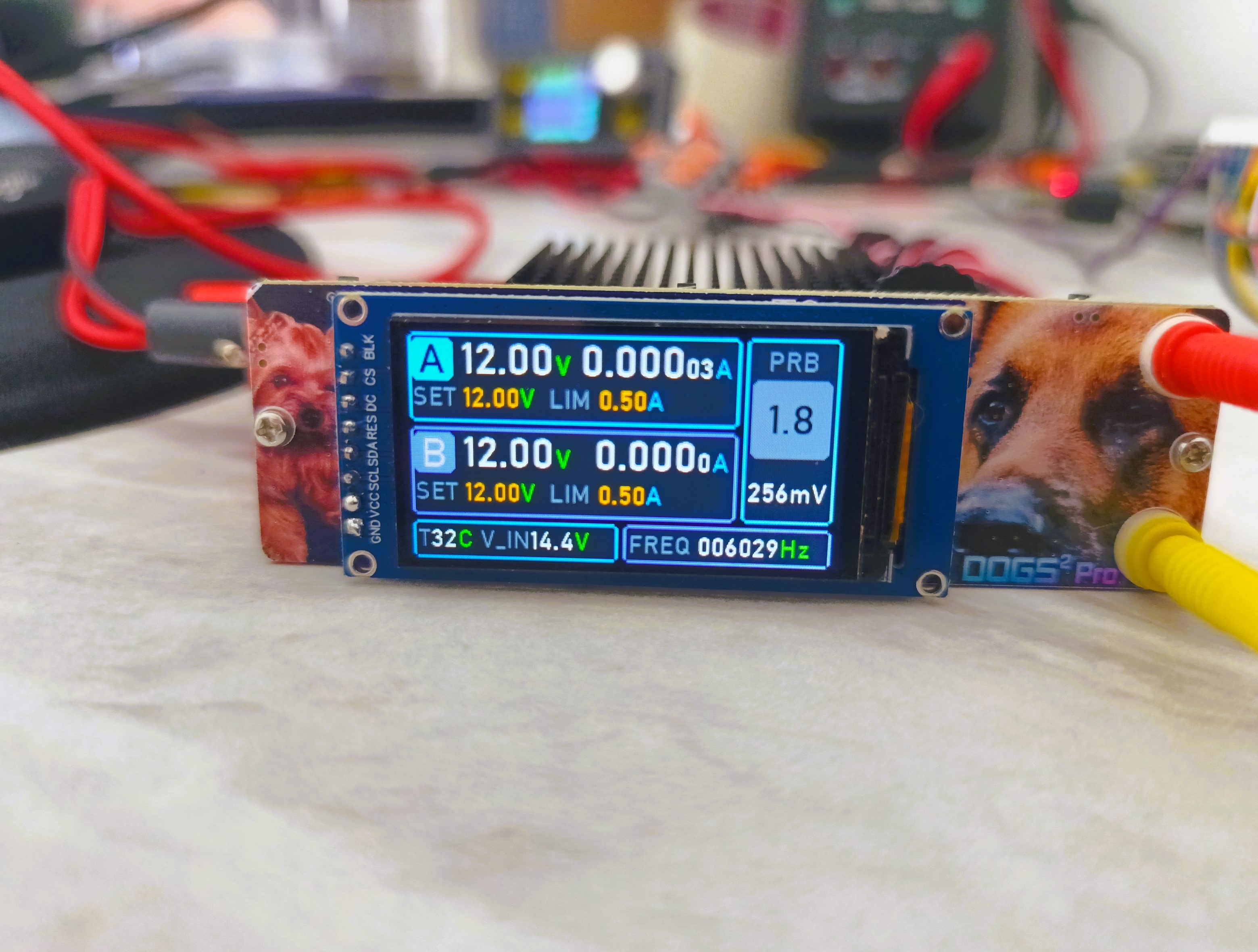

DOGS² working engineering prototype

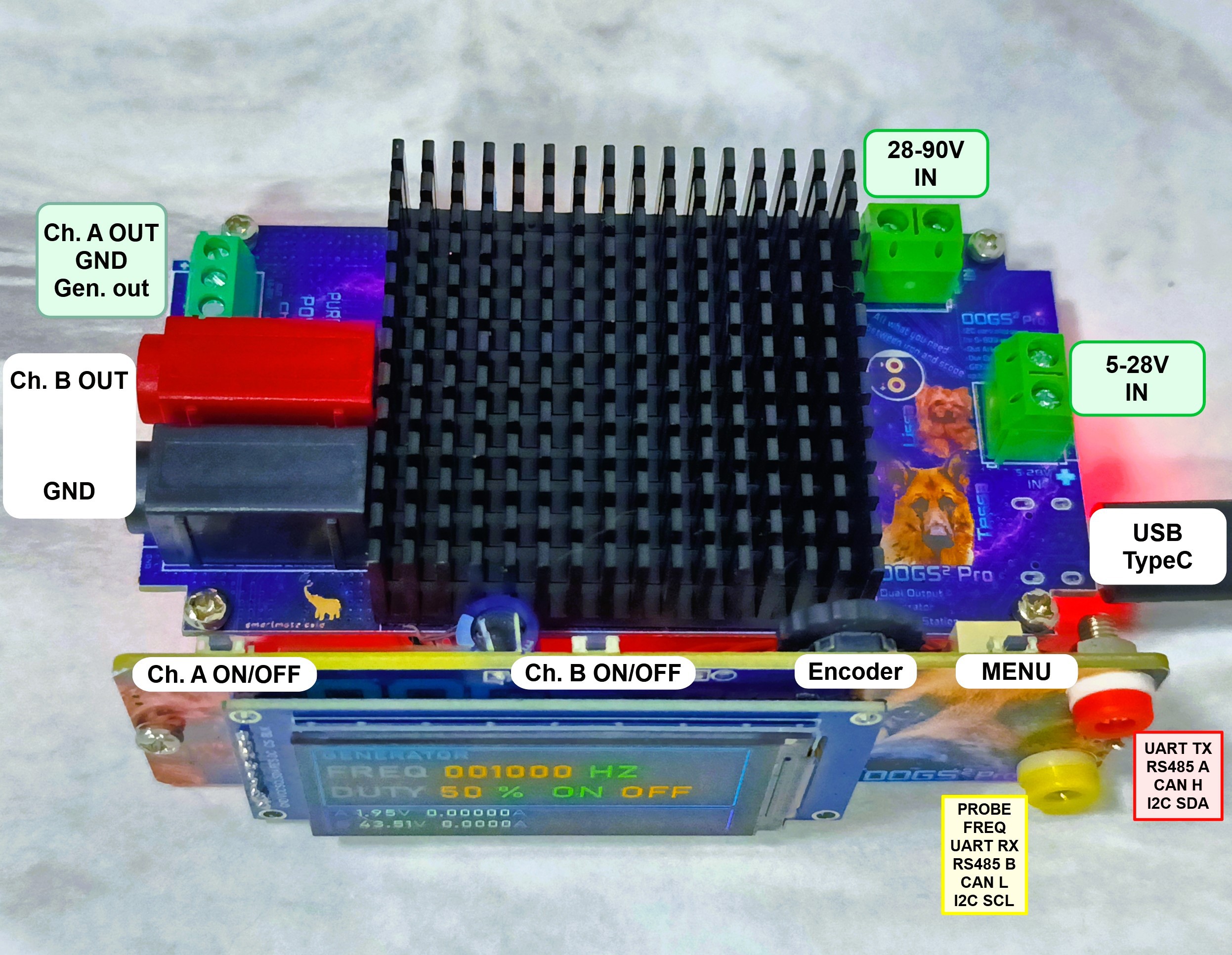

Two power channels
DOGS² has two independently adjustable CV/CC channels with a common ground.
SectionSpecifications
Channel ALow-noise linear regulation, up to 20 V / 1.5 A. Current-measurement LSB is 12.5 µA below 400 mA and 50 µA above 400 mA.
Channel BDC/DC conversion, up to 48 V / 3 A continuously or 5 A for short periods. Current-measurement LSB is 125 µA.
Input power5–90 V DC or USB Type-C, including power from car and motorcycle batteries. Protected against overvoltage, reverse polarity and inrush current.
Both channels measure output voltage and current.
Total power depends on the input source.
The outputs are not galvanically isolated.
The stated limits and accuracy apply to the v1 engineering version and are still being refined through calibration, converter tuning and load tests.
DOGS² connector pinout

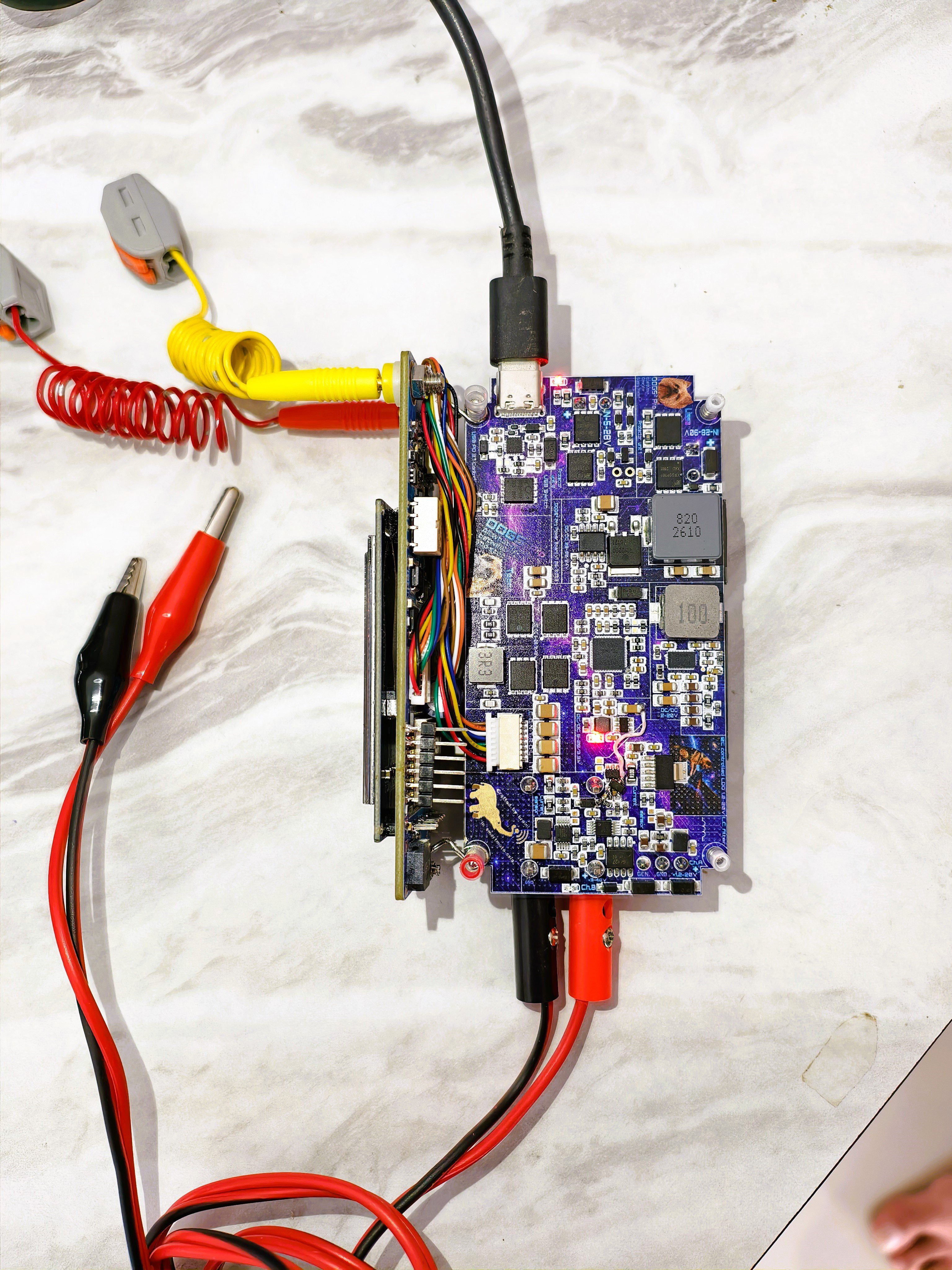

DOGS² assembled hardware, component side

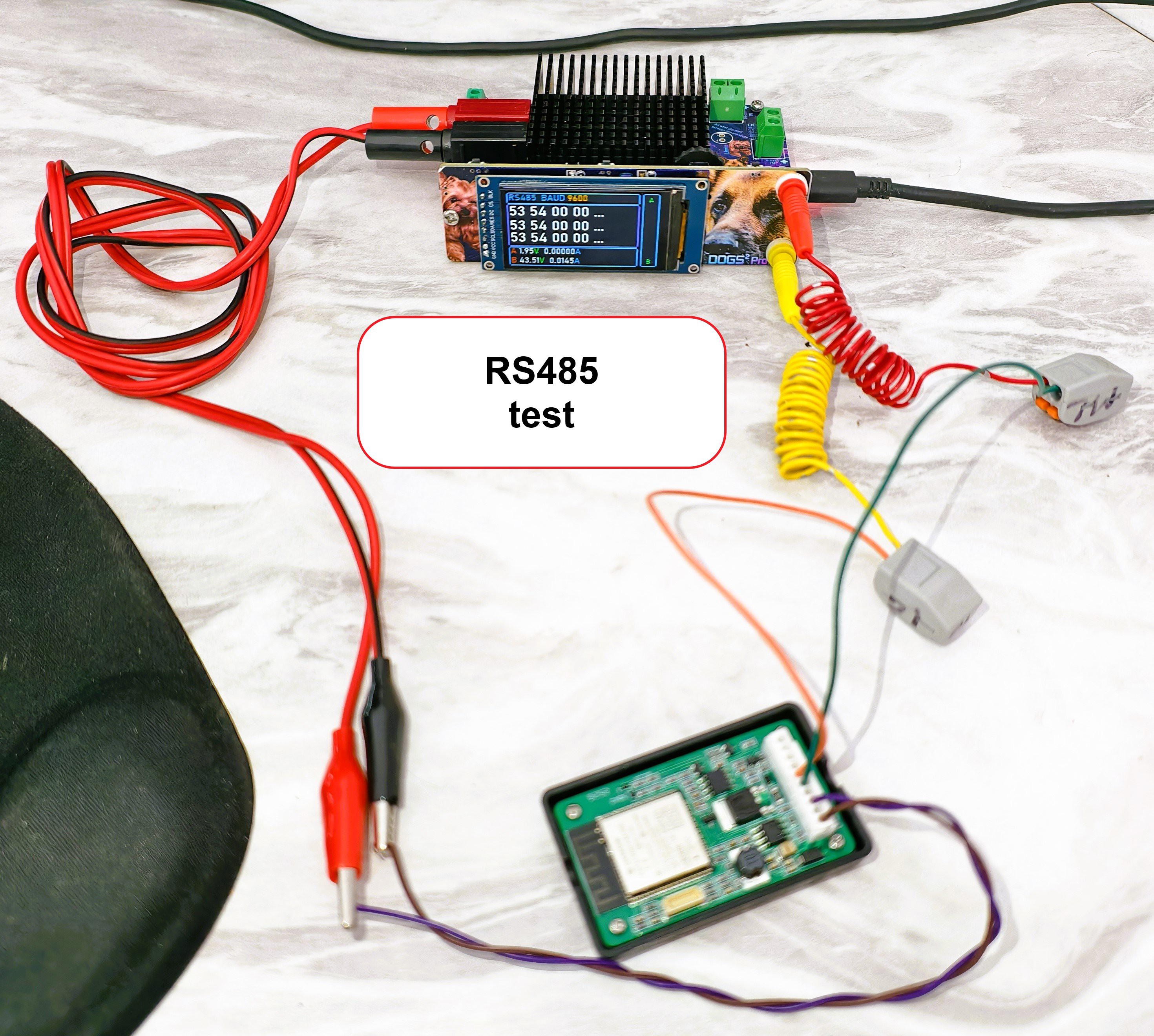

Digital interfaces and Bluetooth
InterfaceFunctionsParameters / status
UART / RS485Terminal2.4–115.2 kbit/s
LINSnifferTBD
CANTerminal: receive, filter and transmit11-bit ID, 125–1000 kbit/s, configurable mask
I2CTerminal, scan and snifferConfigurable address mask
1-WireDecoderTBD
Terminal and sniffer data use a simple text command protocol over Bluetooth SPP. Incoming data can be monitored on the display, but composing and transmitting packets is done from a phone terminal,  I currently use Serial Bluetooth Terminal Android app.
Current readings from both channels can be graphed in Bluetooth Graphics Android app, adjustable graph sweep speed is being implemented.
DOGS² RS485 terminal test

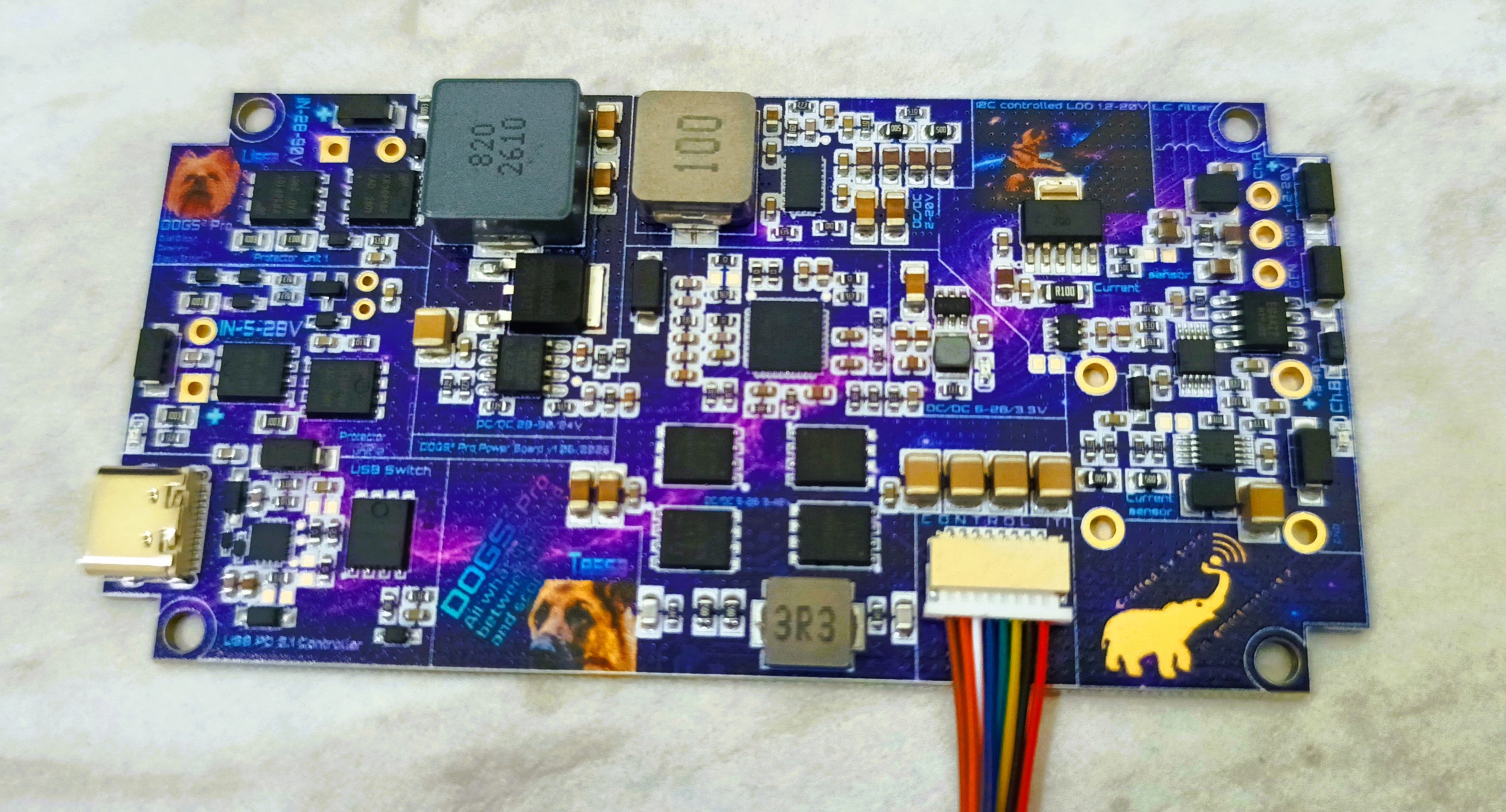

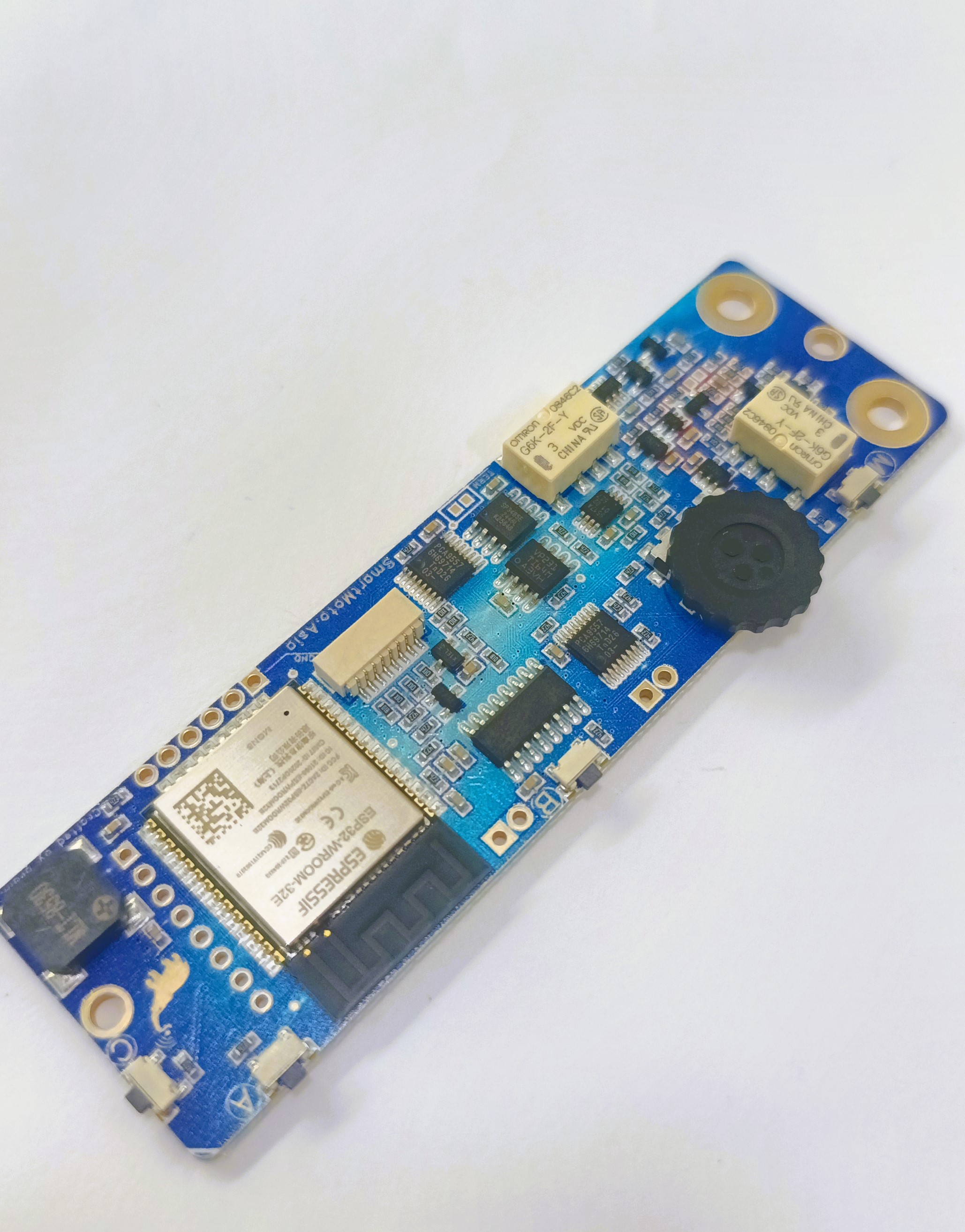

The instrument is divided into a power board and an ESP32-WROOM control panel. The former contains the protected inputs, converters, Channel A linear stage, measurements and generator power stage. The latter carries the display, controls, probe, counter and interface drivers.
DOGS² power board
DOGS² control panel, component side

     DOGS² v1 is working engineering hardware, and the current prototype runs the latest firmware. This is not a finished product yet, but most of the functions that define the instrument are already operational.
    DOGS² v1 working engineering prototype
    Working now
    • Channel A: low-noise linear output up to 20 V / 1.5 A, with a current-measurement LSB of 12.5 µA below 400 mA and 50 µA above 400 mA.
    • Channel B: switching output up to 48 V / 3 A continuously or 5 A for short periods, with a current-measurement LSB of 125 µA.
    • Logic probe and voltmeter with measurement up to 25 V.
    • Frequency counter up to 100 kHz.
    • Square-wave generator from 1 Hz to 100 kHz, with 1–99% duty cycle and an output of up to 20 V / 1 A through Channel A.
    • UART and RS485 terminals.
    • Reception, filtering and transmission of 11-bit CAN frames.
    • I2C master and passive I2C sniffer with address filtering.
    • Bluetooth SPP for phone terminals and current-consumption graphs.
    Still under development
    • LIN sniffer and 1-Wire decoder.
    • Adjustable sweep speed for the current graph.
    • Output-resistance estimation for the probe.
