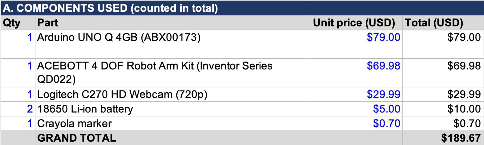

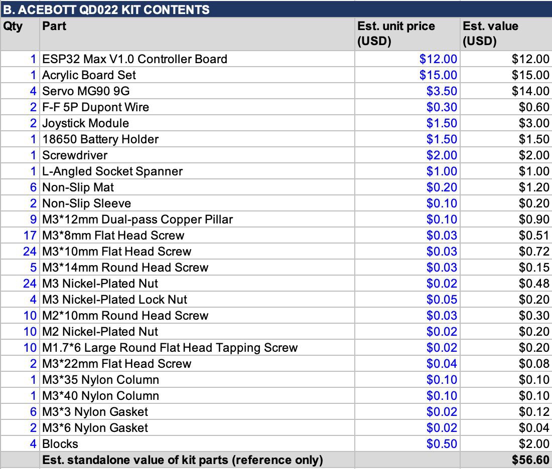

Bill of Materials
  • Prices are in USD and don't include shipping, customs or import fees, which vary by location.
  • The hackathon organisers provided all of the components except the USB-C to USB-C cable, which we brought ourselves.
  • The ACEBOTT kit is priced as a single item. The individual prices for its parts are rough estimates for reference and aren't added to the total.
  • 1 × ESP32 Max V1.0 Controller Board Comes as part of the ACEBOTT 4 DOF Robot Arm Kit (Inventor Series QD022)
  • 1 × Acrylic Board Set Comes as part of the ACEBOTT 4 DOF Robot Arm Kit (Inventor Series QD022)
  • 4 × Servo MG90 9G Comes as part of the ACEBOTT 4 DOF Robot Arm Kit (Inventor Series QD022)
  • 2 × F-F 5P Dupont Wire Comes as part of the ACEBOTT 4 DOF Robot Arm Kit (Inventor Series QD022)
  • 2 × Joystick Module Comes as part of the ACEBOTT 4 DOF Robot Arm Kit (Inventor Series QD022)

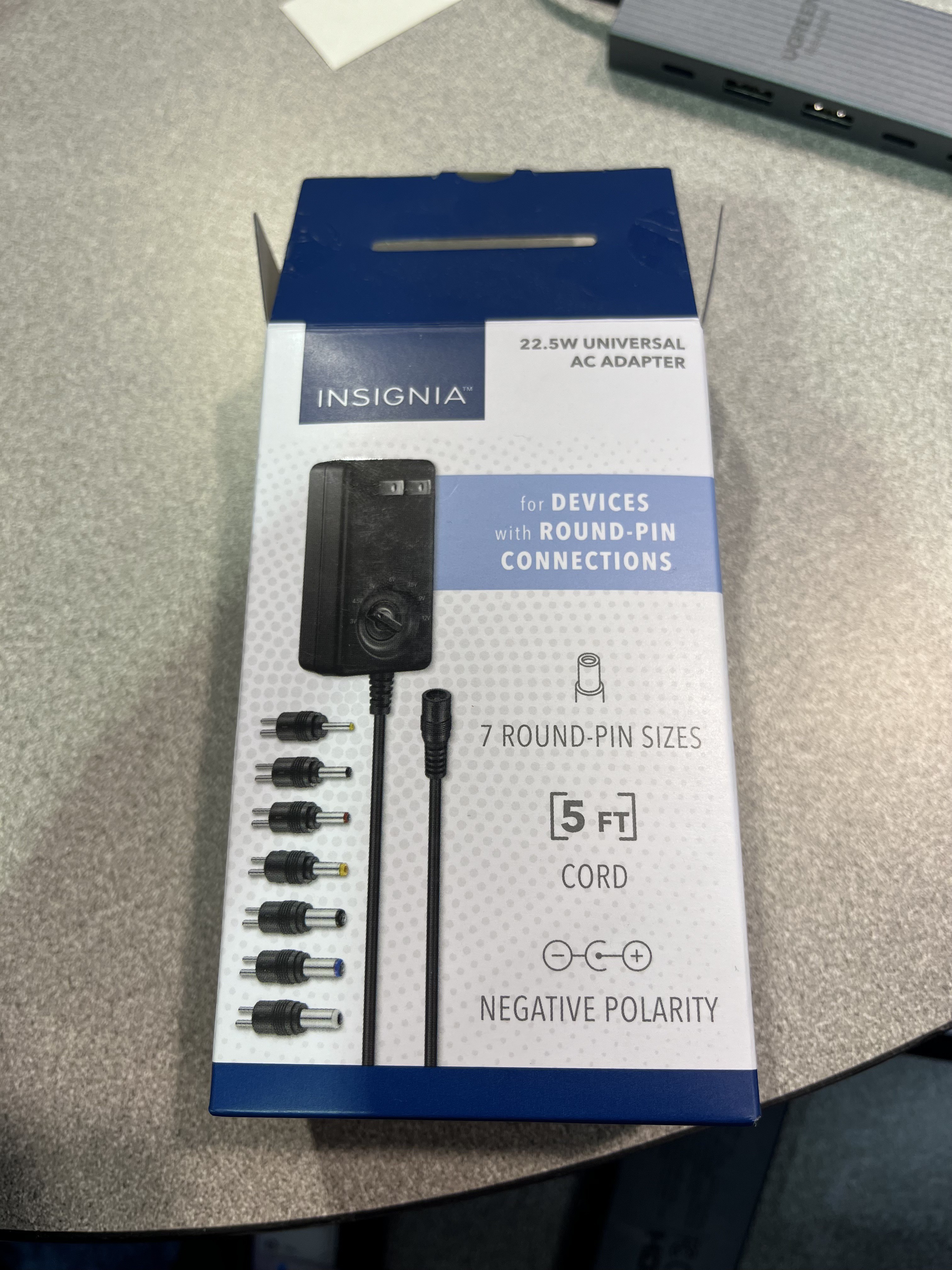

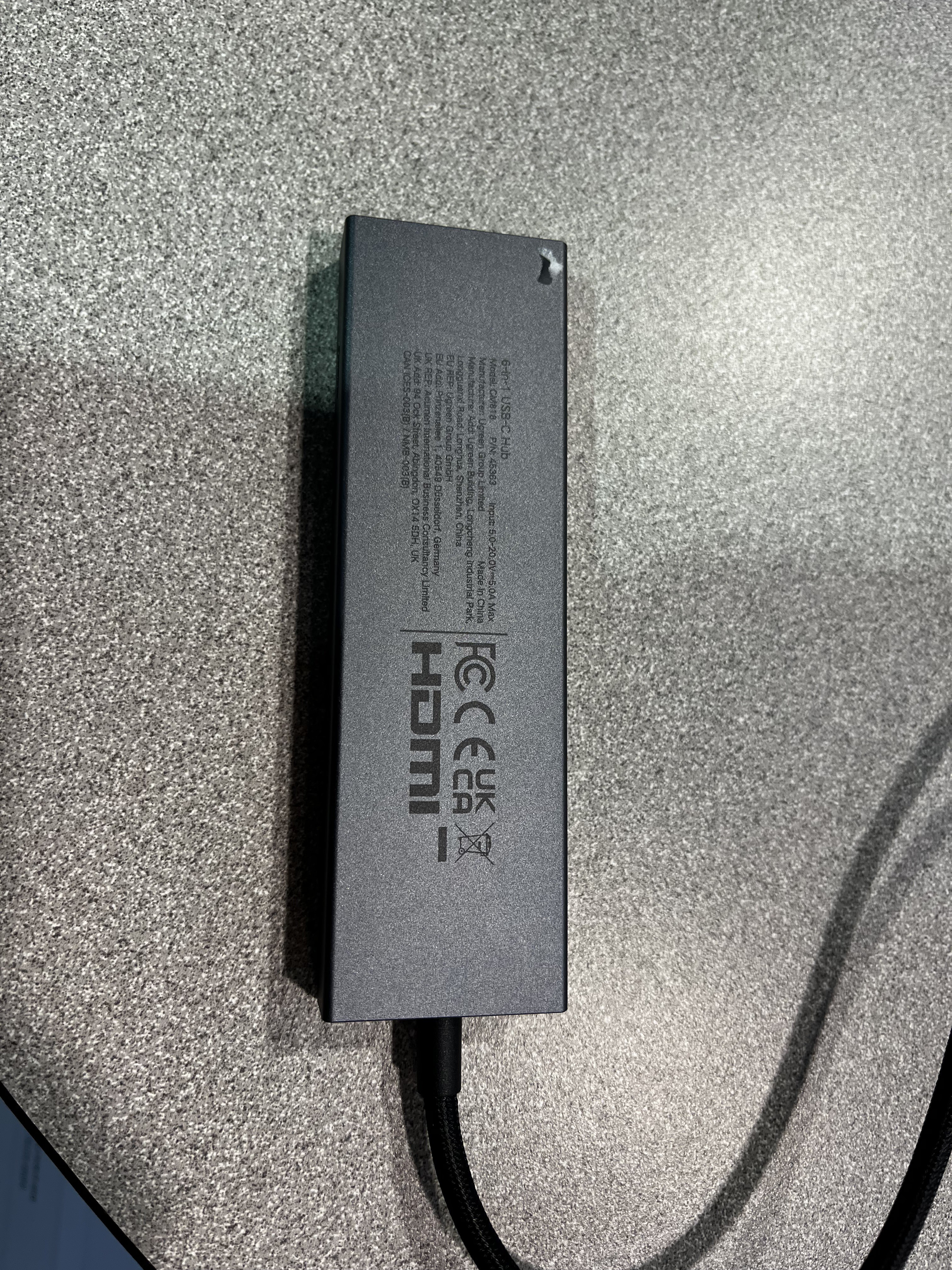

    Early this morning, on the second and final day of the hackathon, the organisers brought us the AC power adapter and USB-C hub, and it made a huge difference. The organisers have been helpful and resourceful the whole way through. Whenever we asked for something, they stepped in right away to help us find a solution.
    We needed the AC adapter because the 18650 batteries couldn't hold their charge long enough for what our arm needs. Four servo motors moving together draw a lot of power, especially when the arm is lifting, reaching and gripping at the same time. Batteries work well for small tinkering tasks, but a project this demanding needs a steady, reliable supply. With the adapter plugged in, the arm now runs consistently, without the jitter and slowdowns we'd been seeing as the batteries drained.
    Getting here took a lot of tinkering and troubleshooting, but that's what building something complex is like. Every small roadblock we cleared felt like a big win, and when the arm finally moved smoothly on steady power, the whole team felt the rush. It's the kind of moment that reminds you why you love building things!
    AC Adapter (you need to select the round pin size depending on the ESP32 Port)
    USB-C Hub for the Arduino Uno Q

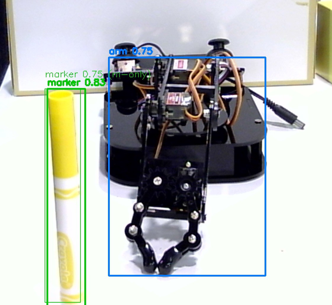

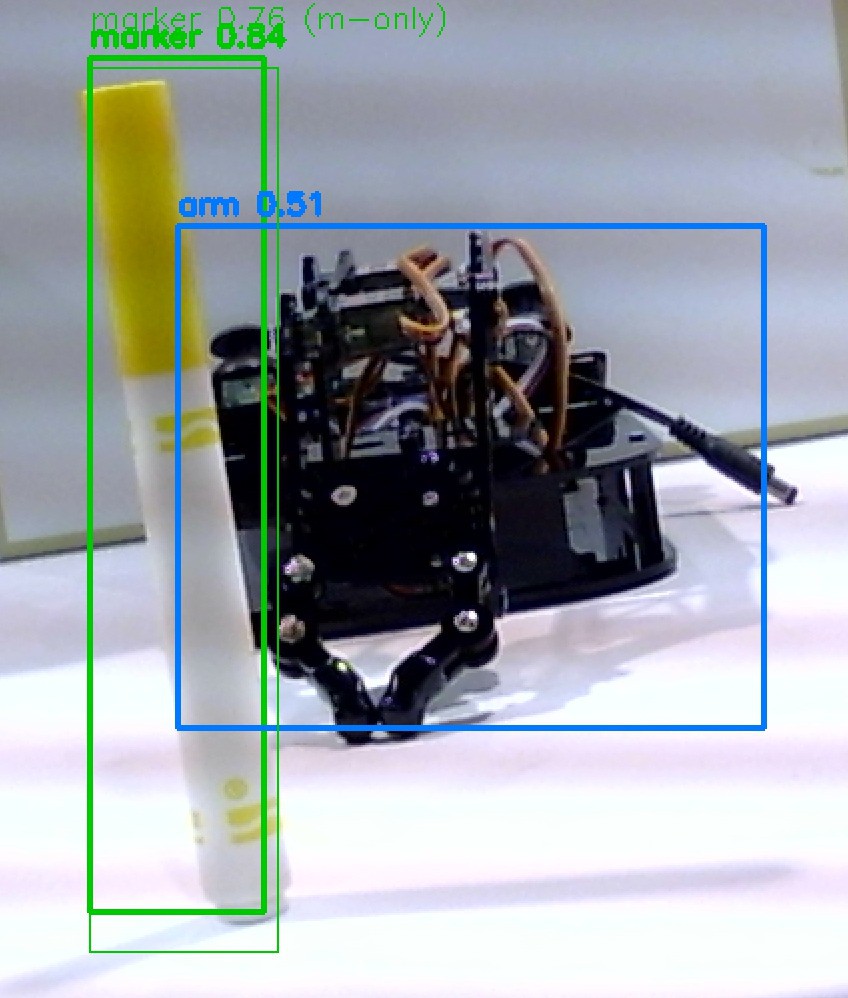

    A detection model can only be as accurate as the data it learns from, so we labelled our training images ourselves. We hand-labelled more than 750 images, drawing a bounding box around each object in every frame. It took our team about 2–3 hours of careful, repetitive work, but hand-labelling meant every box sat tightly around its object. That precision is what the model needs to learn exactly where the marker is.
    The model now detects the marker in real time and gives a confidence score for each detection, showing how sure it is that the object is a marker. It picks out the Crayola marker reliably from both a front and a side angle. It also recognises the robot arm itself, so the system can tell the marker apart from the arm reaching for it. We also compared these results with a marker-only model (the thin "m-only" boxes).
    The marker is detected with 0.84 confidence and the arm with 0.51. The marker-only model finds the marker at 0.76.
    The marker is detected with 0.83 confidence and the arm with 0.75. The marker-only model finds the marker at 0.75.

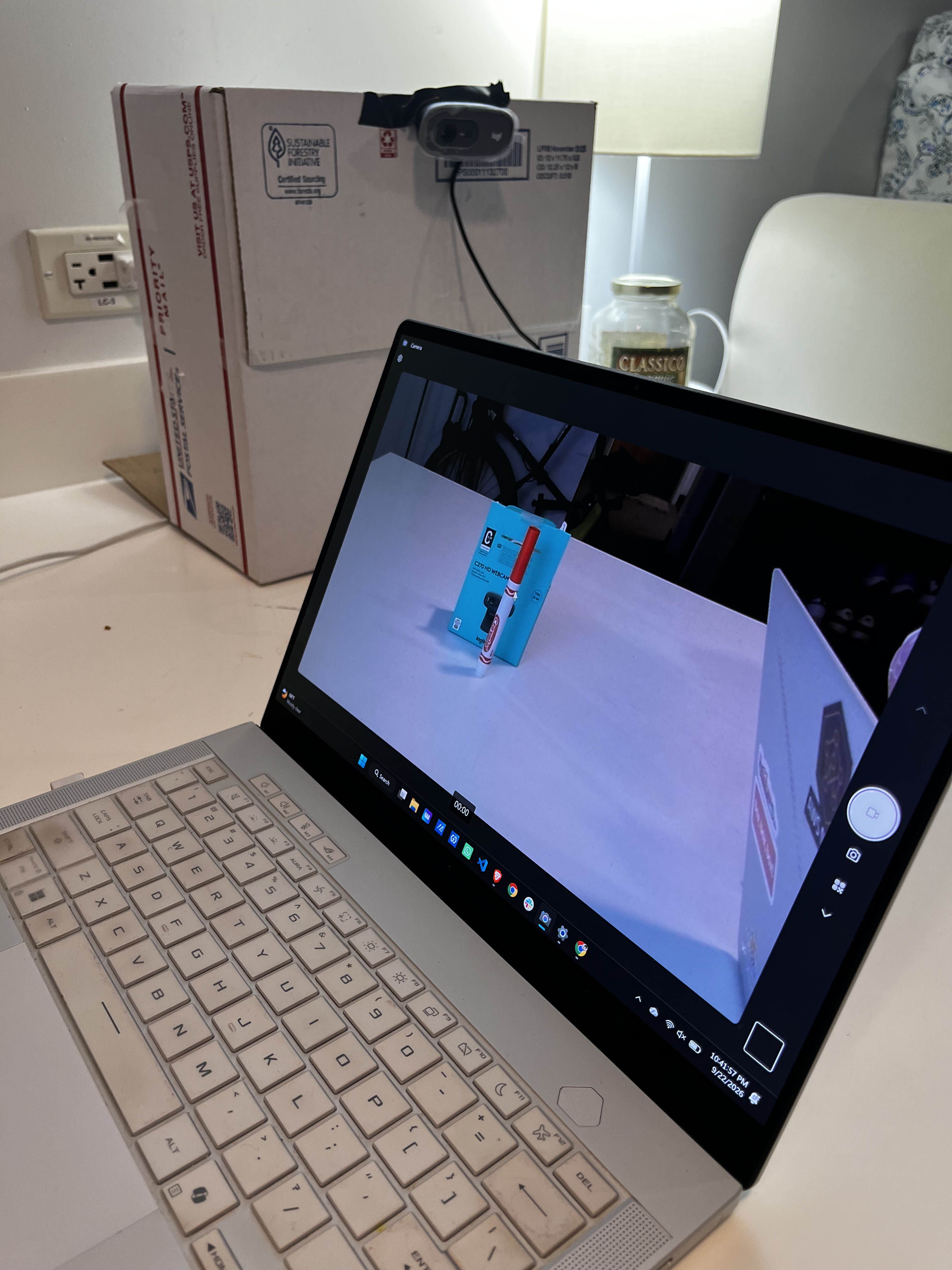

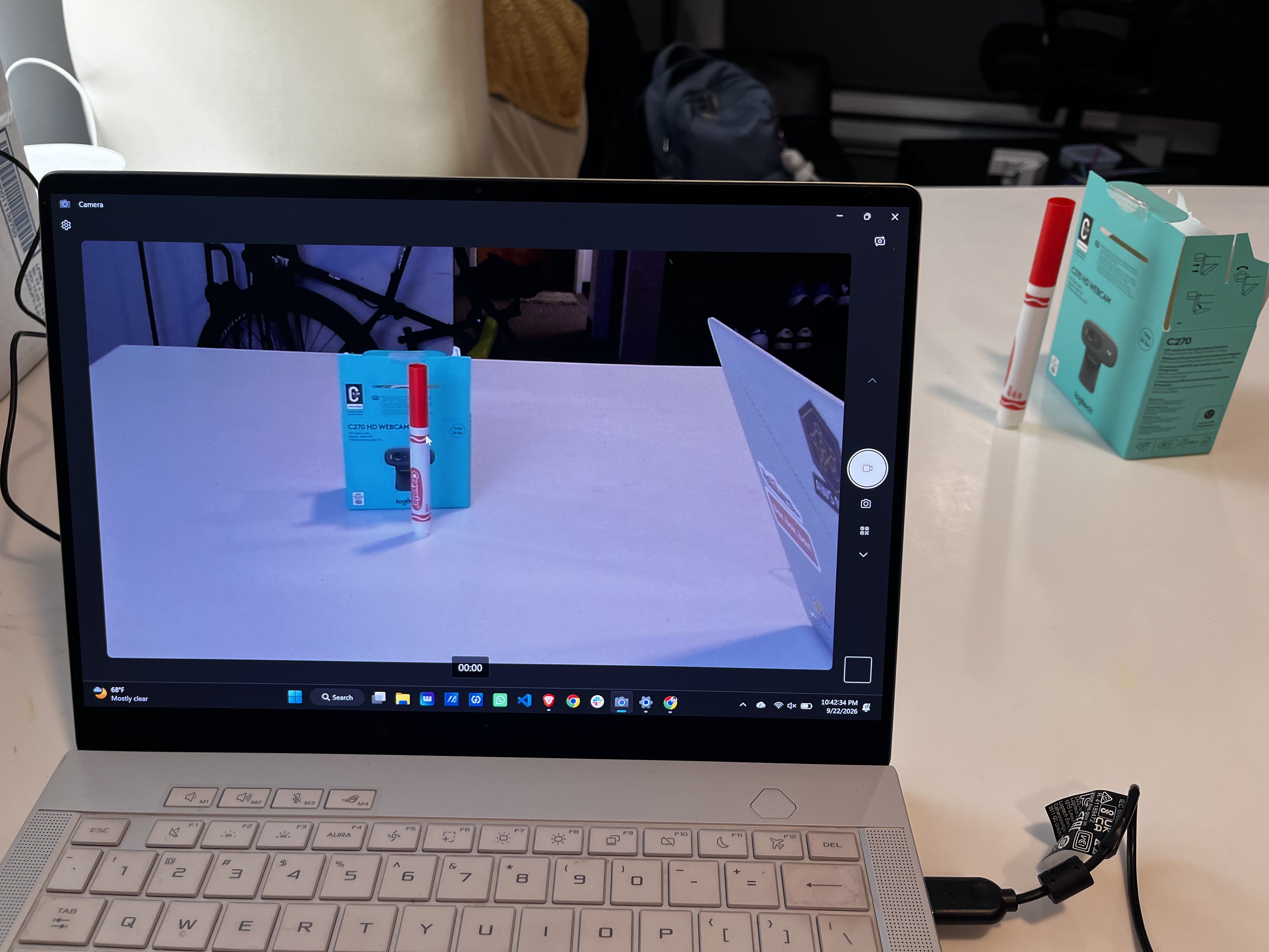

    With the arm assembled, our next job was giving it eyes. We set up the Logitech C270 webcam, taped to a cardboard box as a quick mount, and tested it on a laptop to check the view before moving everything onto the Arduino UNO Q. Our test scene was a white surface with our red Crayola marker standing upright and the webcam's own box as a stand-in obstacle.
    Our quick camera mount: the C270 webcam taped to a cardboard box to hold it steady while we collect training images.
    Live feed from the C270 during testing: the red Crayola marker stands upright, with the webcam's box as a stand-in obstacle.

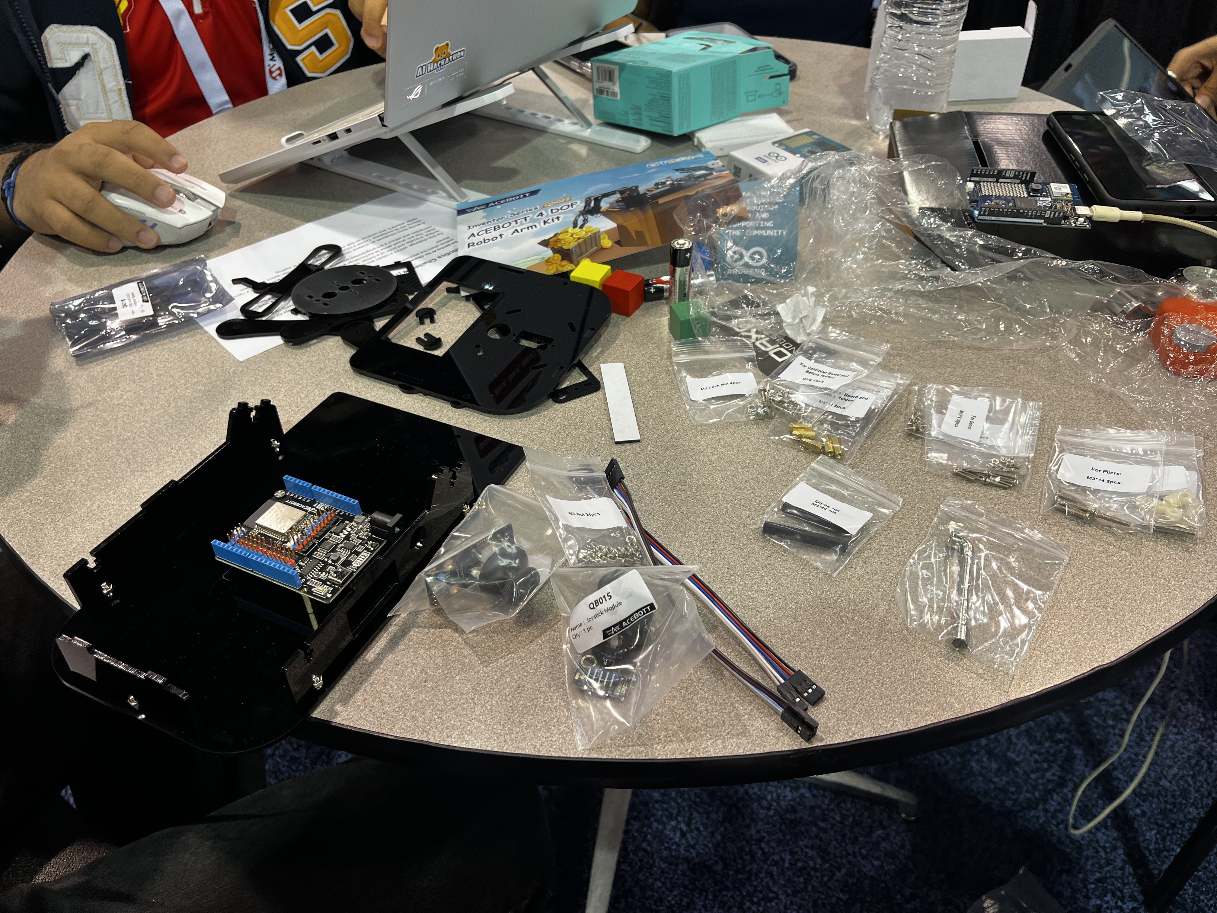

    All the parts of the robotic arm to be assembled.

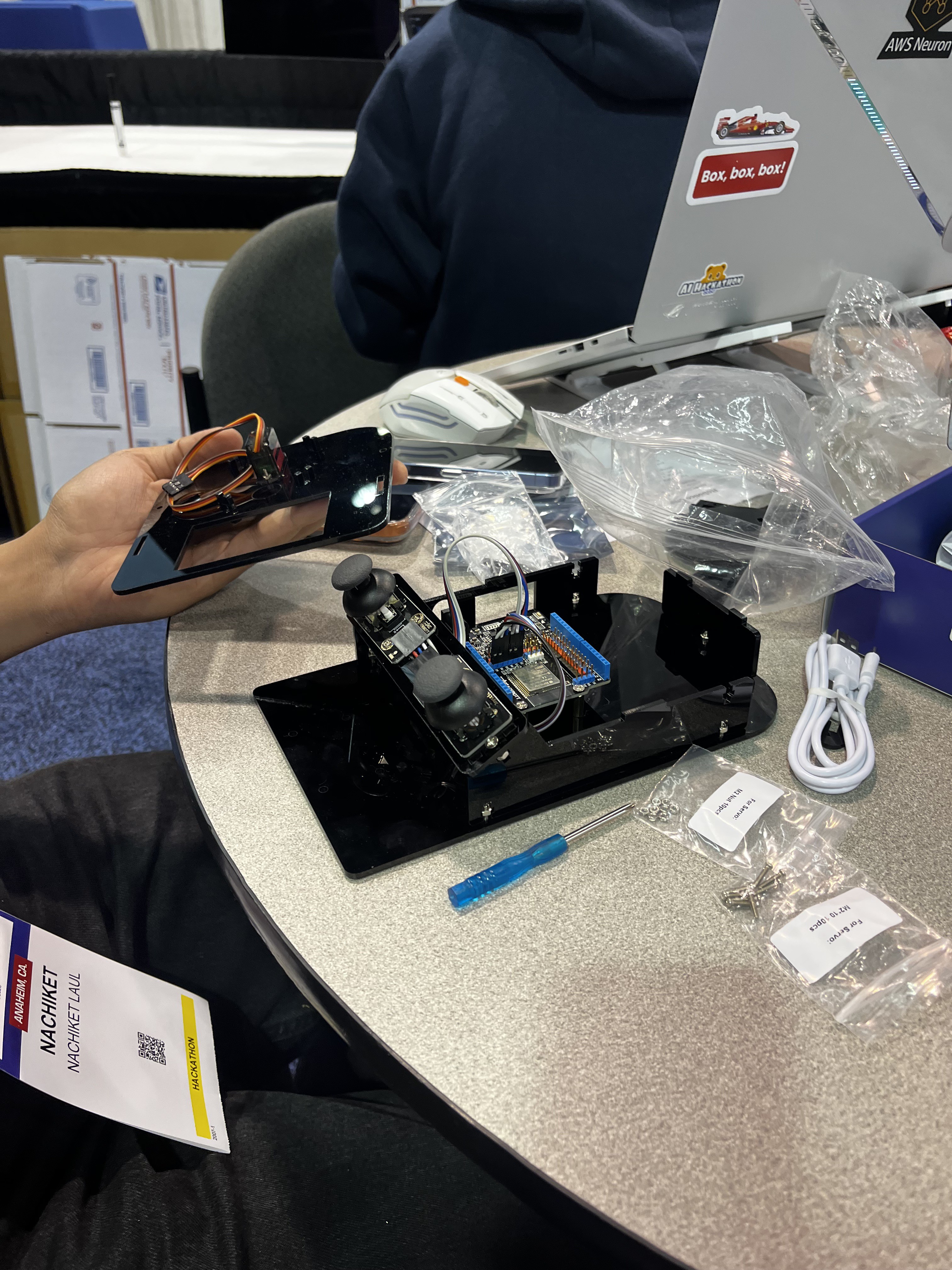

    While the space was a little cramped up, we tried to lay out all of our components and assembled everything together while our other team members tried to figure out how to best make use of the Arduino Uno Q's AI capabilities for object detection and subsequent obstacle avoidance.

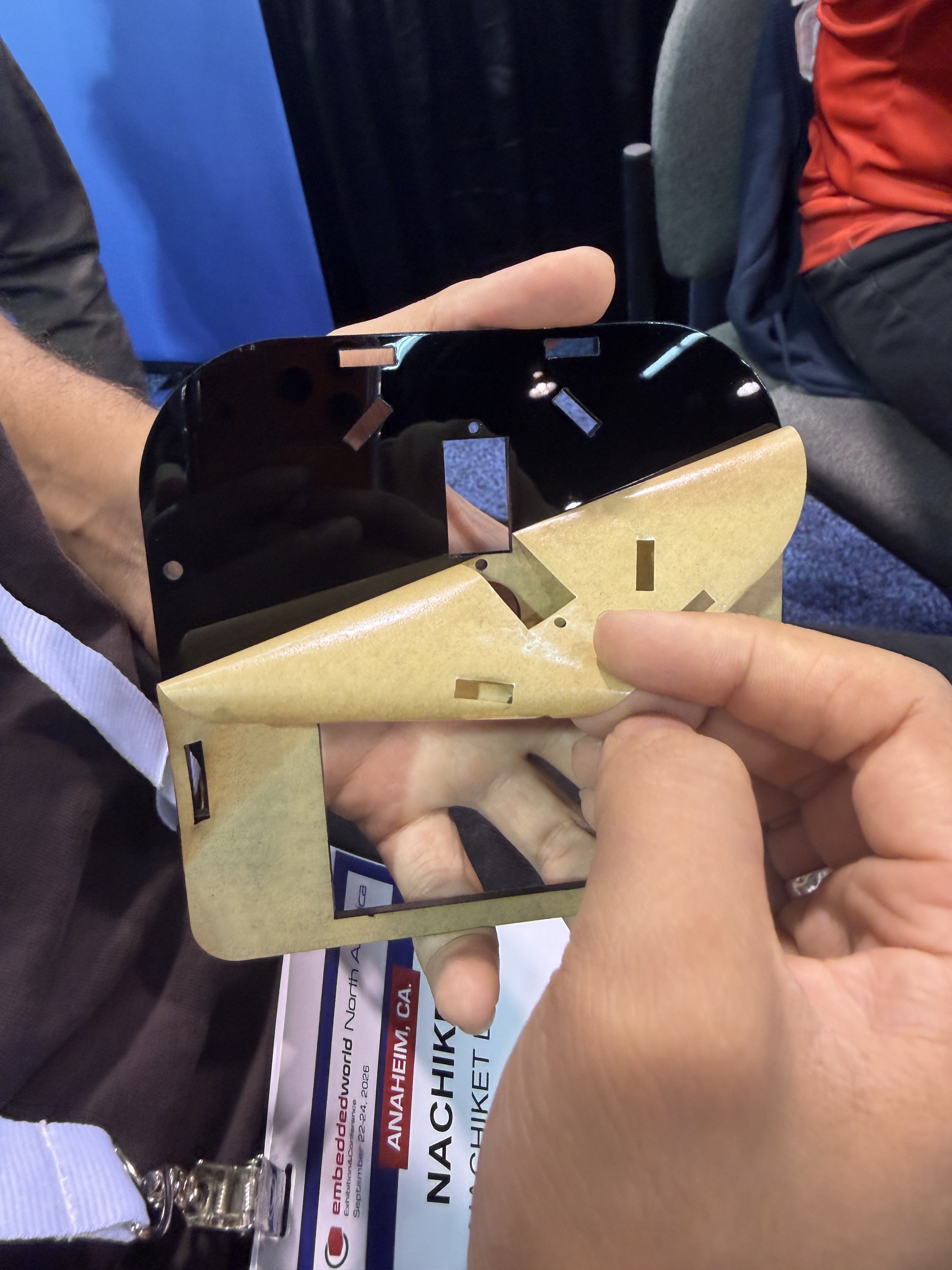

    We meticulously peeled out the protective covering for all the parts of the arm.
    Putting all the wires together! Making sure we connect the right colored wires to their designated pins both on the components as well as the ESP32.
    We tested the servo motors one by one, as it was mentioned in the documentation, to check each one before assembling it onto the robotic arm structure, we made sure they were initialised at the proper position so that any further steps or any untoward movement wouldn't cause any wear or damage to the motors.

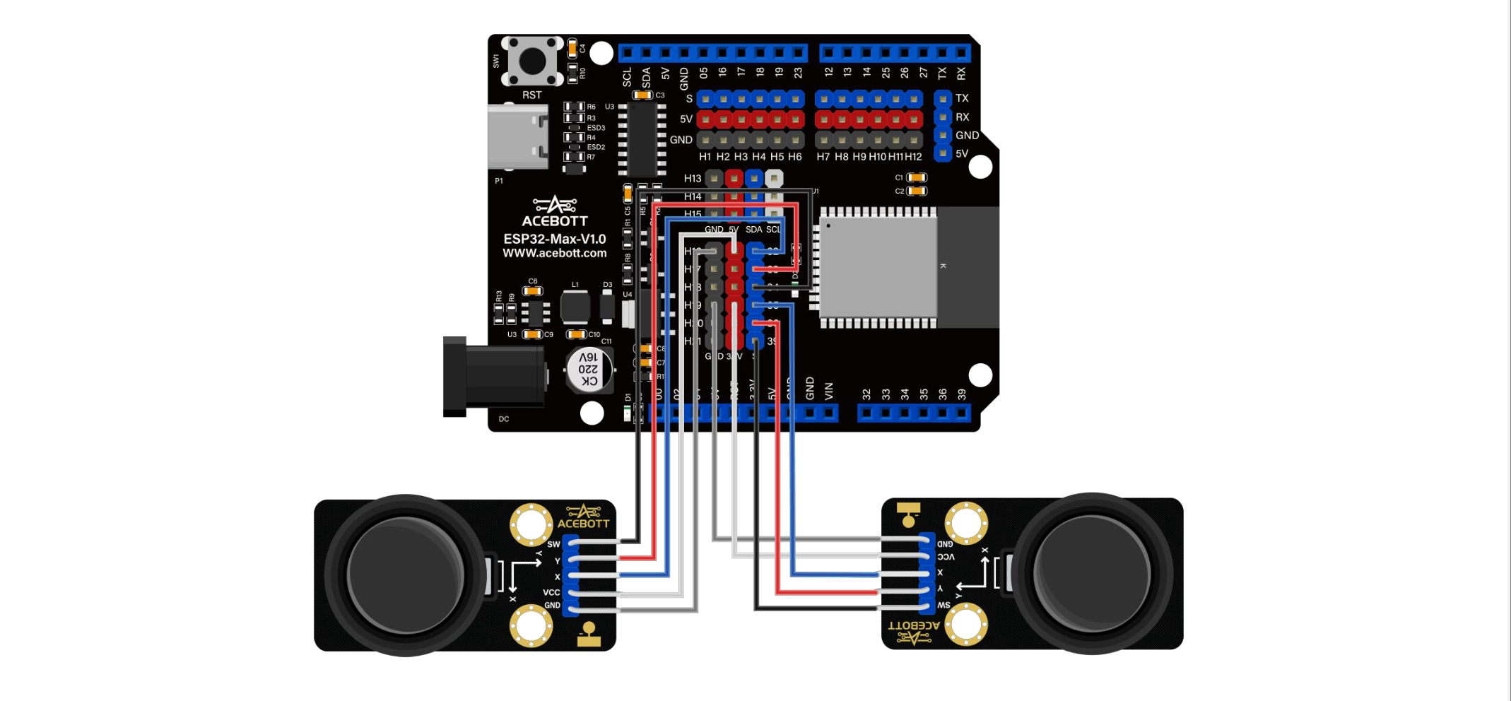

    For initial prototyping, we attached the joysticks as well so that we could test how well the robotic arm was able to move around.
    These were the wiring we followed for the joysticks accessories.

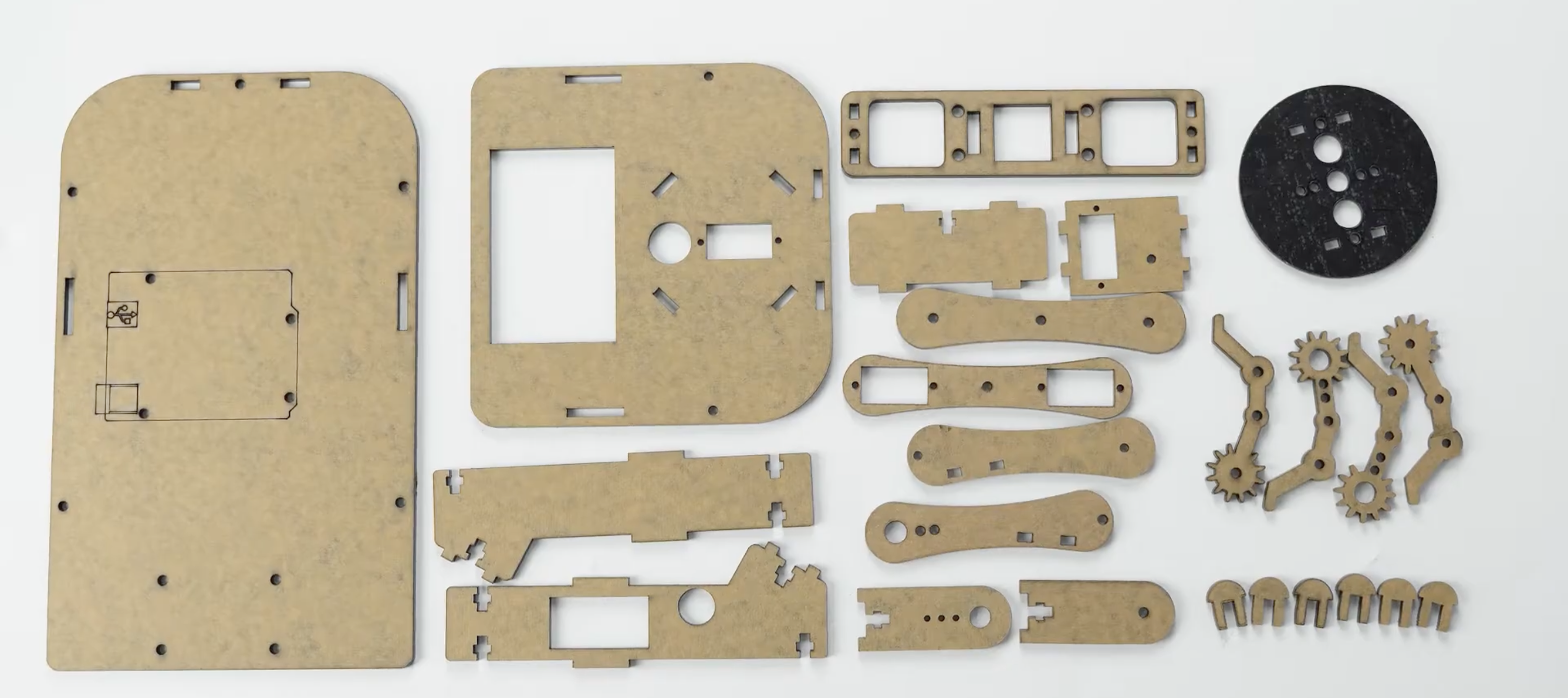

    Before we could teach the arm to see, trace or dodge anything, we had to build it. The ACEBOTT QD022 kit arrives as a bag of laser-cut acrylic panels, four MG90 servos and a lot of small screws and nuts. A big chunk of our first day was spent on turning the components from that kit into a working arm.
    What we followed
    We used ACEBOTT's official assembly tutorial for the QD022.
     It's beginner-friendly with each step showing exactly which panel and which screws to use. If you're building one yourself, we'd recommend following it step by step.

    • Set the servos to their centre position before attaching the servo horns. If you skip it, a joint can end up at the edge of its range and won't be able to move fully one way.
    • Don't overtighten screws into the acrylic since it cracks easily. Tighten until snug, then stop.
    • Peel off the protective film on the acrylic panels before assembling. It's much harder to remove afterwards.

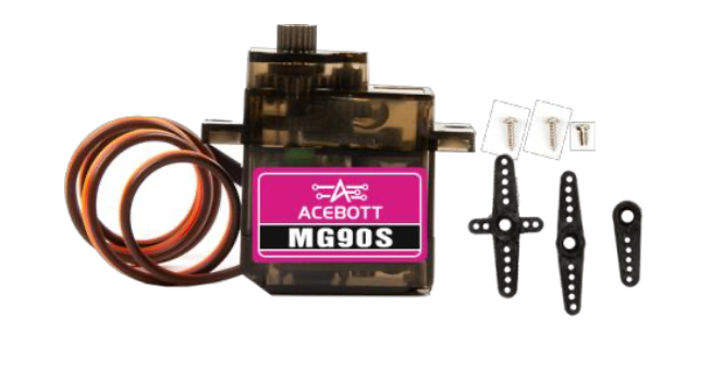

    The ACEBOTT QD022 arm moves with four MG90 servo motors, one at each joint. A servo is a small motor that turns to a precise angle (0°-180°) when it receives a control signal, which is what lets the arm move to exact positions. Together, the four joints let the arm reach, lower, trace and grip.
    How to connect and test the servos
    1. Plug each servo cable into its matching pin header on the ESP32 board, following the table above. The brown/black wire goes to GND, red to power, and orange/yellow to the signal pin.
    2. Install the ESP32Servo library in the Arduino IDE (Library Manager → search "ESP32Servo").

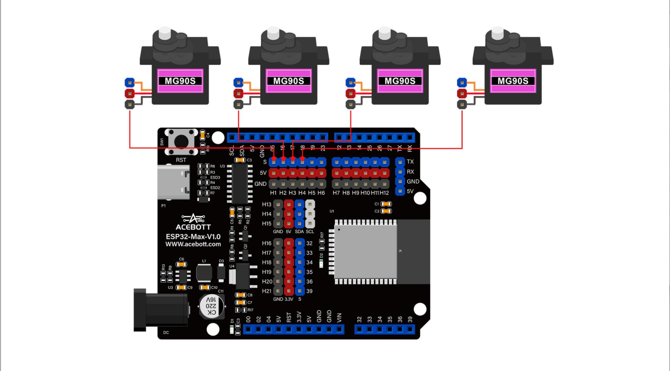

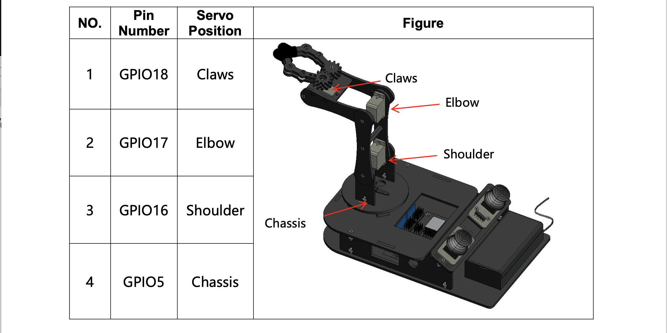

    Wiring and Pin Connections
    It is important to note which pins to connect the wires coming out of the servos to.

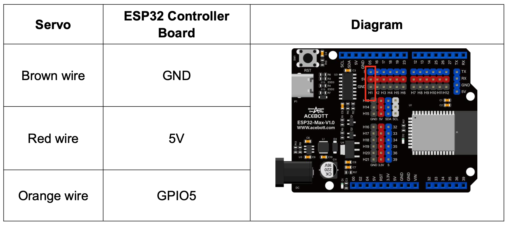

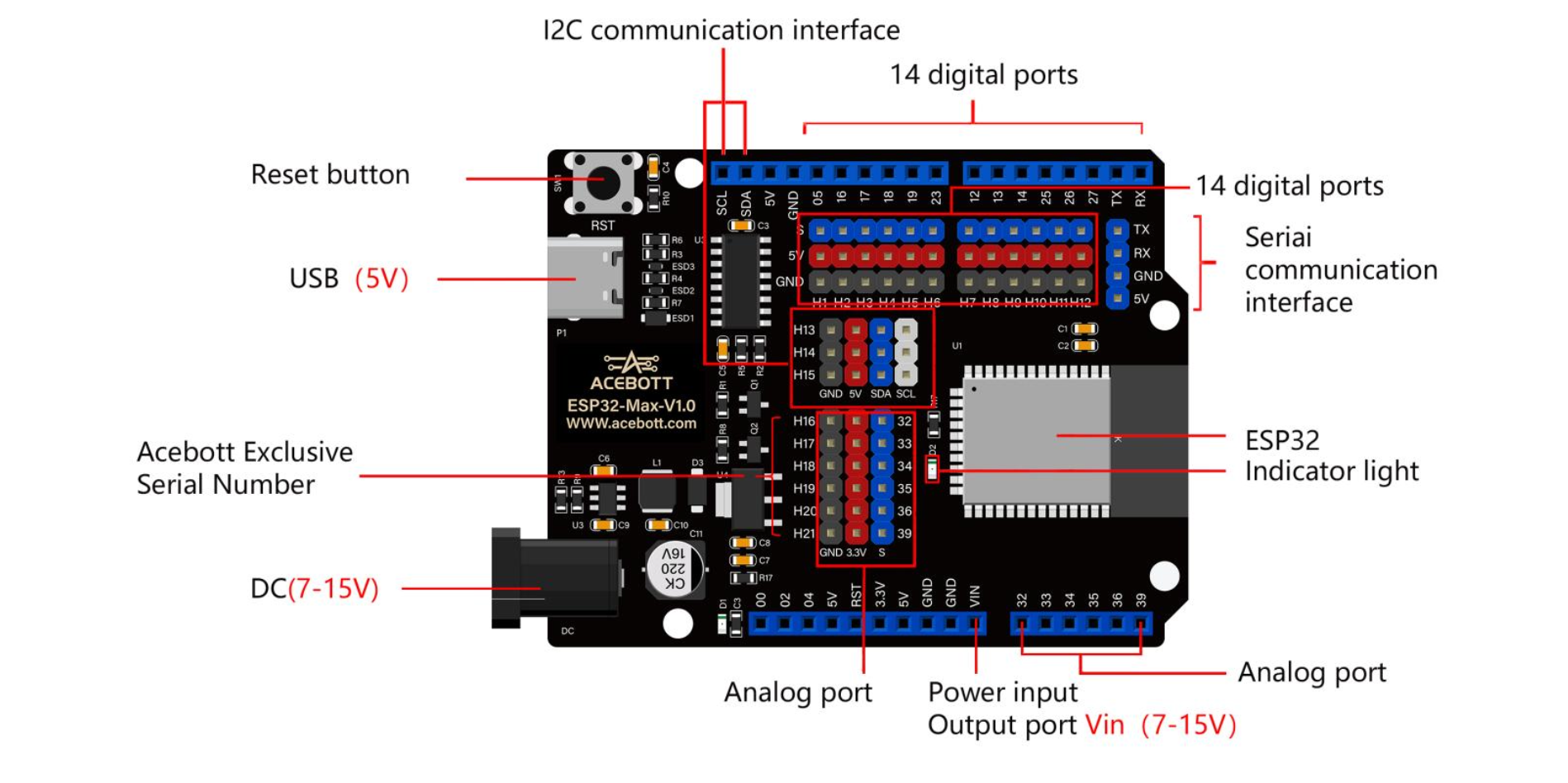

    Below is the ESP32 Max V1.0, the controller board that comes with the ACEBOTT kit and drives our arm's servos. The rows of pin headers along the top edge are where the servos plug in. Each column has a signal pin (blue), a 5V pin (red) and a GND pin (black), with its GPIO number printed above. The board can be powered through its USB-C port (5V) or the DC jack (7–15V), and the serial pins on the right (TX/RX) are how it can talk to other boards like the Arduino UNO Q.
    Each servo has three wires: brown goes to GND, red to 5V, and orange to the signal pin. This example shows the chassis (base) servo plugged into GPIO5. Connect the other servos the same way: shoulder to GPIO16, elbow to GPIO17 and claw to GPIO18. Make sure the brown wire always faces the black GND row, because a servo plugged in backwards won't move.
    This diagram shows all four MG90S servos connected to the ESP32 Max board at once. Each servo plugs into its own three-pin header in the first four columns of the top row (H1–H4), which match GPIO5, GPIO16, GPIO17 and GPIO18: the chassis, shoulder, elbow and claw. Every header supplies power (5V) and ground (GND) alongside the signal pin, so each servo needs just one plug and no extra wiring. Once all four are connected, the ESP32 can control every joint of the arm on its own, taking movement commands from the Arduino UNO Q.
