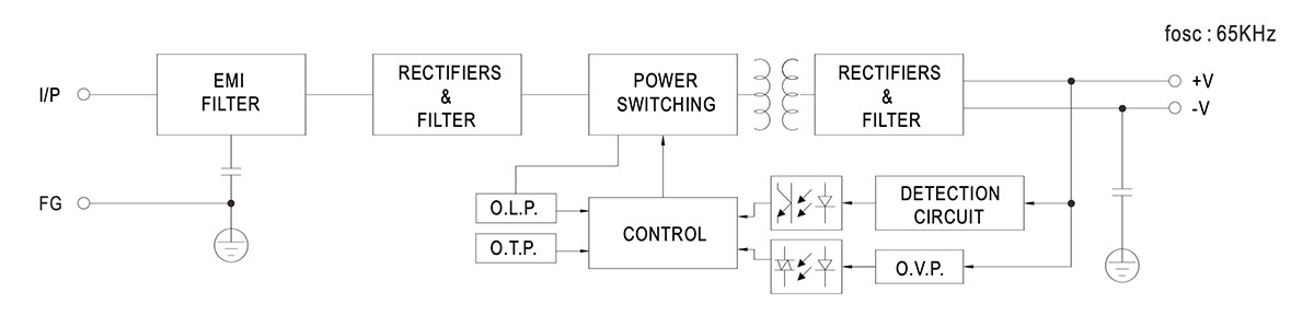

LRS-75-24 is a 24-volt power supply with a maximum current of 3.2 amperes. According to the manufacturer, the unit operates at a mains voltage of 100 to 240 volts without an additional switch. It has no PFC function. The supply measures approximately 4 × 4 × 1 1/5 inches (99 × 97 × 30 millimeters) and is made on a printed circuit board fixed to the base of the metal case. The top cover is perforated, and the holes are meant for passive cooling.
The input and output circuits are connected to a common screw block (1). From right to left, there are 3 terminals for the input line, neutral, and ground wires, and terminals 4 and 5 are the outputs: ground and +24V.
The input voltage goes to the fuse and inrush current limiter (2), then to the RF interference filter (3), and finally, to the diode bridge (4). The inrush current limiter has no markings; apparently, it is just an NTC. The rectified mains voltage is supplied to the 150 uF, 400V capacitor (5) and then to the flyback converter built on an MW03A controller (located on the back side of the PCB), a TK750A60F transistor (6), and a transformer (7).
The voltage from the secondary winding of the transformer is rectified by a Schottky diode HBR20150 (8) and supplied to storage capacitors 2×470uF 35V, and, through an additional LC filter (10) (11), goes to the output.
The feedback circuit is classic; with TL431 (on the other side of the board), the feedback signal is transmitted to the PWM controller through one of the optocouplers (12); the second optocoupler forms a backup channel for overvoltage protection at the OVP output. The installed electrolytic capacitors are designed for operating temperatures up to 220F (105C). The bulkiest of them, the input one, is held on the board with compound.Build quality is good.
The power transistor (6) and diode (8) are pushed against the metal case using spring brackets to dissipate heat. Their own housings are insulated using special shells.

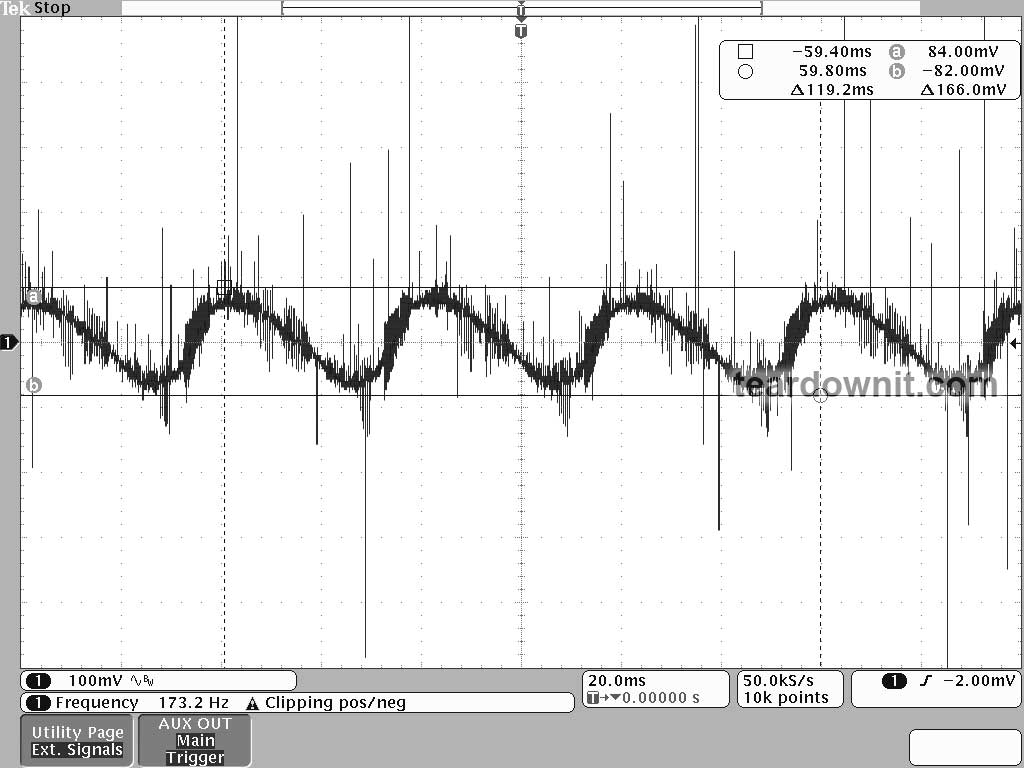

The following values were used to determine the load level:Output voltage under a constant load
It should be noted that there is a slight overshoot; increasing the load slightly increases the output voltage. Power-on parameters Powering on at 100% load Before testing, the power supply is turned off for at least 5 minutes with a 100% load connected.The oscillogram of switching to a 100% load is shown below (channel 1 is the output voltage, and channel 2 is the current consumption from the grid):

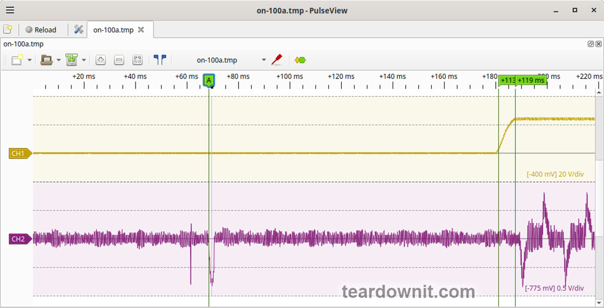

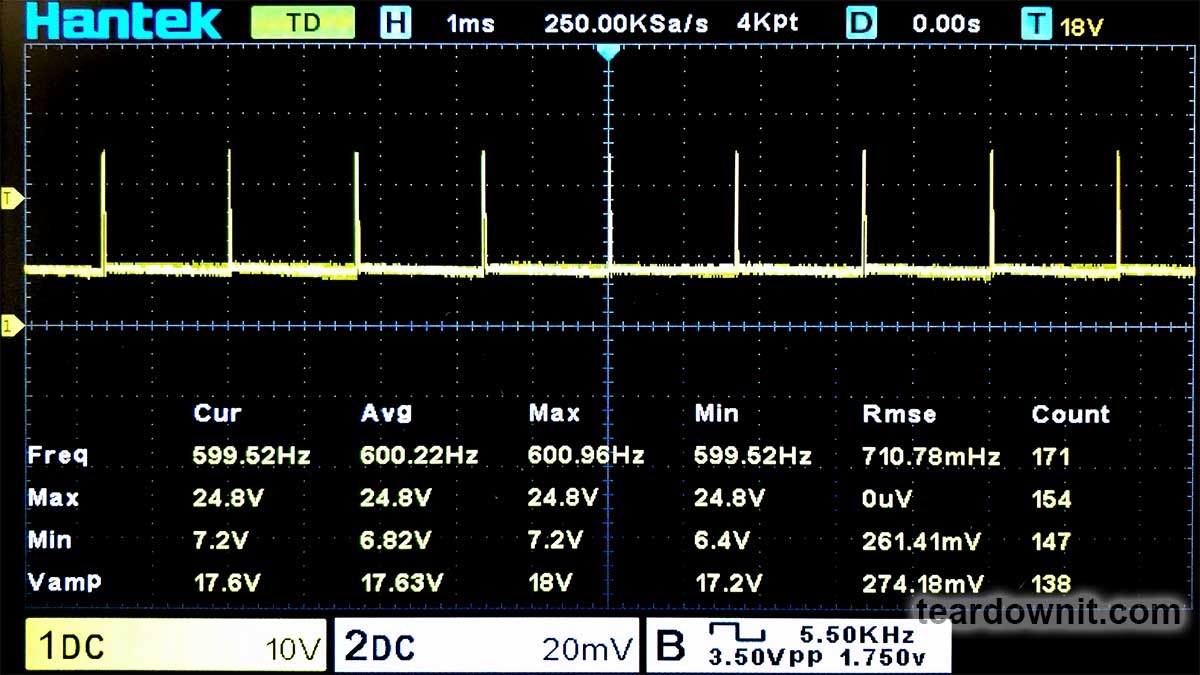

The picture shows three distinguishable phases of the power-on process:
- When connected to the grid, the pulse of the input current charging the input capacitors has an amplitude of about 7 A and a duration of about 5 ms.
- Waiting for the power supply control circuit to start for about 88 ms.
- (Output Voltage Rise Time) Output voltage rise takes 7 ms.
(Turn On Delay Time) The entire process of entering the operating mode from the moment of powering on is 95 ms.
(Output Voltage Overshoot) The switching process is aperiodic; there is no overshoot.

The oscillogram of switching to a 0% load is shown below:The picture shows three distinguishable phases of the power-on process:
- When connected to the grid, the pulse of the input current charging the input capacitors has an amplitude of about 5.7 A and a duration of 6 ms.
- Waiting for the power supply control circuit to start for about 117 ms.
- (Output Voltage Rise Time) Starting the converter, increasing the output voltage,...

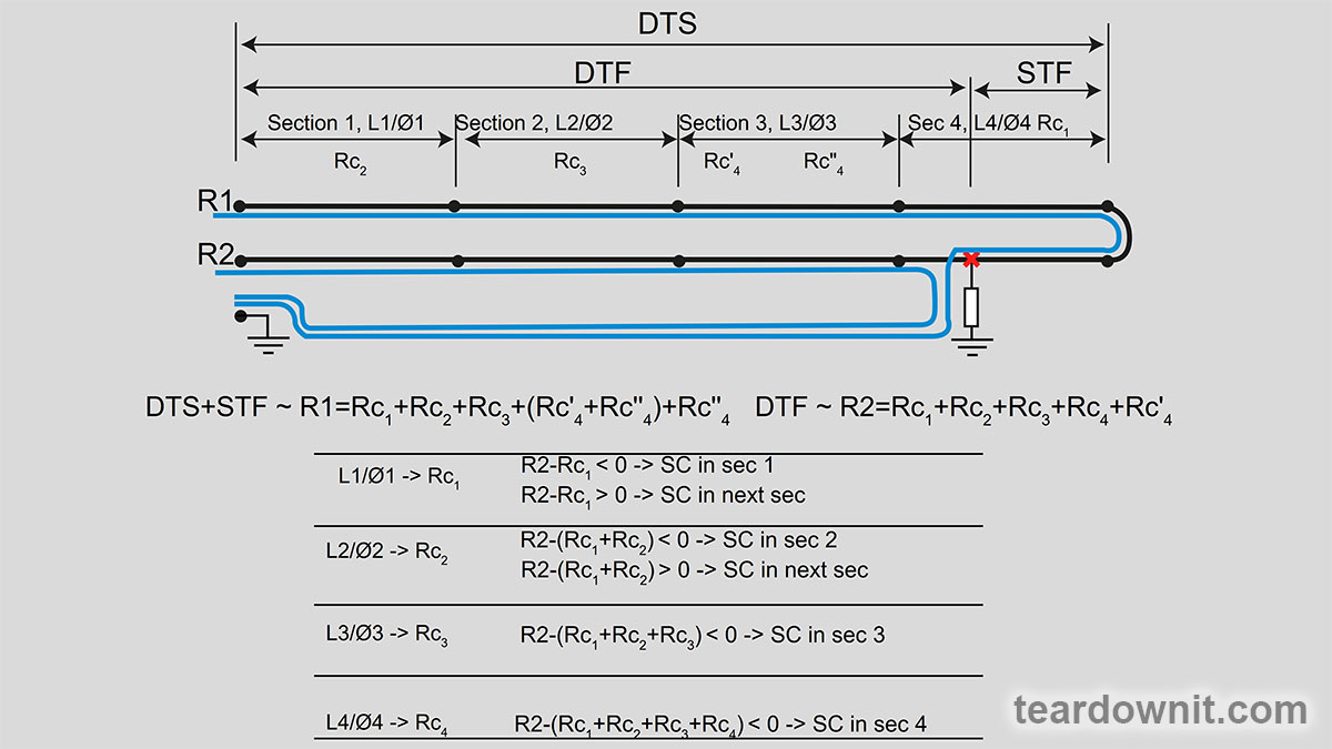

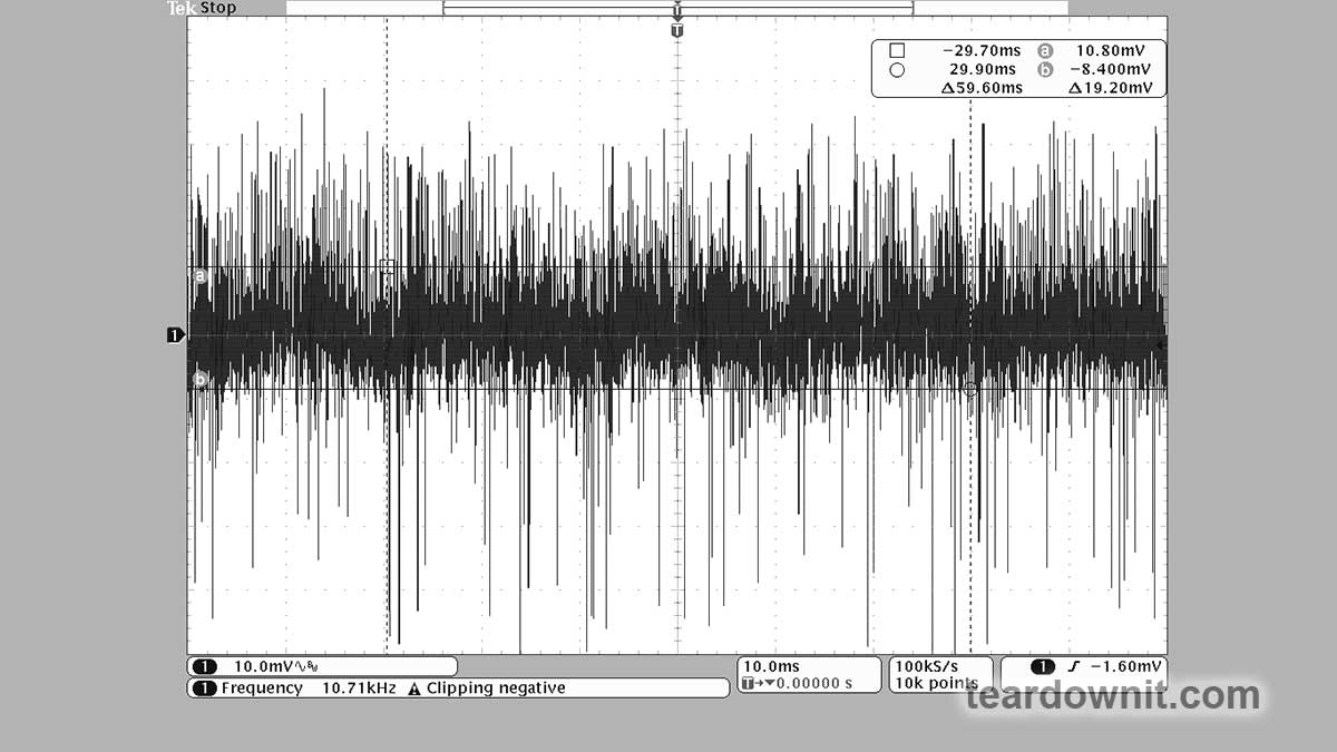

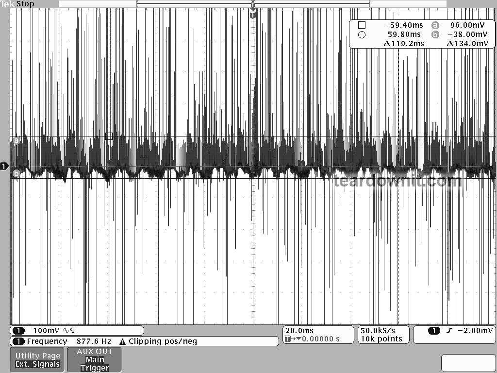

Search for intermittent faults, and Pupin coils using a reflectometer.

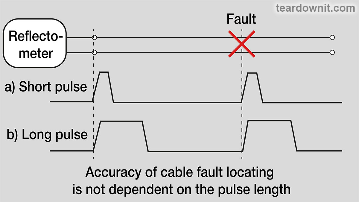

05/14/2024 at 08:02 • 0 commentsIntermittent faults ('floating' defects) are damages that manifest themselves periodically and are caused by poor-quality core connections or reduced insulation resistance. Customer complaints about short-term connection losses are evidence of defects of this kind. Such defects may appear due to mechanical damage to the cable (for example, in the event of vibration from heavy vehicles, rotary equipment, etc., nearby).
Typically, when a technician encounters this type of damage, he has to wait patiently for it to manifest itself, hoping the effect will last long enough to determine its location. There is no guarantee that the damage will reveal itself while the technician is on duty. The use of reflectometers allows one to automate this process and maximize productivity.
Some reflectometers have a special function for detecting intermittent faults. The device connected to the line accumulates all reflectograms over a certain period and displays them superimposed on each other. Where the reflectogram differs, the intermittent fault is located.

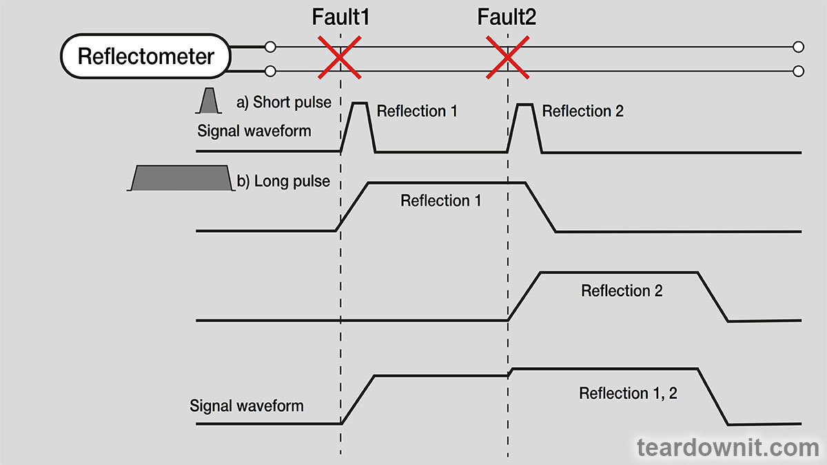

Finding intermittent faults
For example, consider the following situation: a particular pair of cables works fine for the better part of the day, but there is a momentary failure out of the blue.
We get two reflectograms for the same pair (with different gain settings) when checked. In the first one, with a gain of 12 dB, a surge of positive polarity is observed on the reflectogram of a working pair at a distance of 6760 feet, corresponding to the end of the cable. In the second one, when the gain increases by 14 dB, an additional spike appears on the reflectogram, the nature of which indicates the presence of a coupling in the cable at a distance of 3280 feet. By further increasing the vertical gain level, the reflectogram will not reveal the slightest sign of damage along the entire length of the cable being tested.
We will need the 'intermittent fault detection' function mentioned above. By continuously monitoring the pair's condition, the OTDR shows any deviations from the cable's rated impedance, allowing the location of intermittent faults to be pinpointed.
The reflectometer display will show the current reflectograms obtained during testing. Periodic inspections allow one to determine whether signs of malfunction have appeared. Once the non-persistent damage has been captured, the result should look approximately as shown in the figure.
The differences will be evident if one compares it with the previous one. A noticeable drop appears where there was nothing before. The location of the fault can be determined by simply moving the cursor to the front of the pulse reflected from the break and reading the distance from the display.
Random vibrations or other irregular events cause the connections to loosen and electrical contact to be temporarily lost, resulting in a fault similar to a partial break. Note that at the moment this fault occurs, the pulse reflected from the far open end of the line decreases because, due to a poor connection in the cable coupling, the magnitude of the electrical signal reaching the end of the cable is reduced.
What conclusions can be drawn? Almost every type of cable system is susceptible to intermittent faults. Such damage creates severe problems for users and technicians. The intermittent fault detection mode of reflectometers allows one to continuously monitor the cable over a long period, so the technician does not have to waste working hours waiting for the damage to manifest itself.

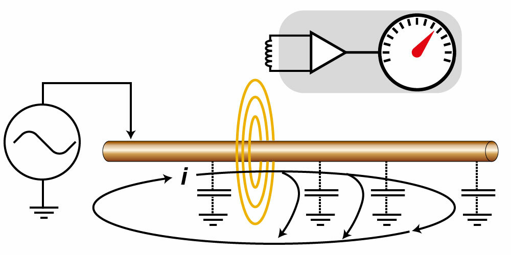

Pupin coils
Pupin coils can still be found on an analog telephone line. Pupin coils disrupt the homogeneity of the copper pair, turning it into an ideal low-pass filter with more substantial high-frequency attenuation.
Therefore, a prerequisite for using any xDSL technologies on existing phone lines is the removal of Pupin coils, which have been found to have extensive applications in US telephone networks. Servicing xDSL systems can always...

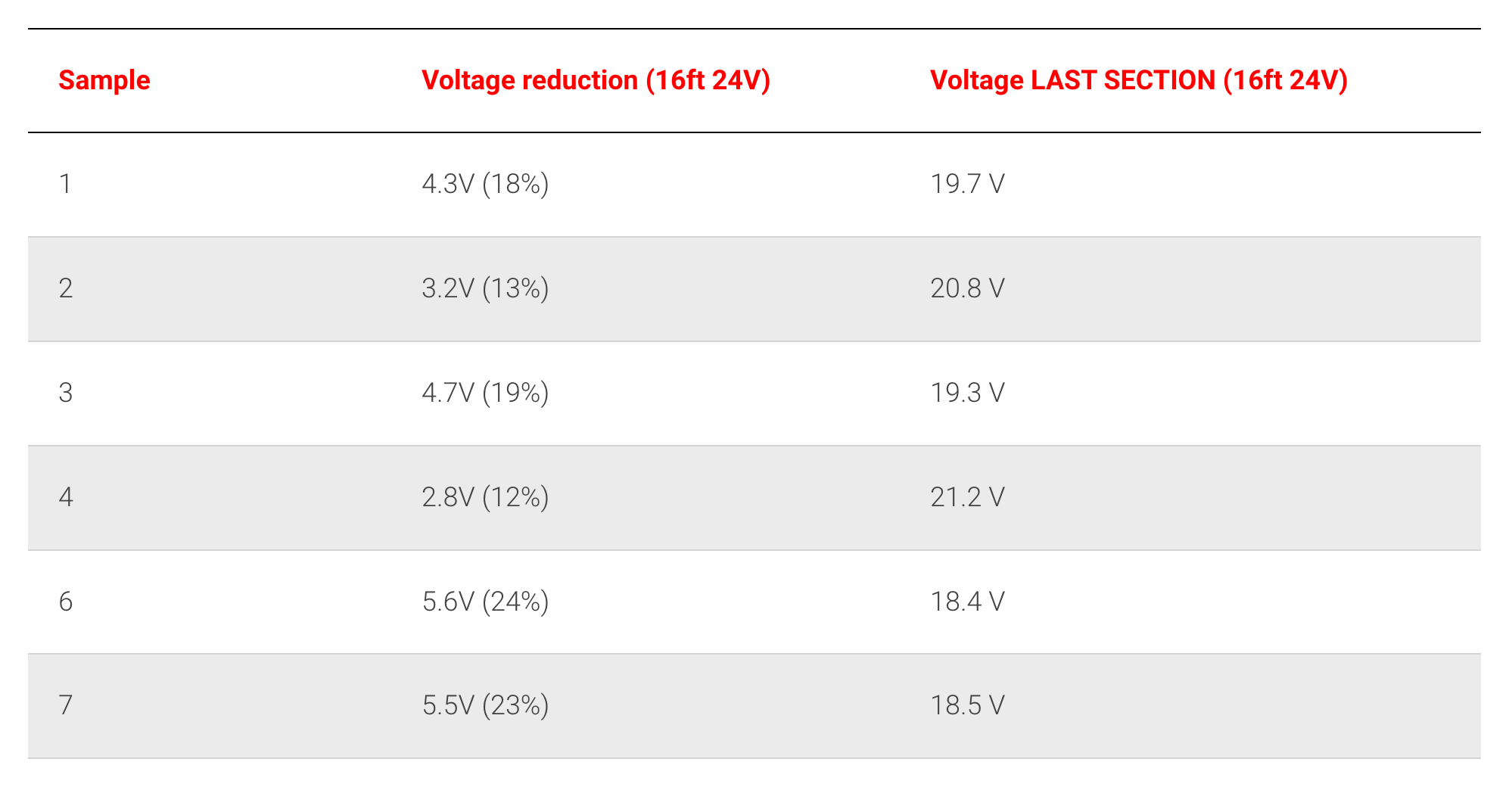

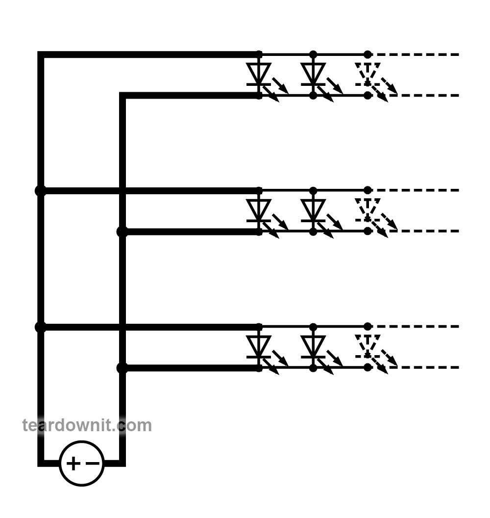

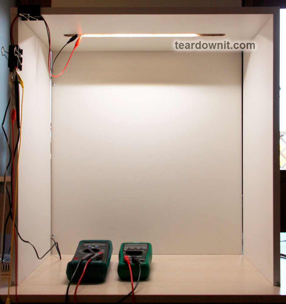

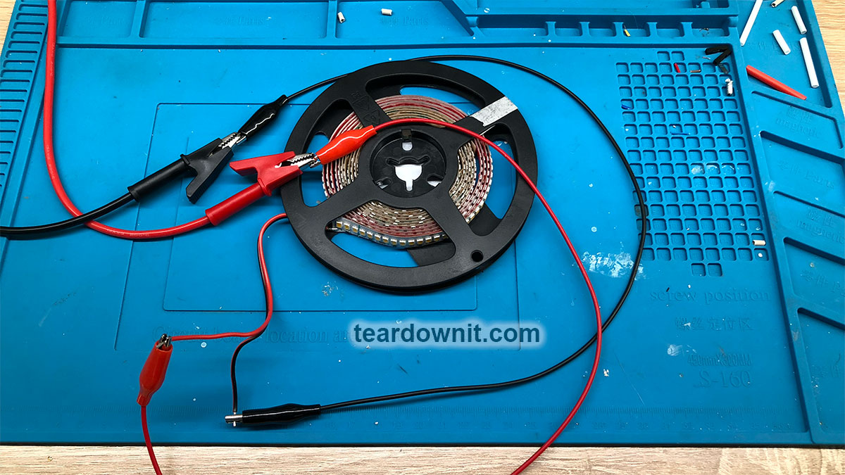

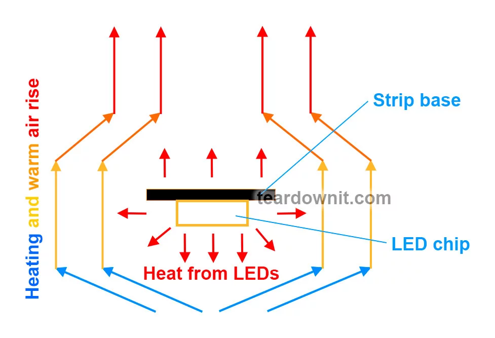

Conductors always have resistance. Imagine we want to install an LED strip around a 500-square-foot room (16*32 feet). We need 96 feet of LED strip, and it is impossible (!) to connect it to the power supply at one point (!). Why?
For example, a strip has a power consumption of 3 watts/foot (a 16-foot reel has a power rating of 48 watts and a current of four amps at 12V). A 16-foot strip comprises 96 sections (cut lines) of two inches each. Each strip section will have an internal conductor resistance of 0.005-0.02 Ohms, depending on the manufacturing quality. The total native resistance of the strip is 0.48 to 2.8 Ohms. The supply voltage drop for the last sections of the strip will be 2 - 7.7 V. The voltage across the last sections of the strip will be 10 - 4.3 V. This is very low!
When all three channels are on, we will clearly see the difference in brightness between the beginning and end of a 16-foot strip. For an RGB strip, it will look like a color change. The start of the strip will be white, and the end of the strip will be yellow.
Details are in my earlier post:
Effect of reducing the LED strip supply voltage on the light emitted
https://teardownit.com/posts/effect-of-reducing-the-led-strip-supply-voltage-on-the-light-emitted
Several solutions to the power problem exist for a long line of LED strips. The first option is to install a thick power cable next to the entire LED strip and connect it to the strip several times every 10-20 feet. For example, a 4*14 AWG cable. The solution is excellent and reliable but expensive.The second option is the use of an LED strip amplifier. The device is a set of transistor keys for powering a powerful load controlled by a special signal. LED amplifiers allow us to use multiple power supplies, synchronizing powerful loads with a control signal. We don't need to run four thick conductors along the entire length of the RGB strip, but just install a few power supplies and amplifiers every 10-20 feet. We can also combine power supply options depending on the situation.
We will also need an RGB amplifier to connect more loads (LED strips) to the RGB controller output than it supports/allows. For example, the RGB controller is designed for a 100W load, but we want to connect 300W LED strips.

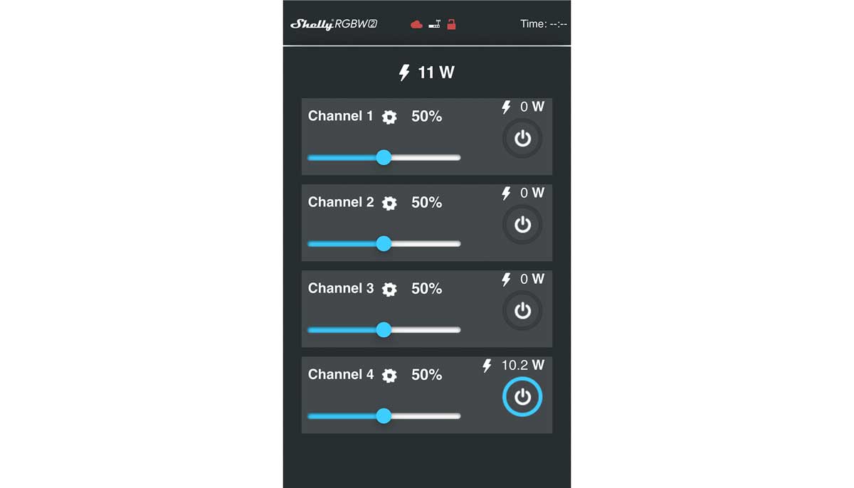

So, what can go wrong with such simple devices? When choosing from catalogs and online stores, you will see only two significant characteristics - operating voltage (5/12/24V), maximum output current, and the number of channels - three for RGB and four for RGBW. However, my experience has shown that not everything is shown in the documentation.
Lying about the maximum current
Amplifiers are DC-powered, and when all channels are switched on, the total current of all channels flows through the common power wire (5/12/24V). Therefore, the maximum total current through the amplifier is critical. Since we are describing an electrical circuit, it is crucial to know how strong the weakest link is.
Let's take a look at such an amplifier.
In the housing and documentation, the maximum current through the amplifier is 24A. But! The device uses disconnectable connectors, which...

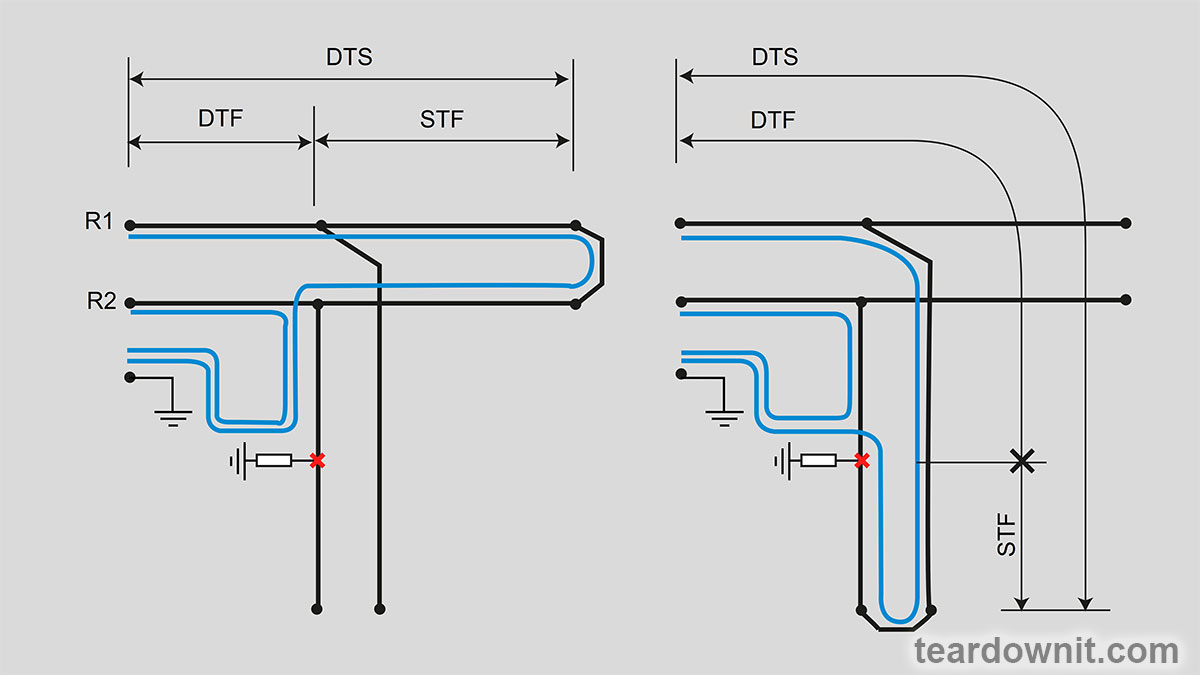

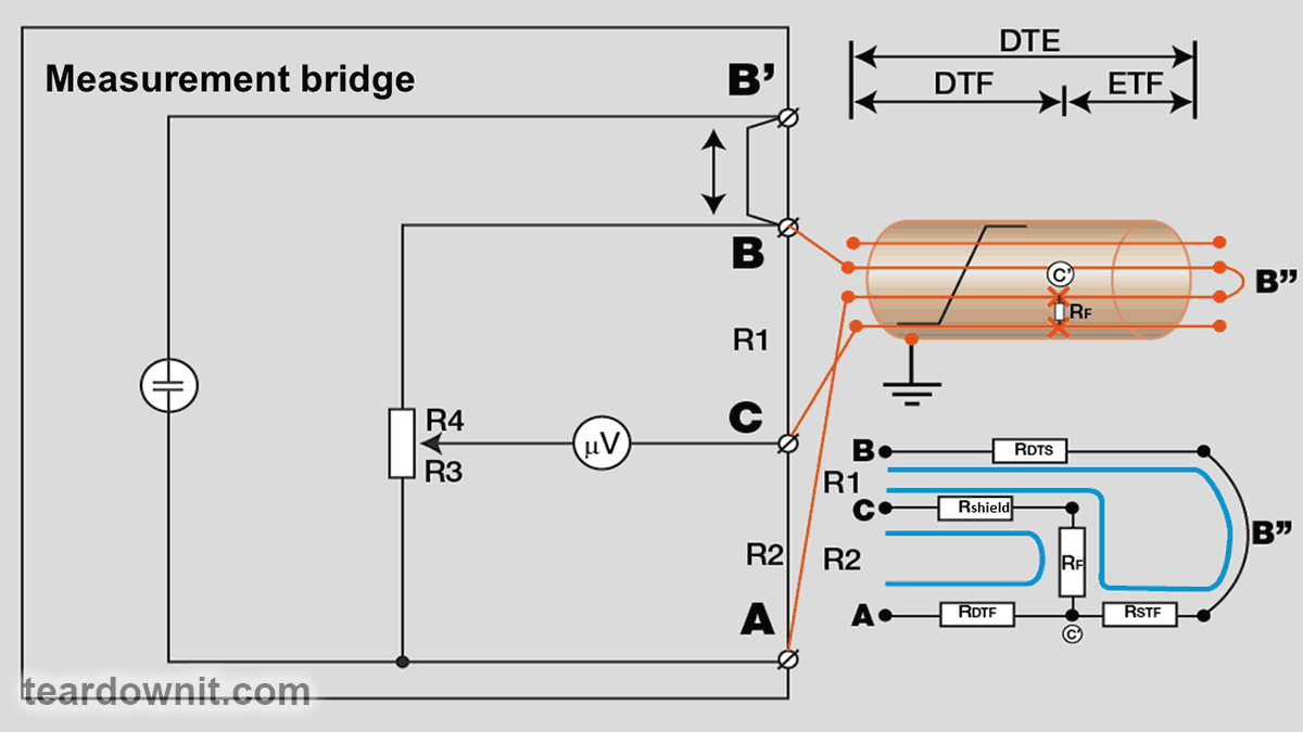

Finding branches using a reflectometer
04/15/2024 at 15:02 • 0 commentsAs you know, a data cabling system consists of different segments. To connect them all and bring the data connection to the end user, it is necessary to make a certain number of crossings. Often, staff forgets to disconnect "old" lines. As a result, over time, parallel branches appear, and their presence can have a detrimental effect on the quality of services.
BRANCHES AS A SOURCE OF PROBLEMS
Parallel branches can make it difficult to serve clients and ensure system functionality. With the introduction of digital systems, the search for parallel branches becomes an increasingly important task since they negatively affect the operation of digital transmission systems and, even if in most cases they are relatively short in length, nevertheless lead to significant problems. The bramch creates a second path for digital signals transmitted on the main line, which travel along the branch and are reflected from its open end. Reflected signals (echoes) enter the main line, where they are mixed with "good" digital signals and negatively affect the quality of the transmitted data. Therefore, to ensure correct operation of the digital line, the branches must be disconnected completely.
When connecting to analog lines, branching also creates problems. For example, if there is a fault on such a branch, it may show itself in the form of a decrease in the quality of the transmitted signal.
Finally, unknown branches can affect the accuracy of diagnostic equipment, for example, when measuring cable capacitance and estimating the distance to a break using a capacitive bridge. An unknown branch increases the combined capacitance of the cable pair and causes a measurement error: for the tested pair, the calculated length will be greater than the actual length.
It is very important to have full information about all the parallel branches available on the line in order, if necessary, to select the correct algorithm for troubleshooting and eliminating the problem.

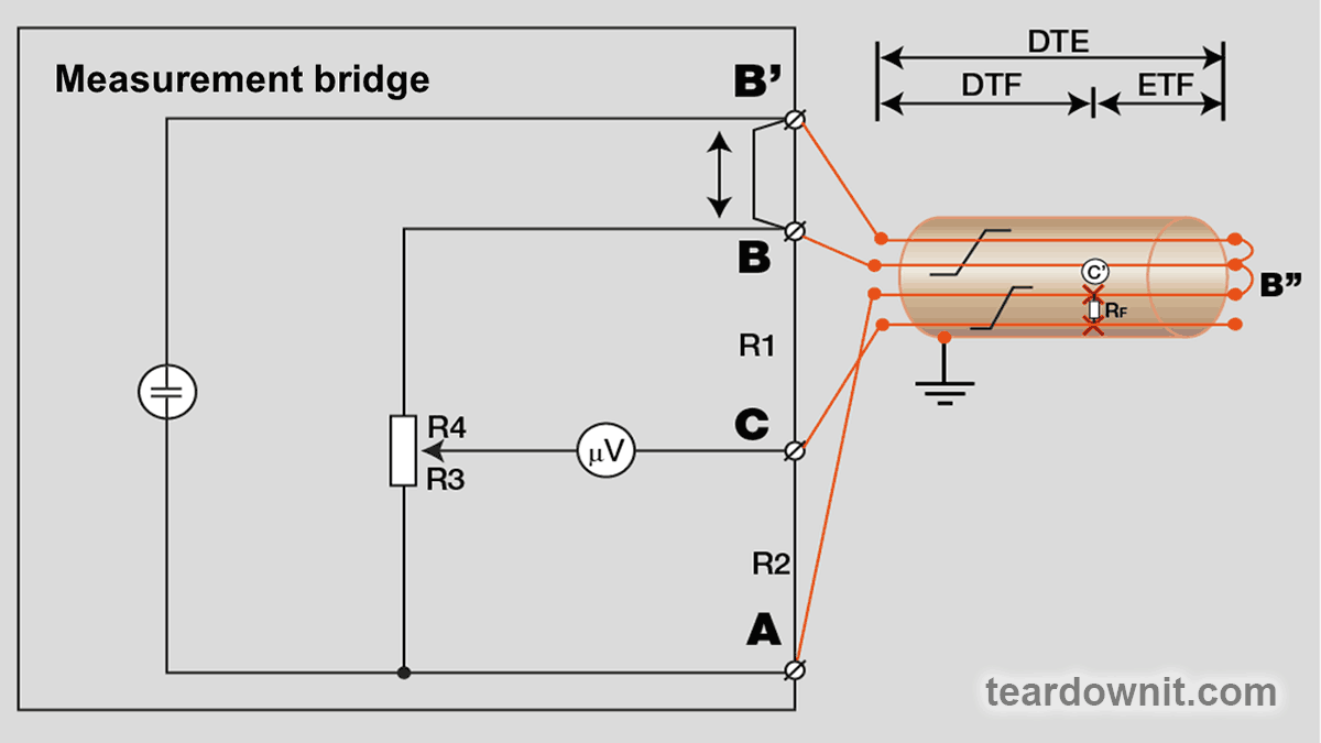

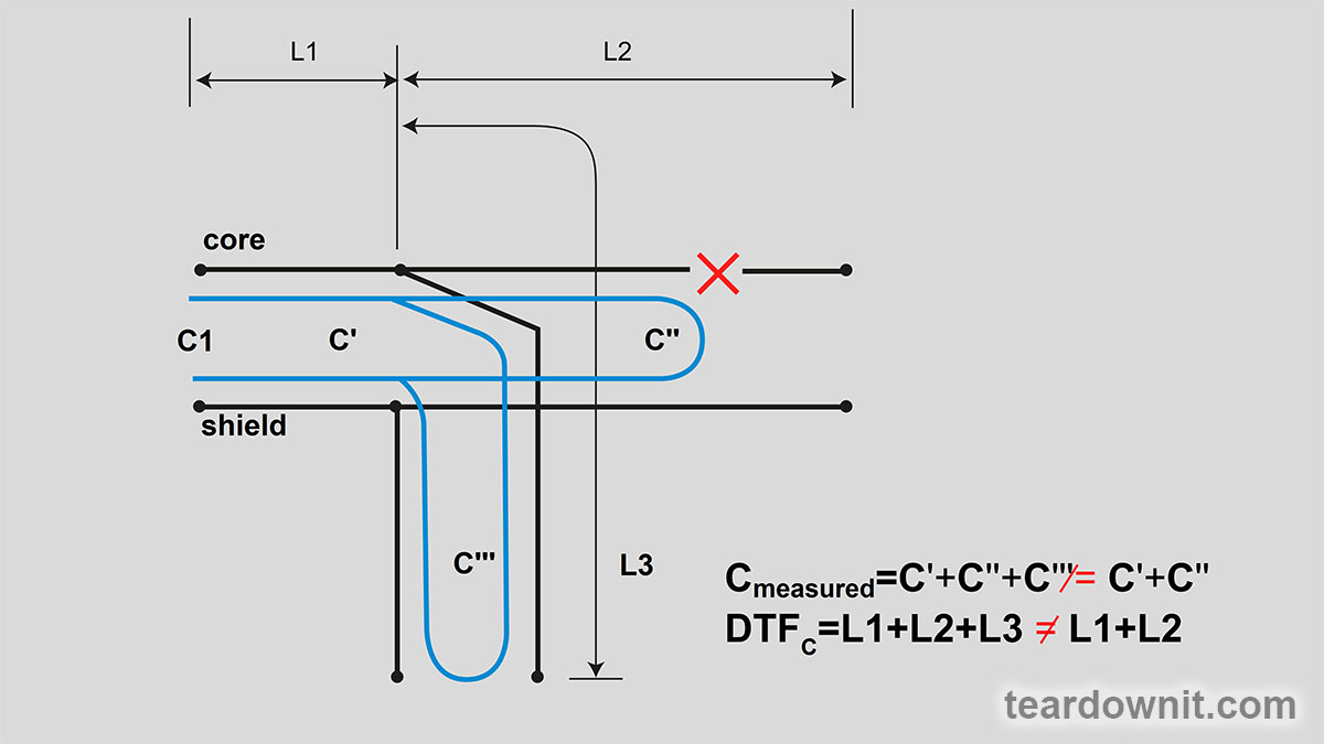

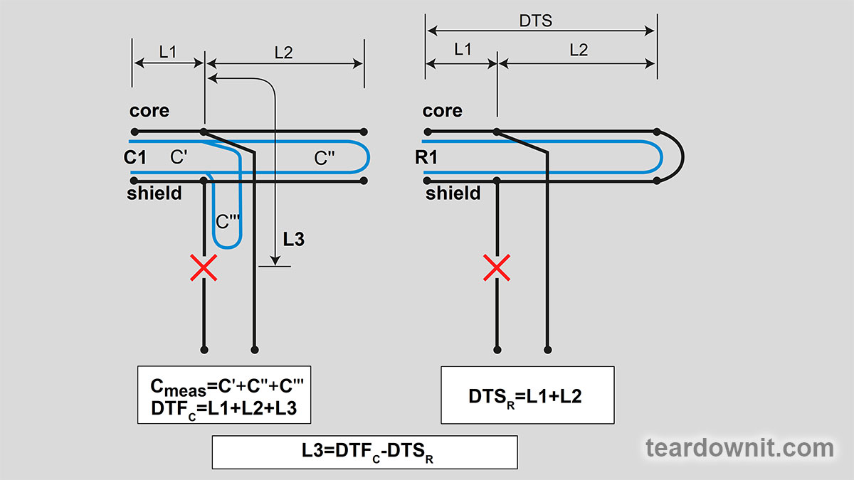

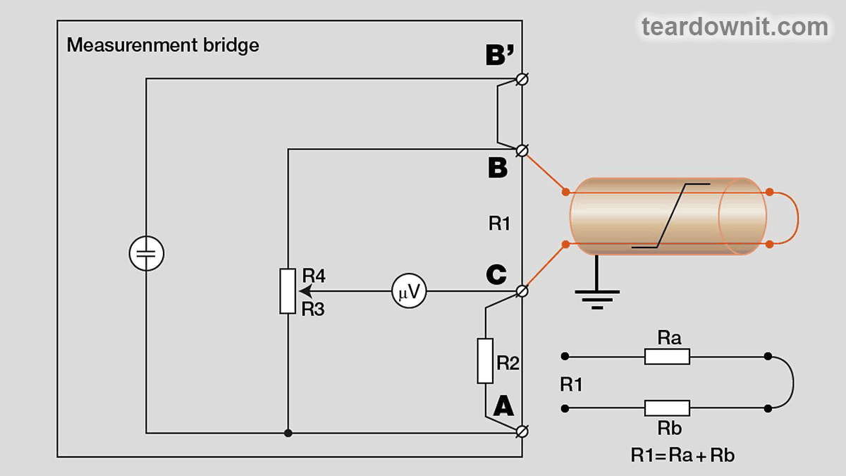

SEARCHING FOR THE LOCATION OF THE BRANCH CONNECTION
The capacitive bridge is the device most often used to measure the length of a cable that is open at the far end. Unfortunately, it only allows one to estimate the total length of a cable pair, including all parallel branches.
Using multi-function devices (combining a capacitive and resistive bridge), it is possible to calculate the length of the branch cable due to the ability to compare the length values obtained from measuring the cable capacitance and the resistance of the loop.

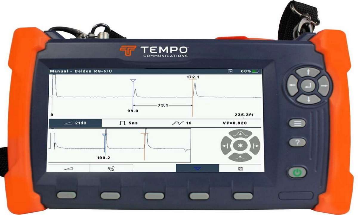

In this case, an OTDR is the most optimal and, moreover, the only device that allows one to find the locations of branching, measure the lengths of the branches, and determine the distance to them.
However, in practice, cable analyzers that combine the functions of a reflectometer and a multi-function instrument are more convenient. The implementation of two measurement methods (reflectometric and bridge) in one device allows for comparison of the results obtained for more accurate fault localization.
The classic branch reflectogram is similar to the one for testing a damaged cable, the only difference being that the reflection of the signal from the branch is a straight line rather than a curve.
As an explanation, let's look closely at the reflectograms for an open-ended cable section without a branch and a cable section with one (it is located at a distance of 3385 ft). The corresponding measurement results using a capacitive bridge were transferred to the reflectometer for direct comparison and accounted for. Note how the presence of a branch affects the measurement results of a capacitive bridge—in particular, how the cable section with a branch distorts the pulse reflected from the open end of the cable at a distance of 6500 feet. This occurs because part of the energy of the reflectometer signal was lost passing through the branch. The ideal way to view these graphs simultaneously is to use a dual-channel OTDR...
Read more -

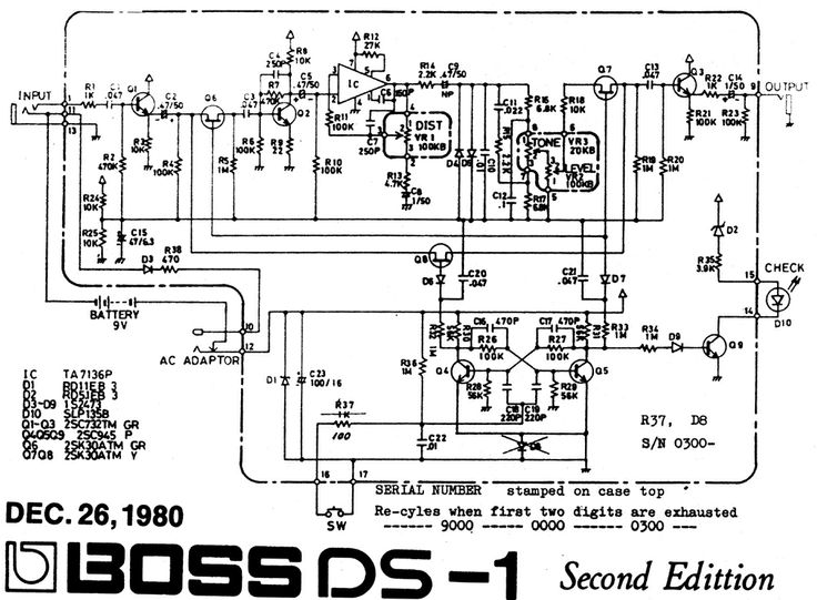

There is no doubt about the possibility of recreating a certain sound by other means. The question is how complex the circuit with transistors and ICs will be sufficient to obtain a convincing effect.
The idea to replicate the iconic sound of the Marshall JTM 45 and JCM800 in a pedal body and create the world's first amp-in-a-box, oddly enough, first came to none other than the employees of the Marshall company itself, led by the head of the Development Department, Steve Grindrod.
Guitarists worldwide owe a debt of gratitude to this man for developing the legendary Marshall JCM800 and Vox AC30.
Today, the godfather of British Sound owns his company, Steve Grindrod (Albion) Amplification. He produces Pendragon guitar amps and Gypsy Boy acoustic amps and works with various charities. And in 1988, his efforts led to the creation of the Guv’nor pedal.
In 1992, the pedal was re-released under the name Drive Master. It differed from the original only without an effects loop jack.
The circuit looks like a regular distortion pedal with two operational...

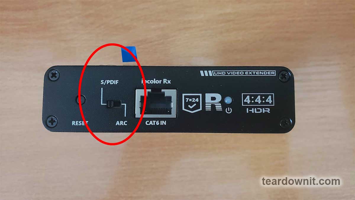

ARC stands for 'audio return channel'; video and audio signals are sent to the TV, video is shown, and audio is transmitted back through the same HDMI cable to be played on the player's, console, or PC side. The easy way to play sound on some standalone audio system instead of TV speakers is, of course, a trusted audio jack output on the TV. Using ARC is the right way to do it with an amp or an audio receiver near the media player. HDMI audio could be multi-channel, but the one-eight-inch stereo port is limited to just two channels.

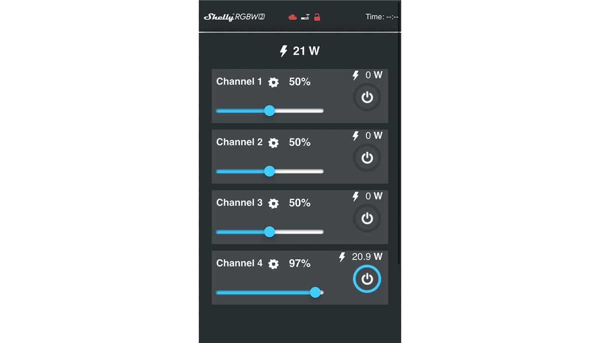

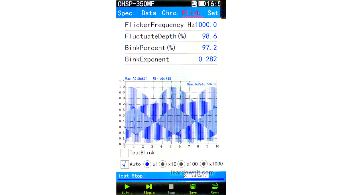

PWM frequency in Shelly RGBW2 controller
03/24/2024 at 08:08 • 0 commentsI received an interesting email from a reader of my post:
https://teardownit.com/posts/shelly-rgbw2-controller-and-shelly-duo-rgbw-bulb-dangerous-light-pulsations=====
After having some bloody eyes and reading your article I decided to change the firmware on shelly rgbw2 with ESPHome so I can modify the pwm freq to 1500 Hz like you recommended.
Don't know if placebo or not but I feel better :) .I can test only with camera from phone with shutter speed at 1/1500 and no flicker (and sub multiples like 1/500).
With PWM freq at 600 Hz I could see flicker on camera at anything above 1/600.Don't know if this is the same you have tested but I was curious if you can test with a modified Shelly with ESPHome to be able to put higher frequency.
I also don't know if there is a limit on the maximum frequency (the shelly or the COB LED strip it's dimming ) it will work and if is there any benefit in increasing any further.Thank you for publishing this extensive tests online.
Ciprian
=====Great news!
I was very interested and read the ESPHome firmware description.
https://esphome.io/components/output/esp8266_pwm.html
Perfect!I have not previously used ESPHome, but I have been actively using Tasmota for a long time. In this firmware I also found PWM frequency adjustment:
https://tasmota.github.io/docs/Commands/#pwmfrequencyLet's do the tests!

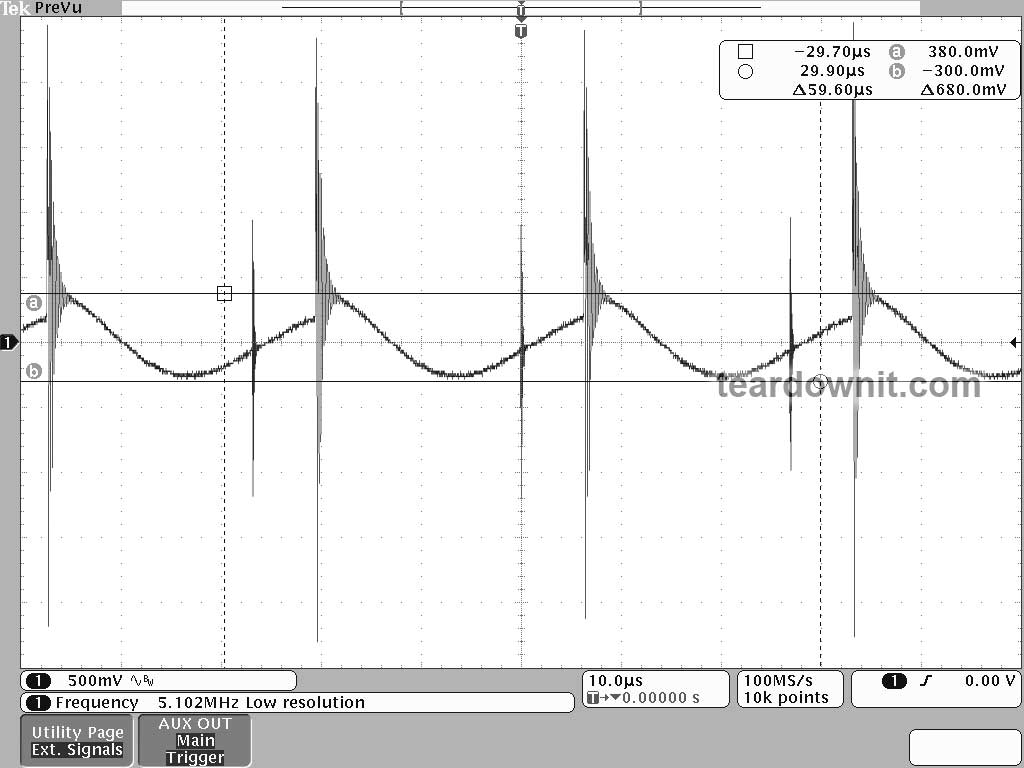

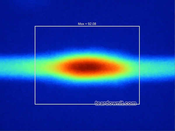

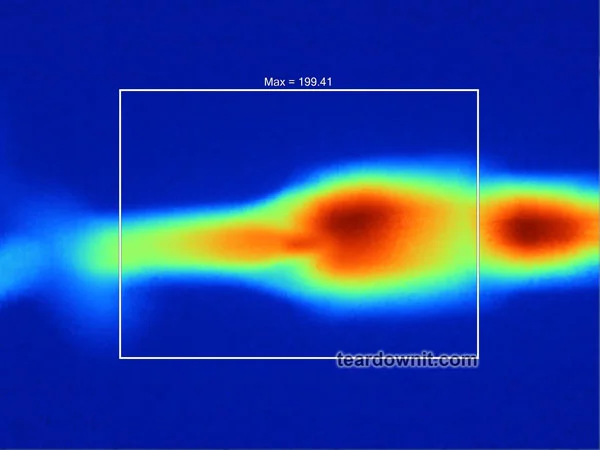

The measurement scheme is simple.

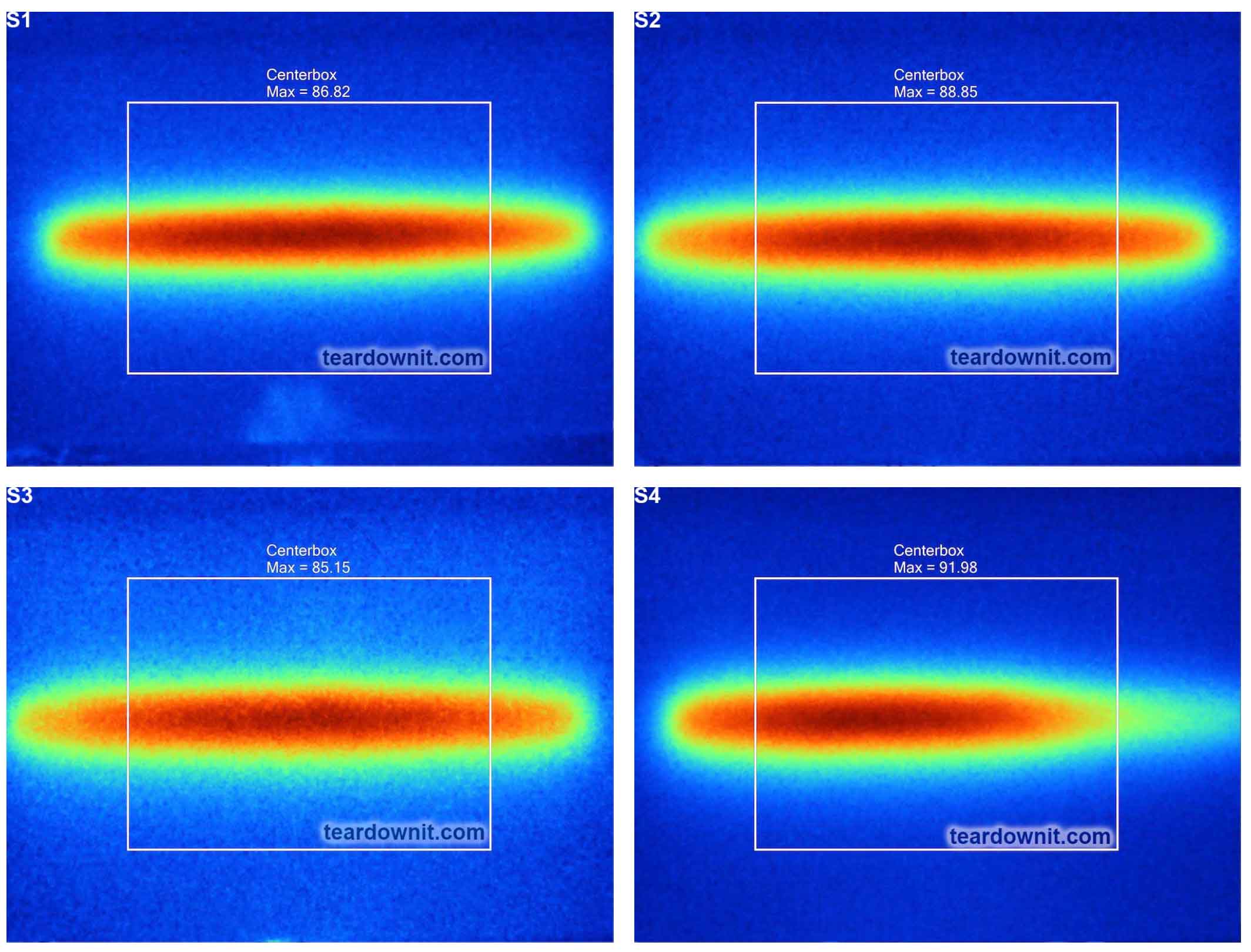

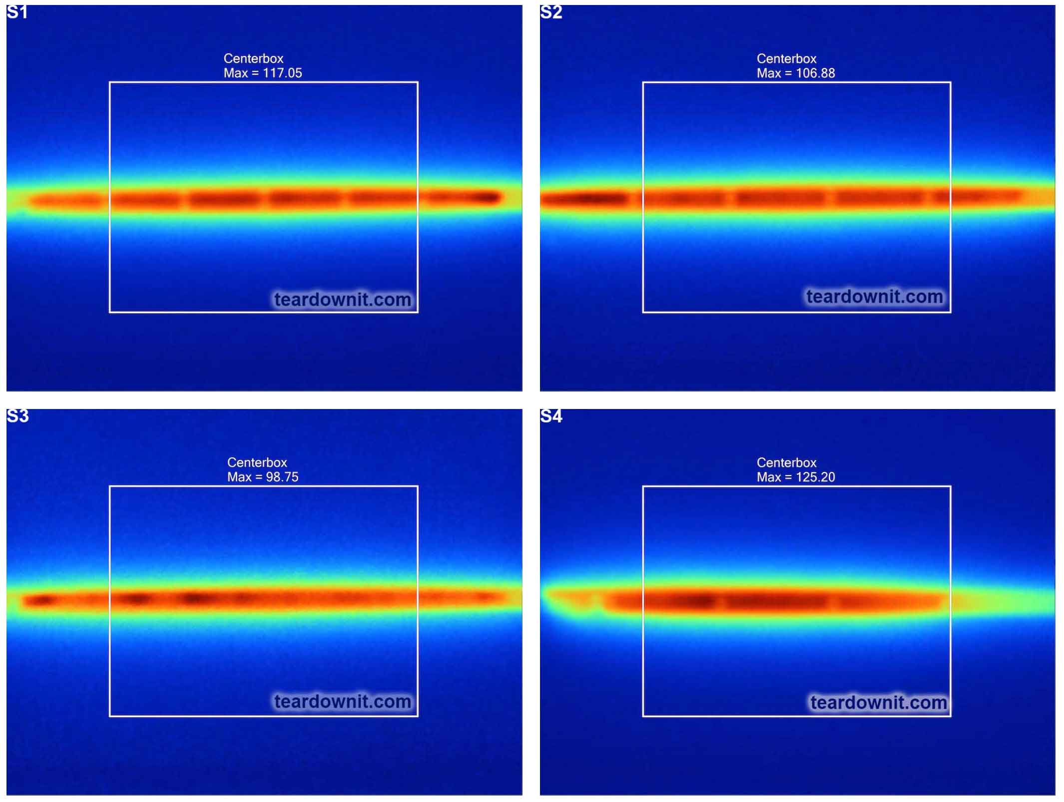

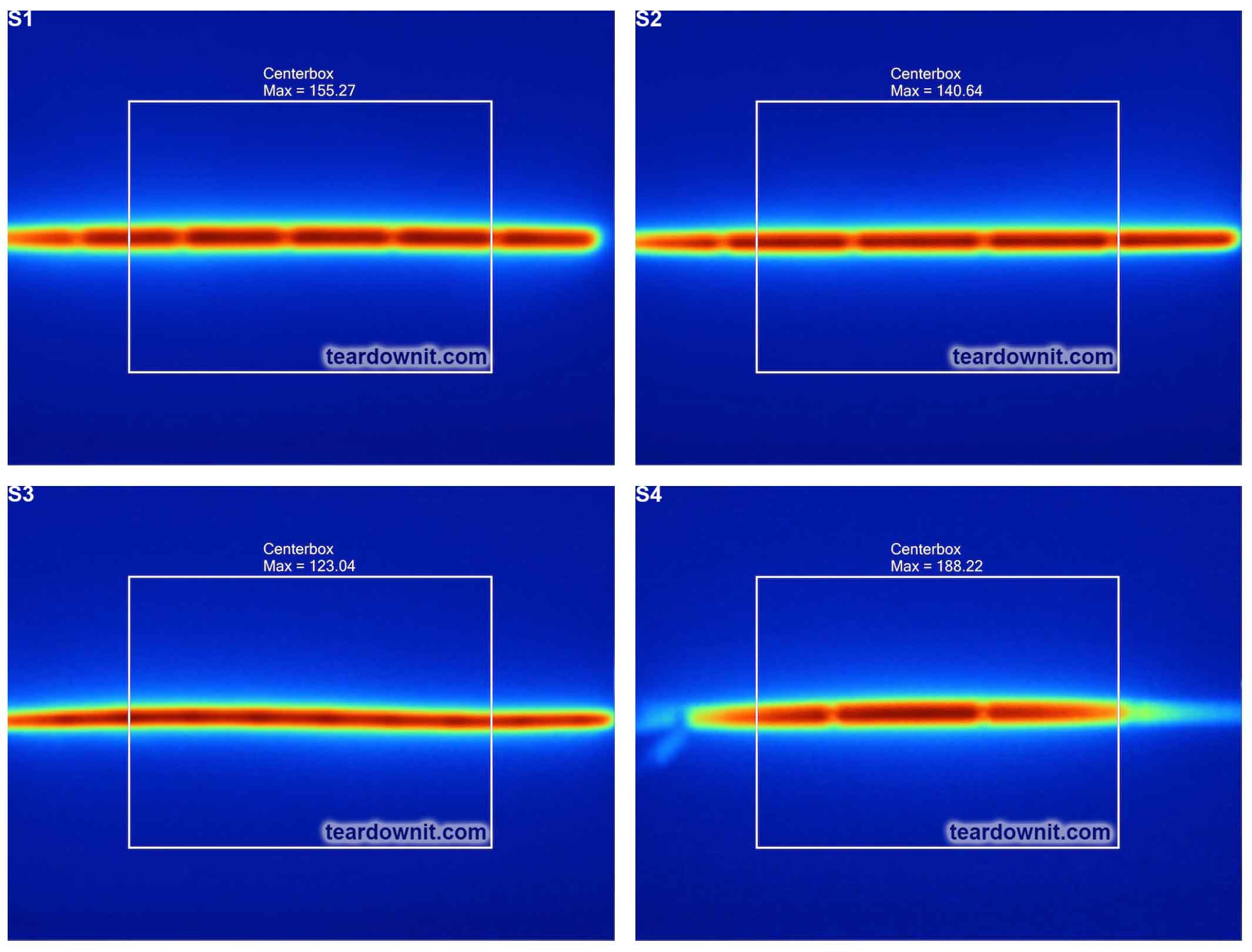

1. Old Shelly native firmware.I found a new old Shelly RGBW2 controller with 2021 firmware in my stock.
Measurements are taken at 25% brightness. The PWM controller is running at 600 Hz.
2. New Shelly native firmware (20230913-131259/v1.14.0-gcb84623).
The PWM controller operates at 1000 Hz for a brightness of 25%.
3. Tasmota firmware.
Firmware installation is easily done without wires and additional devices using OTA.
Manual: https://github.com/arendst/mgos-to-tasmotaHowever, I couldn't use this script and found many errors mentioned for this device.
The solution is found right here:
https://github.com/yaourdt/mgos-to-tasmota/issues/102This is my successful script:
- RGBW2 must be set to Color mode. You do not need to do anything if the device is already in this mode.
- The firmware needs to be downloaded from this link:
http://deviceIP/ota?url=http://dl.nekohell.eu/mg2tasmota-ShellyRGBW2c.zip - Once the WiFi network is configured, you need to use two commands through the Tasmota console (changes will be saved after rebooting or shutting down the device):
SetOption68 1
// The device will switch to 4-channel white mode (if you need it)PWMFrequency 2000
// PWM frequency will increase to 2000 Hz
Configuration for Tasmota and additional information:
https://tasmota.github.io/docs/devices/Shelly-RGBW2/I set the PWM frequency by a multiple margin (I was just curious). 4000 Hz.

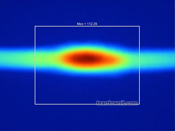

The optical measuring tool showed an incomprehensible picture for me. But this phenomenon is outside the scope of this post, and I will deal with it later.
Conclusions.
- The Shelly device manufacturer can change and does change the PWM frequency in their firmware. I really don't understand their answer about not being able/unwilling to change the PWM frequency to a safe level.
- I am very grateful to Ciprian for the excellent advice. Thank you, Ciprian!

Water impact is found when the reflectometer detects a change in the resistance of the pair being tested due to a change in its capacitance. In addition, a good indicator can be the pulse propagation speed, which directly depends on the characteristics of the cable.
Water in the cable "slows down" the signal. In the waterlogged section, the electrical signal's propagation speed can change every other inch. As a result, measuring the actual length of the entire cable and its waterlogged section is much more challenging since the reflectometer measures time intervals. (The bridge meter will indicate that the cable length is longer than the actual length.) Water significantly increases the capacitance of the waterlogged section of the cable, so it will not be possible to find the correct propagation coefficient value. To reliably measure the cable length, one usually measures the length of a dry section, either on one or both sides. If the total length of the cable is known, subtract the lengths of the dry sections from it. Very often, the starting point of the waterlogged segment is too close to the reflectometer connection point. In this case, the device will not detect the presence of water. Therefore, the cable must be checked from both sides.
Some OTDRs have a "marker" function to measure the distance between two points, eliminating the need to measure dry sections on both sides of the cable and making it easier to determine the length of a waterlogged section.
The figure shows that L2 = Lcable – (L1 + L3), where L2 is the known cable length and L1 and L3 are dry sections.
Water ingress affects the operation of multiple cable pairs. When testing a disconnected or inactive pair, there is a possibility that some voltage may be induced by neighboring active pairs, which is why most testing methods, such as using bridge meters, lead to distorted results. In such a situation, a reflectometer is the only device that will allow one to find the water damage point.
The classic reflectogram of a waterlogged cable has three key features. The first is a decline in the reflectogram (reflected pulse of negative polarity) in the place where the section of the waterlogged cable starts. The second is a waterlogged segment of the cable, usually having a slightly curved characteristic with "noise" (this is not noise per se, but simply an impedance unevenness that causes a characteristic distortion to appear on that section of the cable). Finally, the third is the rise of the reflectogram at the end of the waterlogged section of the cable (the reflected pulse of positive polarity). The reference reflectogram in the figure illustrates the ideal case.

The block diagram in the datasheet shows the "Active Inrush Current Limiting" node. Still, we could not find components on the board that could perform such a role. Still, the inrush current limitation element is present, marked as RTH1 on the board, and installed near the boost inductor PFC; most likely, this is an ordinary NTC.

Test conditions
Most tests use metering circuit #1 (see appendices) at 80°F (27°C), 70% relative humidity, and 29.8 inHg pressure. The measurements were performed without preheating the power supply with a short-term load unless mentioned otherwise.

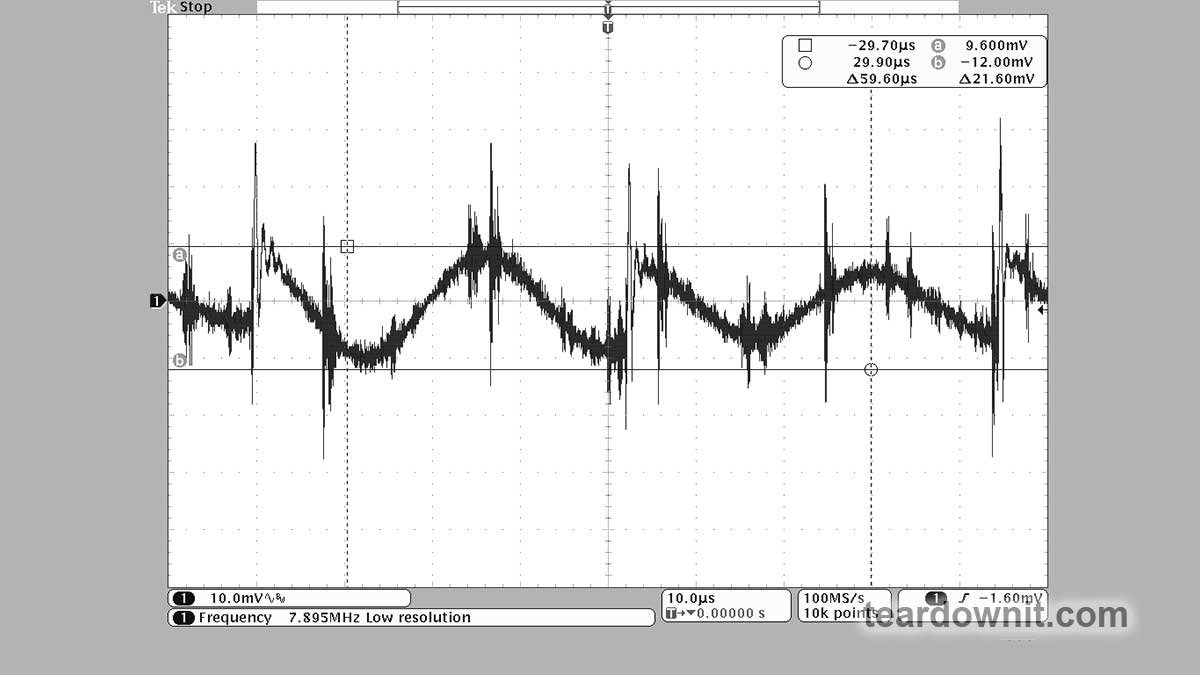

Power supply characteristics. Turns the AC/DC power supply on and off. Low-cost parameter measurement.
03/11/2024 at 07:40 • 0 commentsPower-on and parameters characterizing the behavior of the power supply when turned on
Powering on the AC/DC source can be separated into the following phases:
- Connecting to the grid, charging the input capacitors
- Preparing the power supply control circuit for switching on
- Starting the control circuit
- Output voltage increase, entering the operating mode
INRUSH CURRENT
Peak input current at full load.
An excessive current value can cause false alarms on protection circuits and interfere with neighboring devices in the power line. Considering that nearby devices at risk could be computers, home automation control systems, etc., the cost of damaging them in such an event can be huge.
The INRUSH CURRENT value depends on the power supply circuit, the instantaneous value of the voltage in the grid at the moment of powering on, and the residual charge of the input capacitors before switching on. To reduce the INRUSH CURRENT value, both parametric (the most common is the introduction of NTC thermistors) and current-limiting circuitry methods to cap the charging rate of capacitors are used.
SETUP TIME
Time from power-on until the output voltage reaches 90% of rated voltage at full load
It affects the readiness time of powered devices, which is essential in many industrial applications: automation, redundancy schemes, etc. This time is not critical for domestic applications and can reach several seconds.
As a common rule, the power-on circuit determines it to the greatest extent and depends on its state at the time of switching on. To a lesser extent, it depends on the input voltage at the moment of switching on and on the residual charge of the input capacitors.
RISE TIME
The time it takes for the output voltage to rise from 10% to 90% of the rated level at full load.
Usually, this is several tens of milliseconds. Mainly depends on the power supply control scheme.

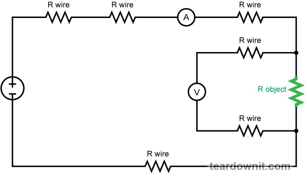

How to measure these characteristics
One can use the power management diagram at the end of this document to obtain the power-on characteristics. You need to connect the AC input to the power source and connect the power source under study to the output.
Connect the channel 1 probe of the oscilloscope to the source output and set the vertical sensitivity so that the expected output voltage of the source conveniently fits on the screen for observation. Set the triggered sweep threshold to 0.7 of the expected voltage. Set the horizontal scan to 20 ms/div. Set the launch moment to position 0.8 from the full horizontal sweep.Connect the channel 2 probe of the oscilloscope to the measuring output of the power control circuit and set the sensitivity to 0.5 V/div.
Ensure the power control unit's current transformer mode button is pressed.
Keep the circuit off for 5 minutes, switch the oscilloscope to standby mode, set the load to 100% power, and turn on the circuit.
Evaluate the use of the vertical and horizontal dynamic range for the resulting oscillogram: the processes should occupy from half to the total size of the screen; single limitations of the signal "hairpins" along the vertical are allowed. If the display conditions are not met, adjust the gain and/or scan and repeat the power-on procedure from the beginning.
Determine parameters using cursor measurements on the oscilloscope screen.
An approximate view of the oscillogram obtained using the described method is shown in the figure:
These characteristics are consistent with a device having an active PFC circuit and an active inrush current-limiting circuit. It can be seen that the SETUP TIME is 263 ms, and the RISE TIME is 8 ms.
Power-off and parameters characterizing the behavior of the power supply when turned off
Switching off the AC/DC power supply can be separated into the following phases:
- The supply continues to operate due to the residual charge on the input capacitors until the voltage across them drops to a certain critical level; at this point, maintaining the output voltage at the nominal value...

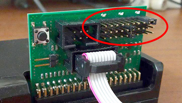

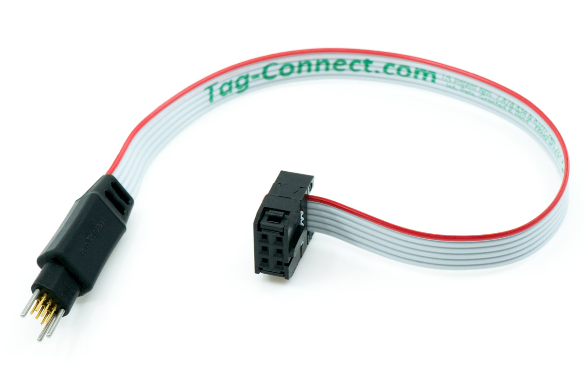

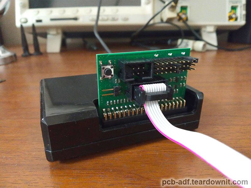

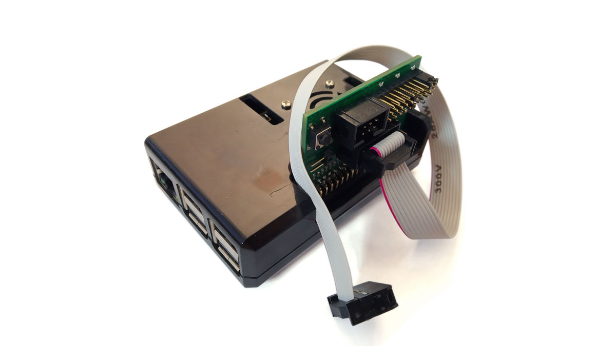

Pi Extension board "PiEBridge" adapters
03/04/2024 at 21:05 • 0 commentsProgrammable power supply for external/target devices
The PiEBridge has a built-in programmable power supply for external/target devices. The user can set the voltage of 2.5-5V (accuracy not less than 2%) with a current not more than 300mA by command from SBCs (e.g., Raspberry Pi).
Users can set this programmed voltage or "ground" to any pin of the output connectors using the built-in 3*10 pin matrix and jumpers.
Connectors

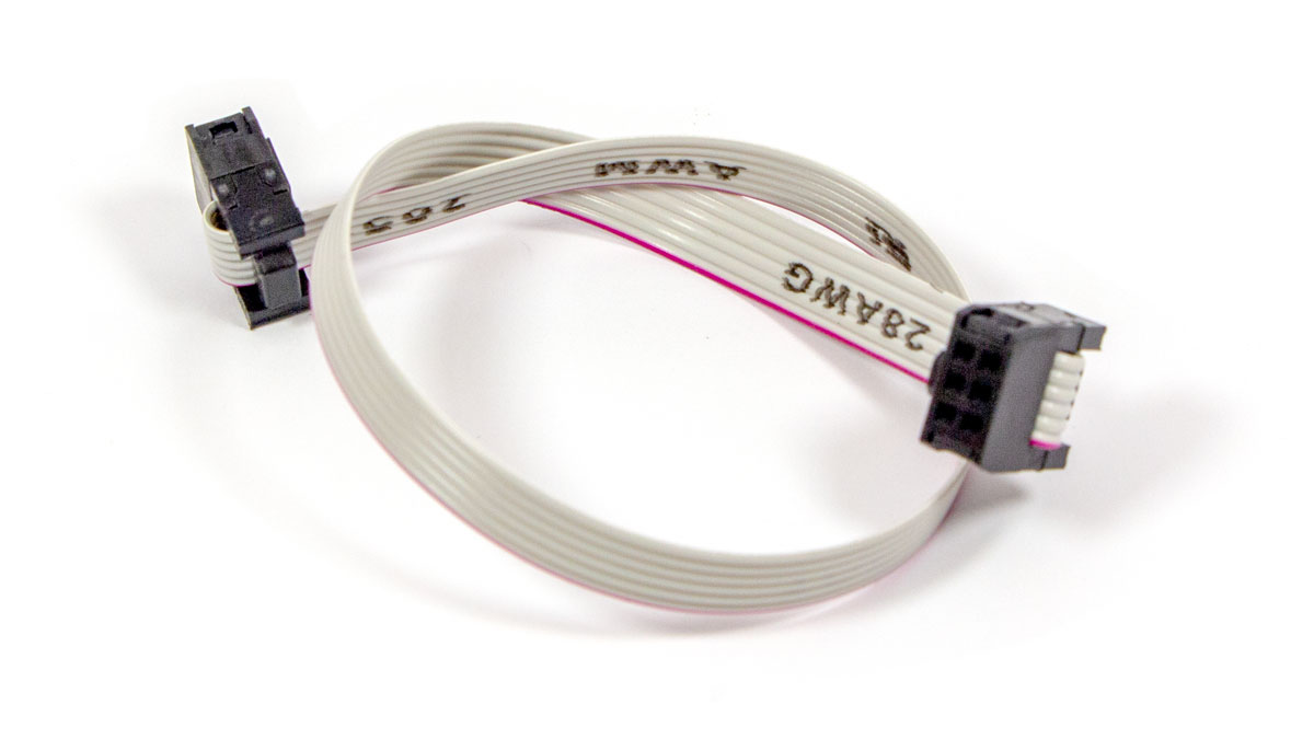

The PiEBridge extension board has built-in 6-pin IDC (2x3 0.1") and 10-pin IDC (2x5 0.1") output connectors.
We recommend using four basic adapters to connect to target systems (e.g., for flashing) via these connectors:IDC6-IDC6
IDC6-TC2030
(TAG CONNECT 6 PINS)
IDC10-IDC10
IDC10-TC2050
(TAG CONNECT 10 PINS)
Analogs in Segger adapters
Reflectometer applications: methods for finding significant cable damage
03/01/2024 at 23:52 • 0 commentsThe primary and most common damage types are wire casing damages or cable installation errors. These typically are 'floating' defects and wire connection errors. Let's learn the technique of searching for those kinds of faults.
AUTOMATIC DEFECT SEARCH
Let's start with the automatic search mode. This method automatically compares defects detected on the reflectogram with a threshold value of reverse attenuation. The method of automated comparison with a threshold value greatly simplifies reflectogram viewing. If, for example, you set the threshold to 30 dBRL, the reflectometer will automatically display only the faults with a return attenuation value of 30 dBRL or less.
FIXATION OF 'FLOATING' DEFECTS
Locating 'floating' defects is another indispensable function of a modern reflectometer. Only with its help can it be possible to point out the locations of the periodically repeating effects of weak wire connections or reduced insulation resistance. Defects of this kind manifest themselves in customer complaints about random signal loss. 'Floating' defects can appear for various reasons: when a signal is applied, due to mechanical stress on the cable at the point of damage (for example, vibration from nearby operating equipment like an elevator), etc.
The inconsistent nature of 'floating' defects complicates their localization; it becomes possible only if the data is accumulated over a relatively long period (sometimes up to a day). To solve this problem, some reflectometers implement a special intermittent fault detection function. When activated, the device connected to the line accumulates all reflectograms and displays them overlayed on each other. The 'floating' defect shows up as the difference in graphs. It is enough to connect the device to the line and leave it for the period during which the defect is guaranteed to appear.

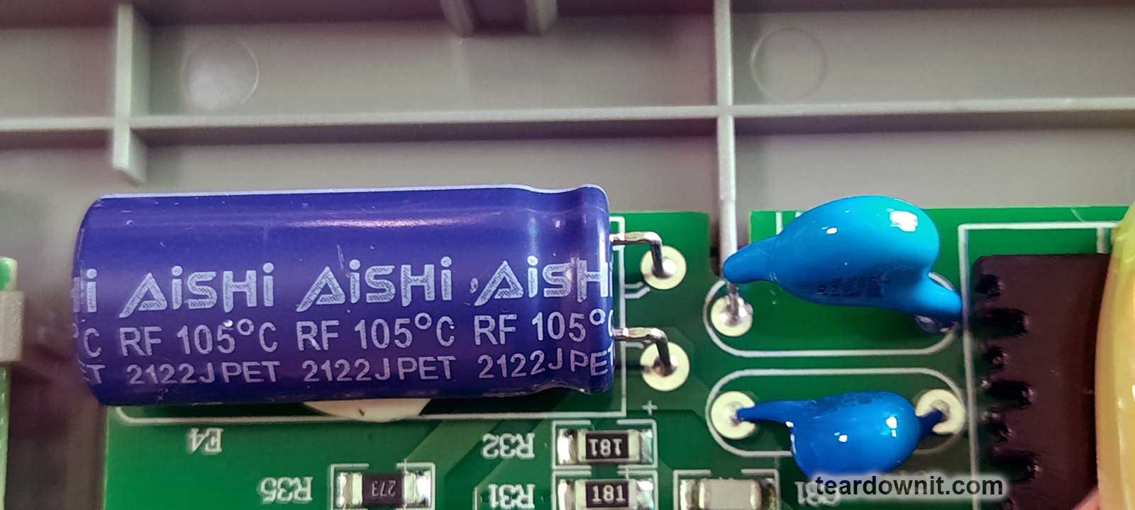

The input voltage is supplied to the input node: RF interference filter (1), a pulse surge limiter (varistor), then the voltage goes to the diode bridge (2) and two input electrolytic capacitors (3). The input voltage selector is also located here. Flyback, built on a MW03A controller (4, installed on the back side of the board) and a power switch (5) on a N-channel MOSFET transistor MMF60R290P. Unfortunately, there is no information about the controller on the Internet. The transistor has a channel resistance of 0.29 ohms at 650 volts and 13 amps. The transformer (6) is entirely covered by the casing, so it is unclear what core material is used. The output rectifier (7) is built using a Schottky diode HBR20150 in a TO-220F package screwed to the side wall and covered with casing. It is basically dual 150V 10A diodes connected in parallel. After the diode there are four output electrolytic capacitors (8) and an additional LC filter. Here (12), there is a small output voltage indicator (green LED) and a regulator (tuning resistor) for adjusting the output voltage. Input and output circuits are connected through a shared screw 7-terminal block (10). 3 terminals for the input line, neutral, and ground wires, and 2 in parallel for common and +24V output.
The main electrolytic capacitors are designed for operating temperatures up to 220°F (105°C), Rubycon. Two optocouplers (11) are installed in the feedback circuit, most likely with phototransistors transmitting control signals from the low-voltage output to the high-voltage input side.
The board has a few cutouts to increase the dielectric strength between the high-voltage and low-voltage sides of the circuit.
The picture shows that the board has three unused spots for storage output capacitors (8), most likely used in the other power supplies of the same series but with different output voltages.
The high stability of the output voltage should be noted.
Power-on parameters
The power supply is turned off at least 5 minutes before the test, with a 100% load connected.
- The pulse of the input current charging the input capacitors when connected to the grid has an amplitude of about 7.5 A and a duration of 2 ms.
- Waiting for the power supply control circuit to start for about 100 ms.
- (Output Voltage Rise Time) Starting the converter, increasing the output voltage, and entering the operating mode) is 8 ms.
(Turn On Delay Time) The entire process of entering the operating mode from the moment of powering on) is 119 ms.
(Output Voltage Overshoot) Output voltage overshoot is absent; the switching process is aperiodic.
02/14/2024 at 06:59 • 0 comments"PiEBridge" is an extension board for microcomputers similar to the Raspberry Pi (Pi), which is designed to be a helper for the DIY-maker in all his activities - Pi, together with PiEBridge, can perform a variety of functions:
- universal programmer
- software and hardware debugger for target systems
- PCB fusion furnace controller
- smart-home controller
- as well as do many other useful things
You might say Pi already knows how to do these useful things, so why does it need more extension boards? Here is the answer to that question:
- PiEBridge transforms the Pi's 40-pin I/O subsystem into more practical 6/10-pin lines for many applications and provides signal integrity for these lines
- adds the simplest controls and indications (button, pedal, and LEDs)
- has a programmable 2.5...5V power supply for external devices
"Naked" Pi is usable in two extreme configurations - either just a box controlled externally via SSH or a desktop computer with a monitor, keyboard, and often even a mouse. In addition to these typical use cases, PiEBridge allows you to use the Pi as a standalone software automaton to perform random repeating tasks with minor interactive operator participation.
PiEBridge is plugged into the Pi extension connector (compatible with family models with a 40-pin connector) and installed vertically. For this purpose, the Pi case (if available) must have a corresponding cutout on top.
When used as a programmer, PiEBridge can work with most known 6-pin and 10-pin connectors, and GND and Vcc can be randomly connected to their pins to ensure compatibility.
The programmable power supply for external devices is programmable on/off and programmable in the range of 2.5 - 5V with an accuracy of about 2%.
Deb-packages for PiEBridge have been created and compiled into a repository:
- general-purpose, providing configs and libraries for working with controls and indications, as well as with the power supply
- special purpose, e.g., applications for MCU and FPGA programming and debugging
- auxiliary purpose, for example, for repeating operations automation (like mass-production function for firmware flashing). In this case, the user can use settings that provide autonomous launching of the necessary software when the Pi is turned on, and then (after finishing its work) its simple parking and shutdown by pressing and holding the button for a long time.
- metapackages, which cause installation of necessary software and configs for the selected role and allow to simplify preparation for work
Reflectometers' characteristics: additional capabilities
02/06/2024 at 07:21 • 0 commentsThe accuracy of reflectograms, the reliability of the conclusions made, and the time spent on diagnostics largely depend on the set of additional functions of a particular device.
A modern reflectometer must meet the following requirements:
• have a decent amount of memory for storing reflectograms with workable resolution;
• be able to exchange data with a computer;
• have two channels for comparison and differential mode support;
• automatically calculate the return loss value.Other useful features that make the operator’s job easier, thus worth mentioning:
• automatic search for defects when viewing a reflectogram;
• automatic two-dimensional scale adjustment to fit the most significant defect found;
• distance measurement between two points or cursor positions on the reflectogram;
• registering transient or "non-persistent" faults.Introduced as another means to simplify the operation, some of the functions mentioned above had a revolutionary impact on fault localization techniques using reflectometers. So they are worth a closer look.
Saving reflectograms to memory
Thanks to this feature, measurements themselves do not require any specific knowledge, and qualified specialists can analyze the results later. Suppose the initial cable parameters were set incorrectly. In that case, the needed information can always be clarified, and using the saved data, the results can be reprocessed without going back to the site.
Data uploading to and downloading from a PC
Uploading data to the cloud or to a computer provides the possibility of archiving and further processing. For example, reflectogram files can be viewed, printed, scaled, compared, superimposed on each other or on a trace diagram, sent, etc. Reflectograms can be processed using proprietary (supplied by the manufacturer) and open (particularly graphic editors) programs. If necessary, files can be sent for analysis to a more experienced specialist. A critical point should be made: the reflectogram file can be loaded back into the reflectometer’s memory, for example, for comparison with a new reflectogram at the diagnostic site.
Dual channel
Two measuring paths allow one to take reflectograms simultaneously from two pairs and display them for visual comparison. Some devices also implement further processing of the received reflectograms.
Comparison and differential modes
These two modes greatly simplify the localization of the main fault against the background of numerous synchronous interferences (repeating reflections from the input of the device, reflections from couplings, inserts, branches, etc.). The amplitude of the signal reflected from the main fault in the line could be less than the amplitude of these interferences. Suppose one receives signals from both faulty and serviceable pairs of the same cable. In that case, their overlay (comparison mode) or subtraction (differential mode) will allow one to identify differing sections of the reflectogram, i.e., exactly those places in the characteristic where the faulty pair does not coincide with the working one and where the defect is probably located.
Differential mode is more convenient—the reflectograms of the damaged and good pairs are subtracted, which leads to compensation for almost all synchronous interference. It is much easier to identify differences this way than by eyeballing them. Using this mode, damage locations are clearly visible on the difference reflectogram.
If the device is dual-channel, both reflectograms can be obtained in real-time. Such devices are simply irreplaceable for localizing places where pairs have been damaged due to improper connection of wires (decoupling).In devices with built-in memory, comparison and differential modes are implemented using reflectograms obtained in real-time from two different channels of the device or by processing saved reflectograms created as a result of the last measurement and stored in the device’s memory. The latter mode provided a revolutionary ability to diagnose...
Read more -

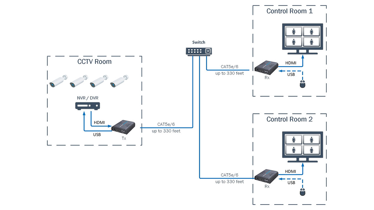

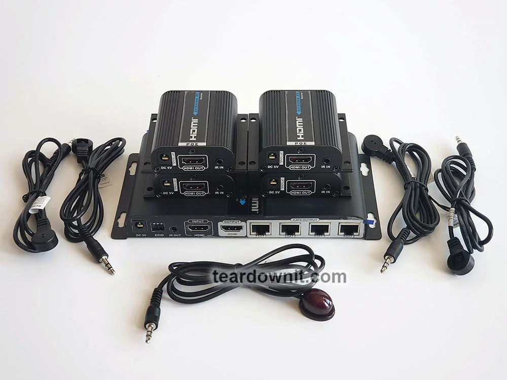

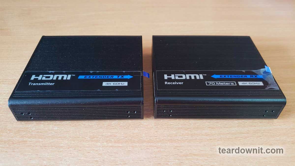

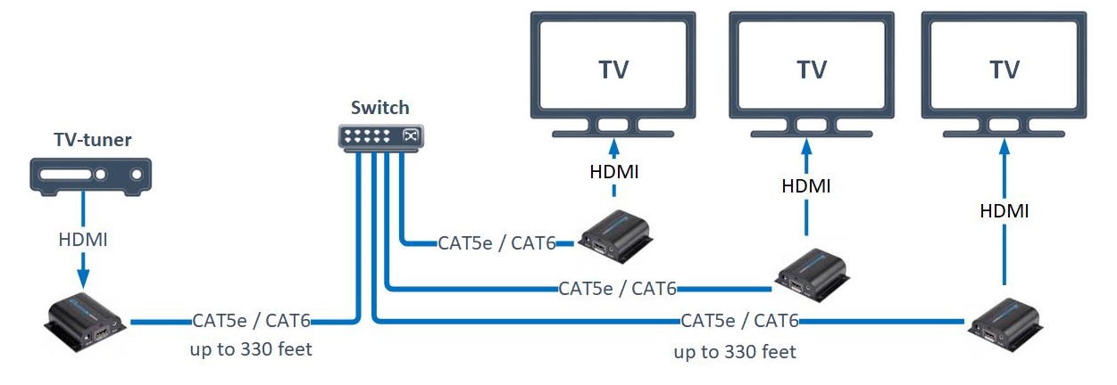

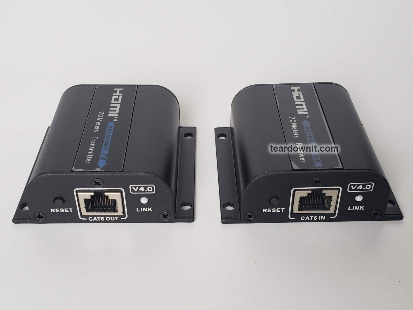

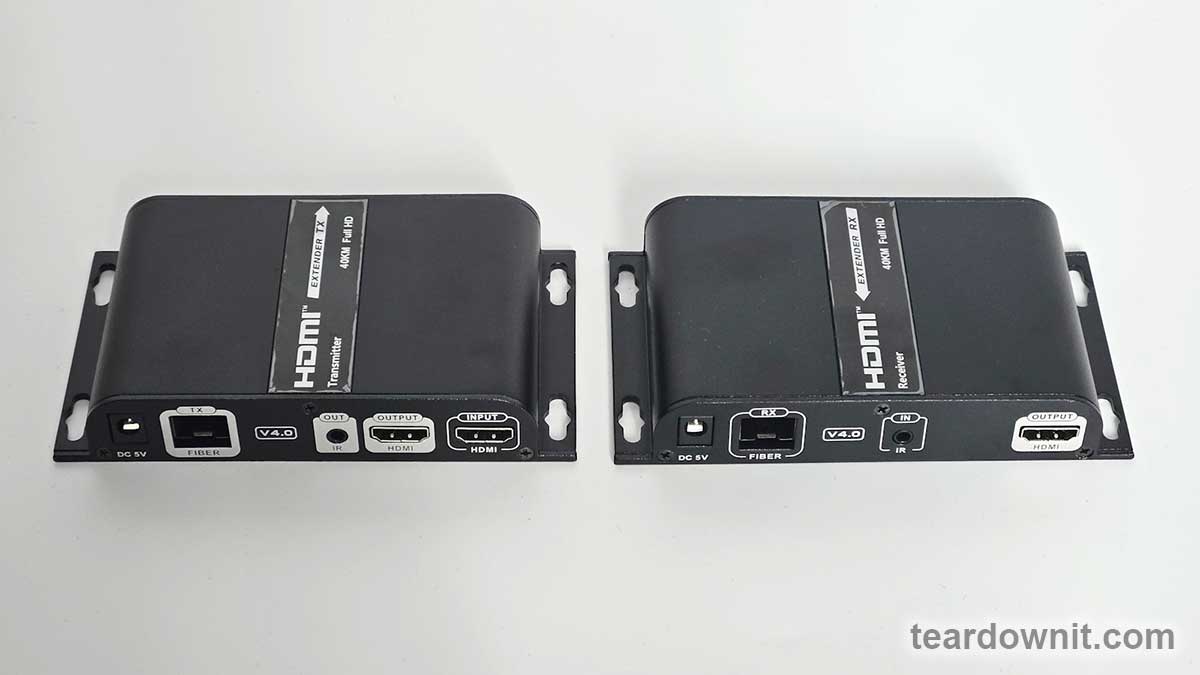

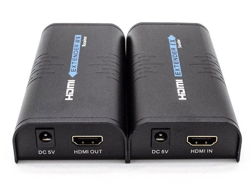

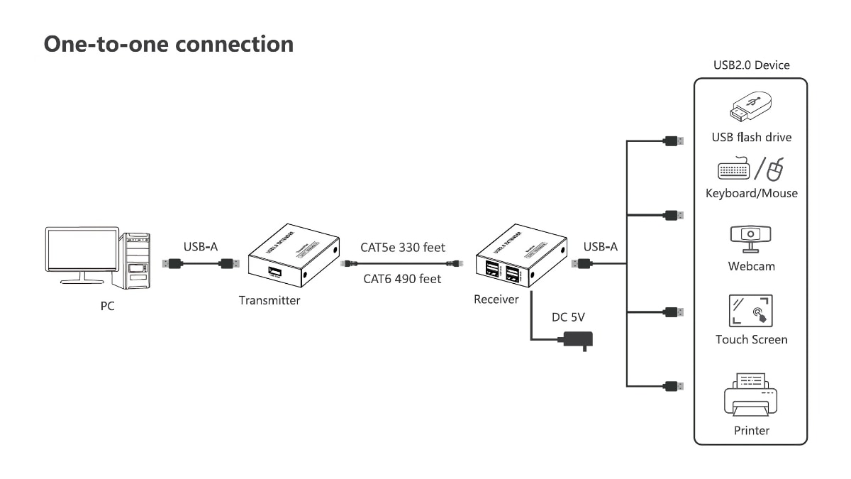

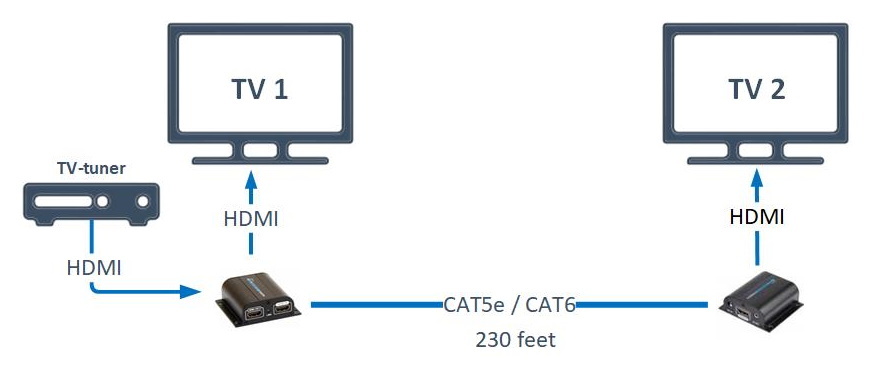

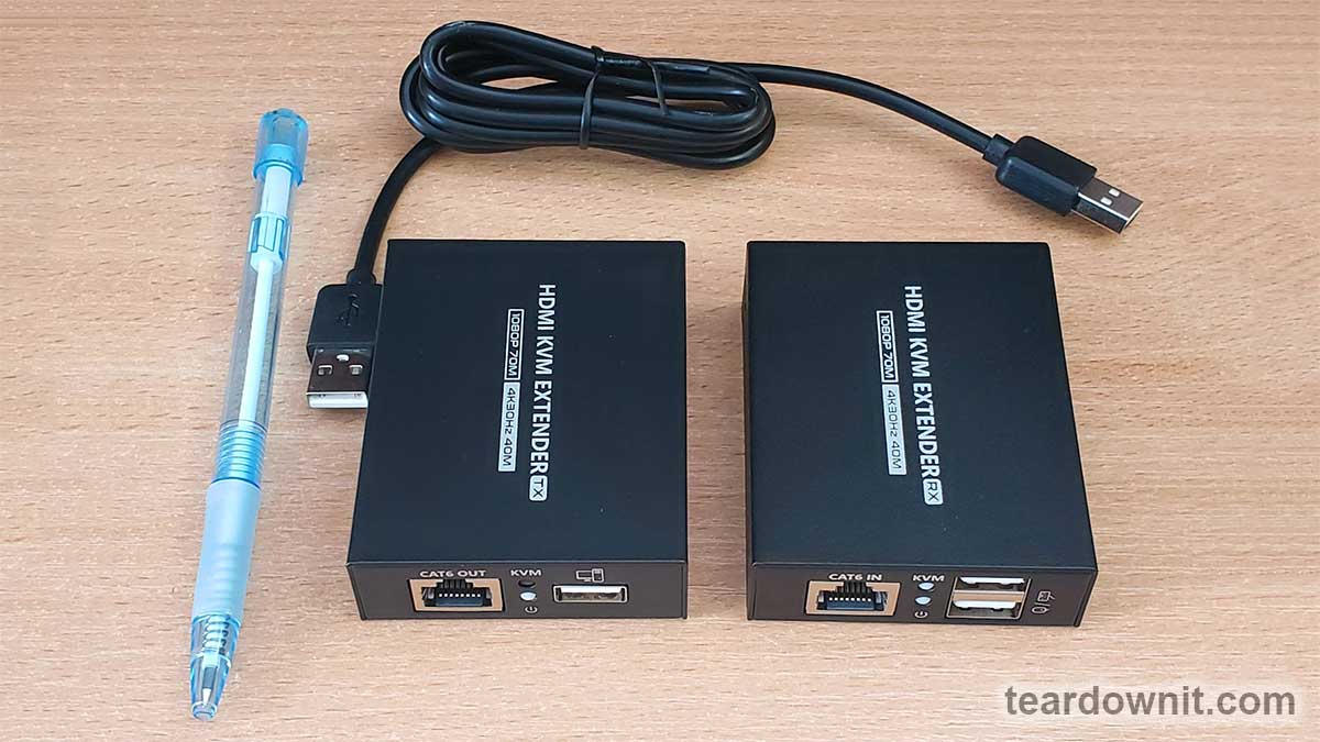

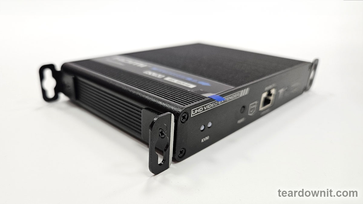

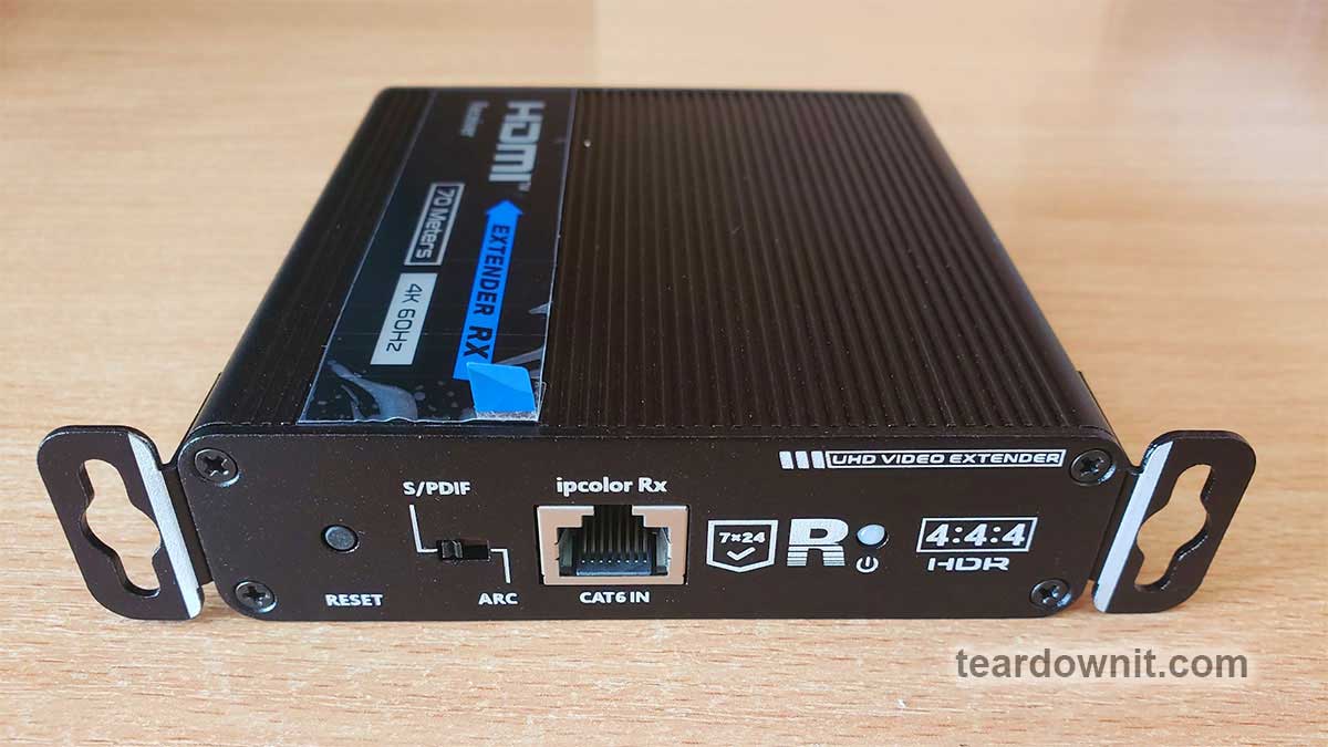

When is the best case for HDMI over IP extenders?

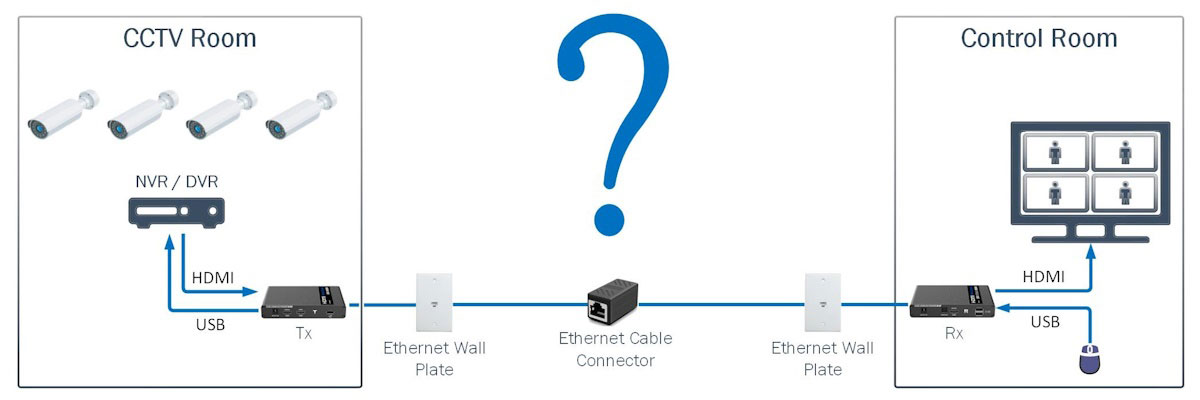

01/15/2024 at 07:40 • 0 commentsIntroductionWhy use HDMI over IP in some cases? The image quality is noticeably worse than a classic HDMI twisted-pair extender. Let's see a few examples and answer this together.
Previously, we have repeatedly compared two types of HDMI extenders with each other:
- HDMI over twisted pair cable
- HDMI over IP extender
The second type also works over twisted pairs, but it has the additional ability to operate in populated local networks.
Upon reading our posts, you may think using the first type of extender is always better. After all, it is indeed better in many respects: ideal video quality, no transmission delays, and many supplemental functions. The only thing is to stay within the twisted pair cable length limits, usually up to 330 feet.
But it is only sometimes the case.
Sometimes, having a separate twisted-pair cable from the video source to the TV makes it impossible to install a transmitter and receiver of the first type. But suppose there are available wired Ethernet sockets somewhere near both installation spots. In that case, the extender of the second type is a good option.
Sometimes, installers plan on remaking an existing LAN, adding separate twisted-pair cables for video transmission of the first type, and turning to us for advice. The initial idea is to disconnect two sections of twisted-pair cable from the router:
- from the video source to the router
- from the TV to the routerand connect both lines together.
At first glance, we will see a twisted-pair cable from the video source to the TV. So we should be able to use type 1 extenders, right? Although it is theoretically possible, the probability is extremely low.
We will have the following connection between the transmitter and receiver: HDMI transmitter - patch cable - LAN socket - twisted-pair cable - connector - twisted-pair cable - LAN socket - patch cable - receiver.
The first type of extender is very picky about the cable's construction and the connections between the transmitter and the receiver. Firstly, one must use twisted-pair cable of a category no lower than specified in the manual. This is usually CAT6, CAT6A, or better. Secondly, there must be a solid piece of twisted-pair cable between the HDMI transmitter and receiver with no breaks or lower-quality connectors, like wall sockets.
The second type of extender works like any other LAN device. So, we can use LAN sockets, patch cords, routers, and switches.
Of course, expensive professional solutions with low video compression levels exist. The quality of the video output from the receiver is hard to distinguish from the original. The transmission delay is almost invisible to the human eye. Such equipment has strict requirements from the manufacturers in terms of IP-network parameters; they usually do not recommend using an existing network.
In our post, we will skip this case and look at more down-to-earth options for the average user.
So what are you going to do if laying a separate whole piece of twisted pair is not on the options list? First, you must determine what you will connect to the remote TV. Suppose this is a DVR located somewhere in the attic or garage. In that case, you can safely use an HDMI over IP extender connected to the existing LAN network.

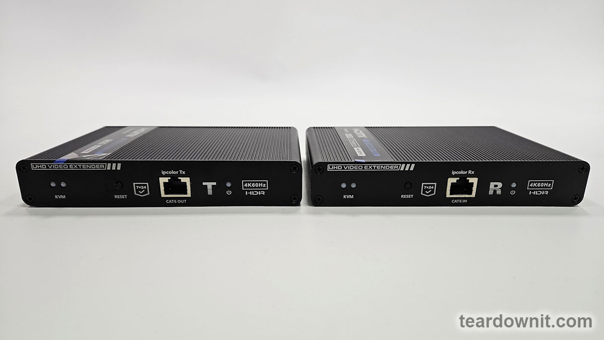

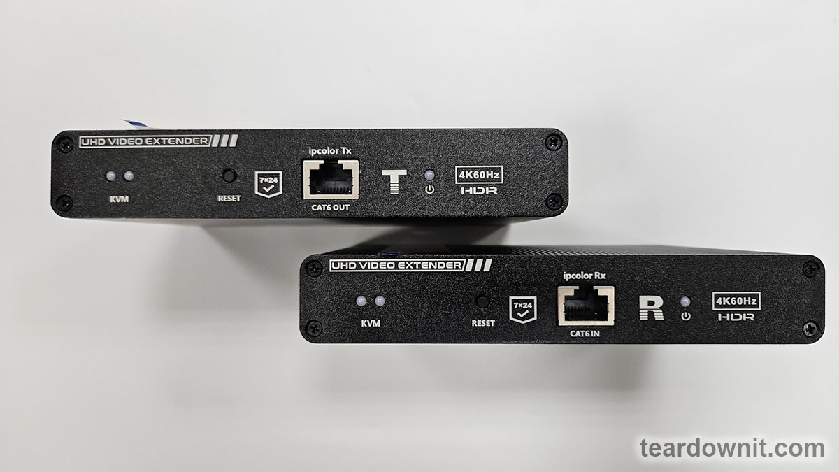

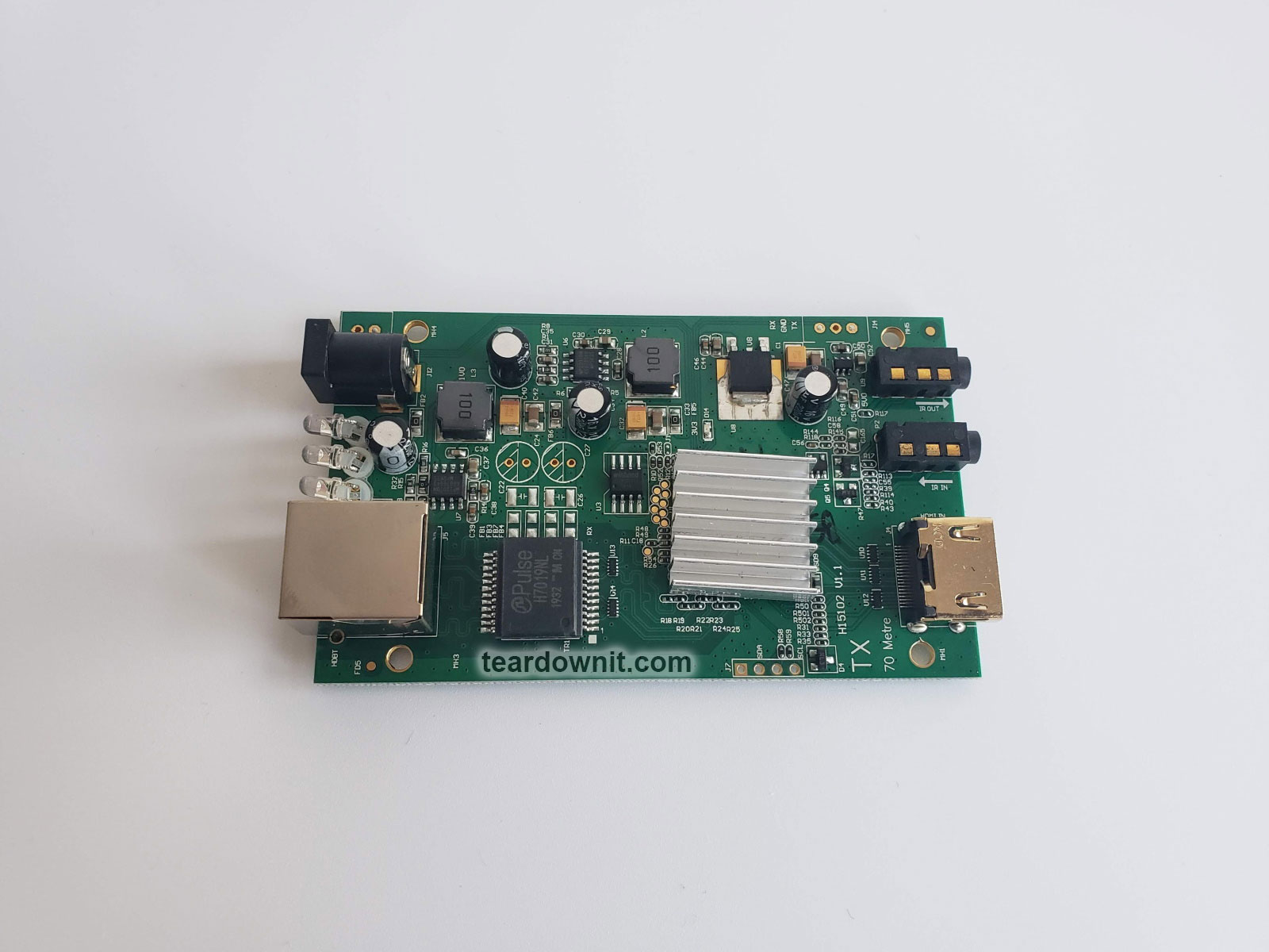

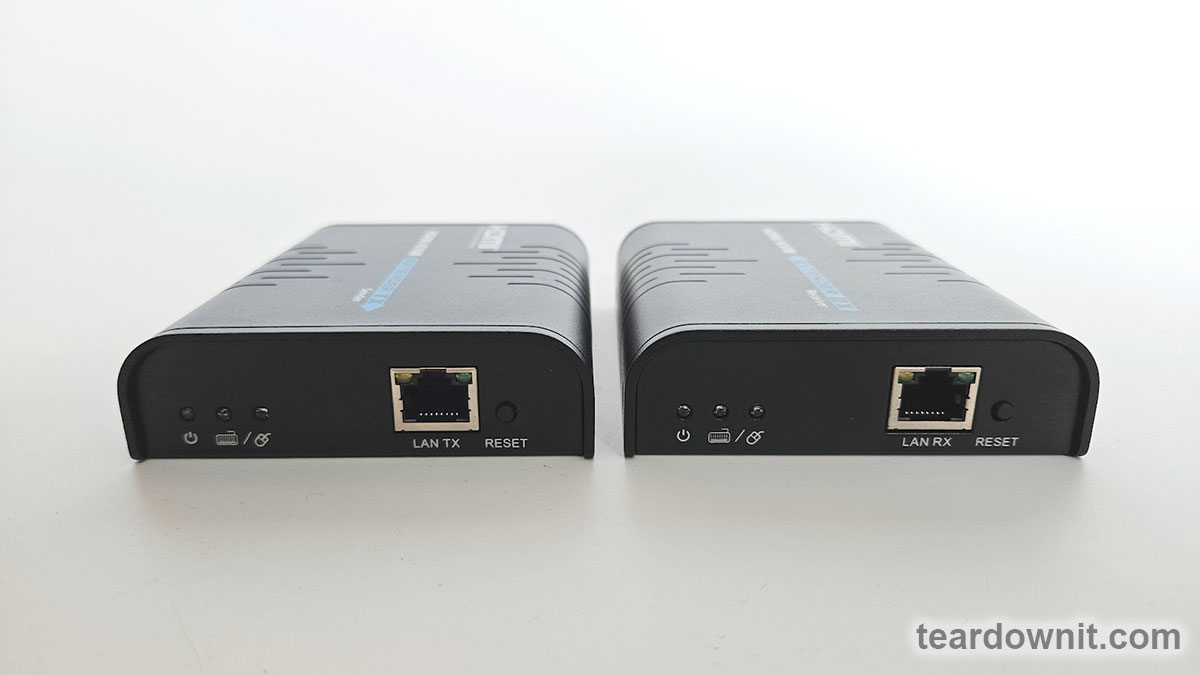

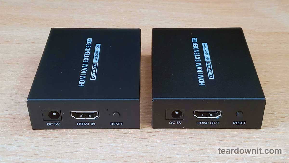

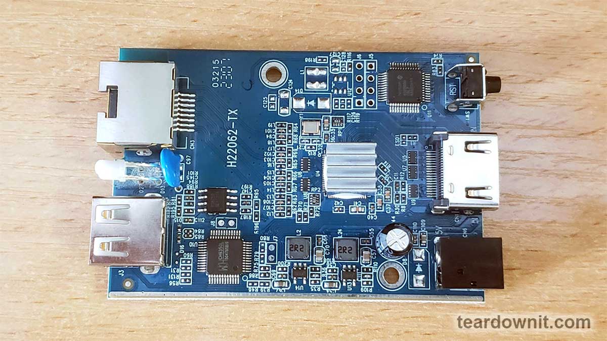

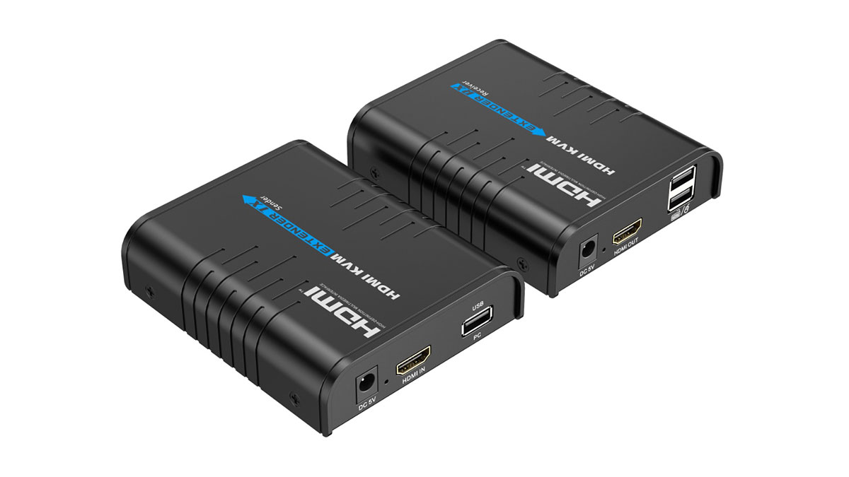

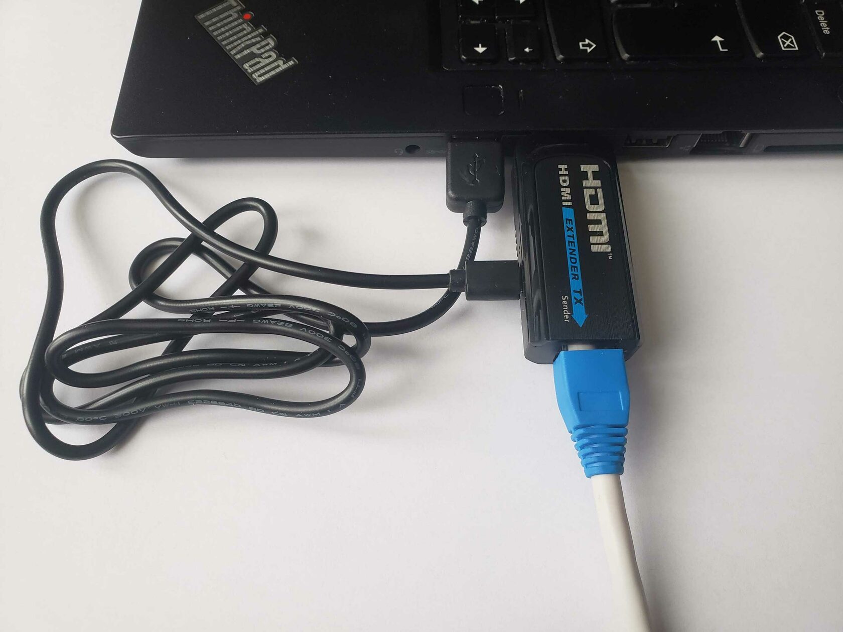

Let's look at one of the devices of this sort and try it in real-world conditions. We'll use the INRIKS EX2073KVM extender as an example.

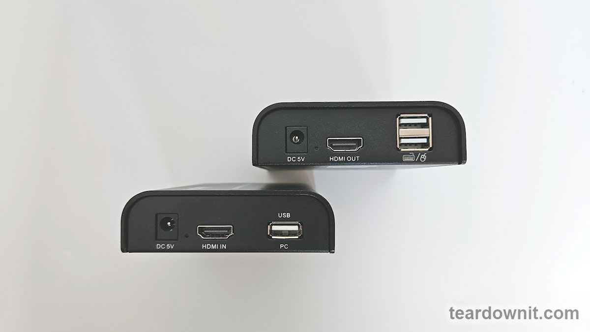

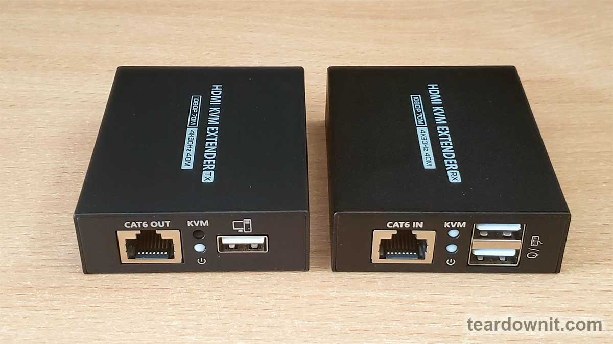

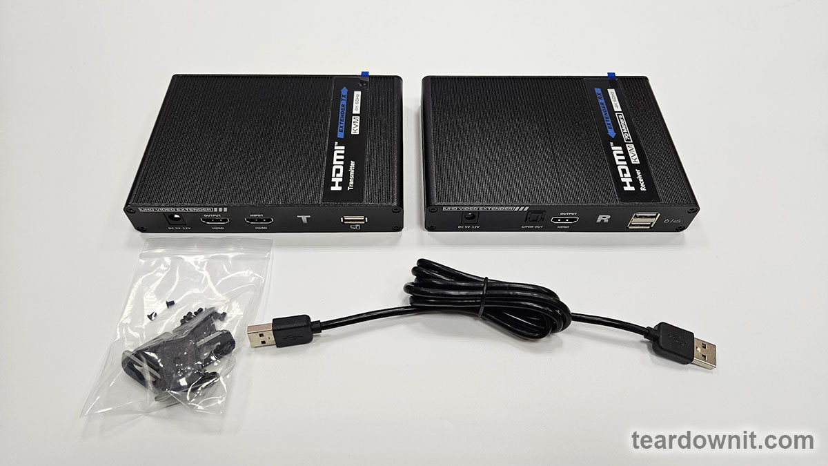

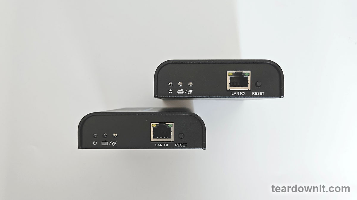

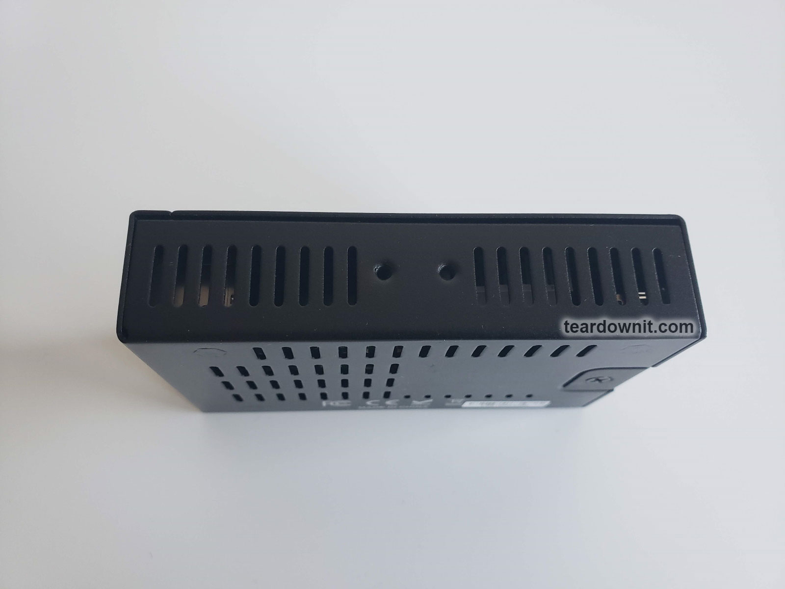

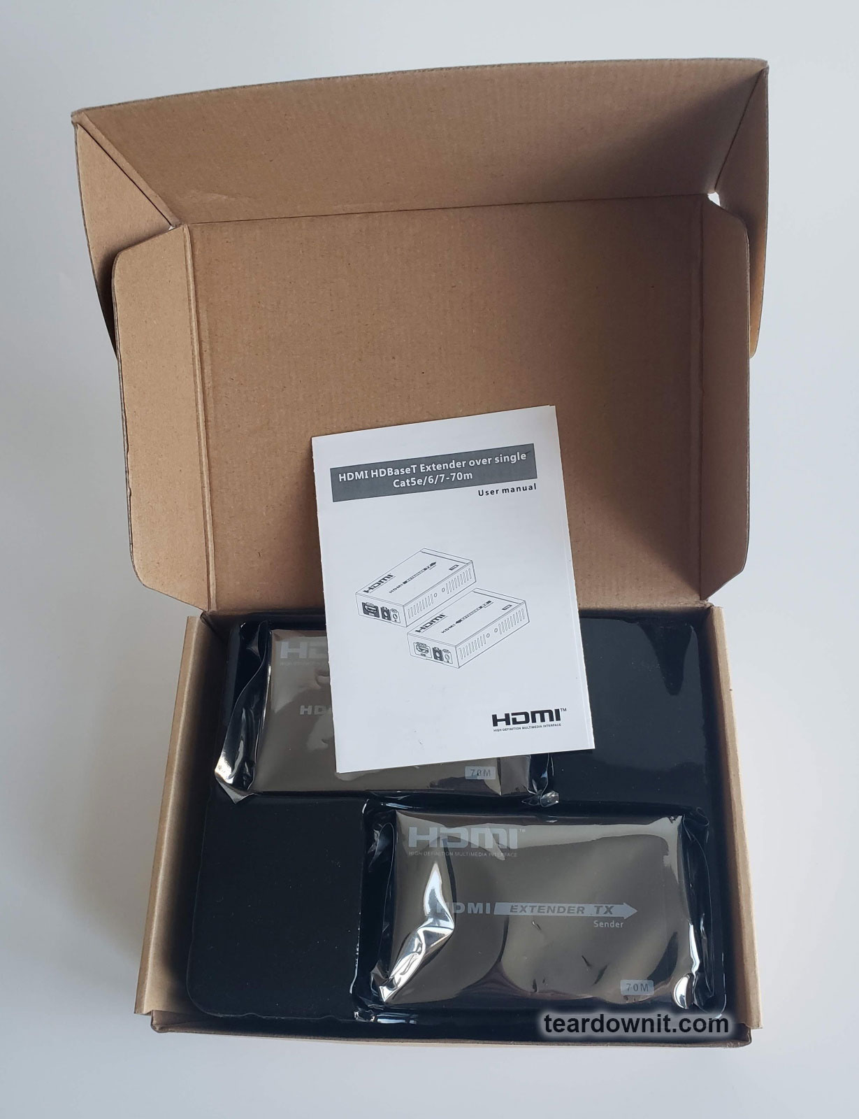

Device description
The INRIKS EX2073KVM is an HDMI and USB transmitter and receiver kit twisted-pair cable with a range of up to 390 feet. The kit operates "over IP," so the receiver can be connected to the transmitter with a single piece of twisted pair and via a local network.
The maximum video resolution is 1080p at 60 Hz.
In addition to video, the EX2073KVM can transmit a USB 1.1 signal, which is sufficient for a USB keyboard and a USB mouse.
Let's look closer at the package contents and the typical connection.
Visual overview
As usual, the HDMI...
Read more -
Reflectometers for metal cables: noise filtering, propagation coefficient, and its determination methods
01/10/2024 at 07:36 • 0 commentsLet's see how the cables measure influence the range of the reflectometer. How do the noise filtering mode and methods for determining the unknown propagation coefficient affect the measurement accuracy?
KEY FACTORS FOR CABLES
The reflectometer's detection range depends on the cross-section of the cable cores, the overall quality of the cable, as well as on the way the reflectometer is connected to the cable being tested.
The larger the cross-section of the cable cores, the less attenuation the electrical pulse supplied by the reflectometer to this cable undergoes and the longer the distance it covers.
Old or defective cables may have reduced insulation resistance or increased attenuation. This significantly reduces the ability of the cable cores to conduct electrical signals and, as a result, reduces the maximum distance.
The connection of the reflectometer to the cable must be done so that a pulse with the maximum possible amount of energy is emitted from the reflectometer to the cable.NOISE FILTERING
I want to eliminate the noise in more detail, as it is on any cable. Many reflectometers have a digital noise filtering mode that obliterates the noise from 50 Hz to 1 GHz. This mode is designed primarily for lineworkers dealing with cables near sources of strong electromagnetic interference (for example, railway contact networks, power lines, or antenna poles). The operator can select a filter type with the required characteristics for each test to ensure the acceptable quality of the resulting reflectogram.
Suppose an unexpected random voltage value appears in the line during the measurement. In that case, the noise-filtering mode gets turned on automatically.
A multi-level and multifunctional filtering system allows one to check antennas and cellular nodes with some received signal interference.In some cases, the noise-filtering subsystem may slow down the OTDR operation to such an extent that the display becomes unusable. A good example is filtering the noise the power supply induces (60 Hz). One period of alternating current with a frequency of 60 Hz is 16.7 ms. Therefore, it also takes 16.7 ms to generate one point on the reflectometer display. It will take no less than 5.12 seconds to refresh all the 256 image pixels on the display. One way to compensate for this delay is to store the denoised reflectogram. Writing data to the device memory will take some time, but subsequent operations will be as fast as if the filter were turned off.
The "averaging" mode, often provided by the manufacturer to eliminate interference at maximum gain, is no exception. This mode also decreases the refresh rate of the display. Four times less noise means the screen is refreshed sixteen times slower. When the image refresh speed is reduced significantly, it becomes difficult to work with the display, so this mode should be used only when necessary.
One more thing to mention: cables for digital data transmission should be tested using short pulses with a duration of 2, 10, or, in extreme cases, 100 ns. They do not affect nearby pairs under load, so the data transmission devices' error detection system will not flag them as such.PROPAGATION COEFFICIENT AND METHODS FOR ITS DETERMINATION
As already mentioned, the reflectometer determines the distance to the abnormal spot based on the signal propagation speed in the cable and the time it takes to reach the point in question and return. In most cases, speed is expressed as a unitless coefficient, the ratio of the signal propagation speed in a given cable to the speed of light. It is an empirically determined value. Reflectometers from different manufacturers require one to set the wave propagation speed, called the Velocity of Propagation (VOP) or Velocity Factor (VF). Typically, this parameter is expressed as a fraction of the speed of light and can have a value from 0.3 to 1. A cable with a VOP value of 0.66 allows an electrical signal to be transmitted at 66% of the speed of light. Some manufacturers...
Read more -

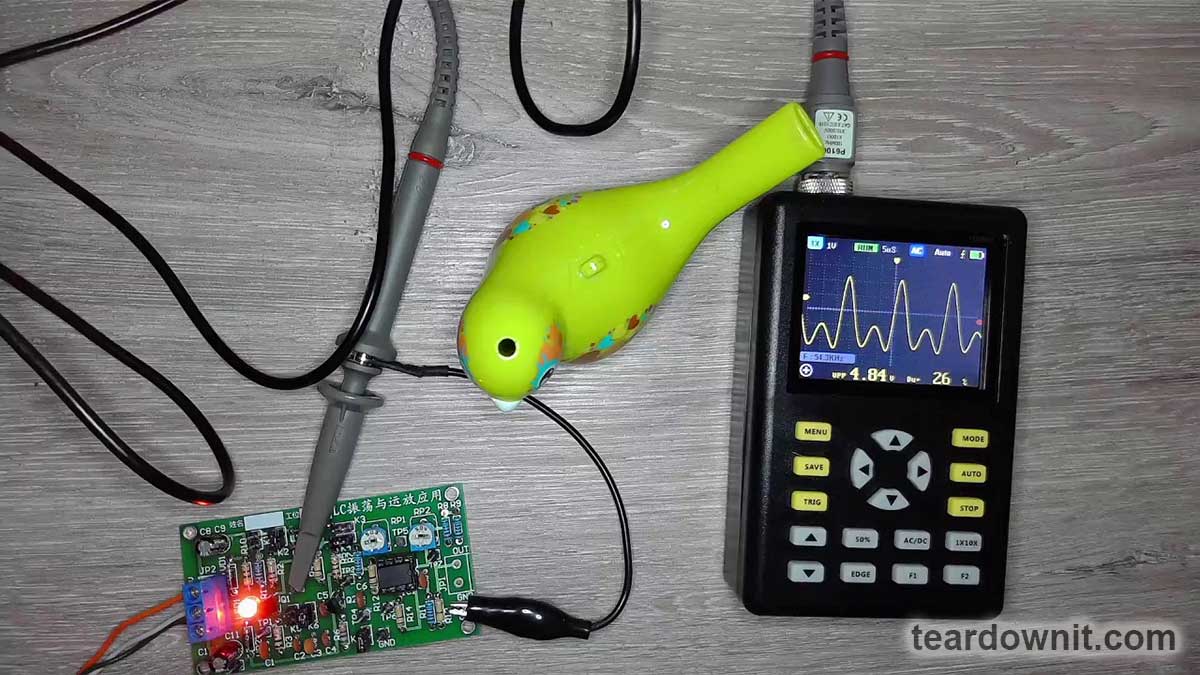

12/13/2023 at 07:41 • 0 commentsSignal distortion induced by electronic devices, primarily amplifiers, could be either undesirable or useful.
When we play back an audio recording, we want it to sound as close to the original as possible. Or sometimes, we want to add just a smidge of tube distortion.
On the other hand, magnetic recording on tape and mechanical recording on vinyl, by their nature, significantly alter the sound; therefore, distortions are deliberately added into the circuits of recorders and playback equipment so that, in the end, the resulting audio signal turns out to be indistinguishable from what has been recorded.
In addition, volume controls are equipped with loudness compensation to account for human hearing abilities.
Mobile pocket audio devices have tiny speakers, and their power amplifiers are specifically designed to add bass and limit treble so that the sound is deeper and less squeaky.
Multi-way speaker systems have filters, and sometimes even separate amplifiers, that slice the sound signal into frequency bands for each dedicated speaker: subwoofer, low-frequency, mid-frequency, and tweeter. These can also be considered deliberately created distortions.
Finally, processing an electric guitar signal requires numerous fine-tuned distortions. They form a wonderful guitar tone. But if we simply plug the best electric guitar into a hi-fi amplifier, we'll be disappointed.
One can also identify a malfunction by the specific distortions of the signal and, by tracking the signal flow, specify the location of the malfunction in a complex circuit.
A device that allows you to see distortions is called an oscilloscope. But having an oscilloscope is not enough; we will also need a standard waveform signal generator. Today, we will assemble three such generators.
So-called standard waveforms are sine, triangle, and square. Devices that generate such signals are called function generators.
A sine wave is the simplest signal, but it is the most difficult to create without an LC resonant tank, using only RC circuits. A pure sine wave oscillates one frequency; it is needed to determine the harmonics the circuit adds to the signal.
For example, in this image from the post about the tube amplifier, we see that the upper half-wave is wide and rounded, and the lower half-wave is narrow and pointy. This indicates the presence of a second harmonic, which makes tube amplifiers sound so beautiful.
A triangular waveform could be created by a ramp voltage generator. Such a signal allows one to see nonlinear distortions as lines bend on the oscilloscope screen.
Bending them a certain way brings the triangle line closer to a sinusoid. This is exactly how the function generators on microchips that we are studying today are designed.
An ideal square wave consists of vertical and horizontal lines. Looking at the flow of such a signal, one can see the frequency-dependent deviations, interference, and parasitic processes.
For example, a differentiating circuit with a time constant of an order of magnitude smaller than the period of the input signal creates a sharp peak at the beginning of the horizontal section.
And this is what the result of the operation of an integrating circuit with a time constant comparable to the signal period looks like.
If the integrator time constant is noticeably smaller than the signal period, then only the leading edges become sloped, and the top part of the square wave remains flat. In this oscillogram, we see additional high-frequency interference.
Here, we see not just high-frequency noise but damping oscillations excited by sudden changes in the input signal. Such vibrations are called "ringing".

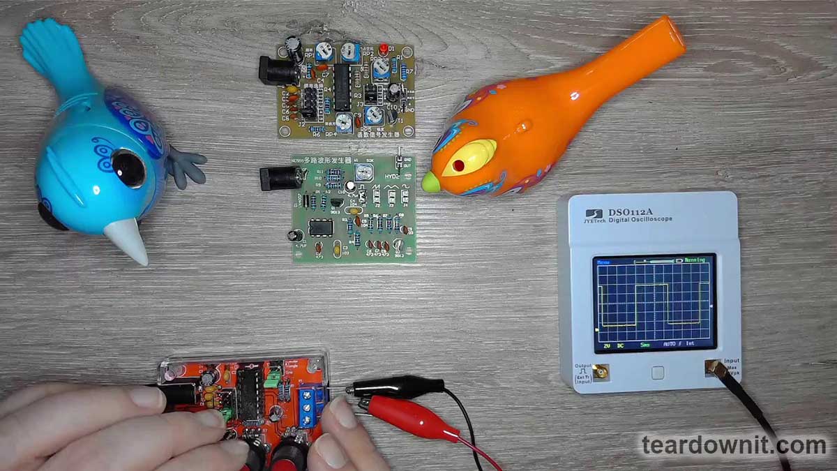

Function generator on the XR2206 chip
Our first generator can produce electrical oscillations with frequencies ranging from 1 Hz to 1 MHz. This is more than enough for an amateur's lab.
The 300 kHz square wave we have here is distorted not by the generator itself but by the DSO112A oscilloscope, whose analog bandwidth is 2 MHz....
Read more -
Reflectometer's characteristics: sensitivity, accuracy, resolution, working distance
12/06/2023 at 07:28 • 0 commentsThe reflectometer's capabilities in terms of maximum distance and damage detection accuracy are determined by the sensitivity of the amplifier and some other important parameters.
Amplifier sensitivity
The sensitivity of the reflectometer, along with the pulse amplitude, is one of its most essential characteristics. It determines the maximum operating range of the device. It is crucial if you're going to check cables with high signal attenuation.
Technical documentation often skips this parameter or describes it very vaguely. In an ideal scenario, sensitivity should be characterized as the input voltage when the waveform on the instrument display is contained between the top and bottom edges of the screen (i.e., “x mV for full-screen deviation”).
Vertical sensitivity is sometimes measured in decibels. The decibel value is relative and has no meaning unless given a reference level of 0 dB. With this data, the amplifier's sensitivity can be calculated, as each 6 dB step doubles the gain.
Based on the parameters mentioned above—pulse amplitude and amplifier sensitivity—it is possible to calculate the maximum overlapped line attenuation, which also serves as a criterion for assessing the quality of TDR.
The maximum overlapped attenuation (amax) is defined as the line attenuation when the deviation of the vertical beam is at least one-eighth of the full screen. In this case, amax is calculated using the formula:
Amax = 20 lg8 + 20 lg(Upuls/ampl),
- Amax is the maximum attenuation,
- Upuls — pulse amplitude under load Zo,
- Vampl — amplifier sensitivity for full-screen deviation.
It should be mentioned that this method can only be used to compare reflectometers from different manufacturers. It will be impossible to accurately calculate the maximum attenuation overlapped by the reflectometer using this method since the attenuation in metal cables is frequency-dependent. Therefore, different duration pulses will correspond to different Amax values.
The covered method for estimating overlapped attenuation better suits optical TDRs. Optical fibers have frequency-independent attenuation, and therefore, in optical time domain reflectometers (OTDR), the pulse amplitude and sensitivity of the photodetector are usually not taken into account; they are "integral" parameters of the device. A parameter called "dynamic range" is introduced instead, i.e., the insertion loss of the line, at which the signal-to-noise ratio SNR = 1 for a certain duration of the probing pulse. To widen the dynamic range of OTDR, one needs an increase in probing pulse power and the receiver's sensitivity, as well as a very specific set of digital processing algorithms developed by the manufacturer.Resolution and accuracy
[illustration from viavisolutions.com]
Before discussing the issues related to resolution and accuracy, some basic concepts should be defined.
Display resolution is the interval between two consecutive dots on the screen.
Fault detection resolution is the minimum distance between two consecutive faults to be visible as separate faults on the reflectometer display.
Sampling precision is just the precision with which samples are carried out.
The term "fault localization precision" also speaks for itself.Fault localization precision
The accuracy of finding the fault in the vast majority of real-world cases is limited by the availability of reliable information for the cable being tested and not by the sampling precision or display resolution of the reflectometer.
Read more
Firstly, the pulse propagation coefficient can only be known with an accuracy of a few percent, and on top of that, it is affected by temperature changes. A 1% error in setting the pulse propagation coefficient leads to a 1% error in determining the distance.
Secondly, the limited information on the actual cable route, in turn, limits the user’s ability to find a point along the cable... -

The first project objective is to create extension boards for Linux microcomputers with GPIO, containing minimal indication and control elements and a small connector for connecting external devices with unified access to them.
Why do you need a board like this?
- In most practical applications, the extension connectors of these microcomputers are redundant. For example, a cursory review of published Raspberry application projects shows that you will often find that 10-pin will suffice.
- For the same reason, the same 40-pin connector is impractical (and more often - simply impossible) to install in the target device, and this means that somewhere, there must be a transition, a bridge to a smaller connector.
- Serial matching is very useful (and sometimes necessary) when connecting devices, for which, for example, Segger has a special adapter. Raspberry has no matching elements, so they must be placed somewhere. By the way, these elements (resistors) are useful for another important reason - they effectively reduce the risk of GPIO damage.
- A microcomputer, equipped with a minimalistic interface on a few LEDs and buttons, is freed from the monitor, mouse, and keyboard from the constant "tutelage" of the host-PC and becomes a handy standalone tool for a pervasive class of routine and cyclic tasks, such as:
- programming, diagnostics (JTAG interface provides access to various pins of the chip, which allows the creation of the necessary test conditions (logic levels on the pins) and reading the states; general tests are also possible),
- electrical training (test (usually cyclic) operation of the device in specified modes. For example, at the initial moment of the device lifetime, detection of hidden defects is most possible (semiconductors, switching, etc.), so "runs" of devices in the correct modes at the factory and workshop are necessary to ensure that consumers receive the best quality devices by filtering out defective devices back at the factory), etc.

INRIKS EX4076KVM 4K HDMI KVM twisted-pair extender review.
11/20/2023 at 07:16 • 0 commentsFeature description

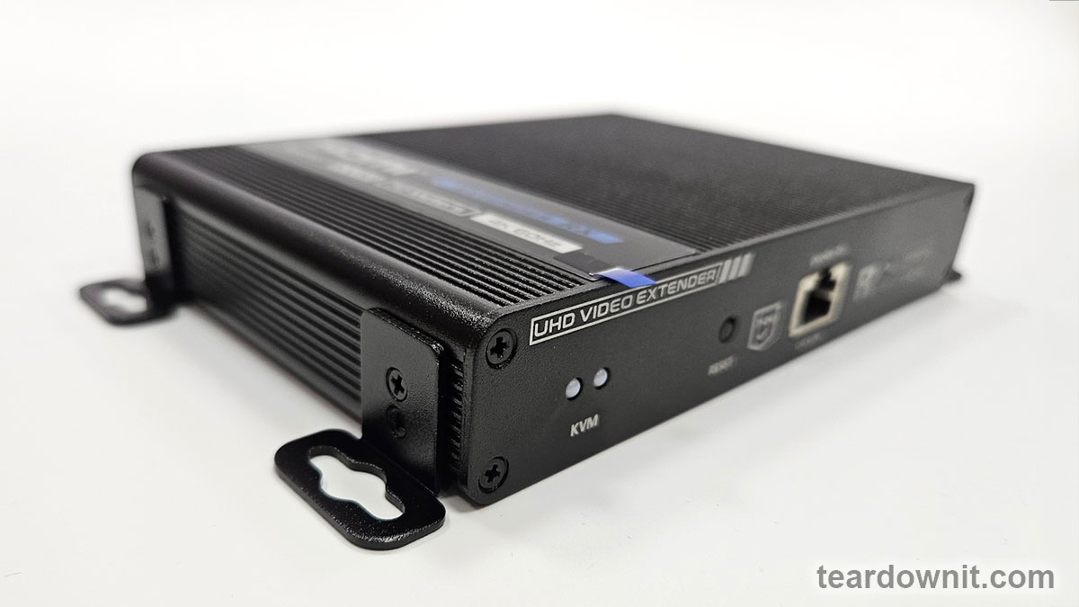

The INRIKS EX4076KVM is a transmitter and receiver kit that allows HDMI and USB signals to be transmitted over twisted-pair cables for up to 230 feet.
Specsheet claims the maximum supported video resolution is 4K at 60 Hz.
The transmitter has an HDMI pass-through output port. It can help connect a nearby TV or monitor.
The receiver has a digital S/PDIF output for connecting an audio system.
The manufacturer does not specify the version of the USB standard. We assume this is USB 1.1, intended for connecting low-speed devices like a regular keyboard and mouse. So, the webcam most likely will not work with such an extender, but we will check it anyway.
Let's take a closer look at what's in the box and how everything connects together.
Visual overview
As usual, INRIKS ships out the EX4076KVM kit in a gray cardboard box with a brief description on a sticker.
Inside the box, one finds the transmitter and the receiver neatly tucked in soft-touch plastic baggies. Those are rare for INRIKS packaging, usually saved for a higher-level lineup of extenders.
Under the plastic tray, there are two PSUs, a USB cable, and a set of mounting brackets with a bunch of screws.
So the full kit of the INRIKS EX4076KVM is:
• Transmitter unit - 1 pc
• Receiver unit - 1 pc
• DC 5V/2A - 2 pcs
• USB Cable - 1 pc
• Mounting brackets - 8 pcs
• Screw - 18 pcs
• User manual - 1 pcThe transmitter and the receiver are both medium-sized, not compact, but feel solid in your hand. It's easy to spot high manufacturing quality right away. The entire case is made with minor grooves for better heat dissipation.

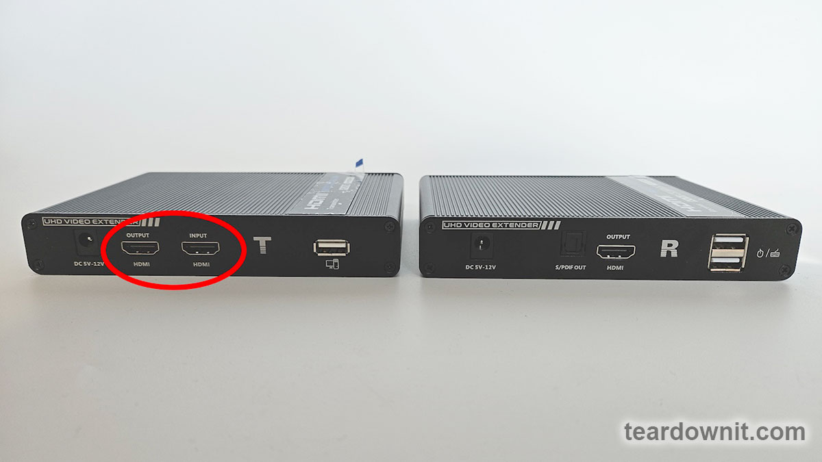

One side of both the transmitter and the receiver has the same set of interfaces, left to right:
• a pair of LED indicators for USB (KVM) signal transmission and reception
• Reset button
• RJ45 port for twisted pair connection
• LED power indicatorOn the opposite side of the transmitter, left to right:
• power connector DC 5V-12V
• HDMI output for a local TV
• HDMI input for connecting a video source, PC, or DVR
• USB port for connecting to a video sourceThe opposite side of the receiver, from left to right:
• DC 5V-12V power input
• digital audio output (S/PDIF)
• HDMI output for a TV
• two USB ports for a keyboard and a mouseOne can call it just a standard set of interfaces, except for the loop-out HDMI on the transmitter and S/PDIF digital audio output on the receiver.
We have already covered the HDMI loop-out function in a separate post. It is basically a 1 to 2 HDMI splitter built into the transmitter.
It can connect a reference monitor, displaying the video identical to that transmitted over a twisted-pair cable to another room. Suppose you want to stream the same video simultaneously to both the remote room and the room with the video source (PC or DVR). In that case, you can do it easily with no external HDMI 1-to-2 splitter or additional cables needed.
As for the S/PDIF audio output of the receiver, this option will be of little use to anyone connecting an HDMI KVM extender to a DVR. Although it might be helpful to someone.

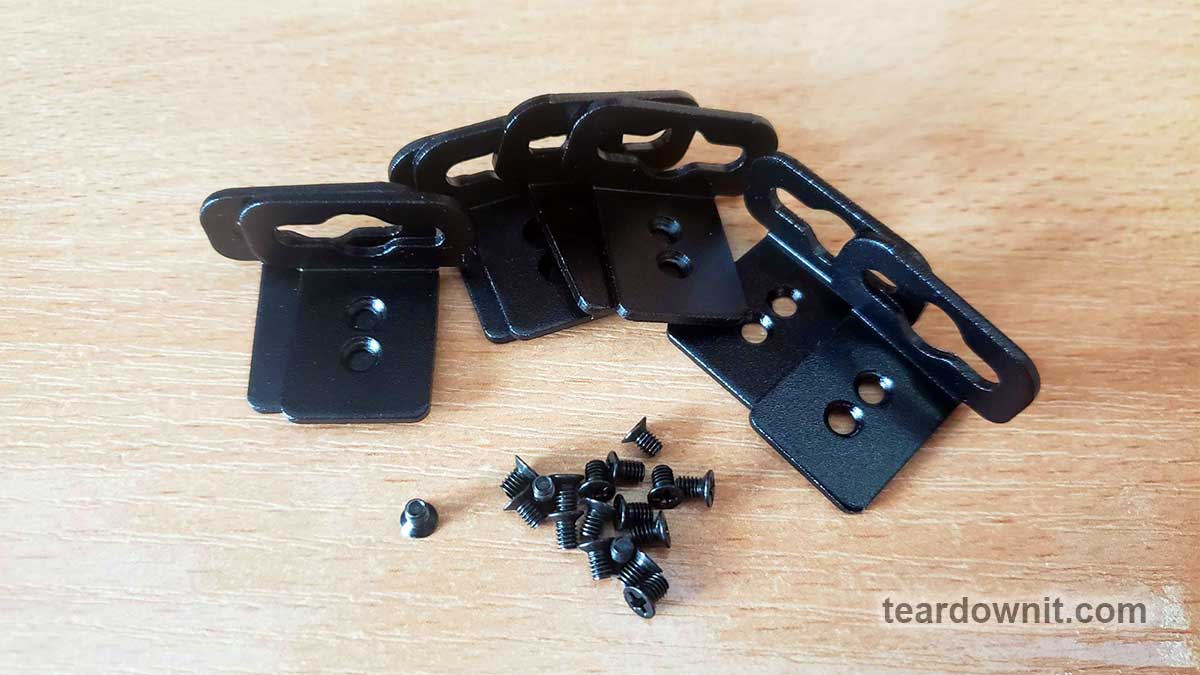

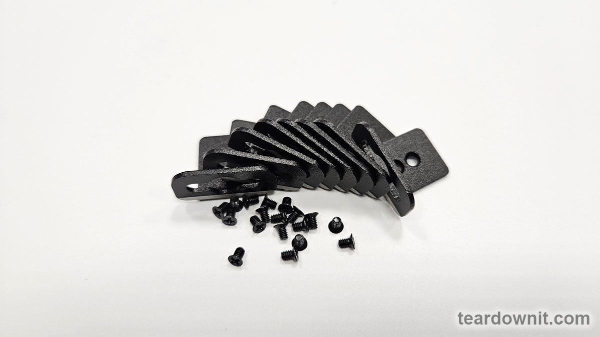

The sides of the housing have mounting holes for screws. The possibility of adding the brackets and the fact that they are included are undeniable advantages of this kit. With them, you can securely fix the transmitter and receiver to horizontal and vertical surfaces.
The holes allow the mounting brackets to be positioned in two planes, as shown:
The first option of bracket placement is used to secure the device to a horizontal or vertical surface by the majority. However, some professionals will be very grateful for the ability to install brackets...
Read more -

How does one control a single DVR from two remote rooms?
11/01/2023 at 07:22 • 0 commentsWe have already covered the topic of connecting a monitor, mouse, and keyboard to a PC (server, laptop, or DVR) at a great distance. The best option is to use an HDMI KVM extender over a twisted-pair cable.
With its help, one can complete the simple task of installing a DVR in one place, a monitor, keyboard, and mouse in another, and controlling the DVR remotely. In other words, using twisted pair cables, one extends HDMI and USB interfaces by 200–300–400 feet.
But what if the person needs to connect two different remote workstations for CCTV operators so that every one of them can see the image from the DVR and control it?
Let's try to solve this problem in practice using HDMI KVM extenders over twisted pair and see if it works out.
Required digression
First and foremost, I'd like to note that HDMI KVM twisted pair extenders come in two main types:
1. The transmitter and the receiver are connected to each other directly by a single piece of network cable. Such setups guarantee almost perfect image quality without any visible video distortion or transmission delays for HDMI and USB signals.
2. The transmitter and the receiver are connected to the local network. Both units encode and decode video signals, which, although just a smidge, negatively affects the image quality and increases the transmission delay, so one can feel a slight lag when using the mouse.We think it is always better to try to use the first type of extender. Such devices deliver the best user experience of all.
On the other hand, sometimes, running a single dedicated twisted-pair cable between the transmitter and receiver is not at all possible. In this case, your only option is the second type of extender. Obviously, you'll need a LAN connection available on both ends :)
Therefore, we'll experiment with both types of extenders separately.
Extending the HDMI KVM interface to two different spaces with a one-piece twisted-pair cable
To assemble such a system, we used a pair of INRIKS EX4076KVMs. The kit includes a transmitter and a receiver. The INRIKS EX4076KVM can transmit 4K 60 Hz video with USB KVM up to 230 ft.
Thanks to the HDMI pass-through port on the transmitter, we can connect two transmitters, one after another, to the DVR. This way, we don't have to use a splitter to duplicate the HDMI signal.
As shown in the diagram below, we have connected all of our equipment.
Everything started working after powering on the equipment and a little initial delay. This startup delay is for all the video devices to sync. The video quality on the remote monitors was perfect; both mice worked simultaneously. We consider this test to be passed.
Extending the HDMI KVM interface to two different spaces over the LAN
We took two HDMI KVM extenders for this case over LAN INRIKS EX2073KVM. The kit extends 1080p 60Hz video and USB KVM over a network cable for up to 390 ft.
It should be noted that the kit uses an IP network, so we can use LAN switches to increase the transmission distance even further. For example, when using a single network switch, the distance will be "up to 330 ft." — "LAN switch" — "up to 330 ft."
Another advantage of HDMI extenders over LAN is streaming the signal from a single transmitter to multiple receivers ("one-to-many connection" in the manual). All the receivers will get the same picture from the transmitter.
We'll try to make use of this feature in our scheme. That means we'll need just the receiver from the second INRIKS EX2073KVM kit.
The manufacturer also states that although many EX2073KVM receivers can be present on the LAN, the mouse should be connected to only one of the receivers at any given time; the remaining ones are just there to show the image. We will check whether this claim is valid.
We have connected all of our equipment as shown in the diagram below and, according to the manufacturer's recommendations, just one mouse.
There is a short pause after powering up to sync all the devices, and everything's working as intended....

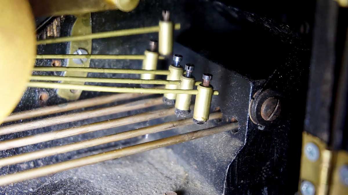

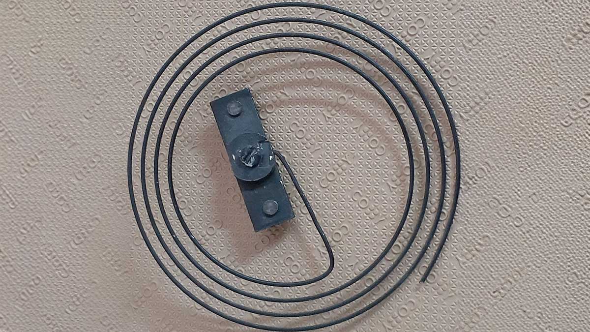

We are accustomed to the fact that a string is a stretched wire. But in a striking clock, the string is a metal rod, fixed on one side and not tensioned. The bass string in the clock is called "gong"; it can be very long and twisted like a spiral to fit into the case
The guitar's soundboard and neck combined are also very massive strings compared to the actual strings. And it's made of wood for the most part, so it is much less hard and dense than regular metal strings.
So, the Q-factor of the soundboard and neck oscillating system is much lower than that of strings. Meaning that the natural frequency vibrations of the guitar's neck and body decay much faster than the vibrations of the strings.
Therefore, wood has minimal effect on the actual sound timbre of an electric guitar. The signal passes through pickups, cables, pedals, an amplifier, a cabinet, and then a microphone with an equalizer; it's safe to say that wood does not affect the frequencies.
The sustain time of the body and neck's vibrations is much shorter than any noted time, but it is comparable to the attack time when one hits the string with a pick.

The reflectometer measures the reflection of a signal. This method for cable damage detection complements all the others we've previously discussed and, in some cases, gives more accurate results, especially when locating wire entanglements or breaks and looking for non-persistent faults. Furthermore, it allows one to clearly identify several individual problems when they interfere with each other, as well as determine the range of each one of them.
Reflectometers' principle of operation
The reflectometer detects irregularities in any wire line (in particular, in a symmetrical twisted pair) by measuring the reflected signal. To do this, short DC electrical pulses are applied to the cable pair being tested. Suppose there is an imperfection in the cable. In that case, some or all of the energy of the original DC impulse is reflected back. Both the sent pulse and all of its reflections are shown on the display. Impedance abnormalities could be of various origins; each of them has a unique reflection pattern. Thanks to this feature, it is possible to determine from the shape of the reflected signal not only the location but also the nature of the fault.
This principle of determining the state of a cable pair based on the parameters of the reflected pulse is called time domain reflectometry (TDR). At its core, it is identical to the radar principle used in radio systems.
The method of measuring the signal at the output of the line being tested (also called the incident wave method) provides only an integral assessment of the line's condition. It requires two devices: a generator on the transmitting side and a signal meter on the receiving end. On the contrary, reflectometry, firstly, allows one to estimate the quality of the wire at any point of its length. Secondly, a measuring device is needed only at one end of the line. This latter feature is the key for TDReflectometers to become as widely used as they now are.
To determine the distance to a particular fault spot or just an impedance abnormality of the cable, one needs to simply set the propagation coefficient and measuring range. The propagation coefficient defines the speed of the electrical impulse going through the cable of a particular type as a reference for the reflectometer. After capturing the impulse, the device will automatically calculate and display the distance to the damaged point of the cable.
Before looking into all the quirks and features of reflectometers, it is helpful to briefly describe the key features of a simple symmetrical twisted pair cable, as they are directly related to the reflectometer's operation.
It is well known that any symmetrical pair is a two-wire electrical line, and it is described as a chain of primary sections connected in series. Each section is a simple circuit, a four-pole unit consisting of active resistance R, inductance L, capacitance C, and active conductivity G.
When a harmonic signal circulates in a twisted pair circuit, the voltage-to-current ratio at each point is called the input impedance of the twisted pair. If a twisted pair is loaded at the end with a resistance equal to
where w=2pf, then it's input resistance will be equal to Zc anywhere along the line.
