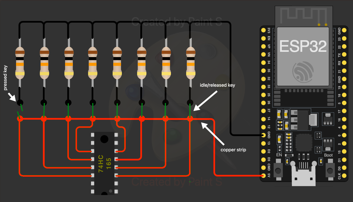

As I mentioned in the previous log, I am going to use an NC (normally closed) circuit for the treble keyboard of the accordion.
The idea is to have something like this:
I kept the other wires out of this diagram for the sake of simplicity (the 74HC165 shift register needs to be connected to the ESP32 too).
So, when the key is idle, the circuit is CLOSED, hence NC. When you press a key, that circuit is OPEN.
To test this I found a very ingenious approach based on https://www.instructables.com/simple-normally-closed-switch/. It uses wooden pegs as NC switches, amazing! Right?
Piece of advice: those drawing pins are sharp and can hurt you, that is why I have inverted their position in the wooden peg.
For the copper strip, I am using the melodica reeds, since it is made of metal and was in hand. As I am not a good solderer I decided to connect the keys' resistors mechanically only (a.k.a. twisting the wires together).
And here is the result (I found it amazing :D)
Next step: make the real keyboard!

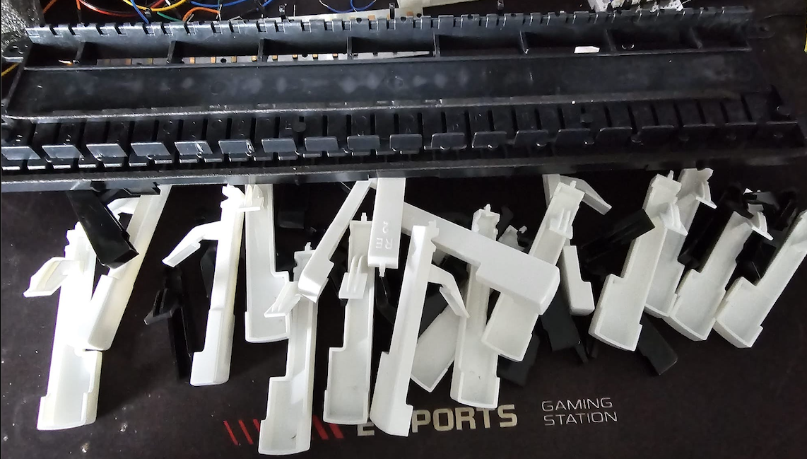

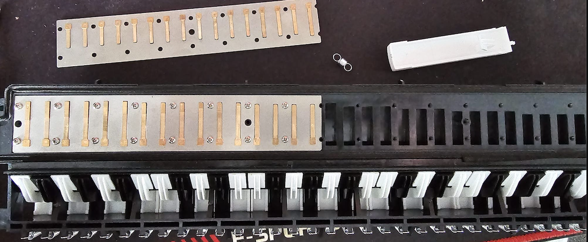

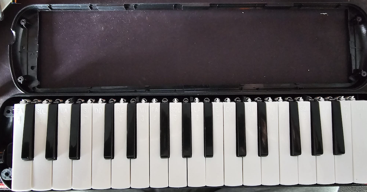

Long-story-short: I bought this cheap plastic melodica to be the treble keyboard of my Arduino Accordion. Why? It is cheap, has 32 keys, starts at note F (like most of the 41-key real accordions do) and it is cheap (again).
I disassembled it and here are some pictures:
I am genuinely surprised with the build quality, it is sturdy, and it is good! It is not like those kids' keyboards people transform into MIDI controllers, this has individual keys, felts to damp the keys and prevent unwanted keystroke sounds and a very interesting mechanism that could allow me to implement a velocity-sensitive keyboard, although I won't do it on this project, not now at least.
This is the key mechanism in action:
As you can see, two contact points can be used as a switch: the back of the key, where there is a valve that opens when you press it and right below the key tip, which requires you to press the key completely to create a contact. That is why I say you can make it velocity-sensitive, you can have both contacts per key and measure the time between them to calculate the note velocity. But that would require 64 inputs (2 per key) and I am good for now.
I will only use the valve as a normally closed switch, where the key is the negative (ground) and a copper conductive strip is the positive (VCC). It will make sense when I show my proof-of-concept working!

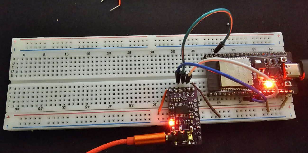

After trying many different libraries I finally settled on https://github.com/shorepine/amy
It just works, it is simple to use, and has a great variety of patches (I am using the Yamaha DX7 Accordion in the video) and is event-driven, so it is a breeze to develop for.
Here is the repo https://github.com/campidelli/arduino-accordion, you can check the other branches where I have tested:
They all have pros and cons, but I found Amy the easiest to work with.
Here is the video with the accordion sound!

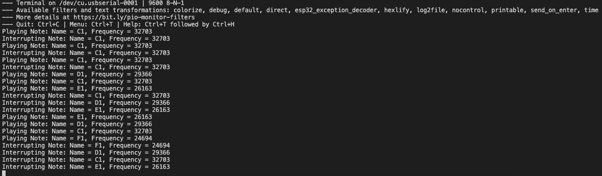

Quick one here, now it is polyphonic!
Here is the sound (I am trying to replicate this recipe from Floyd Steinberg, not there yet).
And the sketch (that only works like this, when I try to separate it in classes it doesn't perform well):

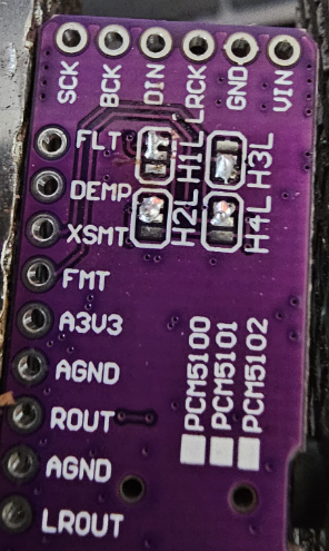

Is it Polyphonic? Hum, sort of? I mean, it plays the four notes at the same time. Is it pleasant to hear? Nope, not at all (yet!).
Here are all the pieces together:
And the sketch that is producing this wonderful sound haha:

But there is more! Now it is time for the PAM8403 and speakers! Here is a demonstration:

So, I need a matrix (or 2) to multiplex those buttons and use fewer pins.
Therefore, I can have a matrix of 4x8 for the treble keyboard (32 keys) and another matrix of 8x9 for the Stradella bass (72) buttons.
4 + 8 + 8 + 9 = 29 pins! Maybe it is feasible, maybe it is not and I will need an actual multiplexer or use 2 ESP32 boards? Who knows? I will eventually find that out.
It would be something like this, from the brilliant Rafael Corvino, a fellow Brazilian like me (https://www.instagram.com/corvino_acordeonmidi).

Anyway, I don't have the Melodica yet (yes, it will be my keyboard) nor the buttons for the bass, I will start small, a 2x2 matrix with diodes to prevent ghosting, this video explains it brilliantly:
This is my little prototype, it looks silly but it was hard for me to get there, I made this mistake https://www.reddit.com/r/ElectronicsRepair/comments/103pfk8/im_building_a_keyboard_matrix_with_a_micro/ but now it is okay!
I only have 4 buttons for now (still waiting for the Temu order to get here :)
This very simple program shows the buttons states, you can press them all at once, neat!
