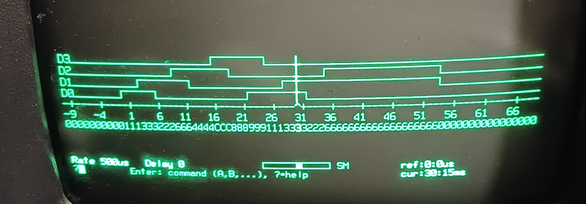

This KayPro-based "Omni4" logic-analyzer is pretty impressive, for its time... And still certainly usable/useful. 20MS/s on 16+ channels...
30 years old, and it booted up right away, despite having its diskette clamped in its heads for probably decades.
I can't find much on the ol' interwebs about this machine, so it's plausible this is amongst only a few remaining system-disks on the planet!

FLOPPY DISK IMAGE HAS BEEN SUCCESSFULLY EXTRACTED.
