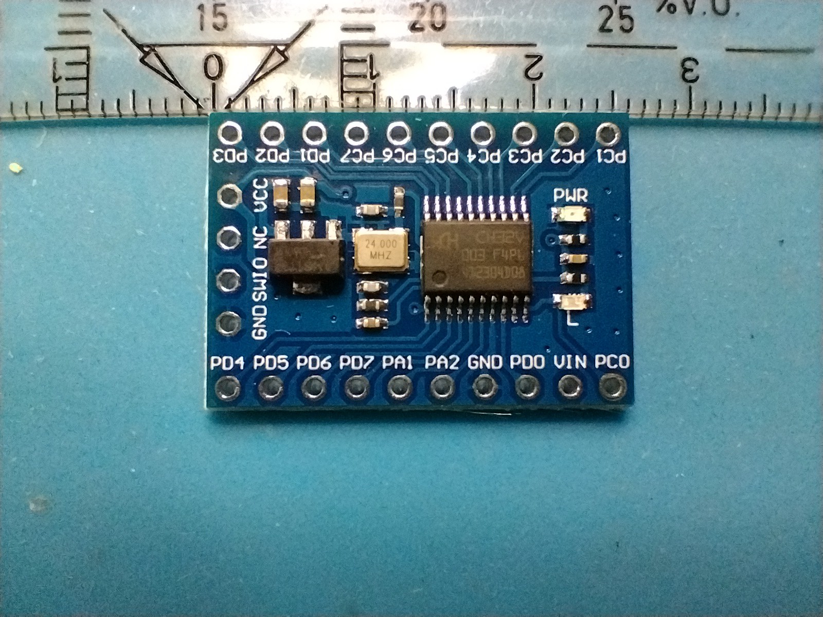

Now we get to the actual hardware that I've decided to develop for. The CH32V003 family is one of the offerings of the Nanjing Qingheng Microelectronics company. These MCU ICs got the attention of developers and hobbyists for their low price. This family of 20 pin and below MCUs aims to capture some of the base functionality MCU market, which coincidentally or not, have 003 somewhere in the model name, e.g. STM8F003, STM32F003. Higher members of the CH32V family offer more peripherals and more pins.
If you go shopping in the usual bazaars, this is a module you will commonly see:
Another variant has a TSSOP-20 package instead of the QFP-20 package in the middle. Notice the 3 pins to the programming dongle.
I've decided to go for the module shown in the topmost picture, one of the BTE series made by a different factory. It doesn't have the USB-C connector but has an onboard 24 MHz crystal which could come in handy for more precise timing.
I've decided to not attempt to design around the bare MCU but use the BTE module as a component. They pack more on the module than I could with my SMD soldering skills and sell it cheaper than I could buy the components for. You can see how small it is, about the size of a 20 pin 0.6 inch DIP IC. A price of tens of cents for the bare MCU is tempting, but so is the price of only a dollar or two, quantity 10 shipping included, for the module. Tested working too. The drawback is that these module will raise the height of the entire assembly if pulgged into Dupont pin sockets, unless I'm willing to solder them more or less permanently onto the base PCB.
