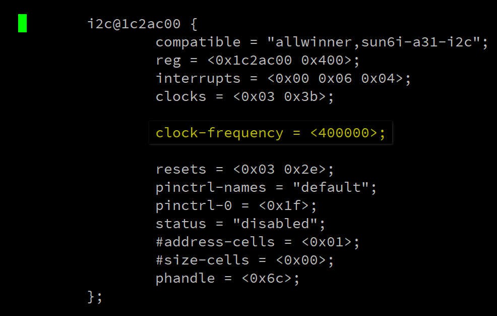

sudo emacs sun8i-h2-plus-bananapi-m2-zero.dtsSearch for the section that controls the I2C0 configuration. In this case I2C0 is the one at address 1c2ac00. How do I know that? By having searched further in the DTS file being edited for "i2c0" and finding the corresponding address reference. For BPI-M2-Zero in this case:
i2c0 = "/soc/i2c@1c2ac00";![]()
If it doesn't already exist in the I2C0 control block, insert the clock-frequency parameter...
clock-frequency = <400000>;... so that it looks like the screenshot below. So far, I've tried both 100000kHz and 400000kHz and validated the resulting SDC frequencies using a multi-channel logic analyzer.
At this point, save the file and exit the editor.

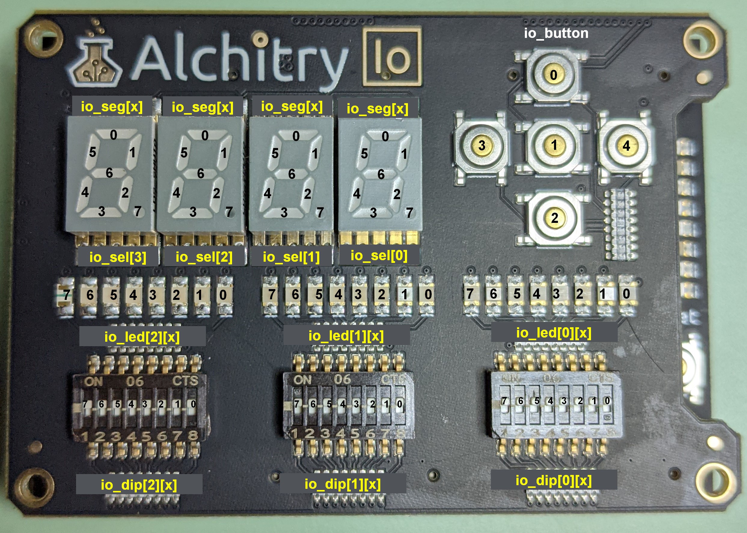

Alchitry IO Element Graphic Layout
01/09/2021 at 01:59 • 0 comments![]()
