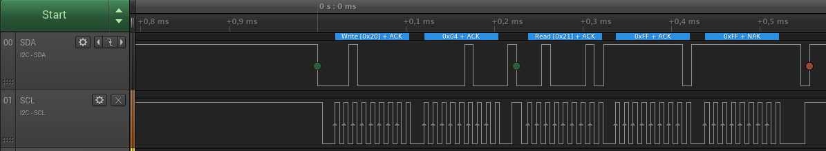

- The problem with the STM32 Arduino tool chain is that it doesn't send a repeated start. It sends a stop instead, followed by a start. This may be ok for most of the I²C devices, but the VEML7700 doesn't allow it.
- We might want to try a SoftWire I²C library on the STM32 as a workaround. I patched the SoftWire library to get the repeated start working. You can find the library here.
- Unfortunately, another problem arose : the SoftWire I²C library doesn't work simultaneously with the DCF-library. The DCF-library relies on the 1ms timer interrupt. The SoftWire library prevents it from working correctly in some way.
Capture from Wire I²C on Arduino Pro Mini : the VEML7700 returns data, there's a repeated start (green dot), not a stop after sending the address (0x04). In this case the sensor returns 0xFF, 0xFF. These values change...
