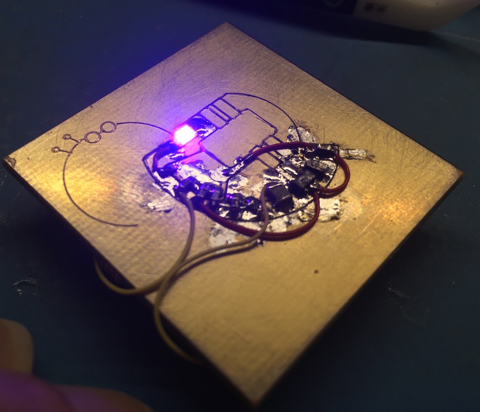

As of 2024's Supercon 8, the machine has been operational for around two weeks and I have used it to produce a few dozen test boards, and three working circuits, one of which came together the night before leaving for Pasadena and one of which I designed and fabricated at the conference. The first two circuits are the most interesting, and use tiny DFN 74HC595 shift registers driven by ESP32C3 XIAO boards running Micropython to blink a bunch of 0402 LEDs. Board One uses yellow LEDs and a single shift register:

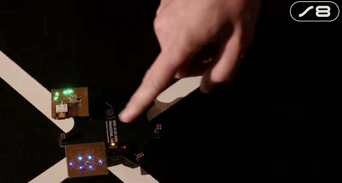

... while Board Two uses green LEDs in a more interesting pattern and two shift registers:
And an update, from Pasadena on the morning of my talk! I also used it to design and fabricate Board Three, a simple add-on with a Supercon8 theme, which I'll add a photo of here at some point. Perhaps the first custom machine-fabricated circuit board to be made at the conference? I can't imagine no one brought a desktop mill at some point, so I won't claim that yet.
Here is a video clip of the mounting pads for the XIAO getting carved into the first board. Keen observers will note that I did this after assembling the delicate shift register bits, a dicey proposition for the only working artifact produced at that point by a machine I wanted to show off in a few weeks:
As seen above, there are still fundamental limitations to the process which are shared with other home-gamer techniques: no vias, no solder mask, and in this case, no singulation. Carving circuits also needs a thorough trip through optimization-land; the whole process is quite finicky, requiring careful pressure adjustment and minor razor-blade fixes on perhaps 10% of traces. The concept would also benefit from more specialized toolpathing to reduce the chance of tearing up the corners of traces at right angles (among many other minor tweaks). Think of this as super-duper-early-stage research that just had completed its first spiral; the field is pockmarked with hastily covered rabbit holes, some of which may be filled with gold (or gremlins, to be fair).
But all faults can be forgiven when one sees the adorable and satisfying tiny chips getting produced during operation (okay, technically this is a shot from the manual test jig, but you get the idea):

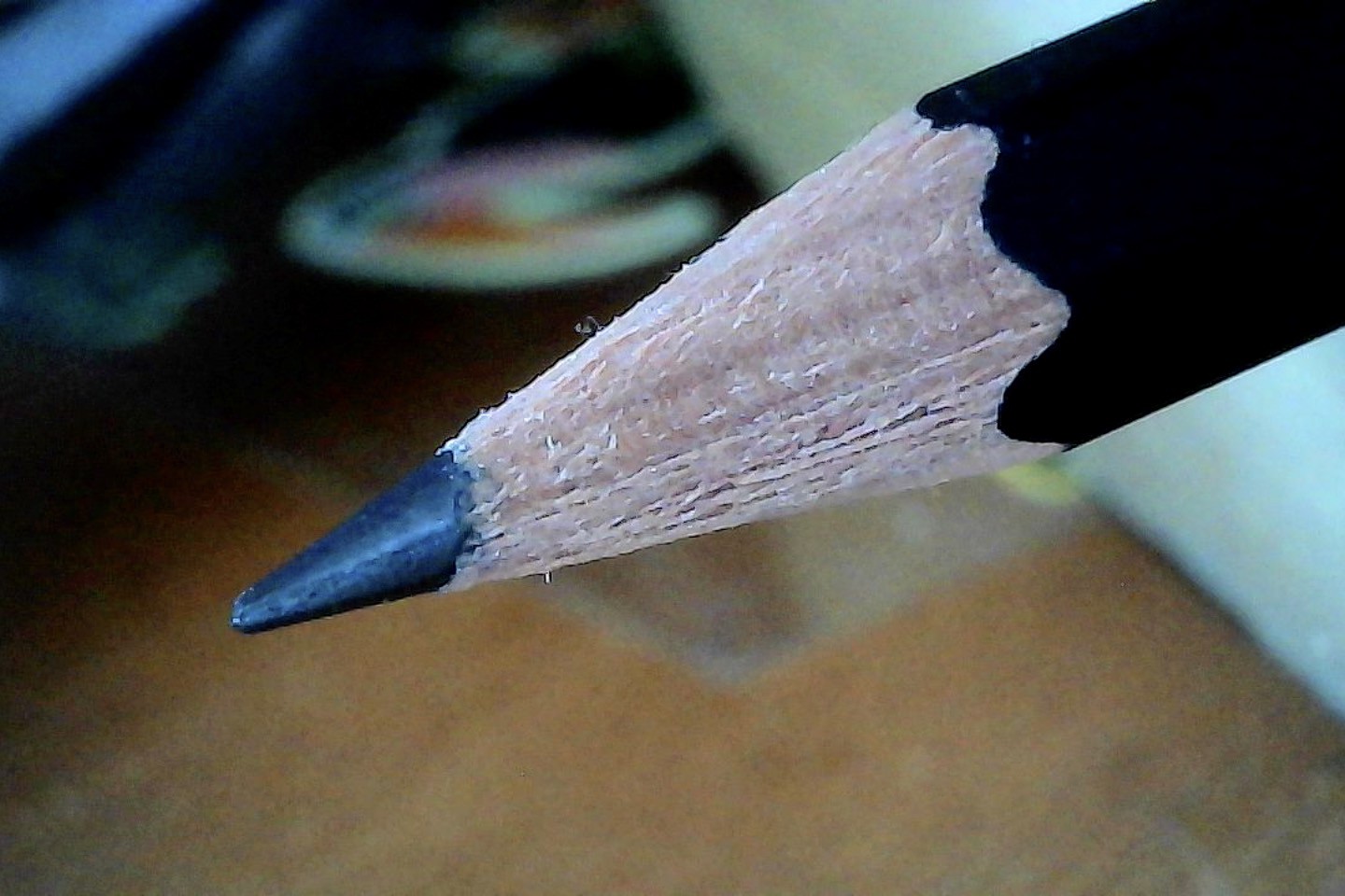

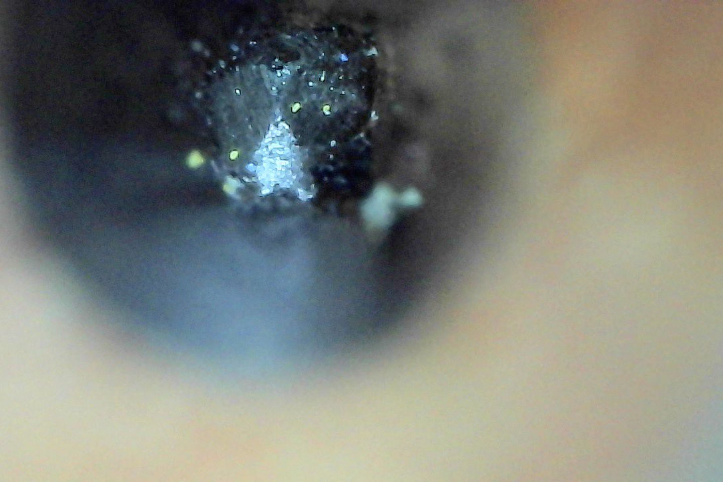

    The microscope I bought last fall to better see Circuit Graver work is pretty amazing. And also not amazing, perhaps; at this point, USB microscopes like this have been around for some time, and I'm just a bit late to the game. To recap, I have a USB-C version labeled for 50x - 1000x from a company called TAKMLY, and it cost around $40 at the time.
    The microscope enumerates as a webcam and takes reasonable-looking 1920 x 1080 pictures. With decent but not excessive illumination the noise levels are pretty good, and the LED dimmer is a simple way to adjust exposure to prevent washout. It seems they achieve this on the cheap by opening the aperture pretty wide, so the main issue, particularly at high magnifications, is a short depth of field. Of course, this condition exists with commercial microscopes costing far more; it's just one of those tradeoffs you make when seeking out a high-quality image. Here is a shot I took at lower magnification of a recently sharpened pencil:
    ... and then zoomed in, showing little green bits of pollen which has suddenly appeared on every surface in my apartment:
    ... and zoomed in even more and viewed head-on; this picture took a long time to set up and isn't great, but the magnification is impressive. Note the shallow depth of field; only a fraction of a millimeter is in focus:
    Held flat against my recently-dusted and pollen-encrusted electric piano shows a notably better image, since the focal plane matches the plastic surface and I was able to carefully adjust illumination while keeping everything still. Look how porous the plastic is up close! No scale here; might be time to finally buy a cheap calibration slide. I bet the green pollen bits are in the range of 10-25 microns:
    Due to the shallow depth of field and high magnification, just holding the sample and microscope stable relative to each other is tough. The included table stand has some adjustment but lacks the weight to really keep the microscope stable, and the clip that secures the stand to the barrel tends to slip off a bit too easily. So just having a multi-axis stage that lets me adjust the microscope and be assured it will stay where I leave it is a great improvement. Seems like a nice excuse to make a new platten for this machine:
    I want to use one of the two "good" axes for precise focusing, so I oriented the microscope parallel to the X axis. Note the workholding plan; I'm going to devise a clever clamp for my tweezers that lets me pick up a sample and quickly secure it to the machine, probably with some kind of flexure and securing knob. Left-right (to the camera view) sample orientation is adjusted with the Y axis, while a bit of vertical movement is allowed by pivoting the tweezers at their base. Perhaps future work could hijack the R-axis to actuate the camera's zoom ring, but for now, just operating it manually will dramatically improve image quality.
    And of course, once the system is working I can automate the X-axis and take a series of shots at precise focus intervals, and then use some kind of focus stacking software to mash them together. That's not something I've done before, so maybe it's less trivial than I assume. One thing at a time.

  • in pasadena!
    zakqwy • 11/02/2024 at 13:12 • 0 comments
    I finished the SAO at the eleventh hour, the day before getting on a plane. It works! Well, one LED has some challenges, but we're counting this as a win. It's also a great example of why vias are important; driving two shift registers means they share a lot of pins and need a lot of tedious (but delightful, of course) magnet wire work.
    At some point I'll post more pictures, maybe installed on the badge. But for now:
    The machine made it to LAX without much trouble, and I managed to spot it getting unloaded from my (well, Delta's) 757-200:
    I got to Supplyframe HQ around 4 PM and set up on a table with friends, and spent a few hours showing folks how the machine works and making sample boards. And soliciting designs from conference attendees! I brought ~30ish blanks and it would be great to go home with none.
