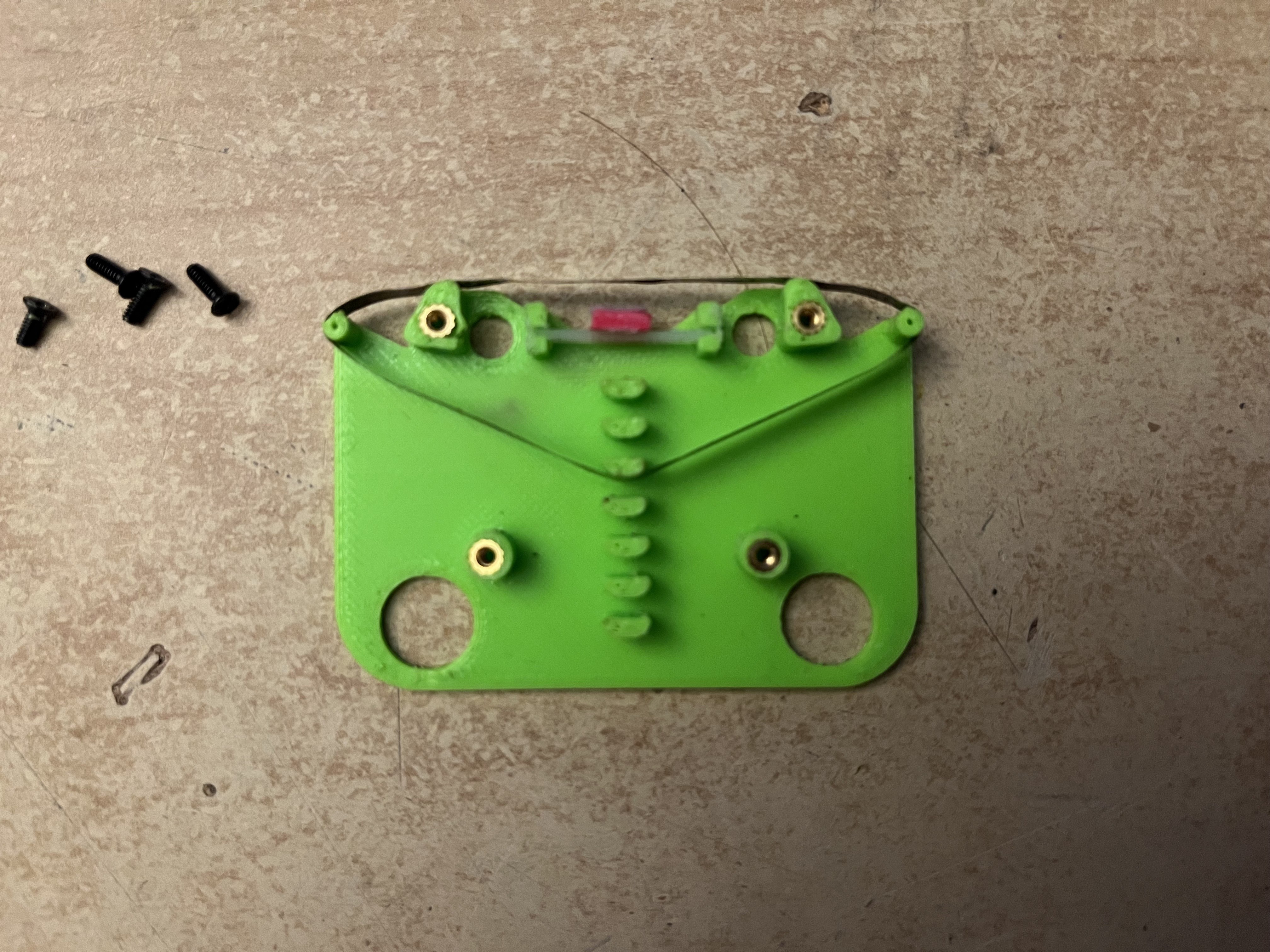

Making the Tape is pretty simple.
1) You can download the TapeOrgan_Tape.zip, it includes two stl. This is a very small version of a normal cassette, you can 3D print both of them or just use your own.
2) On the underside of the tape you need to insert a mechanism that pushes the tape against the reader. What I did was cut a slid into both of the pools to the left and right of the reader, insert a piece of zip tie across and put a small piece of foam rubber on it. this firmly presses the tape against the reader. in order to not create to much friction I then put a small piece of paper on top of it. You can see the assembly in the image below.
3) From a still intact cassette cut out the part of tape you want to loop. Don't make it too short, because it may not fit in the 3D printed cassette, it needs to be long enough to go under the tape reader and to at least one of the rubber wheels that drive the tape. But other than that, all is up to you
4) Tape the ends of the piece of tape you cut together. I recommend using only a small piece of flexible tape. Normal tape one might use for paper should be fine.
5) put the looped tape in the underside of the cassette. There are some poles on the underside you can use to wrap your tape around. (See image below) Make sure, its not to tight, the reader and wheels of the cassette player will press down on the tape and therefore deform it a bit, so give it enough slack.
6) now put the upper side of the tape on the underside. You can either use threaded inserts (like I did as seen on the image below) or instead just glue both sides together.
