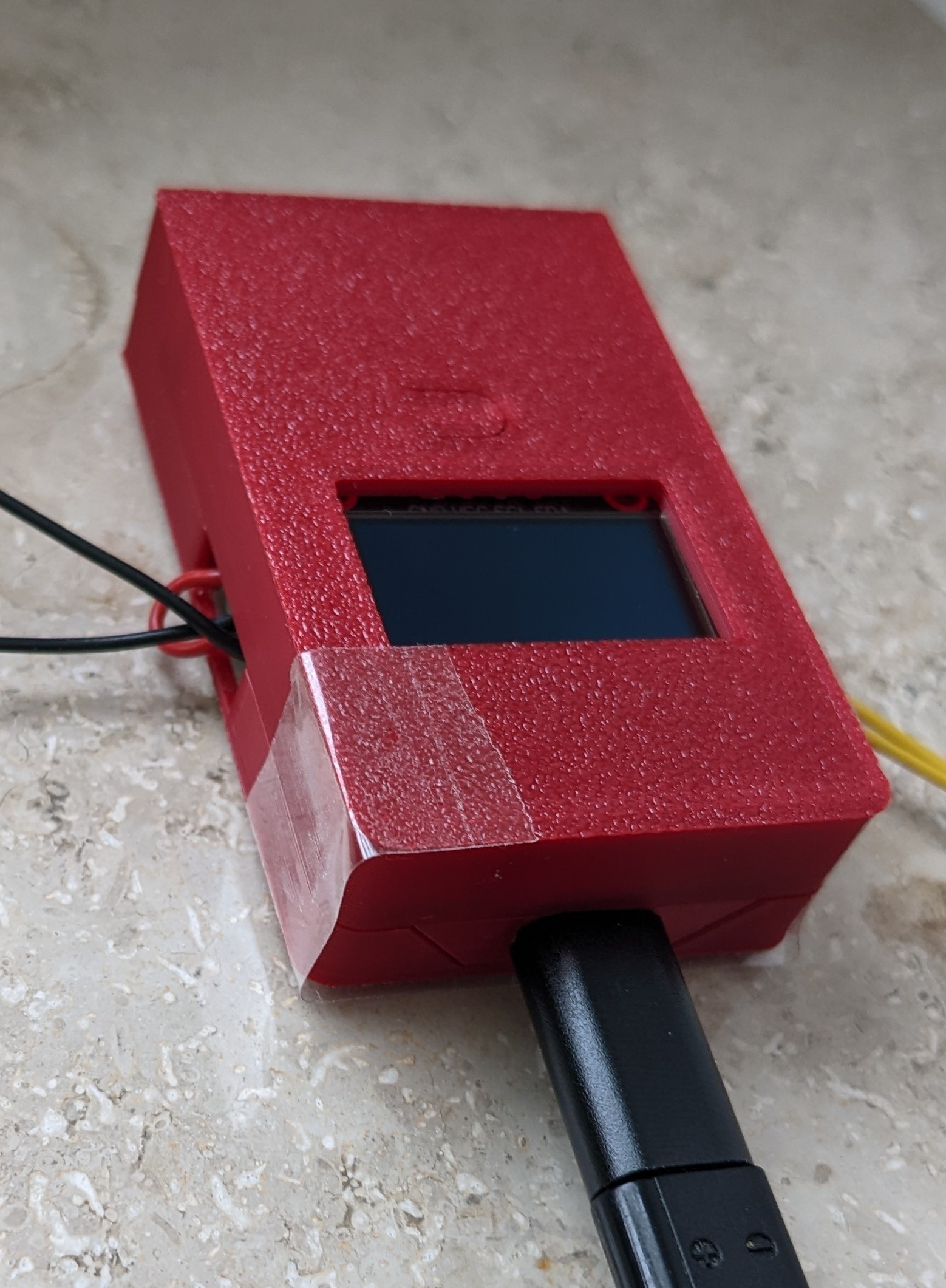

    Only the housing was left. A bare PCB on the window bench does not appeal my wife.
    Thus, a housing was to be created. The buttons are functioning with a smal cutout that bends down.
    And here it is after some trouble with false measurements and FreeCAD.
    Unfortunately, some tape is needed to hold the two shells together. Designing clips is the next level. I am not there yet.

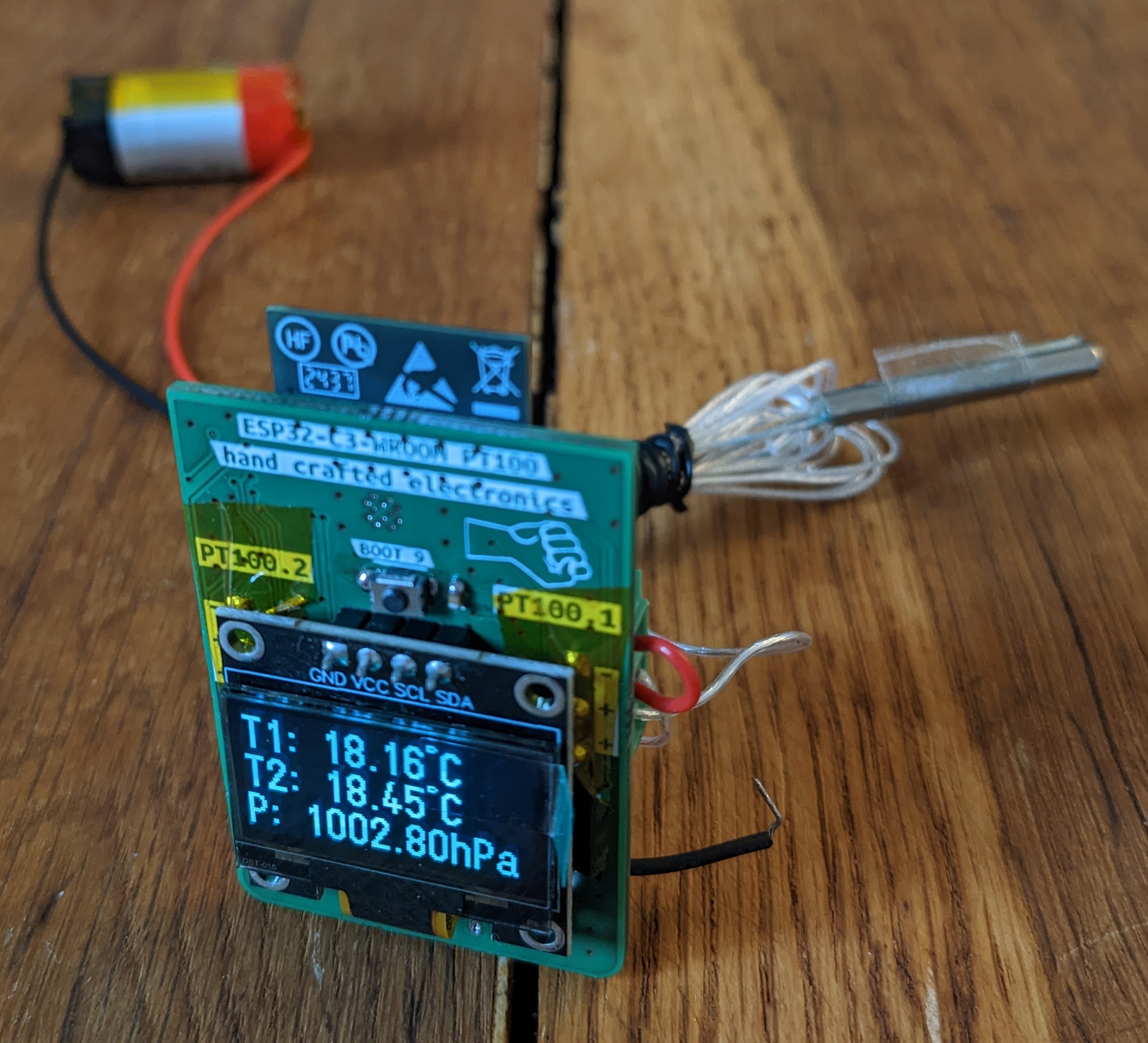

  • First Prototype
    Per-Simon Saal11/15/2025 at 11:29 0 comments
    Assembly

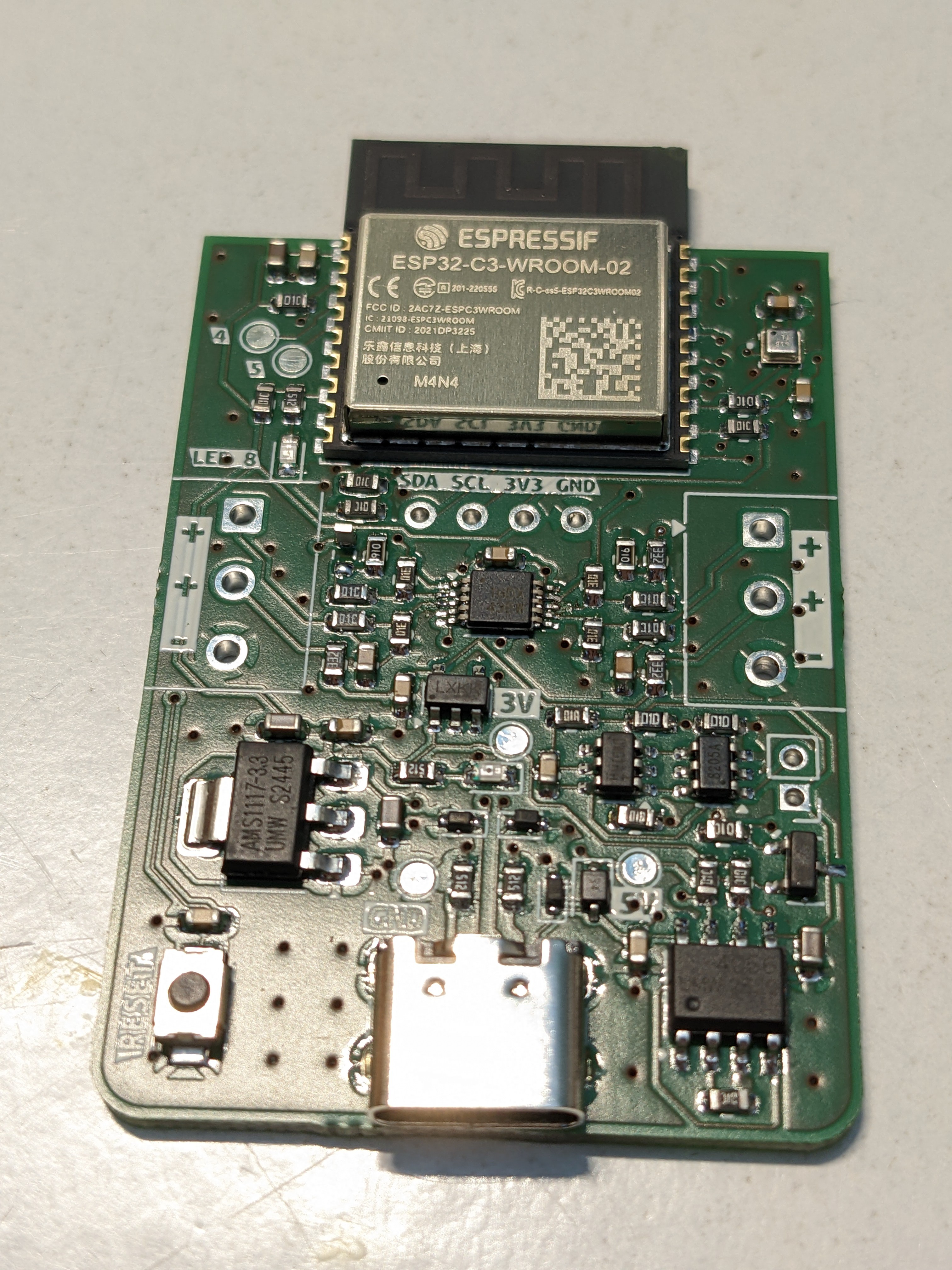

    The PCB finally arrived, and I assembled the first board.
    I was initially worried about the quality of the solder paste application through the stencil. First, there’s the USB-C connector, which absolutely must be soldered perfectly—there’s no way I could fix that with a soldering iron. The pitch is far too fine.
    The second concern was the barometer chip: it’s tiny, and any rework would only be possible with hot air.
    Surprisingly, applying the solder paste went quite well. Unfortunately, the pins of the barometer were completely shorted.
    Nevertheless, I placed all components and “baked” the board on my cooktop. This is a proven method for me and works very well. 😄
    After soldering, I checked most critical signals for shorts to GND or VDD.
    Only two issues showed up:
    • The op-amp had shorted pins.
    • The barometer had SCL shorted to 3.3 V, meaning I²C would not work. The OLED wasn’t assembled at this stage.
    Apart from that, everything else looked good!
    Can you spot the tombstone?
    First Power-On
    Next, I supplied 5 V from my bench power supply with a 100 mA current limit. The board powered up, and 3.3 V was present.
    Then I connected it to the PC to flash the firmware. As hoped, the controller was recognized immediately, and the Arduino IDE connected without issues. Flashing worked too.
    Then the problems started.
    Several things didn’t work—or appeared not to work. After many flashing attempts, I finally reverted to the very first firmware version. Somehow I had made the code worse over time.
    With this restart of the firmware, the controller successfully starts an access point. The Wi-Fi credentials can be entered via the browser interface and are stored in flash. After a reset (which still doesn’t work correctly in software), the controller connects to the configured network.
    Calibration with precision resistors also works. However, the op-amps do not output matching values for the same calibration resistor. After connecting real PT100 sensors, the first temperature readings were not too far off. I calibrated them in an ice bath, so in theory they should now always match.
    But they don’t.
    Maybe the sensors are too cheap—after all, I bought them on eBay…
    Testing the Battery Charger
    Using my power supply, I injected around 4 V to simulate a battery. Measuring at the 5 V test point, I got only 3.4 V—quite a drop. At the 3.3 V test point, only 2.4 V remained, and the controller wouldn’t even start.
    I suspect the AMS1117 isn’t suitable for operation from battery voltage because its dropout voltage is simply too high.

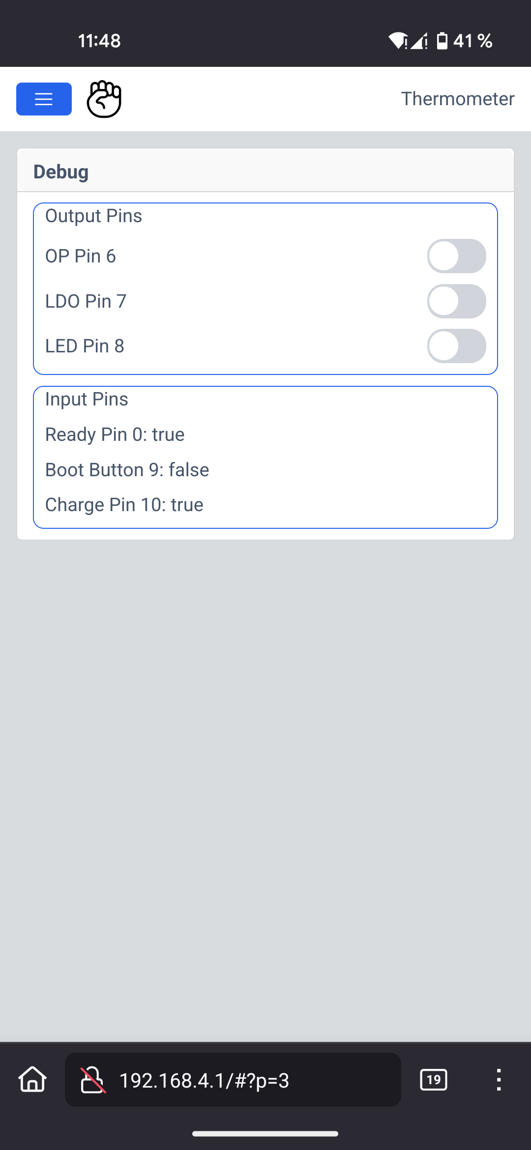

    I came up with a new idea: during hardware development, it’s extremely convenient to have full control over all input and output pins.
    Normally, this kind of control requires reflashing the firmware or reassigning functions in software—for example, mapping a button to a specific GPIO. If you’re using a debug probe, you can manipulate pins directly while the controller is running. However, I’m working in the Arduino IDE, so that approach isn’t practical.
    My solution builds on the HTML interface I described earlier. I simply added a new page with toggle buttons to control the output pins and text indicators to display the logic input states.
    The result looks like this:

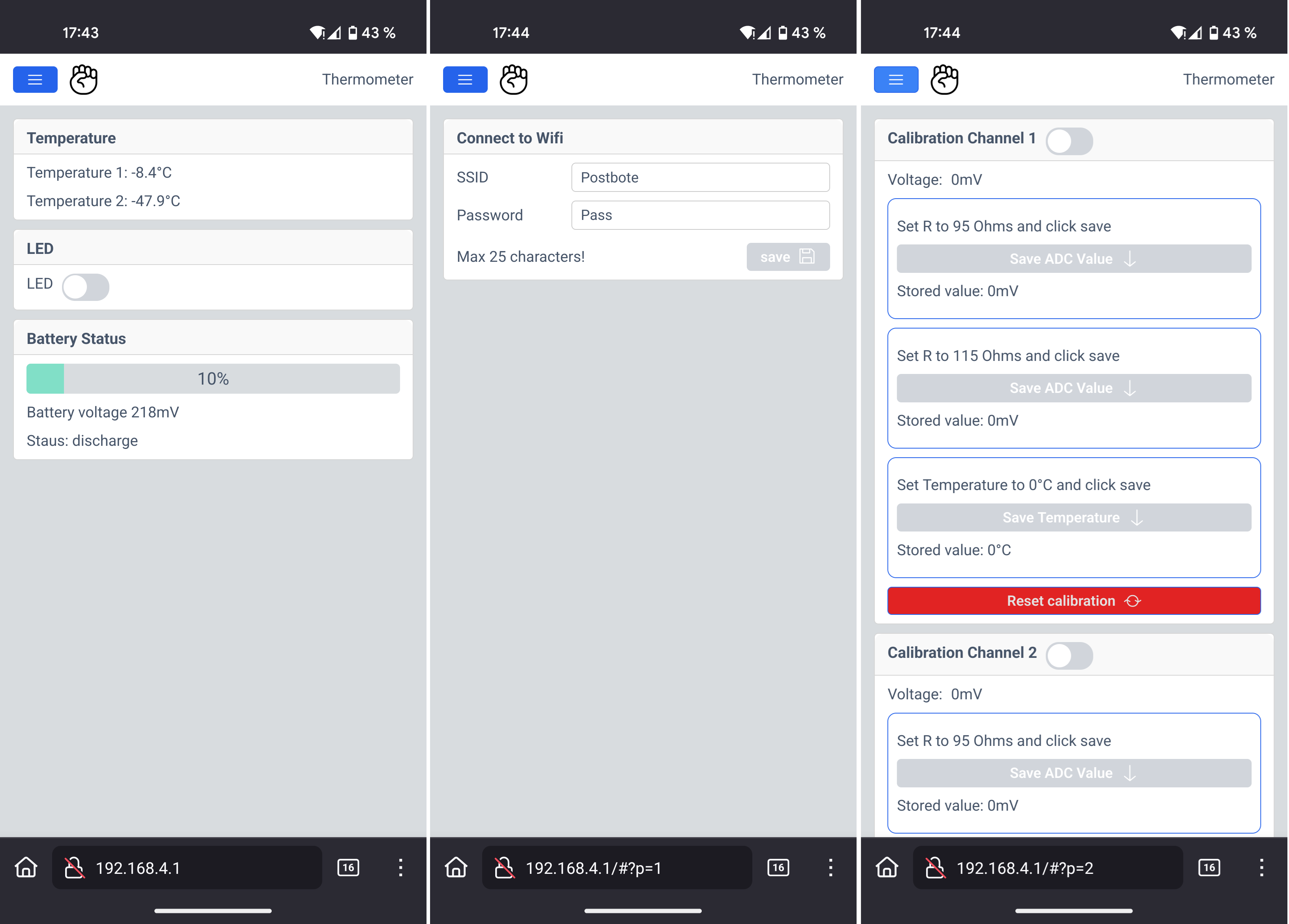

    One important feature I want to achieve is the configuration of the Wi-Fi network the device should connect to. Similar to many smart home devices, it will provide its own access point for setup. However, unlike typical IoT devices, mine does not require internet access—nobody needs to see my temperature data (and they shouldn’t!). Everything will be accessible locally via the AP.
    Mongoose.wz offers a very nice online tool to design a professional-looking HTML interface for free, if it is open-source. After a bit of a learning curve, I finally figured out how to use the API and library properly—and now it works beautifully.
    System Overview
    When the device starts up, it first tries to connect to a known Wi-Fi network. If that fails, it automatically starts an access point. You can then connect to it and open its default IP address—usually 192.168.4.1—in your browser. On Android with Firefox, initial loading can take a moment, but eventually the page appears.
    The main page shows:
    • Both temperature readings (and later possibly ambient air pressure)
    • Battery status
    • A toggle button for the onboard LED to verify functionality
    Wi-Fi configuration
    Using the menu (“burger” icon), you can access the Wi-Fi configuration page to enter network credentials. These are stored in emulated EEPROM for persistent access. Even if the network is currently unreachable, the saved credentials remain visible—intentionally a feature.
    Calibration Page
    The third page provides calibration options. Each channel can be calibrated individually using:
    • Two known reference resistors
    • A PT100 measurement at 0°C
    Both channels can also be reset independently. When calibration mode is enabled via the slider, previously stored values are shown for reference. Calibration data is also saved in emulated EEPROM.
    With the Mongoose Wizard, the interface can be easily expanded and customized as the project grows.

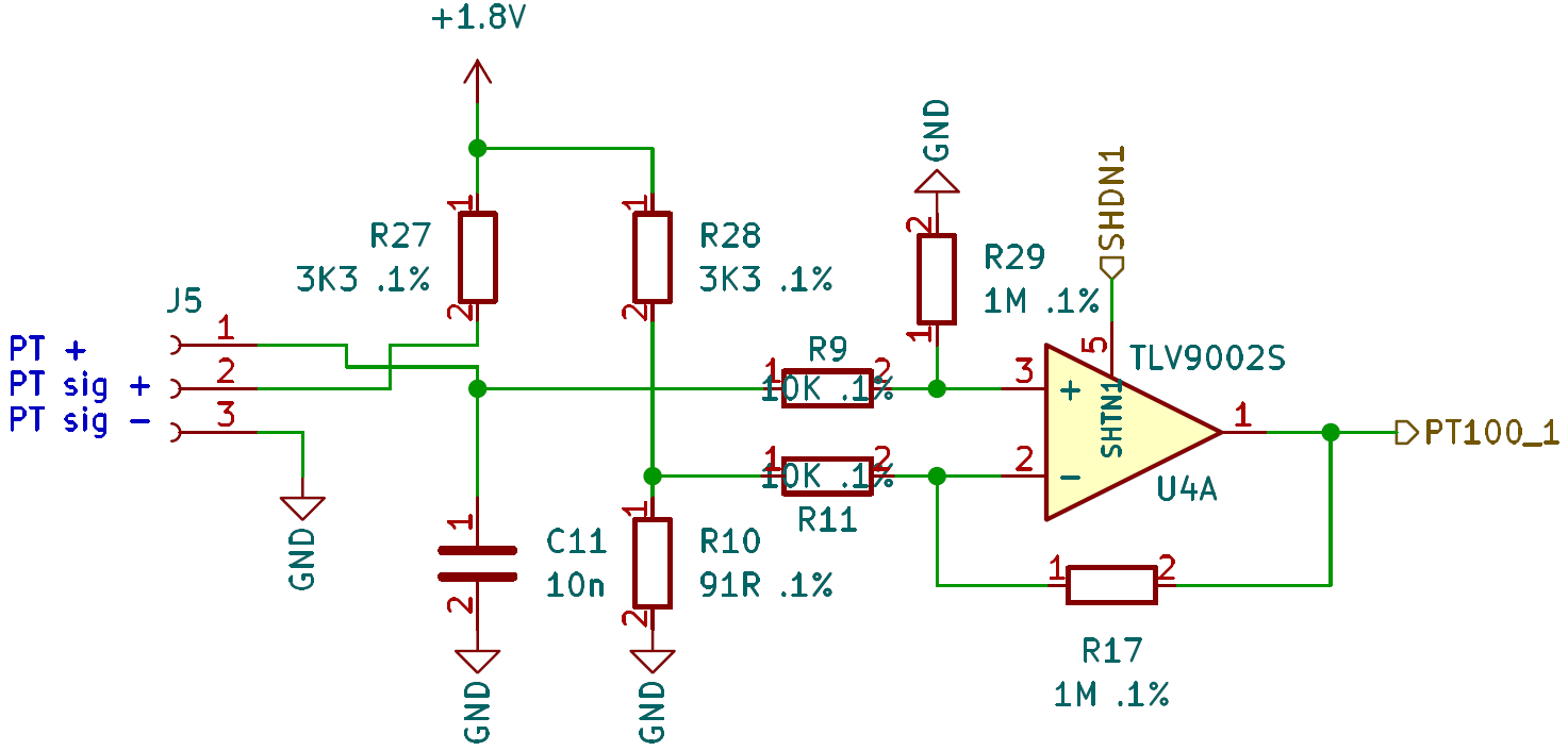

    I chose a Wheatstone bridge, as it is a highly accurate method for measuring small resistance changes. There are dedicated PT100 measurement ICs with SPI interfaces that can deliver temperature values directly, but I wanted to keep the design as cost-efficient as possible. I’m using such an IC in my mock-up as a reference for comparison.
    For amplification, I selected the TLV9002S operational amplifier. Its low offset voltage can be handled in software, and it provides two channels plus individual shutdown pins—useful for reducing power consumption in a battery-powered design.
    The PT100 is connected using a 3-wire configuration. This may be unnecessary with short cable lengths, but I want to evaluate the potential benefit.
    Component Tolerances
    All bridge resistors are 0.1%, which already helps improve accuracy.

    Here is the Wheatstone bridge I’m using:
    R10 sets the minimum temperature (91R ~-25°C). R27 and R28 are current limiting resistors and part of the bridge. R17 and R29 sets the amplification of the difference amplifier. 1.8V ~ 45°C.
