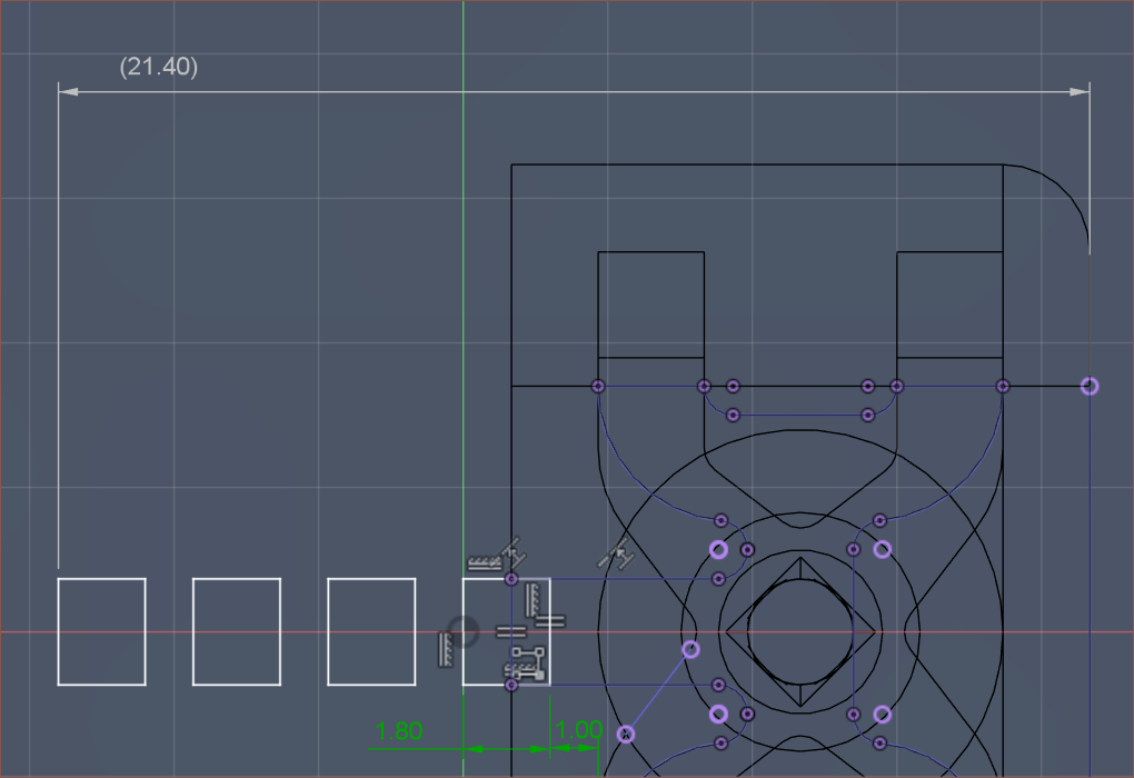

So I first decided that I was going to go back to the symmetrical-bolt mounting of the 6028 fans, and with the hotend holder now entirely made of metal, it can also help with heat dissipation. I then noticed that there'd be more space above than below the cooling 6028 so I pointed it upwards.
Then, similar to how I'd go about solving a maze, I started thinking up ideas on how the duct would start and end. I knew that the rear of the Coaxial8or was the most suitable location for the duct output. It also looked like a revolve would be beneficial to cool from multiple directions. I gladly found out that Fusion supports lofting from such a curved face:
I went on to refine the geometry so that it was at least 3mm or so from anything else and didn't stick out beyond the bottom wheel bolt:

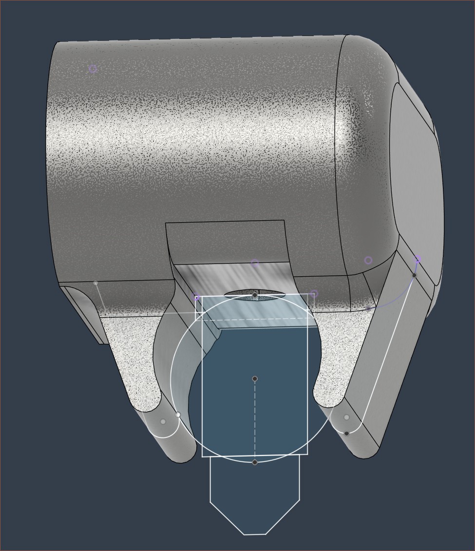

I was finally able to model the new hotend holder, which uses aluminium plates for its construction. No longer do I have to worry about the holder unintentionally melting, sagging due to the weight, or blocking the view when inserting the heatsinks into the couplers.
I still have visibility on all coupler holes, unlike the printed designs. The holder presses against the x carriage to better support it.
This was one of those things that is kind of hard to model because when there's nothing but an empty canvas, it feels like every plate depends on every other plate, thus a cyclic reference (aka catch22 / chicken and egg problem).
I initially was planning on a jaws-based solution similar to the redesigned holder for R2, but had concerns with grip so I just went with grub screws. This design allows all 8 heatsinks to get a grubscrew.
This shows the 1/4th section of the plates (except the + shaped plate, which is shown in its entirety). The + shaped plate is for added stiffness, but I don't have full confidence it's going to help.

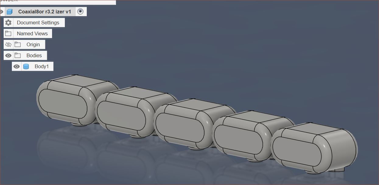

Instead of saying something along the lines of "I expect the part will be printed in X orientation", I instead just specified "There shouldn't be any powder / supports in the internal channels" and the engineer quote was $47.69; almost 10 entire dollars lower than earlier quotes. Obviously, I wanted to find out why and the engineer sent this:
I thought the bridge overhangs (see below) weren't allowed and produce a coarse surface finish but the engineer informed me that it'll be the same as the forward tilt.
The grand total with all the fees and shipping (that didn't budge from $12 regardless on if the part was 30, 29.9, 29.4 or 29mm high) was 4,777 pennies (£47.77) so I'll take that as a sign that I've "hit the jackpot".
I found Xometry had an article on DLMS design practices and it does mention that "unsupported bridges" can be 2mm long, and the channels are only 10% longer than that:
Essentially, I've been trying to model around a problem that doesn't exist. Thus, the orientation the engineer chose is indeed the better one when also considering the external features like the output port.
My main hope is that the port rings print correctly. I don't know what the shape would be called, but from looking at past prints, I'd guess that the minimum fillet is 0.25mm radius.

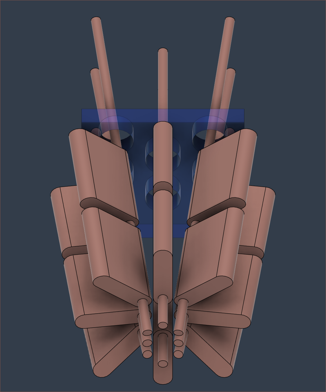

R3 simulation
I also questioned if there was an even better way to see the ParaView results than using cutting planes or streams, and I did:
Using the threshold settings, I was able to get this cool visualisation that looks like a Minecraft speed build:
Not sure why, but I was getting frame drops.
Since the input is split in primarily perpendicular directions, compared to R2 (below), it seems that the 4 paths arrive at approximately the same time, hopefully meaning that the output core would be more squircle.
Anyway, this is what the simulated core material looks like for R3:

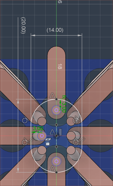

Finally! I've been trying to solve a solution essentially daily since the 8th and I've finally arrived at one that minimises the drawbacks and incorporates the benefits.
The main issue was mounting the 30mm cartridge in such a way that it didn't block an allen key to the plate bolts and that the cartridge can be held in a clamping mount instead of grub screws. When I got to save v45, I more or less abandoned mounting the cartridge horizontally since I couldn't think of a solution that didn't look ugly (and likely use a relatively large amount of material).

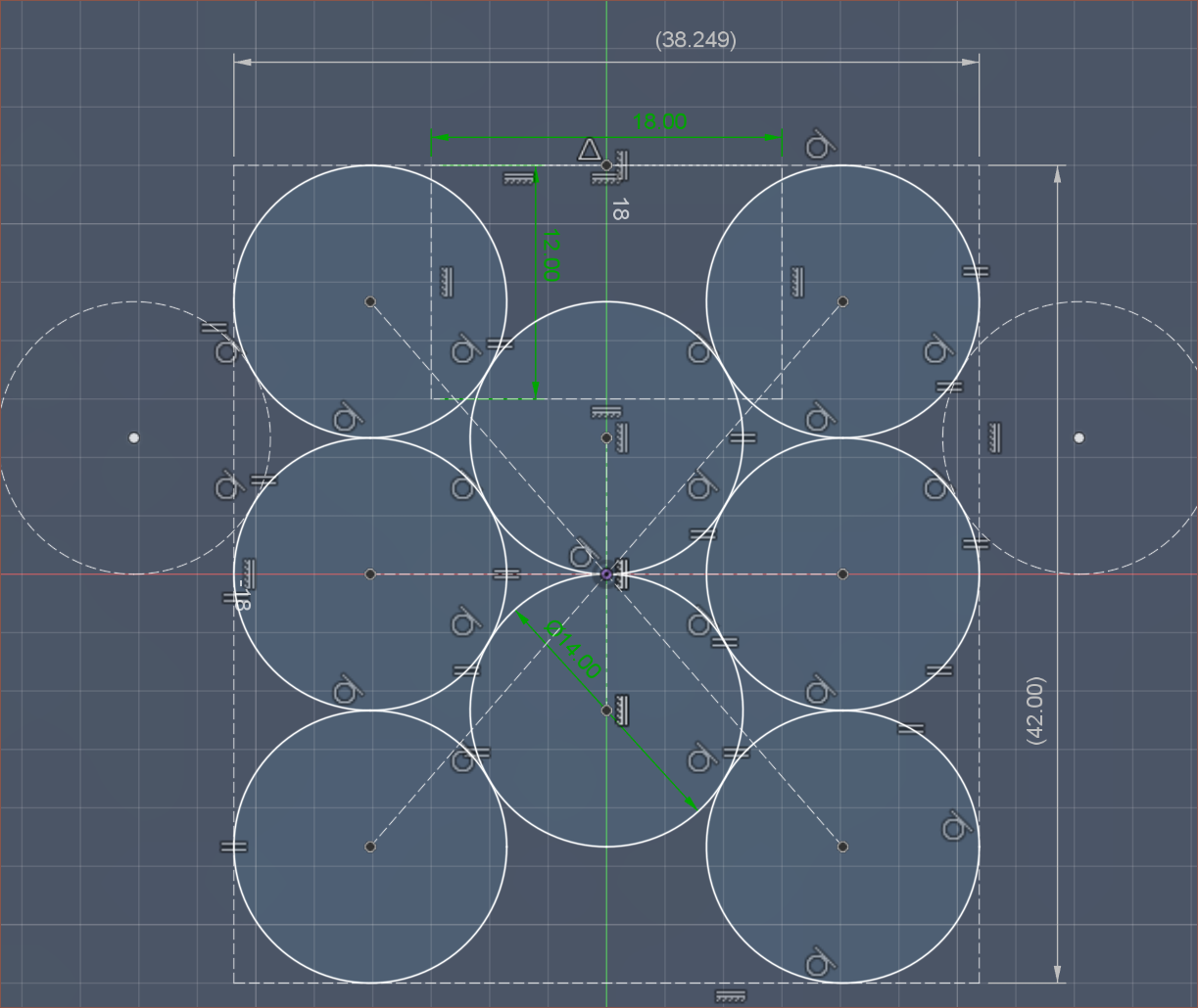

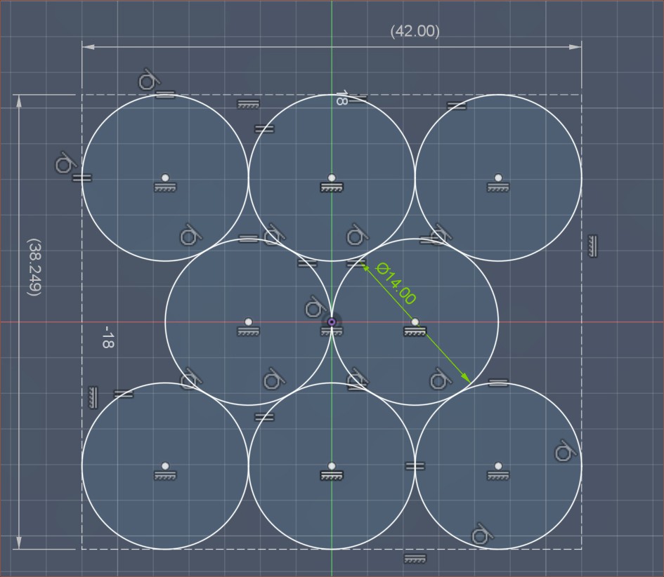

My ceiling for modelling was 20cm3, and the result is a respectable 17.2cm3. The PCBWay autoquoter says this print is $35.
LWH dimensions are 26 x 53.5 x 30mm with each input being 10mm away from adjacent ones.To cut down on material usage while minimising radiation, I've come to this heatsink-fin-esque design. The cutouts are perpendicular to the X axis to minimise air moving through the heatblock during printing.Additionally, measures have been taken to both try and prevent leaks and prevent difficult cleanup should they occur. All inputs and output has a print-in-place o-ring to encourage deformation at the contact points, hopefully avoiding the need for post processing like the previous revisions. Then, leak channels have been added to allow any leaks a low(er) pressure way out, instead of a leak deciding to show up wherever. Furthermore, 5mm steel plates are used, with the mounting bolts as close as possible to the inputs to minimise flexure. Lastly, the design has a gap between the input plates and the cartridge+thermistor as a last line of defence against rogue plastic.This solution has been facilitated by a modified input shaft and coaxialiser geometry. In addition to the split (hopefully) increasing flow rate, it allows the inputs to be connected without a bridge overhang, which would be the case if a basic L path was rotated 45 degrees. The coaxialiser is slightly more compact now. I did try orienting the coaxialiser vertically, but it uses more Z height.Vertical coaxialiser ideaCurrent geometry, which is about 2cm3. The output is still an octagon.
From the top of the o-ring to the Y split is 19.5mm long uninterrupted, so I'm expecting that this heatblock can put the "ate" in Coaxial8or when it comes to consuming filament.
As for aesthetics, I think I've done a passable job with the limitations I have to abide by. Like previous designs, there's a main element of symmetry. Somewhat inspired by earbuds, I've used fillets to make everything seem more organic, like a pebble. There are also some sharp edges, a design tip I saw used for cars (and some earbuds). I like how my logo is somewhat obscured, peering out of the shadows.
I just don't like how flat the bottom of the heatblock is:
[Oct 21] - I've opted to go with a sharp circle for all inputs/output. I feel it will have more pronounced deformation.
I'm also trying a new variable fillet across the bottom to improve aesthetics:

I have several theories about why, but my two favorite are that the rough surface creates turbulent flow, mixing hotter fluid at the perimeter with cooler fluid in the center, and that a rough surface is more surface, and more surface = more heat transfer.
Thus, I don't think I need to concern myself about the surface roughness of DLMS parts, and just need to ensure that overhangs don't exceed 45 degrees.
I also like that this design is more accepting of arbitrary input amounts. The only thing stopping someone from a Coaxielveor (12-in-1-out) or Coaxihexor (16-in-1-out, not to be confused with a Coaxi6or) are other things like software / firmware / hardware support.

I decided to take a loft straight from the coaxialiser to the output pipe, which looks cool and seems printable. I've then simulated it and it takes 4.5s for the output to transition.
The coaxialised output conforms to the cross section. The below images show the output just as it leaves the coaxialiser (left), halfway up the loft (middle) and the end of the loft (right):I notice that the midpoint is notably rounder than the simulated output of R2:Thus, I've modelled an octagon output instead:
