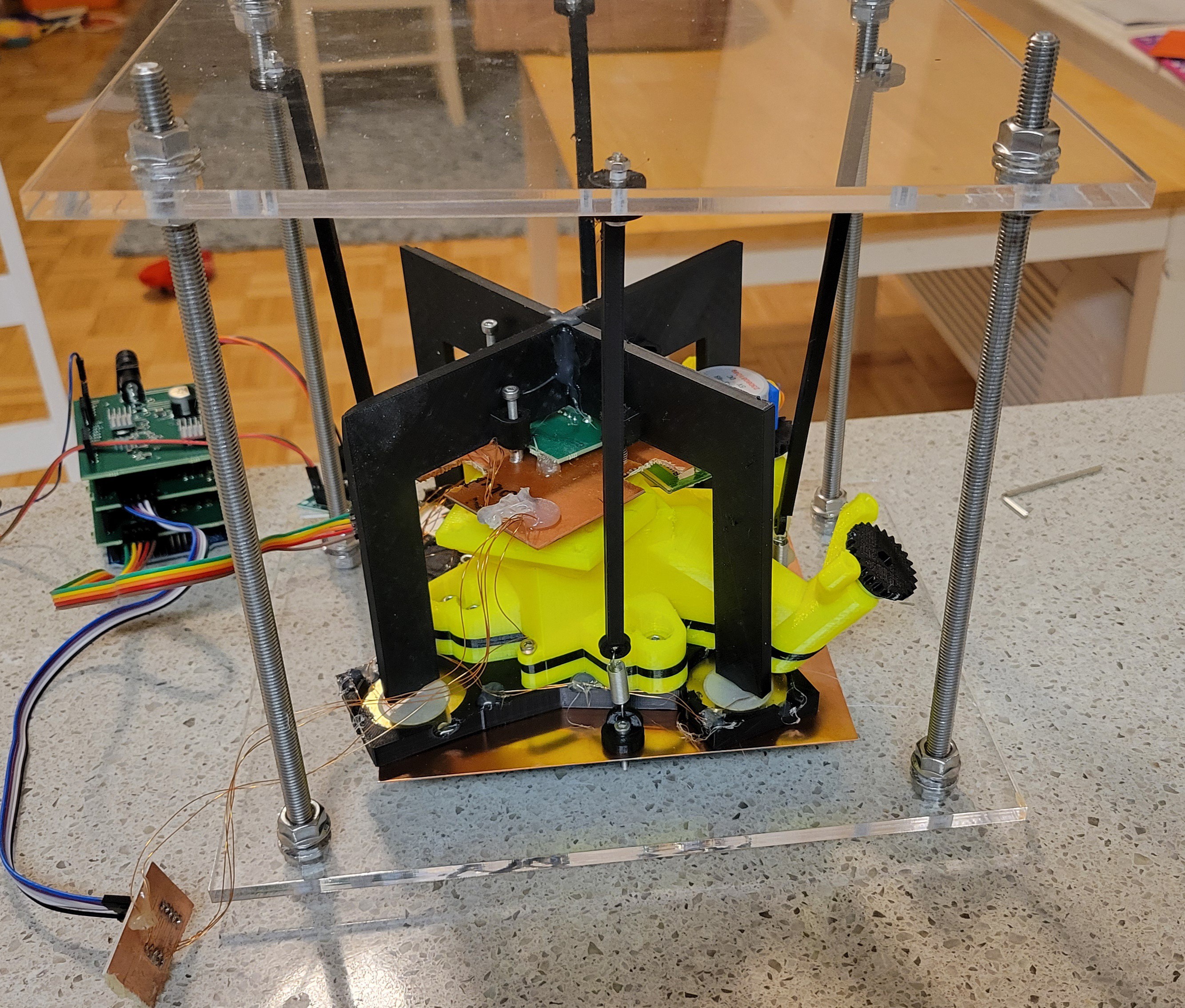

Connected everything together and debugging 'Approach'. (Algorithm that controls both micro and nano movement, which lets cantilever land safely on the surface)
Glued the cantilever
Now it seems to give consistent reading for landing.
Approach seems to be working now debugging new scanning algorithm.

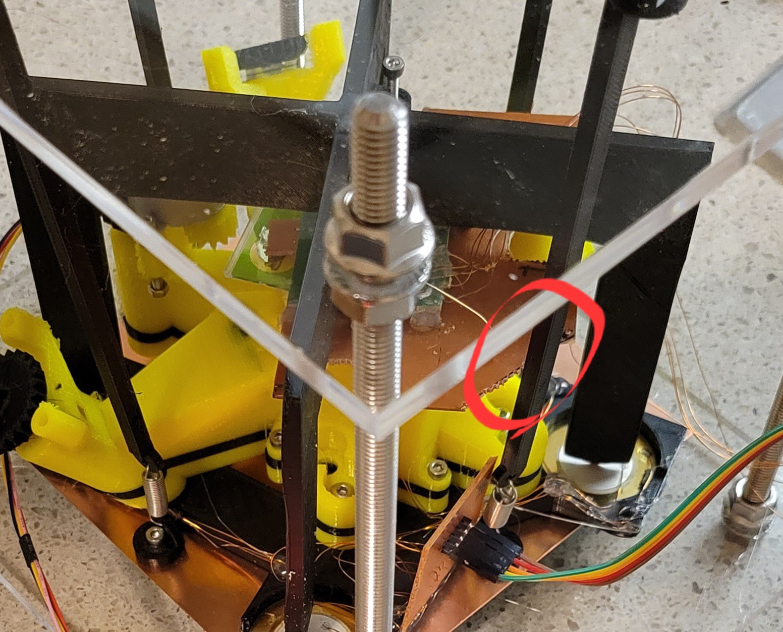

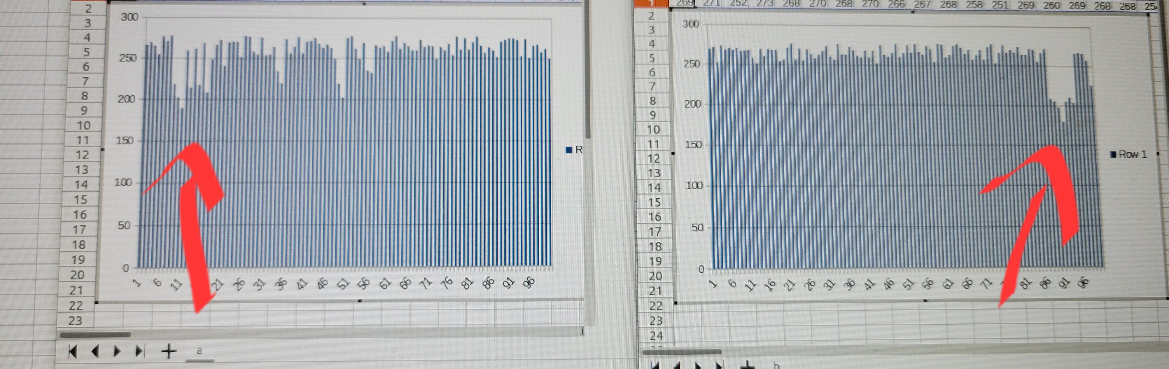

It looks like x-axis is not functional.

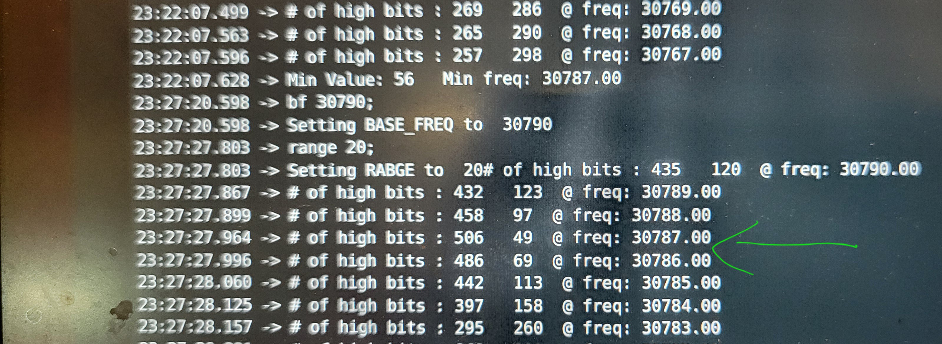

Just realized that this might be not electrical problem but a property of the Quartz Fork. I've observed in the past that oscillation takes time to start or fade away. To test this hypothesis I've added 500 millisecond to each X movement when scanning. And got this
Proving that X-axis is functioning if enough time is given.

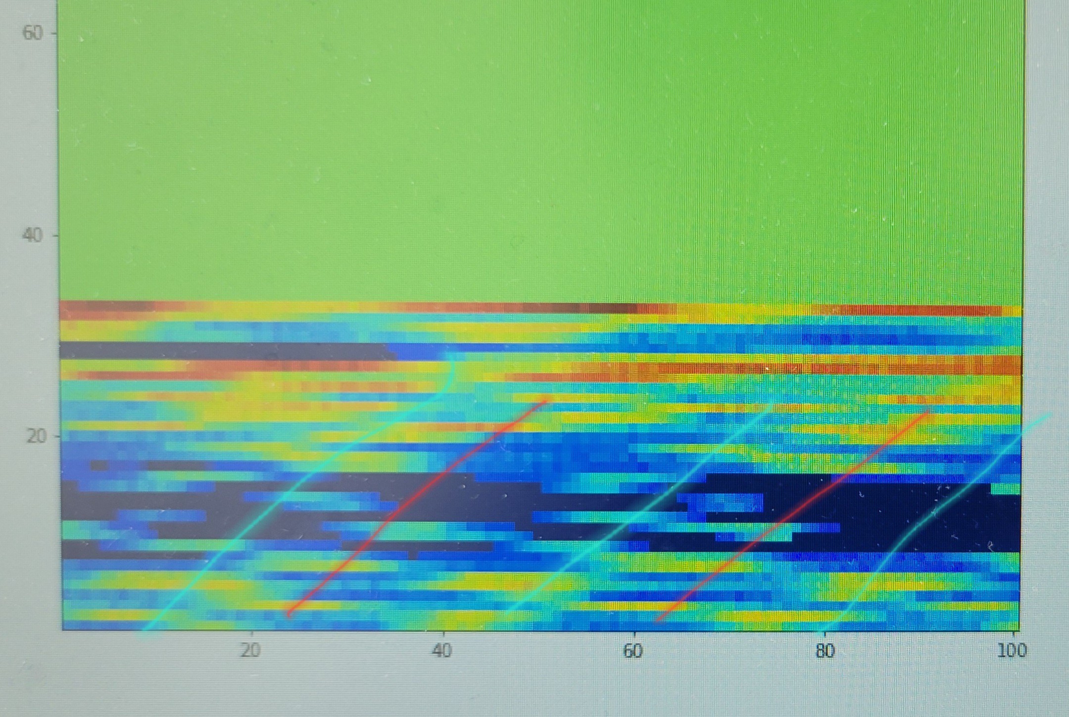

It looks like a pattern (or maybe it's me that wants to see a pattern 😄 ).
The blue lines I think are the main pattern and the red ones same pattern with phase. I don't know what is the reason for this phase or how to get rid of it. This is 10 samples hop image. I should run with 1 step hop size and see if it gets better.
By the way the sample is CD-ROM surface I expect to see pits (valleys) of different lengths.
Another thing is that I played so much with this cantilever, probably I smashed into surface more than once. Anyway, I will try to reduce speed even more to see if it make images sharper.
After making another picture I've realized that this is not a phase shift but wrong left-right/ right-left placement on GUI. I am trying to take the data from those images and check if this is the problem.
Here is the output without the bug (this is x10 zoom out magnification image):
I believe those green diagonal lines ( about 30 degrees) are pits of the data. I will try to rotate the sample and see if it keeps the proportion.
Does it looks similar?

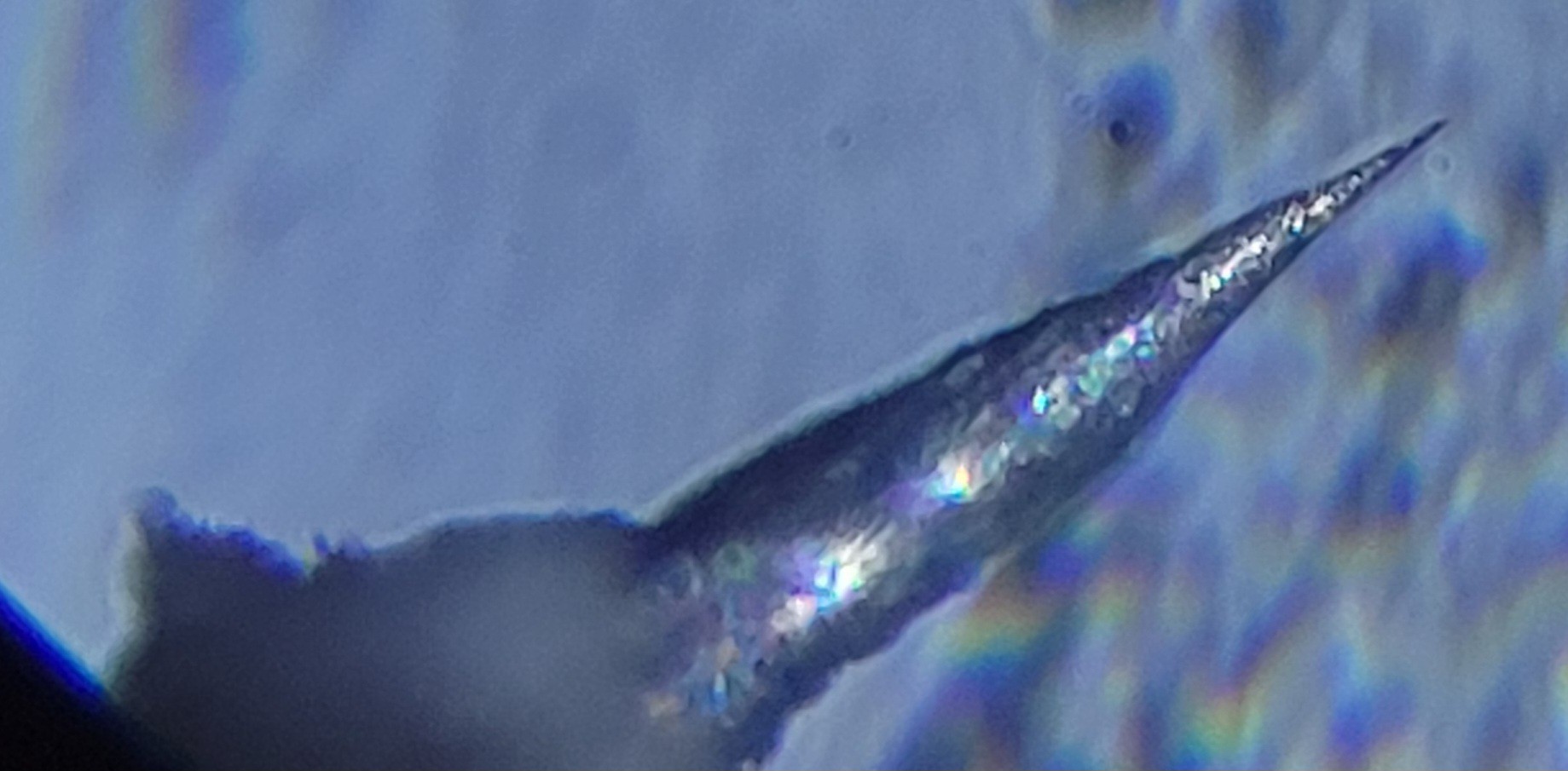

Last images I did are not sharp. I was not able to make qPlus tips but using very thin wire of 0.05mm. The problem with 0.05mm wire is that I was not able to etch it to make very thin cone instead I just cut it with scissors and hoped for the best. The 'best' was blurry images.
I've re-read articles about making sharp tips one of the ideas was to add wire on the other side also to counter weight.
Indiana Jones counter weight type.... (Sorry no GIFs here)

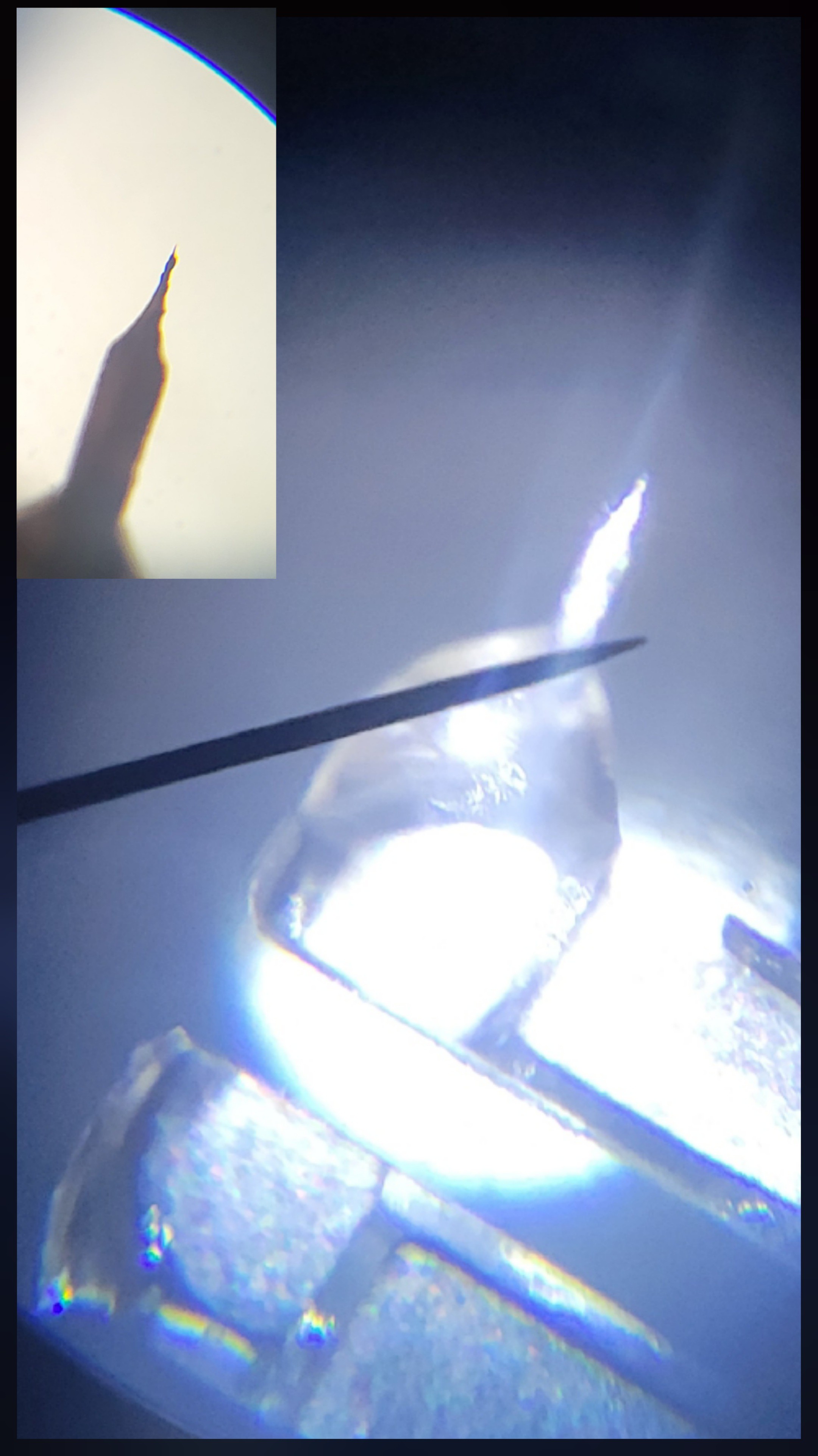

So I started with making mechanism to be able to etch Tungsten wire very close to fork's edge. This is the schematic/idea
And this is what I made...
Well, it's not as perfect as I wanted it to be but it will do as a first prototype.

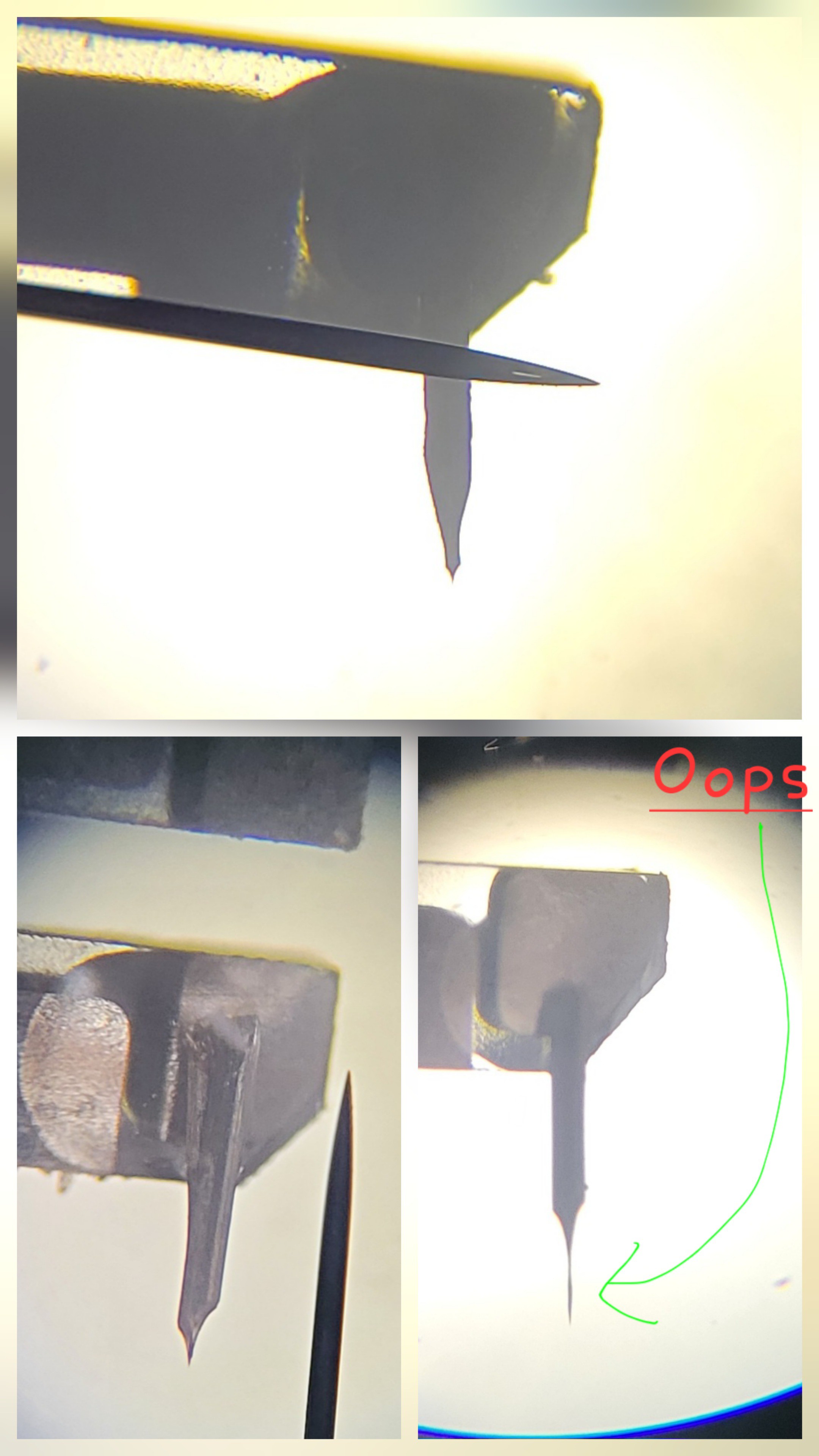

Ok, this prototype was not good enough. To get sanple I had to bend thick copper wires. In the process the loop was not aligned with horizon as a result all the bubbles would pop few seconds after they formed.
Another thing was the line of sight I couldn't easily see the length of the result wire. In the end I made tips of 1mm length which was not bad for begining but now I need something much smaller to keep high Q factor for my quartz fork.
And most annoying thing that both tips were broken I don't know if I just clumsy or super glue was destroyed by concentrated alkaline.

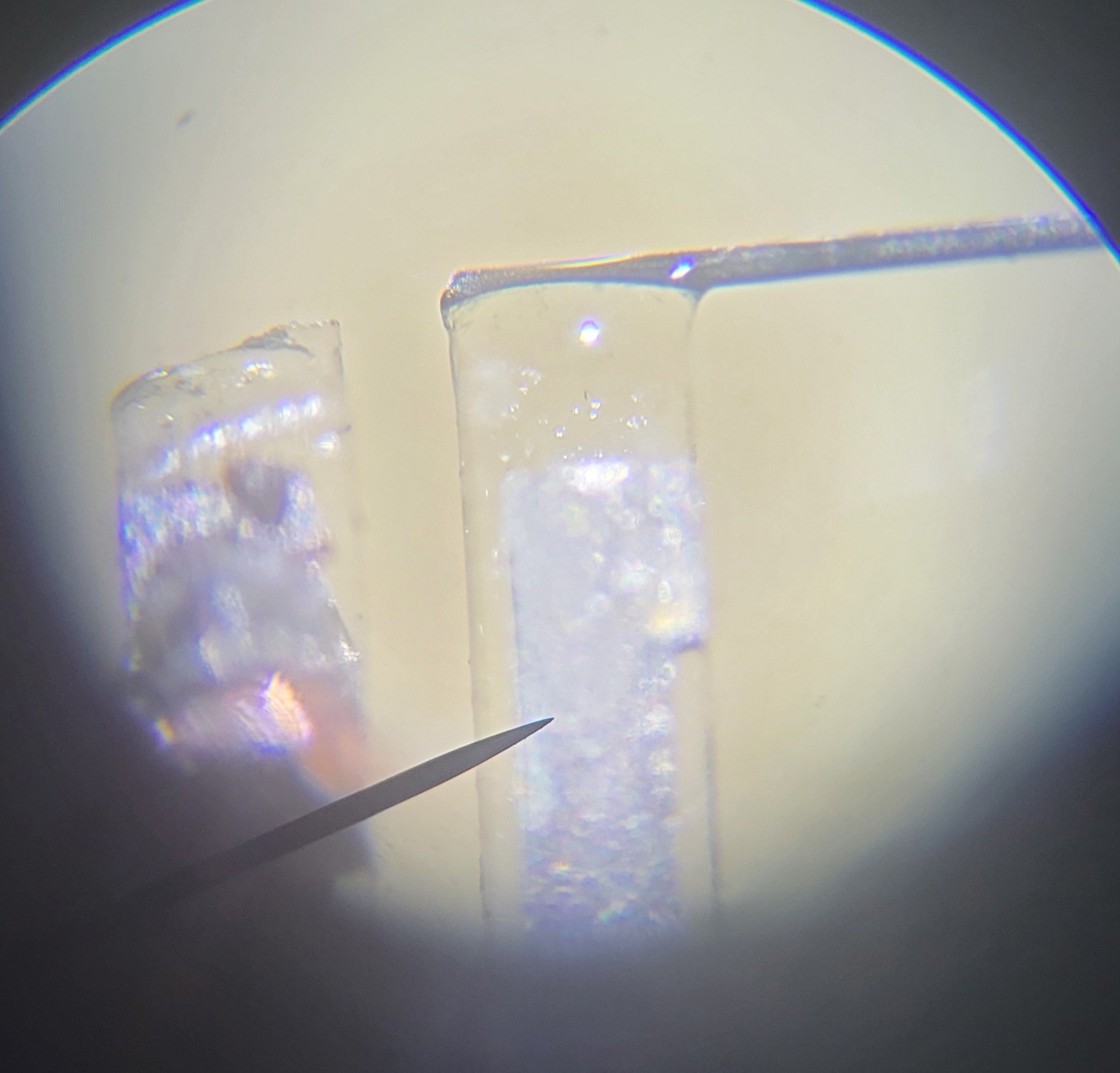

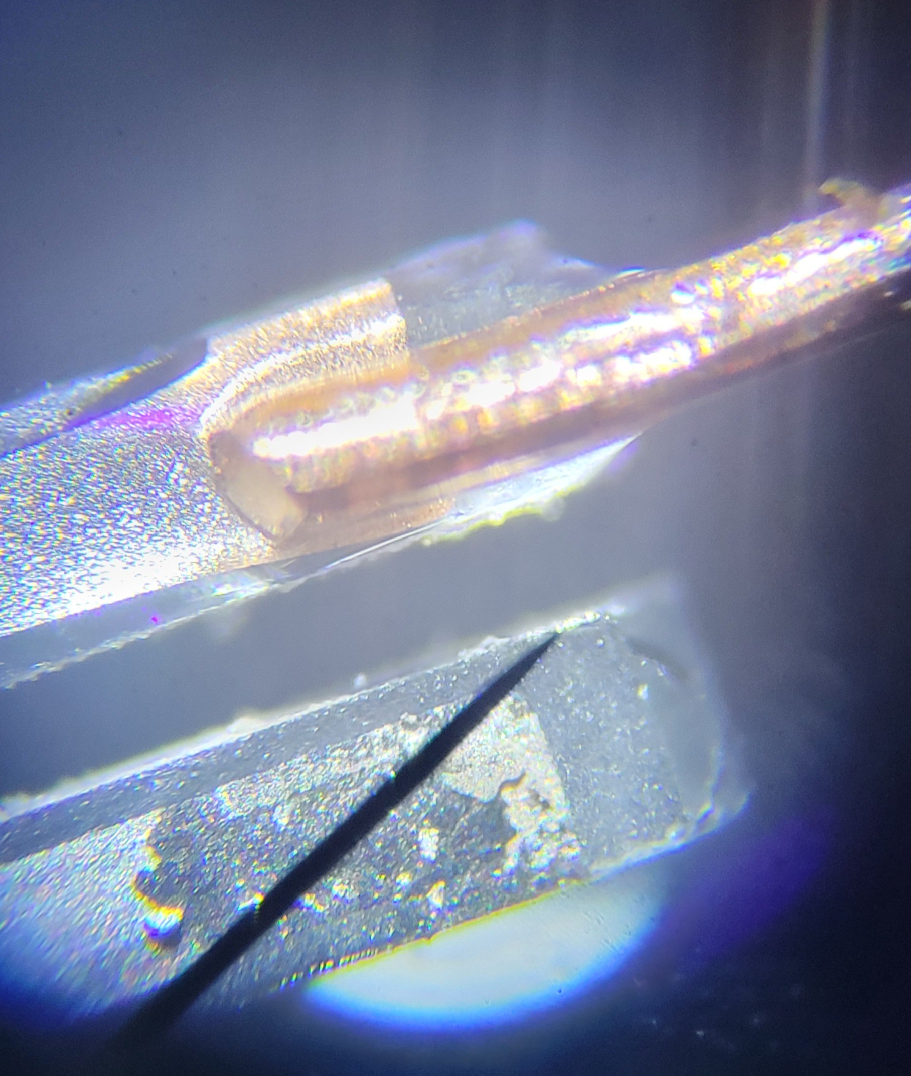

Ok, back to making sharp tips... I've decapped six quarts forks, three 8x3mm and three 6x2. Using microscope I've glued Tungsten wire 6mm once the glue was broken once I've moved it. Once 8mm broke as I touched it. So Ive left with two 8mm. One I was able to etch, and dropped from 1cm which made it glue break. The other once broke as the copper loop felt from it's place.
The main problem now is that it takes so much time to glue each Tungsten wire, plus, it takes 24 hours for glue to fully cure.
Now I've tried to glue with magnifying glass of soldering station. Although magnification is only x3 it was still possible to glue quite easily and there was almost no restriction on how many I can do in parallel
Although I used to much glue, the method works really fine. Now, when process is cheap and fast I can do many hopefully some will be successful I need only few.
Run another bunch with four quartz forks
When looking under the microscope you can see issues
So some of quartz fork irreversible, except this it works really good. Although quality is worse it will be smoothed out be quantity.

I've just discovered that NaOH not just destroying super glue but also quartz fork itself.
It took me few etching tries just to realize that Tungsten wire was covered with glue, therefore I didn't get nice cone form.
To fix this problem quartz fork must be below so glue will go towards the fork and not spill down towards Tungsten wire.
Also managed to remove quartz fork from it's base but could solder it properly (it was soldered but short circuit)
I've destroyed dozen of quartz forks but was not able to make one properly. It's not easy as I thought it would be. I guess I was very lucky to get those beautiful cones in the begging of the project.

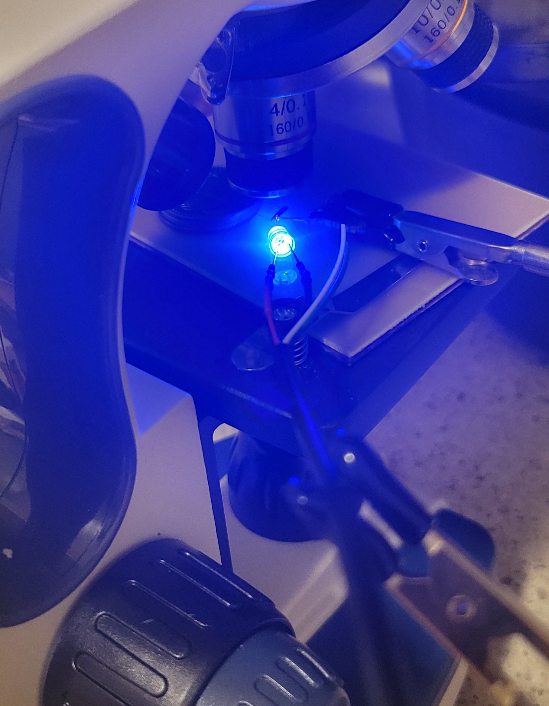

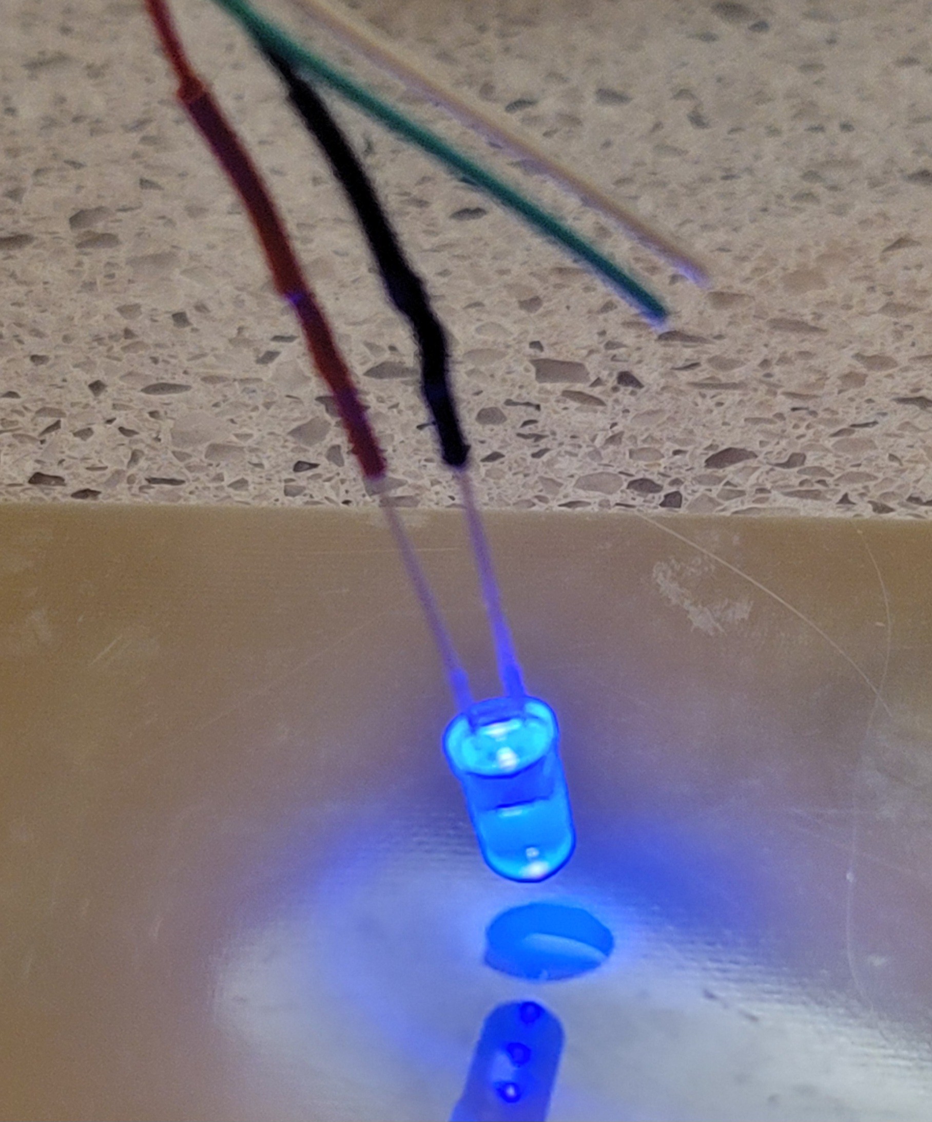

I've just realise how can I continue from this point. My problem is that super glue curing very fast. I don't have time to set everything correctly. The perfect would be doing under a microscope but it's almost impossible with time frame of super glue. Now, I've realize I can try UV glue, this way I don't have to hurry up. Set everything as I want only then shine some UV light to cure it.

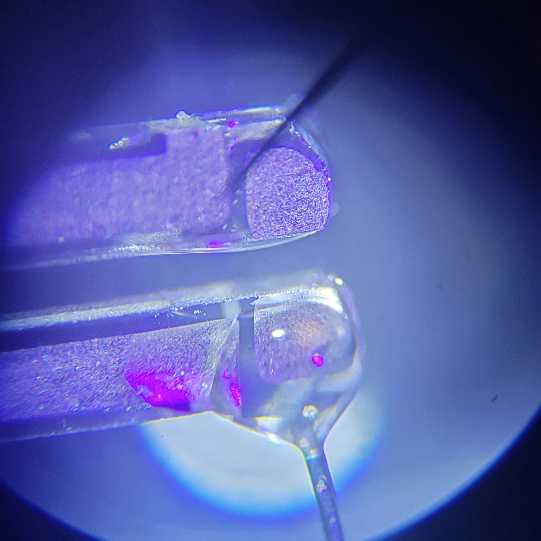

Ok, connected small LED to USB. Looks good
After only five minutes the bulb became hard the other bulb that was not exposed to UV was still liquid. It's working more than I was expecting. Tomorrow I will try to connect Tungsten wire to quartz fork, using microscope and finish with UV light.

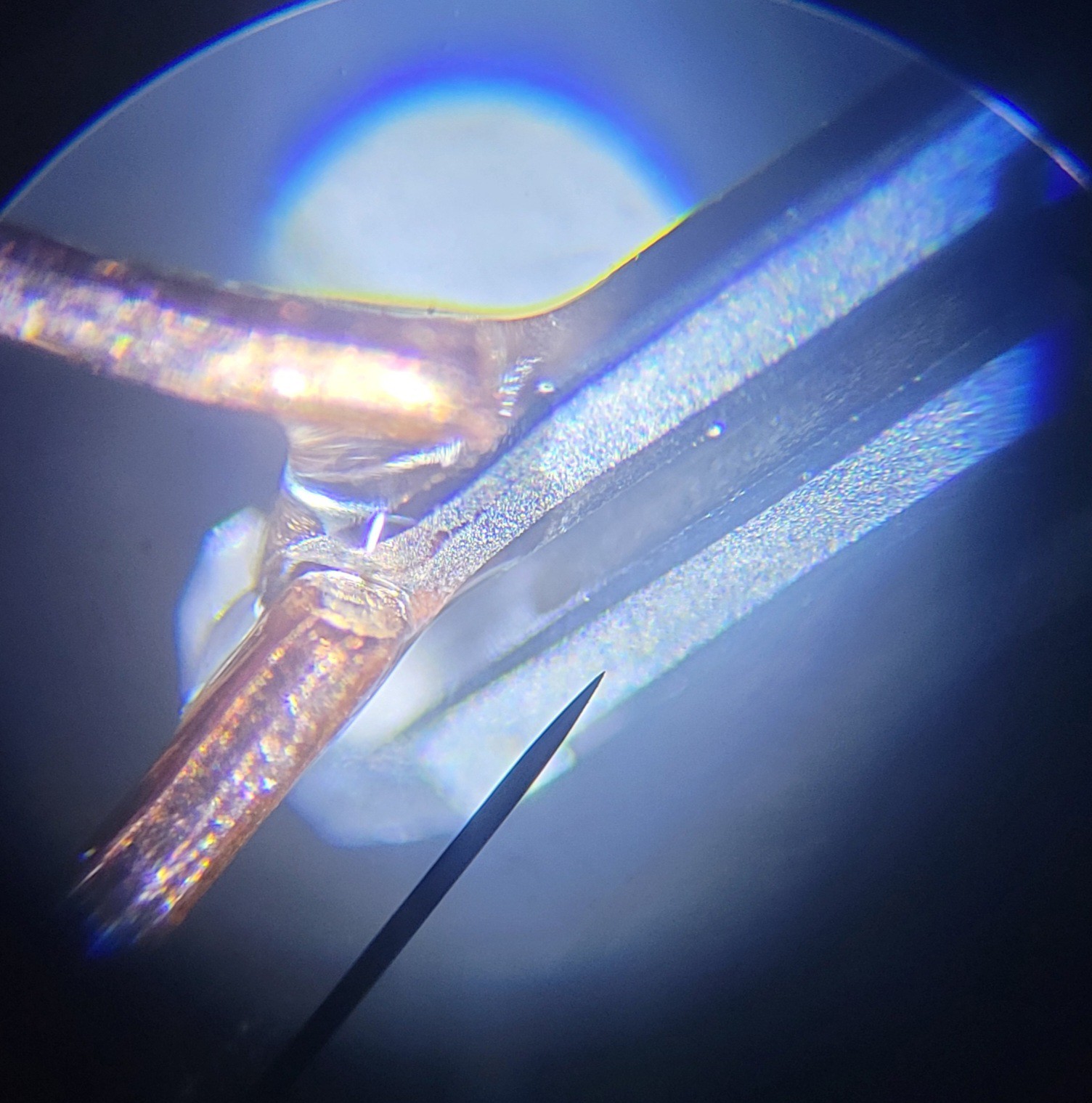

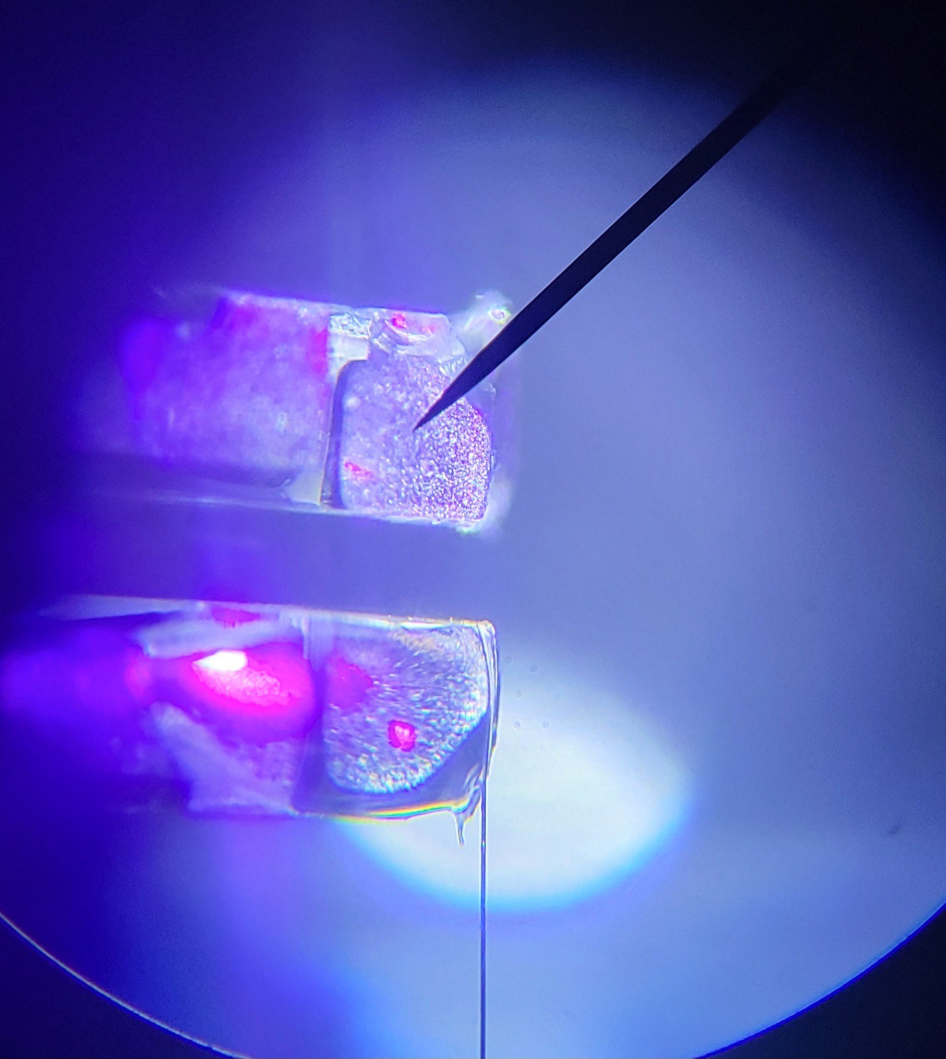

Working with UV glue is so easy. I've managed to connect Tungsten wire to quartz fork without any issue.
Here is my setup:
After few minutes of UV currying. The connection looked very strong much better than supper glue after same period of time.
I've learned how to use UV glue in this microscopic environment. Got pretty good connections.

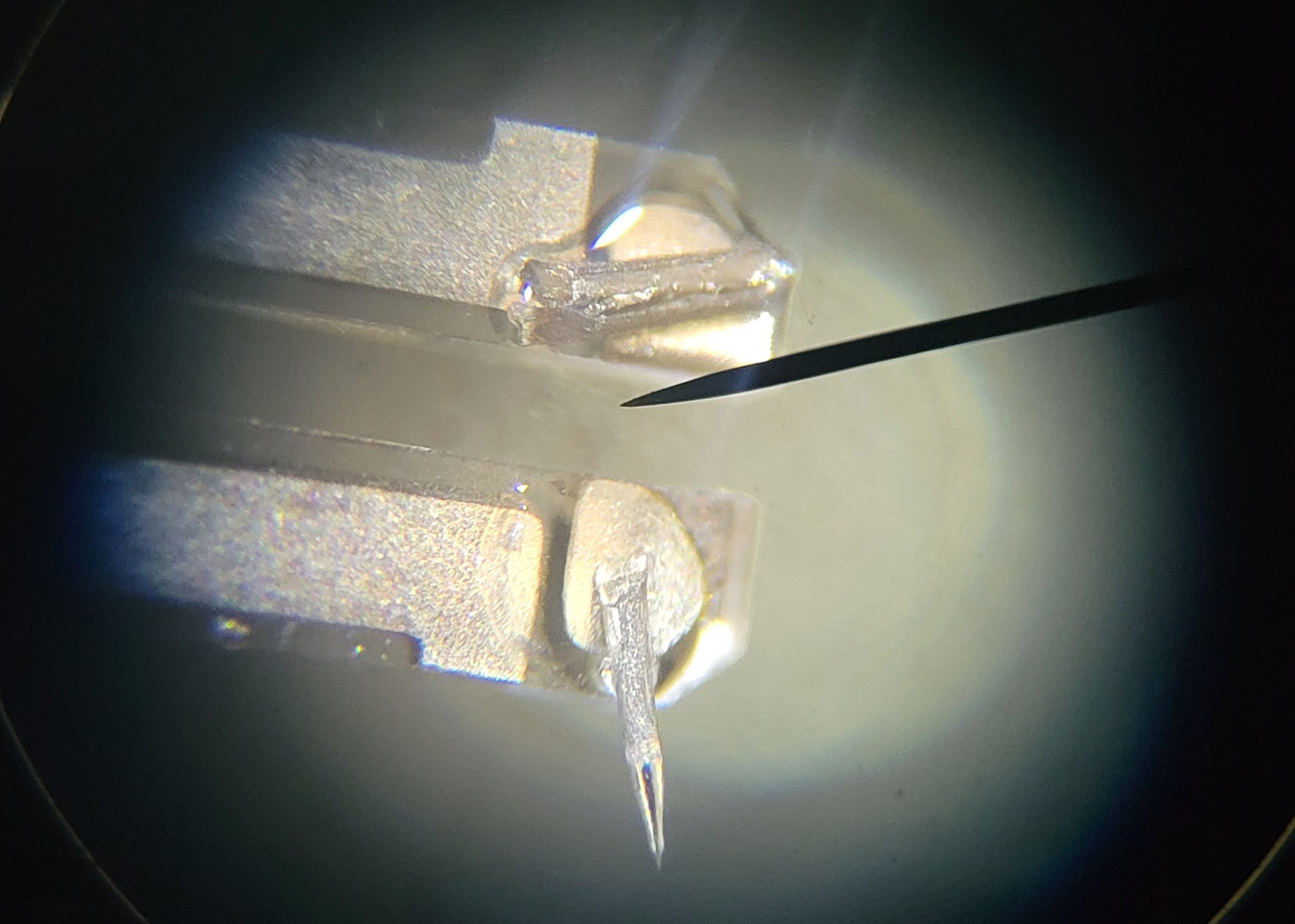

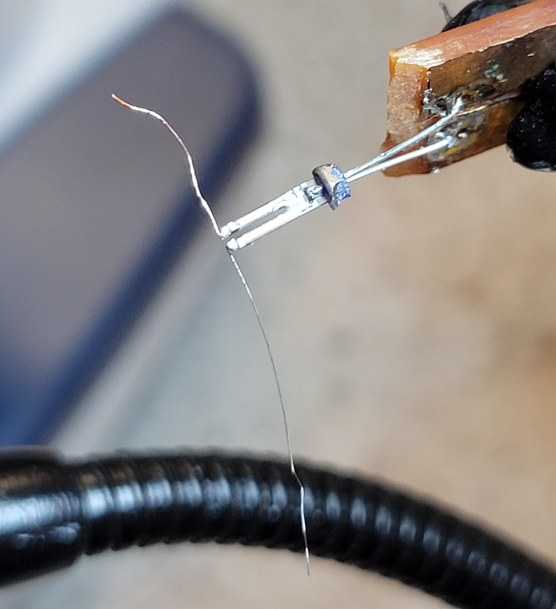

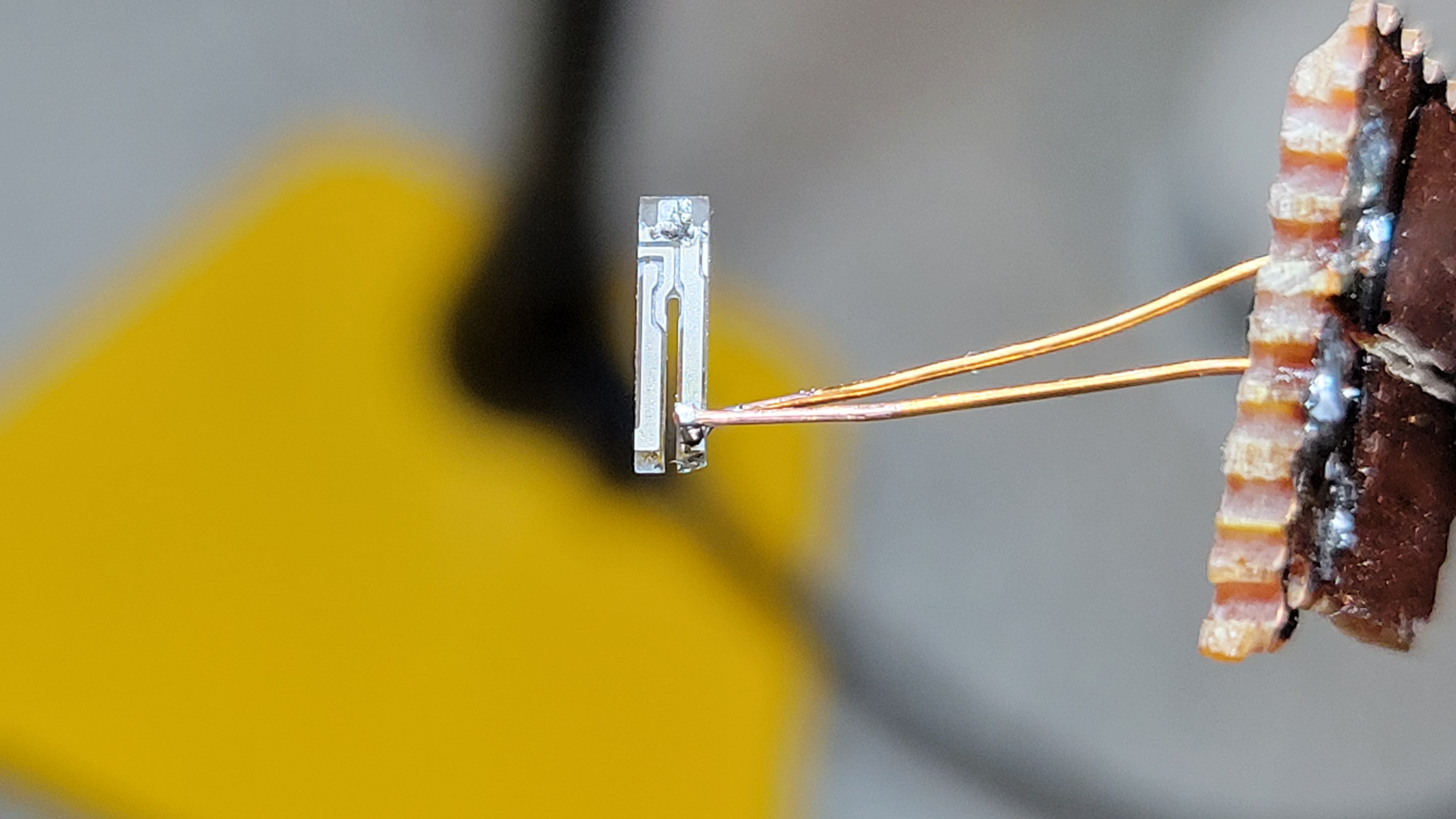

Just realized I could add Tungsten wire on one side and copper wire on other side of Quartz Fork. To remove material from copper just place it in Ferric chloride or Sulfuric acid for a bit.
Ok, got quartz fork with Tungsten on one end and copper on the other.
On microscopic level it's looks like
I will make another pair of those and will learn hot to etch. The tricky part would be to find the right length of copper wire to counter weight Tungsten.
Made another two copies, it's quite easy to build those with UV glue.
Let's hope it's also easy to etch and balance. (Otherwise I don't get a clean frequency) [Low Q ]

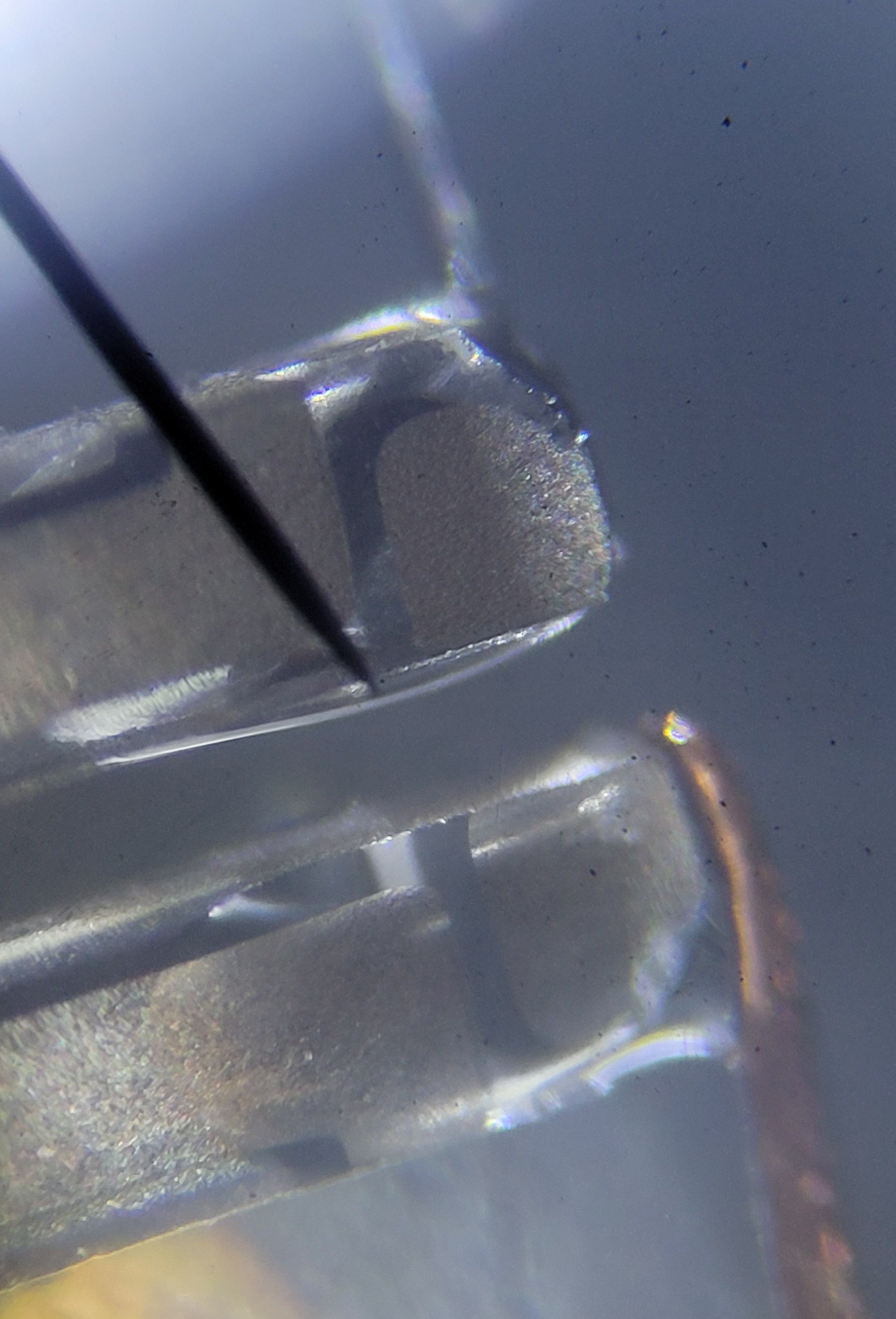

Let me stare the obvious, copper wire is not enameled. I've just cut a 5mm standard electric wire. (Otherwise we will not be able to etch it)
From three I was able to etch only one. Other were broken in the process. I should revise the etching device, unfortunately I don't know how to improve it yet.

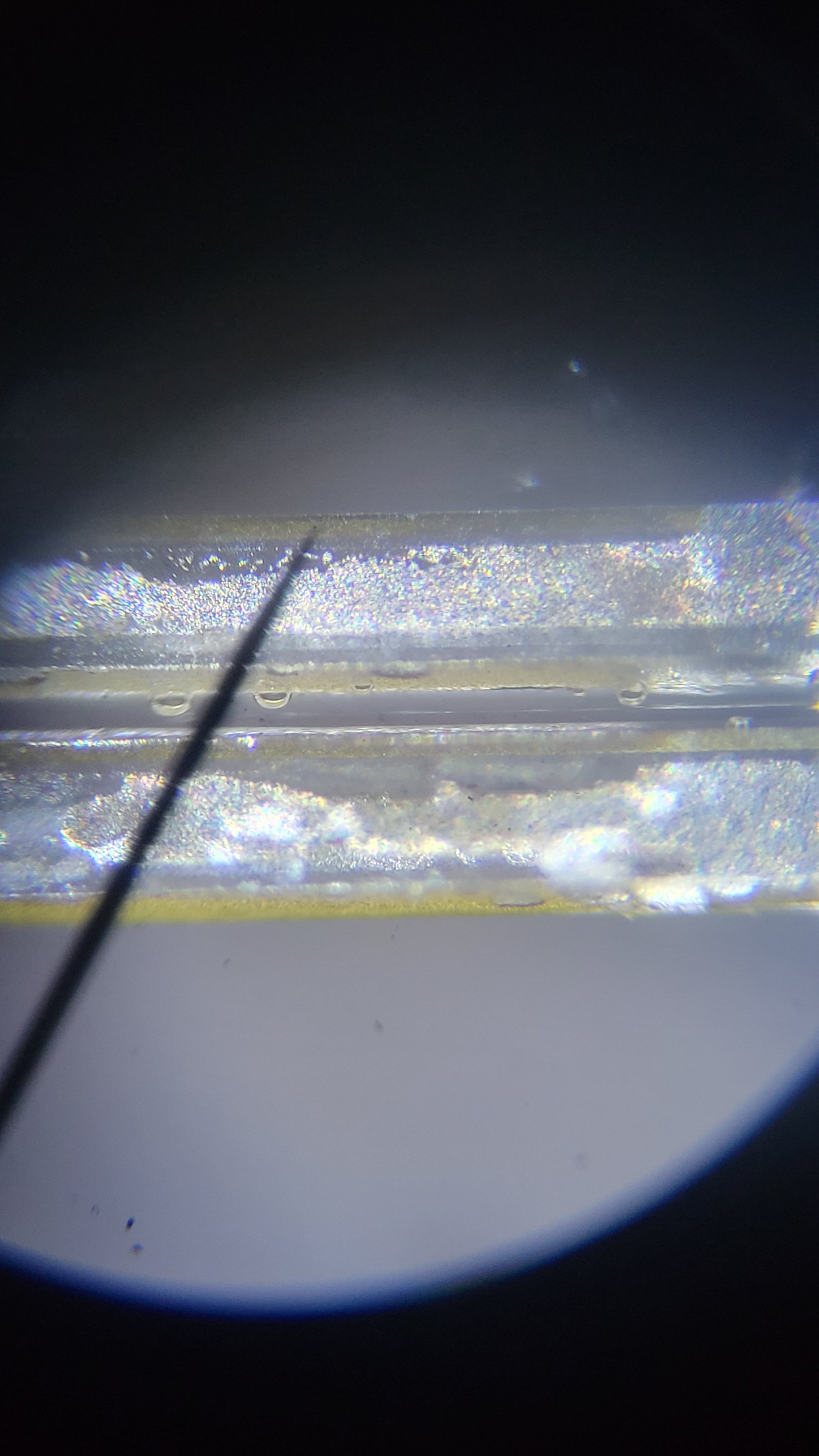

With more magnification
Now let's etch the copper side and hope to get high-Q (oscillation)
Etching copper seems to be a good idea as it easy to control the length of the copper to a high degree
I've used a drop of ferric chloride literally. With pipette we can accelerate the process even more.
Although it seems very good it might not work as I managed to drop all this quartz fork into drop of ferric chloride [Yeah I know clumsy me]. I don't know if it's going to work. One thing for sure I know now how to prepare dozens of those. With 2$ for ten forks and UV glue I am not worried so shouldn't be you.
I will test it tomorrow, fingers crossed

Removed Tungsten and Copper and searched for resonant frequency I turned out that all yhe glue and removed 2kHz but still going strong.
So the problem was unmatched lengths or heavy Tungsten/Copper 'needles'.
I will give another try to 0.01 mm wire, it's the only that worked so far. Let's try to glue it and etch it.
0.01 mm looks tiny even under microscope
I was successful with gluing 0.01 mm wire. The trick is to use powerful light source and magnifying glass. ( Or maybe I need glasses 🤓)
I've found out that tiny drop of glue can break the symmetry between the prongs and kill oscillation. I still didn't find a reliable method to apply glue to maintain oscillation.
Another attempt this time I've glued Tungsten wire from side instead of the top.
In the past I've used to connect from the top to make a better grip of Tungsten to quartz prong. With UV glue it was not necessary as it much stronger than supper glue for some reason.
Plus, I've used smaller Tungsten wite. If in the past I would use 2.5cm (inch) length wire. Now I am trying 8mm. Shorter wire means easier to etch. I do afraid it will negatively effect form of etch as there will be no enough weight to pull Tungsten wire down when etching.
Etching with smaller Tungsten wire turned out to be a beter solution.
Was able to make the best tip so far
By the way 0.01mm wire was not successful. Probably because of low weight, the form was not a sharp.
I am having trouble with making those tips. I wasn't able to produce qPlus, using Tungsten and Copper is problematic since ferric chloride is powerful enough to destroy the glue and quartz fork tiny wires. Building two sided Tungsten is problematic in a sense of how to control exact size of each wire. I mean you start something and it ends up with different length.
Ok, I will try now to add a piece of Tungsten to counter weight the sharp Tungsten wire.
The idea is to glue Tungsten wire sharpen it using NaOH. The tricky part is to find a tiny piece of Tungsten the size of etched one amd gently glue to the other prong.
I found a working method,
The idea was just adding counter weight
From four I got three working which is amazing compared to other methods.
Got clean response at about 30,000Hz (low was 29700 and highest was 30700).
Wanted to share what I've changed to make it work: Instead of gluing from side I am gluing the Tungsten wire on side. It makes connection stronger and it's much easier to glue. Using UV glue you can do it slowly as it will not dry out. Don't use gloves when working with NaOH, gloves makes me clumsy. Instead I clean alkaline solution before I touch it (never touch NaOH with bare hands, you get cracked skin for a week). Shorter Tungsten wire, brakes less much easier to work with. Lower voltage I've switched to 4-5v from 7-8v. It's slower a bit but the form is much better. And MOST IMPORTANT do everything under magnifying glass, that is the secret for success. I use 3x magnification glass for soldering station. Last but not least I applying glue using 0.3mm wire and perform under microscope to put glue in the right spot and right amount. In order to make Tungsten wire stay still I use double sided tape. (I touch the tape multiple times to make it less sticky [almost not sticky at all] otherwise it will break the glue once disconnected.
More images

Now, I managed to calibrate it better and run on the same surface to see if it gave me same (give or take) image.
My raster scan is not perfect as you can see this comb shape image.
Another problem I've noticed is that images are quite binary it each not touching (and getting 100-150) the surface or it does and goes to 240-250.
The yellow color is where fork touches something the blue/green is where nothing detected.
Contrast is another issue, it took me lots of trials to get a better contrast:
Last but not least is that I don't know what I see. I have only one sample of CD-RW surface which I have ripped off. Some places have information and others don't. I don't really have control over where I land in this nano world.
Some claims to see atoms with STM, using similar piezoelectric discs, those structures are sub nano. Red laser, CD RW has 0.8micro size grooves and 1.6micro spaces between them.
So, I've tried to change step sizes from 10 to 100. Still I don't seen the groves although I see some forms and they repeat until I restart the setup.
I feel like this joke: the surgery was successful the patient died.
I got working machine but the magnification so powerful I don't even know what to expect.

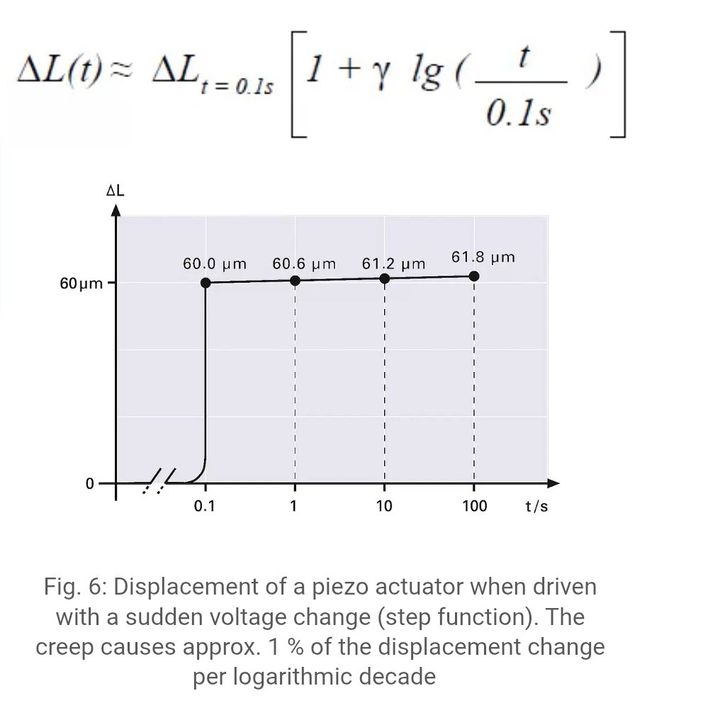

I finally solved the creep issue, after learning more about phenomenon I've found this graph
So, what I have it's not a creep, creep should be about 1%. So, I've suspected in the tiny connection wires of quartz forks. Could it bend each time it touches the surface?
To test it, I found an old quartz fork that was glued to the usb PCB plate.
Since I've solved electrical issue (by connecting plate to ground) I was able to use this one.
Ta-Da!!! It's working as a charm. No creep issue at all (even after going 3k steps down and back)!!! Now all is left is to connect vibration reduction and hope for the best....

Now, I've followed the same procedure. Approach, few times getting closer and then scan. For now I scan only on one axis, so it easily to debug without the need of copying contacting etc. Plus, I prefer to do step by step.
The results were better than I expected.
Here is two scans from same point in the sample. one from right to left and second from left to right. You can see the same notch in opposite places.
The 250 is where touching something and about 200 is where nothing detected. This is not a noise as noise is much smaller in range of 5-10.
The graph is quite binary but it can be much smoother when I will reduce the steps from 10 to 1 per hop. ( I've used steps of 10 so more surface would be scanned [I want amplification better than optical but I am not interested in seeing atoms at this point])

I suspect that this is mechanical, as I've applied too much glue to hold the electric wires when connected piezoelectric elements. Plus used regular electric wire instead of one thin wire
I will try with using tiny wires and soldering paste and see if it's the problem
Made another mechanical part version 4.0 I think.
For now I have used AliExpress micro positioner, only because it's smaller and easy to obtain. I should go back to OpenFlexture Delta stage, since it more accurate ( I think, don't know how to measure it) and can be easily motorized.
Used old piezoelectric discs to try to learn soldering. It turns out brass part is easy to solder to quartz almost impossible without ruining it.
So I will use conducting ink(scribepen)+super glue to connect 0.3mm wires.
The result was quite good and even my kids were unable to break it. Let's connect the real one and hope for the best.
Started adding thin wires (ground) so far so good.
Now added the connections for each piezoelectric disc, the connection is in clock direction. (To ensure X+ and X- are in negative directions) used bit of scribepen and super glue.
Let's dry it for the night and see if it is working or this project goes to garbage 🗑️
Good news, the new mechanical part seems to work much better.
Was able to get to 25 and 10 steps resolution (less than that, I think, is waist of time since 25steps is 25mv which is my currently noise level of the system)
I mean I was able to set position so I was on the edge between touching (the sample) ~250 and not touching ~80. It was about 200 and minor change of three steps of 25 could take you up or down.
Some important changes: I've connected the plate that holding sensor module (the PCB with USB on it that quartz fork connects to) to ground and got much better SNR. Instead of 180 I got 80.
Also, used the vibration reduction system which was a tire above it box with rocks (for weight). On top of the box I've put metallic plate to make sure plastic doesn't get deformed. On top of it all mechanical stage.

Probe #3 - Quartz fork with Tungsteen wire (sharpened by NaOH)
If already wrote about how to create supper sharp Tungsteen wires (this project logo :) ) but once I glue it problem begins. If there is too much glue on the fork's prong it kill oscilation. If too little it doesn't hold the Tunsgesteen wire properly. Glue plus wire kills oscilation sometimes only the glus's weight kill oscilation. like in thie case

Probe #5 - I was totally clueless of how to continue.
Then I recalled that I own really thin Tungsten wire, of 0.012mm wide. It's so thin it breaks easily in your hands. But now I got more experience and nothing to lose. I managed to push some wire into syringe. Since it was so tiny I thought to use 0.1mm wire to paste the glue (instead of toothpick).
The glue was strong enough but I had another problem. Since the wire was so short I couldn't etch it. Luckily (yeah, I feel lucky today) I managed to cut it with scissors. (It's impossible to do that with 0.1mm wire, it breaks the glue)
Now I've tried to scan the frequency and TA-DA! I got stable frequency

Was able to do first measurement with Tungsten wire.
The procedure is run 'range' which runs coarse frequency change of 1Hz and range of 200. This finds the frequency where maximal/minimal eclipse occurs.
Now we set new base frequency by 'bf' and run 'land' function steps of 100 (I ran with 1000 and crashed into sample). If fails to land change high of micro meter movement (open flexture Delta stage).

Added 'ph'ase function which changes current phase. It helped to change convolution result from ~120 to nice ~ 30. No matter what I did I couldn't go below 30.
Going step by step, I thought it would be a good idea to test the 'land'-ing function is consistent. I tried to descent in big and small steps but the result is same if you find a place where convolution changes and goes up and down again the convolution still high. This is the basic step for measuring height. If this not stable we cannot go to scan. Now when I think of it one of the problem could be phase change once probe touches sample's surface.
Update IV:
Today I was able to depth difference between two consecutive runs of 200.
It was without shielding and without vibration reduction. The only difference was that now all my appliances are off, and windows shut, as it cold and super late.(I am happy I don't have to rebuild the electronics)
Let's wrap everything in aluminum foil and go to the next step...
