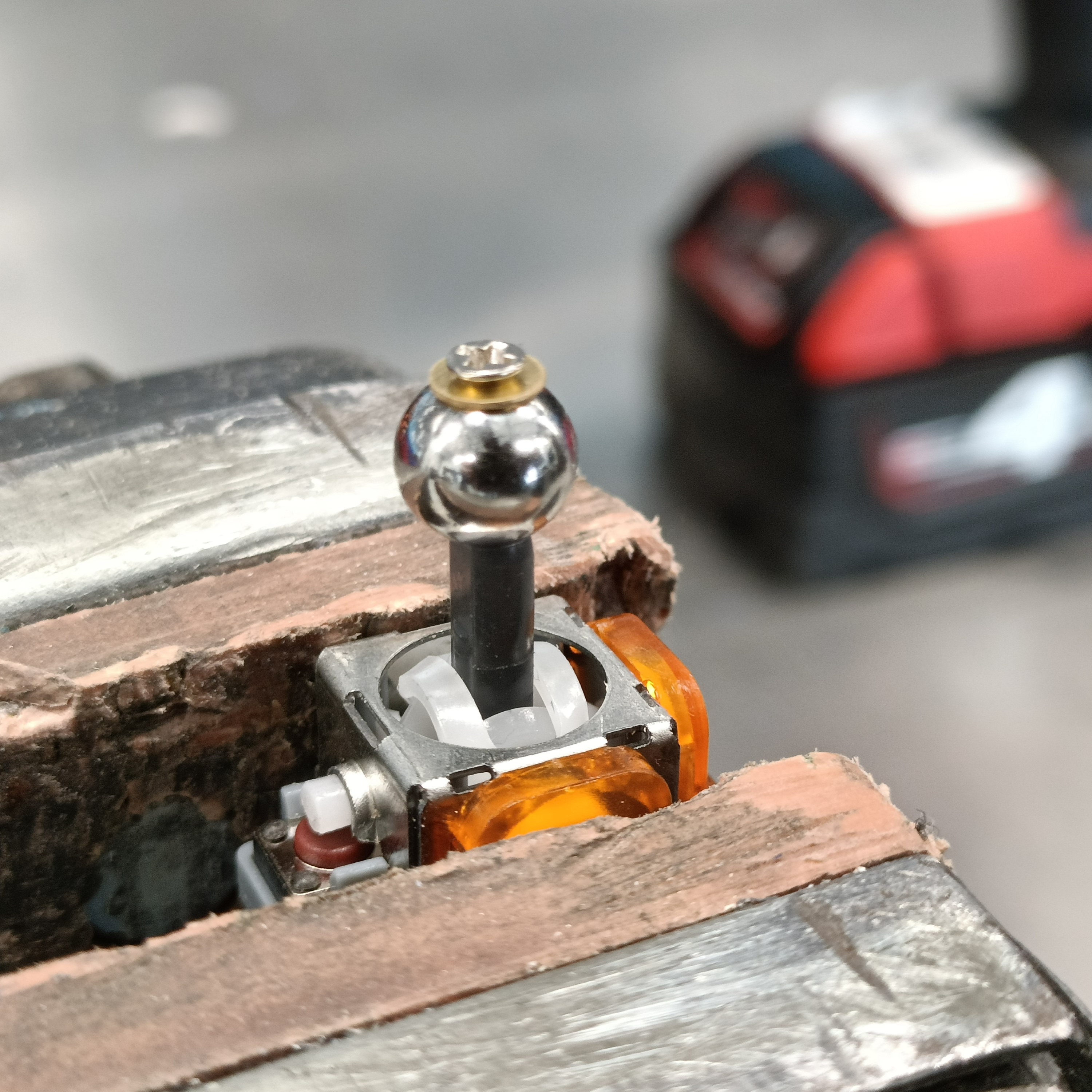

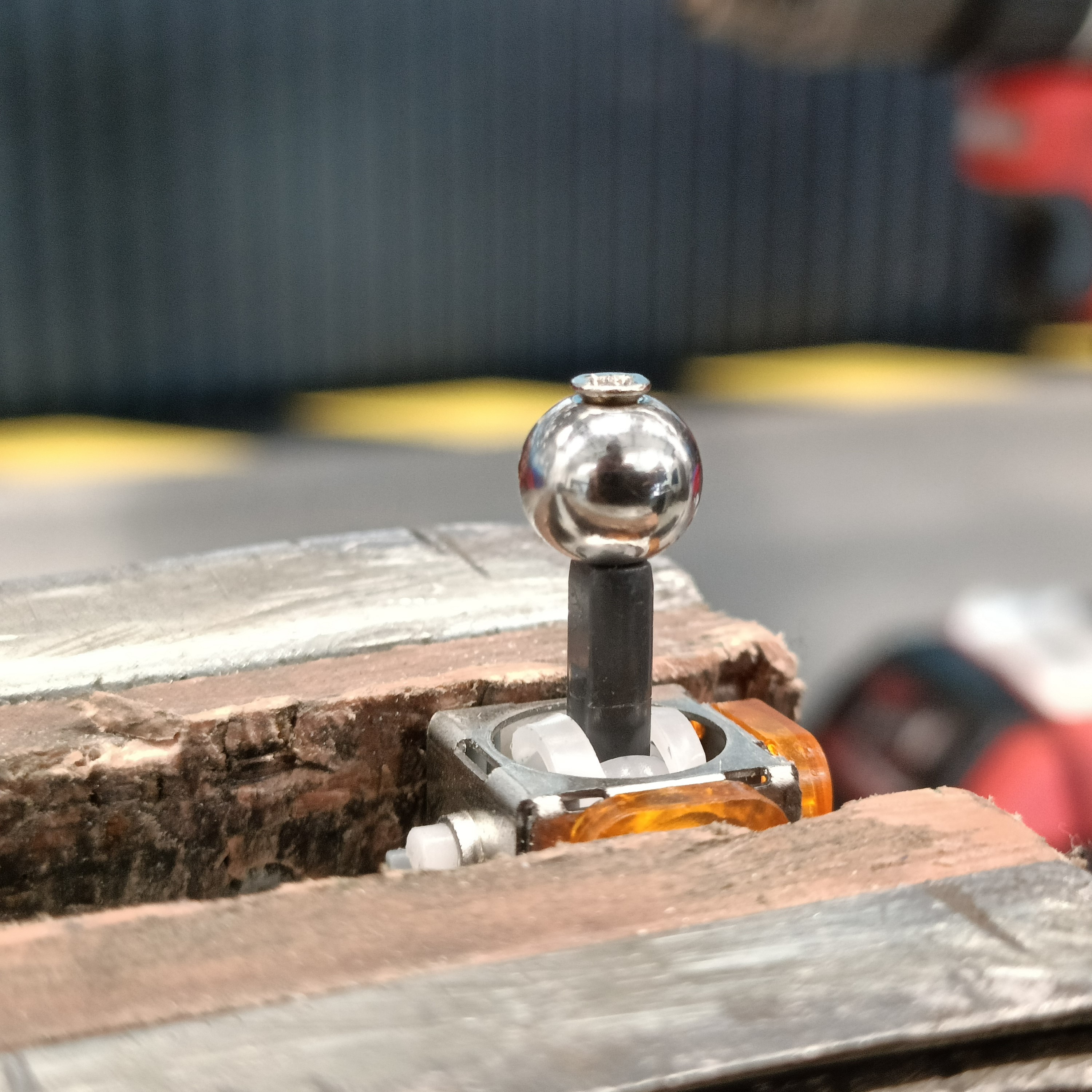

  • [X] Balls secured to joysticks
    kelvinA04/29/2025 at 18:26 0 comments
    First thing I did was download the drill guide .STEP and confirmed that dimensions seemed sensible, so I printed it and the joystick was a nicely snug fit: The printed hole needed to be drilled, which is probably by design to have the best tolerances. I tried 1.5mm, which barely fit in the drill, and then opened it up a bit more with a 1.6mm bit.
    The 1.5mm was black and the 1.6mm was almost brass in appearance; the drilling difficulty felt like cold and room-temp butter respectively.
    Then, I tried drilling the joystick to 1.5mm, which worked, but the screw wouldn't start. I tried again with the 1.6mm and it started to screw down after maybe 10 seconds of spinning:
    Immediately after I finished screwing, I thought "Haven't I got the washer on the wrong side?" and so I checked:
    Well everything seemed perfectly stable and the plastic didn't seem like it was going to break or anything. I actually asked this question and never got a response (see below) so I decided I was going to spend the £1 on washers just in-case.
    I decided to try having the ball as the washer, because it would be even more tedious to put the washer between the joystick and ball during assembly, and it looked and felt fine:
    So I did the other 9 sticks, following these steps:
    1. Sort out the balls. I filtered out 3 balls that were nominally 7.90mm while finding 10 that were 7.97 - 8.02.
    2. Drill all joysticks using the 1.6mm drill bit. I kept the drill spinning when pulling the stick out in an attempt to avoid jamming and keep a good interior surface finish.
    3. Put a joystick in a vice. I like to have the orientation as shown above so that I can see early if I'm crushing the yellow plastic.
    4. Put a screw in the ball and hold the ball to help guide the screw as I spin for a couple seconds.
    5. If the screwdriver skips 3 times, unscrew.
      1. There's 100pcs of screws so I'd rather get a new one. The more the driver skips, the worse the phillips head becomes and the more likely it is to skip in a negative feedback loop. I rejected 3 screws due to this, with the last one being very close to being perma stuck.
    6. When the screw stops turning, it's good. The ball doesn't move or twist and I don't have to do any "final tighten" or anything.
    7. Take the joystick out and GOTO step 3.
    Lastly, I tried the bushings with the first stick I did (which is the joystick I opened in a previous log) and it slid rather nicely. This strategy is soooo much better than having to try and install smoothly printed adapters.

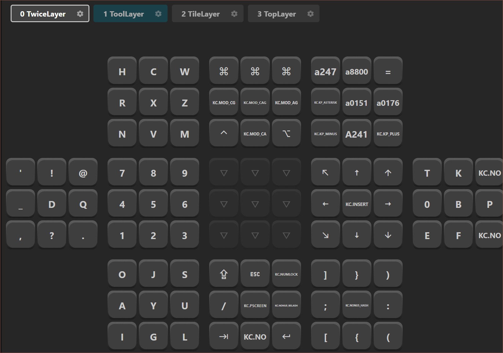

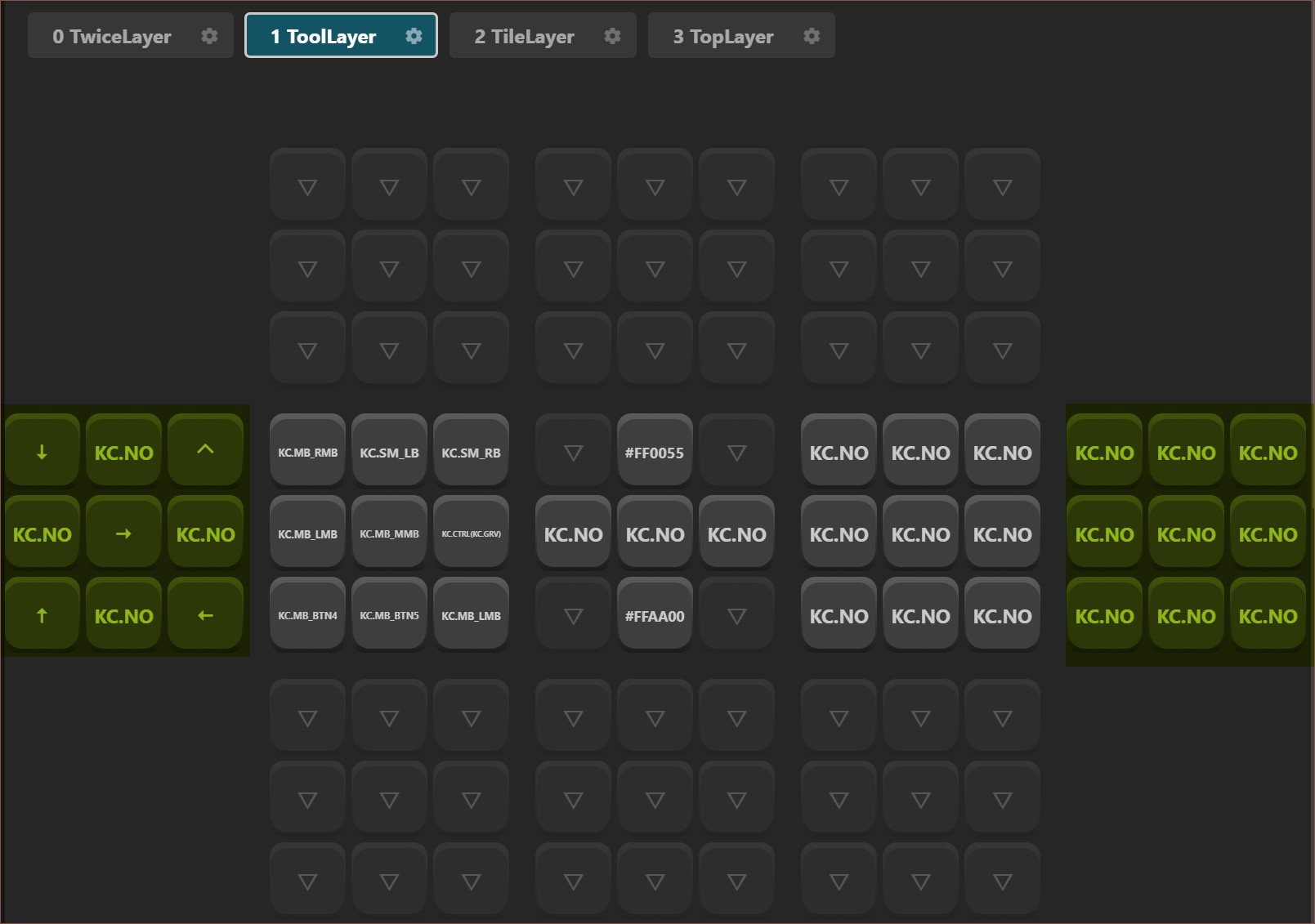

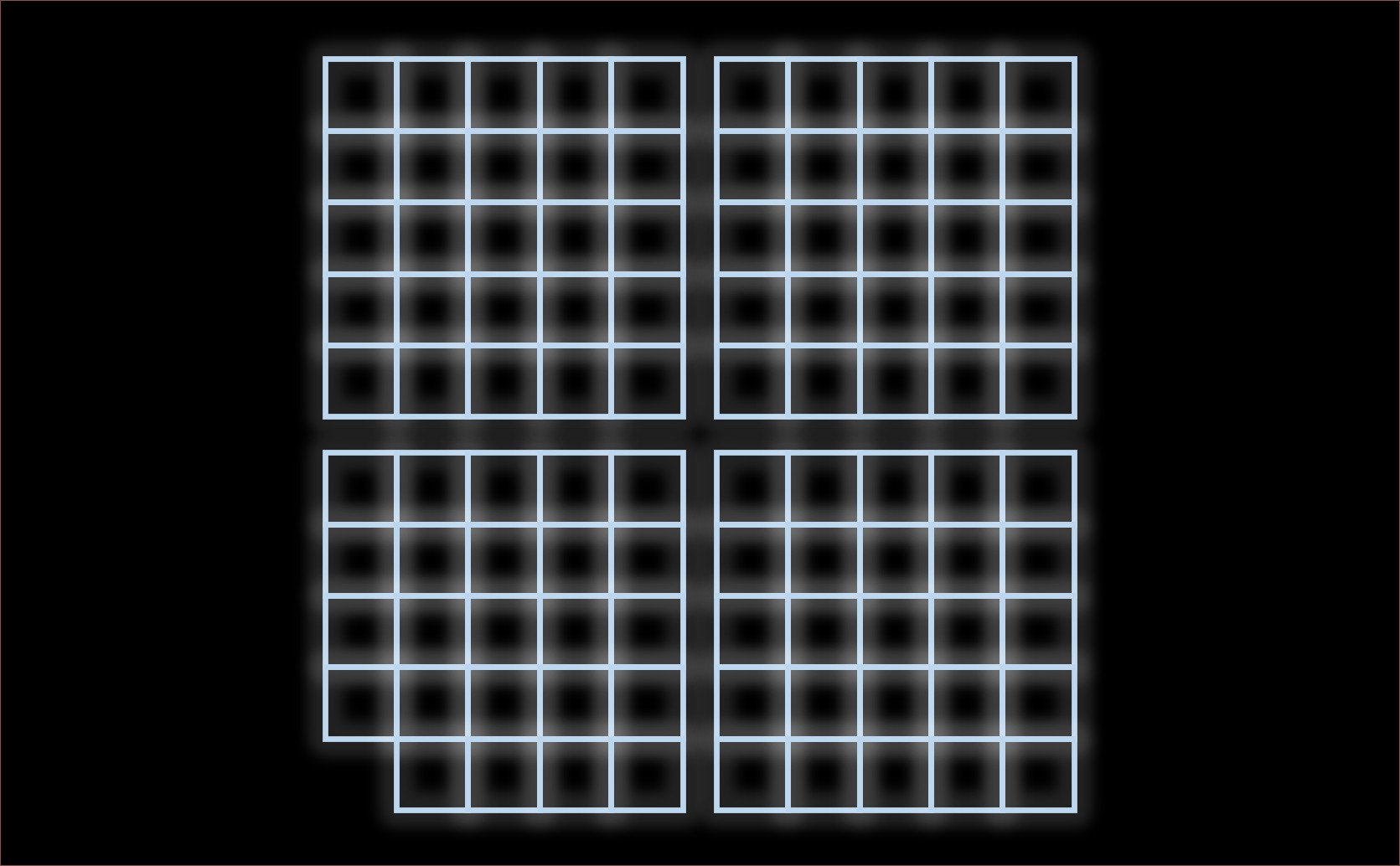

    The currently populated layout, which skips 5Y chords.

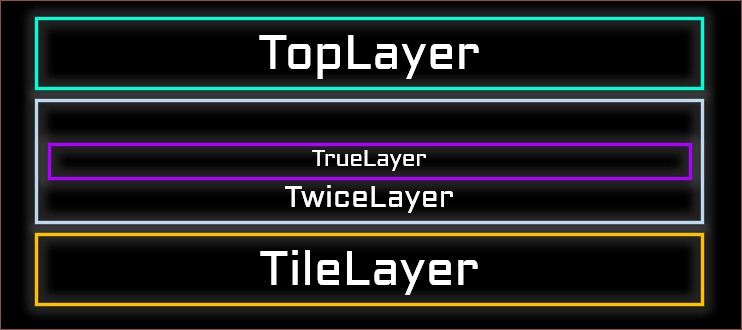

    TrueLayer
    As you can see, I've moved things around, mainly so that one doesn't have to go to another layer to access symbols. You might also notice that "TrueLayer" has been renamed "TwiceLayer" because I've now coded in the true "shadow dimension" layer, which is 18 keys with no chord-mapping, intended for things like game controls.
    As mentioned previously (I hope), the numbering for the wells on the right hand matches that of a numpad. Thus the 4 physical buttons map to a keywell value of 1, 3, 7 and 9. For Well4, a value of 3 is the TileLayer and 9 is the TopLayer. What happens if you try to go to both the Tile and Top layers at the same time? Well4 = 6 is when spacetime momentarily collapses and you enter the TrueLayer.
    As you know, there are 20 keys on each side. Thus, 18 are 1:1 mapped and the last two, residing on Well4, escape the layer:
    # Bottom Right: 12 34 56 78 9E
      This is partially so that the bottom and top fit in a box of 9 (see below) and partially so that pressing Well4 = 6 again causes another rift in the spacetime and a negative of a negative is a plus, thus you end up in TwiceLayer again.
    The ToolLayer with the TrueLayer section highlighted green. The bottom is on the left and top is on the right side.

    Letter and Symbol Placement
    The most notable addition is the CTRL on Well4 = 4, so that things like CTRL-A + CTRL-C could be entered. I feel like this feature would be more useful for the CTRL-K shortcut in Visual Studio Code. The location of K is related to the location of C, which is on top because of "copy" and V is on bottom because of "paste". X is in the middle because it's like scraping of a sticker with a fingernail. Finally, Z is to the left so that "undo" isn't hard to do.
    For the location of the keys, I've assumed the following list of easiest-to-hardest chords per keywell:
    1. Bottom keys are easier to hit than top keys, and it's easier to stay on the same side of the well. Thus, I've picked =1 as the "easiest" key. There's little reason why it couldn't've been =3 instead.
    2. Keywell values that use more keys are less reliable to chord. Thus =5 is the hardest.
    3. For any XY chord, 0Y and X0 chords are easier just because only one finger needs to move.
    Thus, you might be wondering why a bunch of punctuation, or seldom-used characters like K and Q, are on these easy 0Y/X0 sections. It's simply to prioritise flow. Let us talk QWERTY for a bit. Due to its frequency, the E key could likely be anywhere and, from practice, not affect speed. In contrast, the Q key is seldom used and feels like a trip hazard when the shortest finger has to reach out for it, unlike the equally unused J key.
    Anyway, this is the list of considerations (in no particular order) that I made, with help of the character frequency of past logs I wrote and bigram frequency:
    Character before 'e' is [space] and character after 'y' is [enter]
    1. Constants on 7Y to match with T placement. Vowels on 1Y to match with E placement.
      1. Like with ZEV-XS, I put them on lesser utilised fingers to balance out the workload.
      2. Y is essentially a vowel
    2. As H is in the top 2 bigrams, making up 5%, I had to put that in the 7[1/4/7] row instead of S.
      1. H = 77 so that, somewhat satisfyingly, "th" = 7077 and "he" = "7710"
    3. Similar position for Q and U (0616), X and Y (7515),...

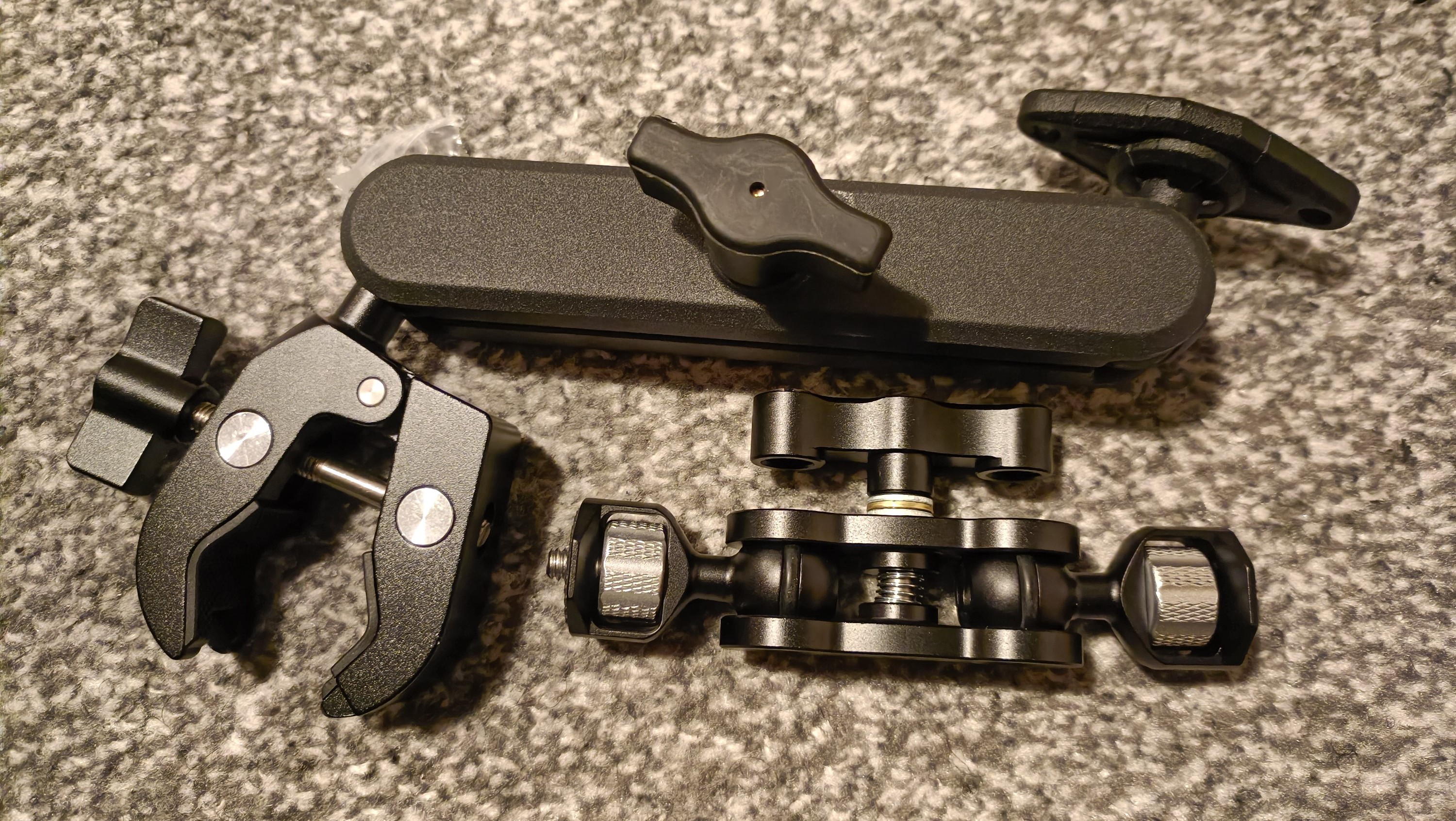

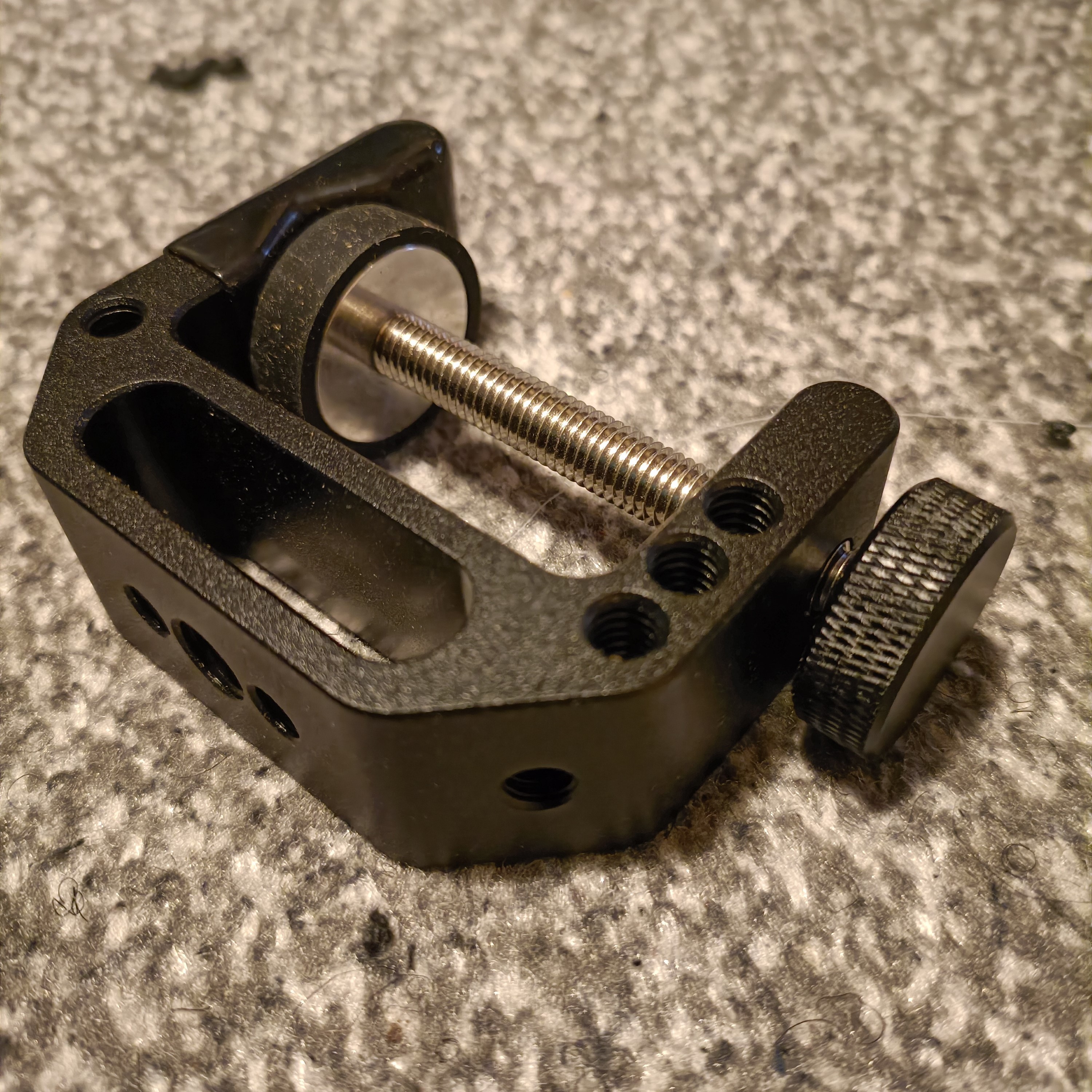

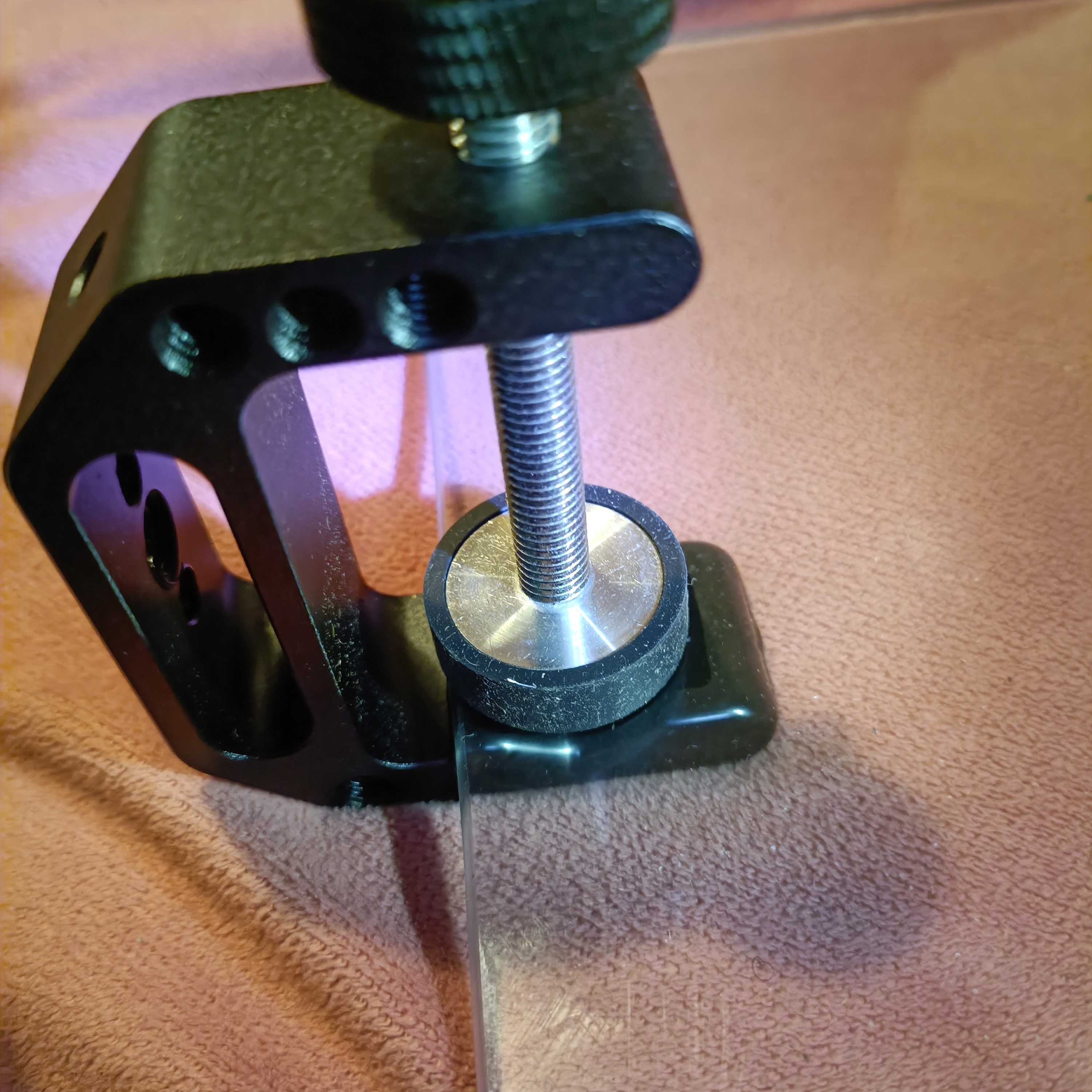

    Over the course of last month, the parts I ordered arrived so I tried some things out.

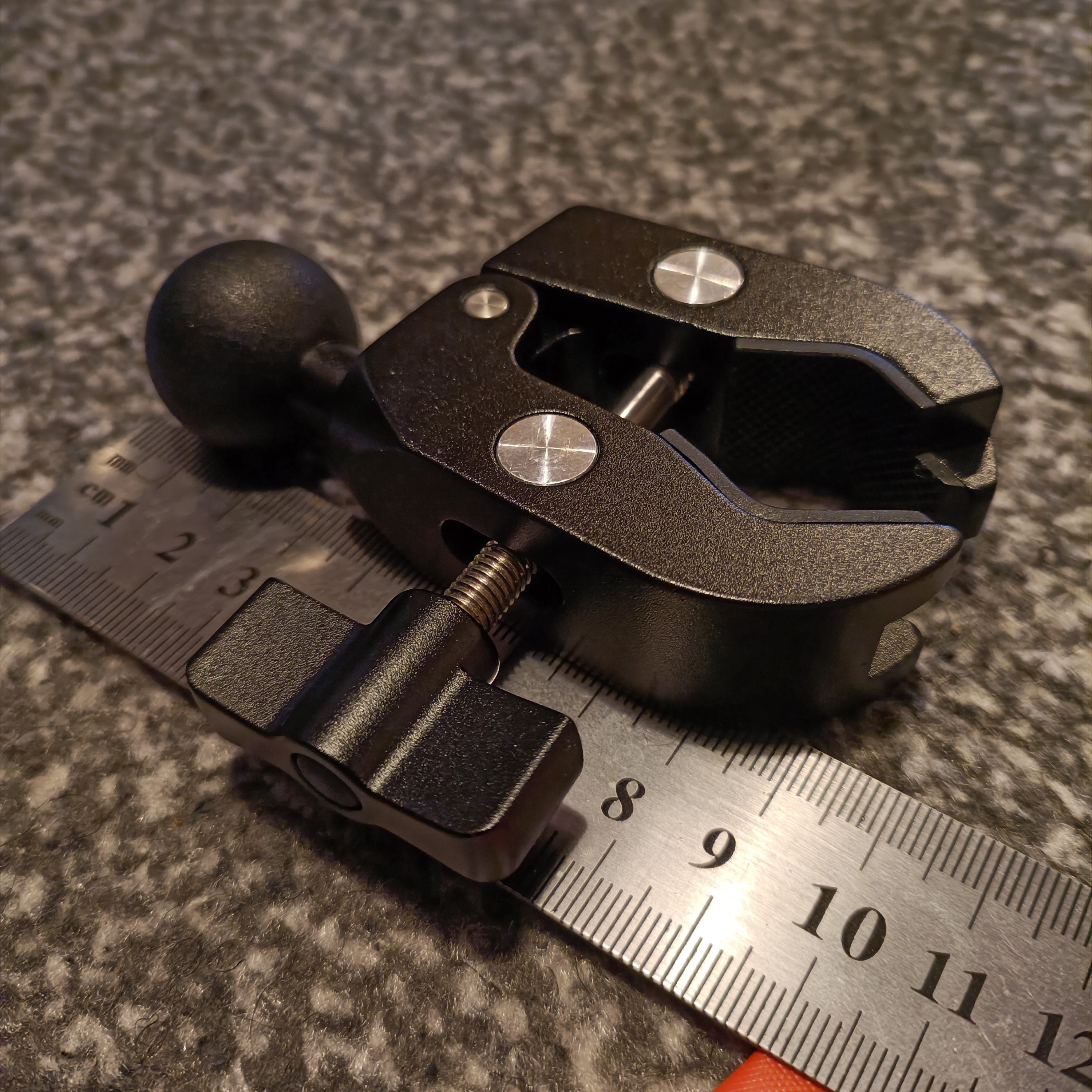

    C clamp and TM-5 magic arm
    The c-clamp was very nice, being able to securely clamp to a 5mm glass worktop saver and a 42mm pipe:
    The worktop saver is so that my portable monitor doesn't fall over when on a bed.
    A 27mm chair-leg, the same one that holds the #Coaxial8or [gd0144] spools.
    A 42mm handle-rail.
    There is just one very unfortunate problem (that I already knew was going to be an issue but I went ahead with the purchase anyway) which is that the vast majority of tubes out-and-about are larger than 42mm.
    I took my calipers outside to measure them. The most abundant size was 76mm for things like lamp-posts and signs, followed by railings that are 48 - 51mm in diameter. If only the c-clamp was designed to be 20% larger.
    TM-5
    This was disappointing as it still spun in place where the threads are. One reason could be that the rubber surface is just a thin embossed grid which folds over at minimal torque:
    If the rubber is looking like [the left] after 5 minutes of testing, I don't think this is going to hold up at all.

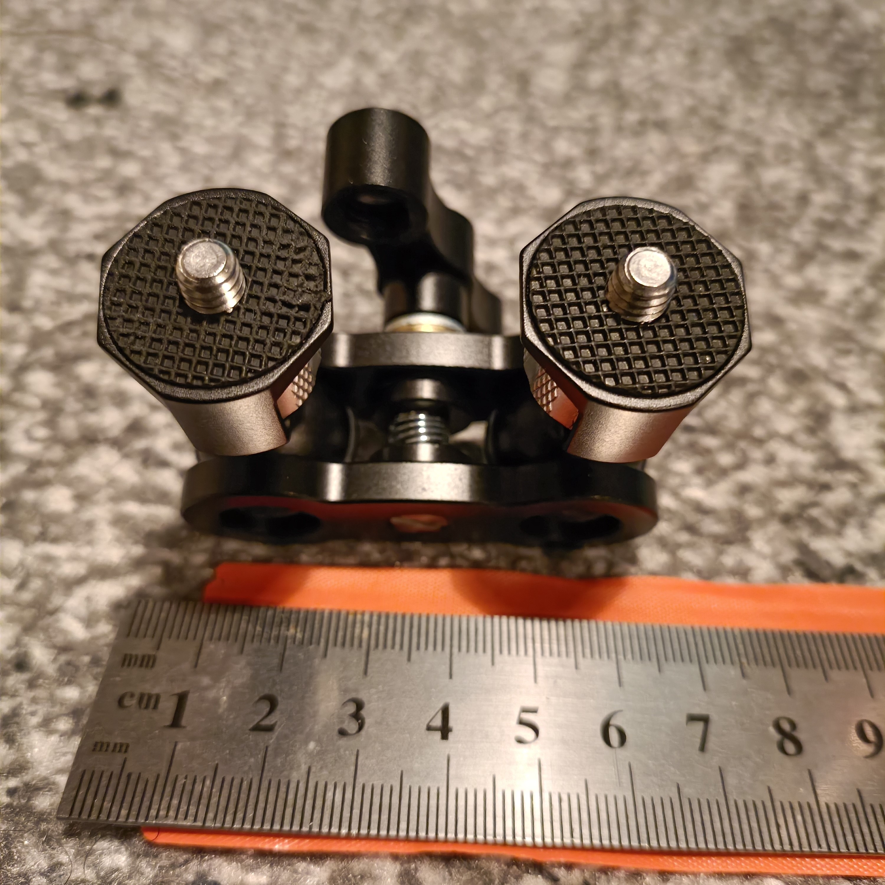

    1-inch Ball Accessories

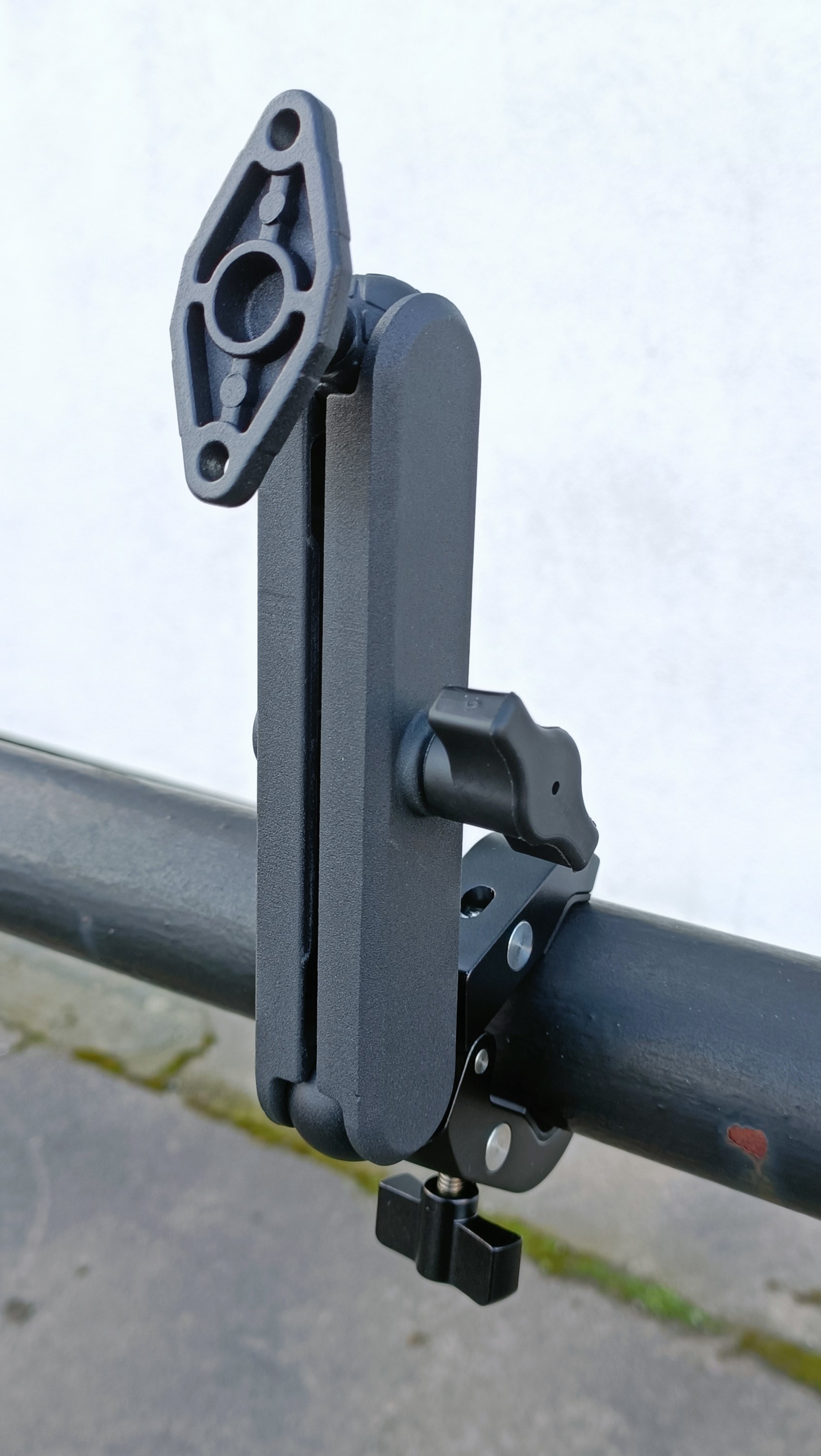

    I noticed that the ball joints themselves were very solid, so I was able to find some 1-inch ball accessories:
    The idea is that I get 3 ball mounts; 2 for the front and back of Tetizmol (for mounting options) and one to somehow attach to the c-clamp. This one would stay inside while the tube clamp with built-in ball will be used outdoors:
    I tried to find one similar to the c-clamp and failed.

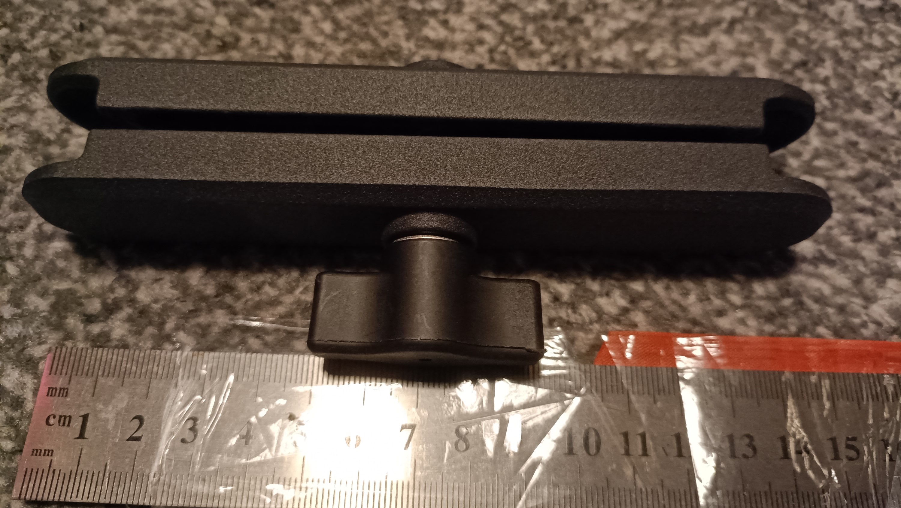

    It took a bit of looking to find a sleek-looking 150mm arm.
    Top: Ball accessories (assembled). Bottom: TM-5
    Without much effort, the handle of the arm can be twisted and movement of the joints is completely locked. Additionally, the handle of the tube clamp is easy to quickly spin to open/close the jaws.

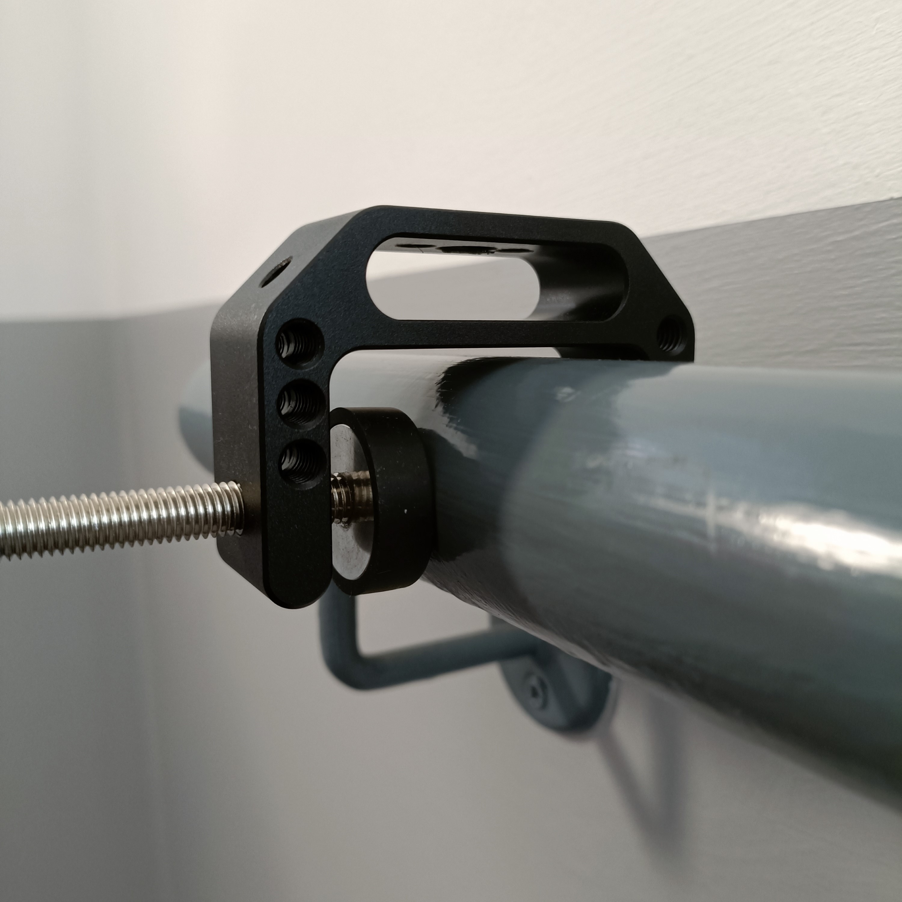

    Assembly mounted to 48mm railing.
    I would've preferred if the tube clamp was a bit wider than 20mm to better fight against torque forces, but I think it's actually the grippy surface slightly moving / flexing. Everything returns to its original position, so there's no sliding happening. Thus, I think it will be fine for this application.

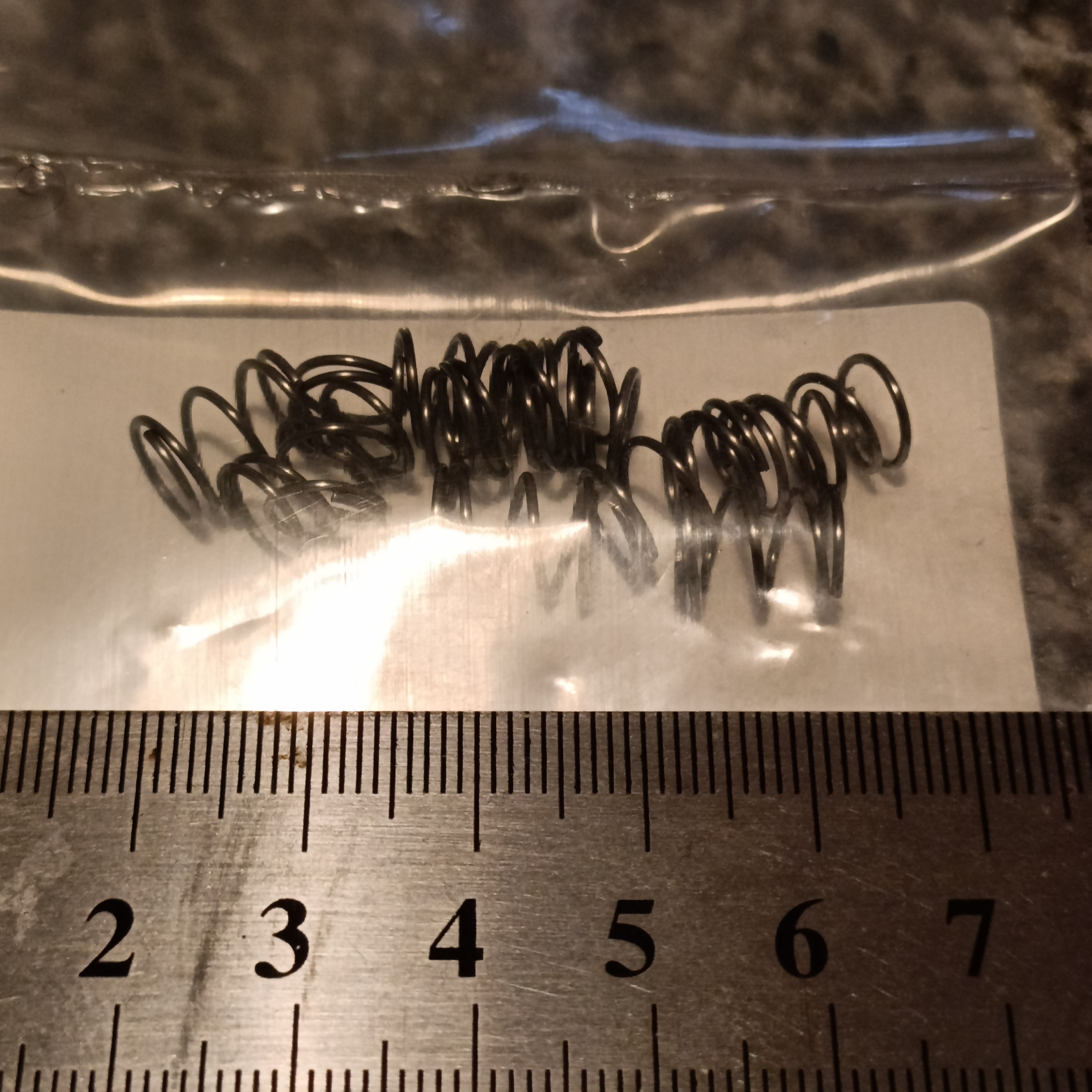

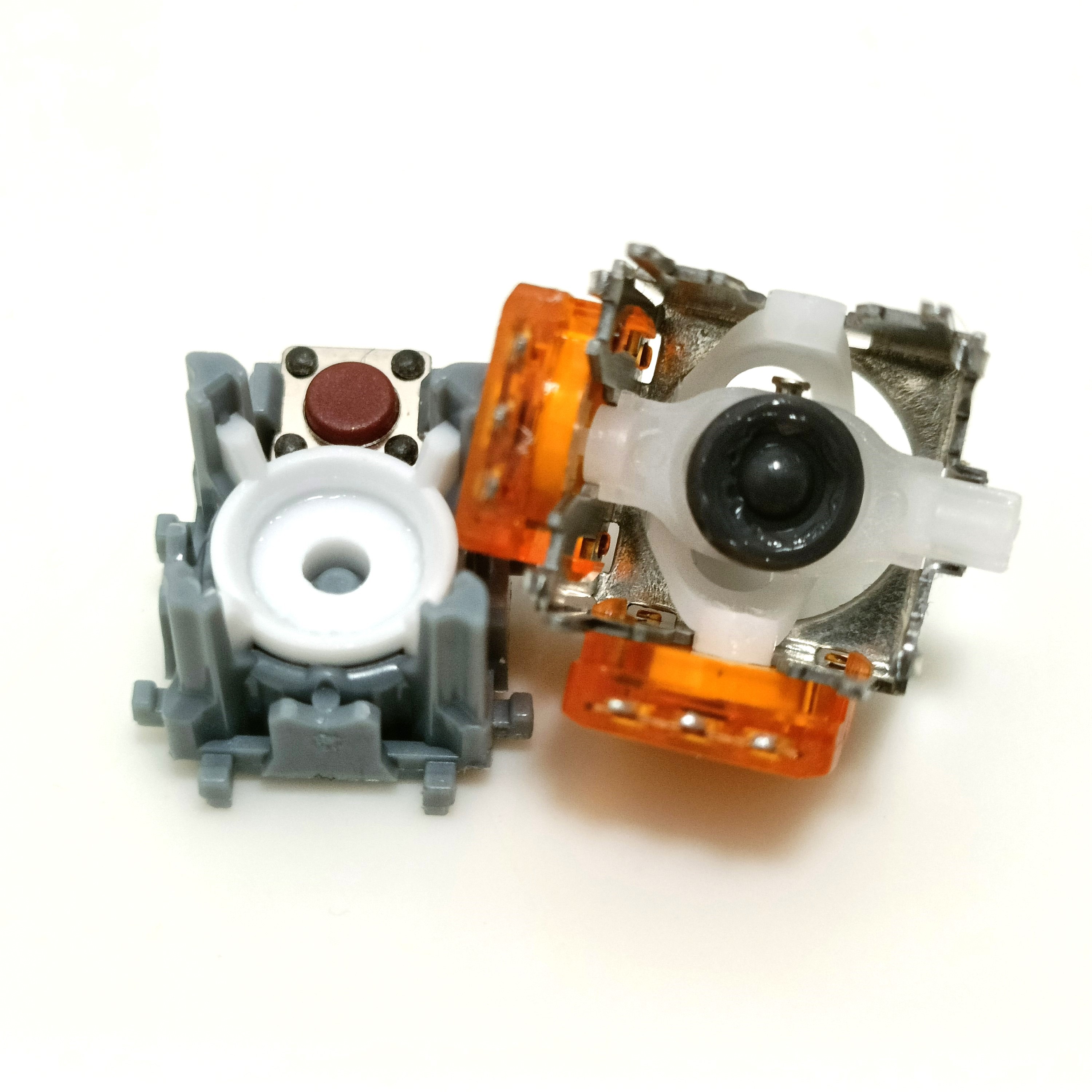

    Joysticks
    I measured about 90gf for displacement of the stick, so these are already 50% stiffer than the original L4A joysticks seen in:
    Using the smallest flat-head attachment I had, I was able to fold out the 4 tabs under a joystick and separate the base from the frame:
    The plunger and stick are lubricated.
    2 of the 4 legs have very small bumps in them that prevent the plunger from launching out. Pulling them apart allows it to come off.
    The spring inside is 0.5 x 8.7 x 11mm and compresses down to 2.05mm height. In contrast, the springs I bought only compressed down to 3.05mm. The stock springs slot around a cylinder on the other side that is 7.6mm diameter.
    I had calculated that the difference from 0.5mm to 0.7mm would be a 3X difference, but unfortunately it's more like 10X. I measured about 120g and 1200g respectively when compressing both springs down to 5mm height.
    I put the joystick back together, but the axle that rests over the push button now has an airgap. All in all, I don't think spring replacement is a reliable strategy.

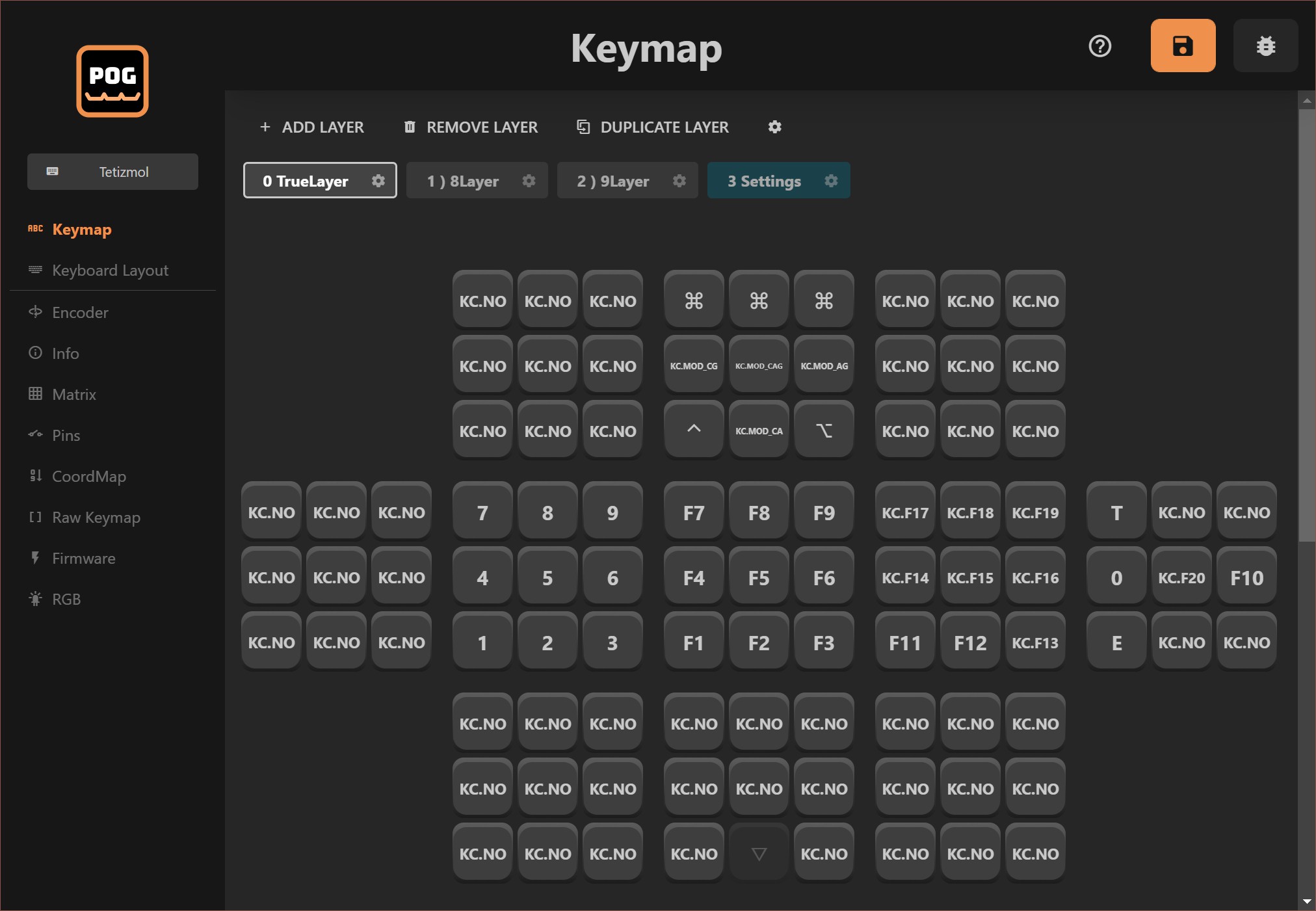

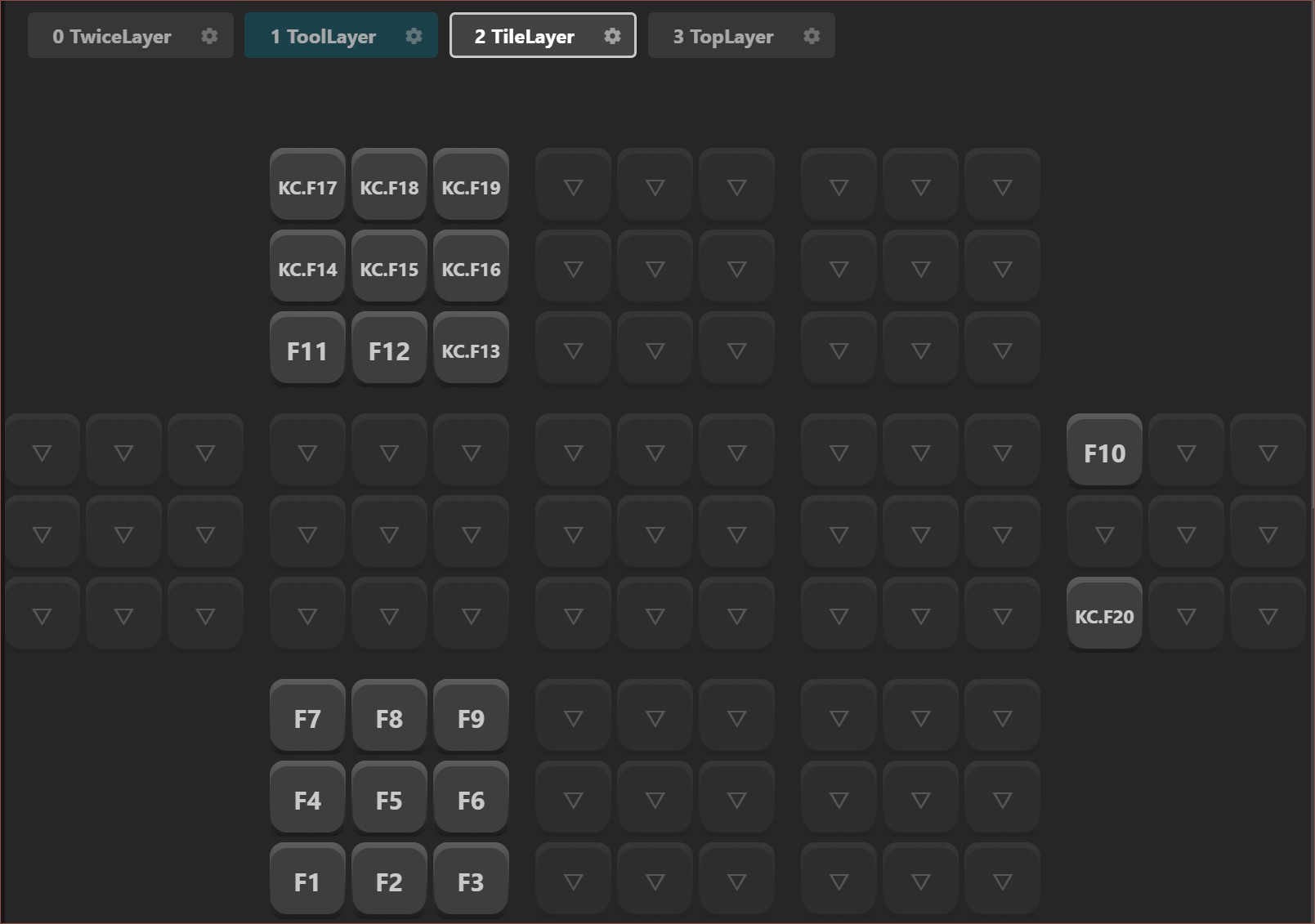

  • [C] Pog Configurator for a chording keyboard
    kelvinA02/25/2025 at 17:23 0 comments
    Partially finished Tetizmol mapping. There's no F0 key, so I've used F20.
    If you followed along with #WK-50 Trackball Keyboard, you'd know that Tetaip (and Taipo), the keymap is hardcoded into the KMK module:

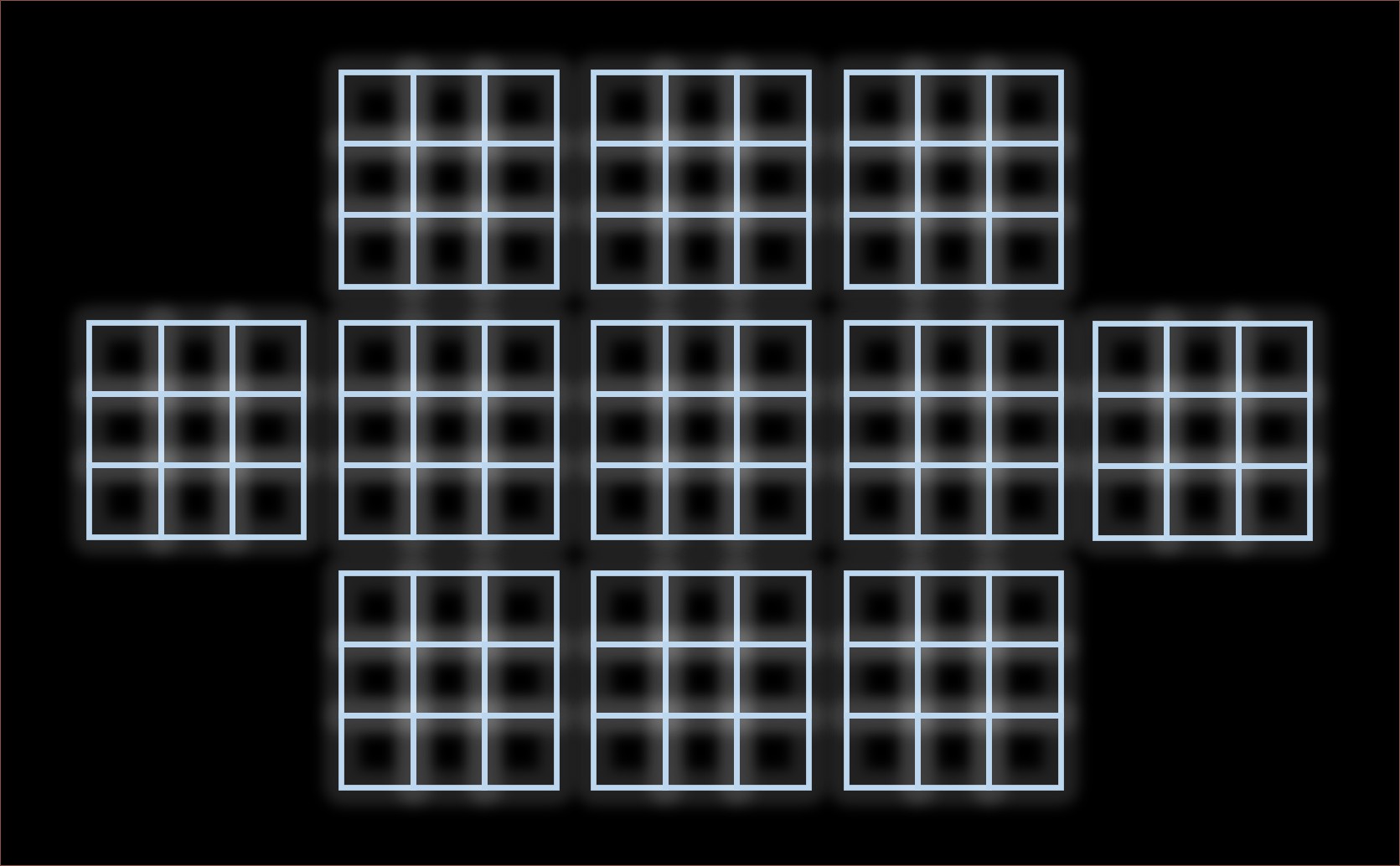

    Layout ideas
    My first idea was a 10 x 10 grid, since each well would have 10 combinations (including pressing nothing) and there are 2 wells per chord. I split it into 4 sections of 5 x 5 and removed Chord 00:
    However, in my mind, each right-hand option in a well was mapped similar to the numbers in the numpad: 1 is the lower left button, 8 is both upper buttons, etcetera. Thus, the chords 00 to 99 map to these directions, making it confusing in the above layout. That's why I thought of grouping them in sets of 3x3:
    For Chord XY, Left: 0Y, Large/Small grid: X/Y, Right: X0
    Lastly, I thought of a recursive layout, where X0 was put on the side of the small grids just like how 0Y was next to the large grid:
    I liked the symmetry of the second option, so I created that in Pog's configurator application.
    Setup and changes
    It didn't take long for me to discover that Pog will only save the keys that exist in (what it thinks is) the matrix. Well, to be precise, it will save any number of keys, but fail to load them back in.
    Since Tetwice is the only real "layer", I hardcoded the keys and removed any other code that set them up:
    class POGKeyboard(KMKKeyboard):
        def __init__(self, features=['basic']):
            super().__init__() # Recently introduced change
            self.keymap   = (...)
            self.row_pins = (...)
            self.col_pins = (...)
            self.diode_orientation = DiodeOrientation.ROW2COL
     Then, in the configurator, I set direct pins and put 99 in the textbox.
    Through serial, I was getting a lot of "INVALID PIN None", so I tweaked the first line of this function with "or pin is None":
    def pinValid(pin):
        if pin == "" or pin is None:
     Then for reading the keymap:
    self.keymap = []
    for l, layer in enumerate(pog.config['keymap']):
        if l < 3:
            layerKeymap = []
            for k, key in enumerate(layer):
                layerKeymap.append(eval(key))
            self.keymap.append(tuple(layerKeymap))
    In the Tetwice module, it handles layer transparency:
    for i in (0, 1):
        if twice[i] > 00:
            key = self.keymap[layer][twice[i] - 1],
            if layer > 0 and key == KC.TRANSPARENT:
                key = self.keymap[0][twice[i] - 1]
     I also removed the POGKeyboard code that appended the layer module.
    Since the imports are just text, and Pog Configurator allows arbitrary "keys" to be saved, I can do things like hexcolour keys in the settings layer:
    self.colourmap = []
        if l == 3:
                if (k in (_num, _caps, _pointer, _orbit) or
                k >= 90):
                    self.colourmap.append(self.hex_to_rgb(key))
    def hex_to_rgb(self, hex_string):
     I'm using this to pass colour values to a ring LED extension that's currently taking me hours to even "understand" the problem. It's because I want decaying fade-out animations and automatic luminosity.
    Additionally, I deleted the key that corresponds with Chord 22, since that is toggling the Manipulator module (the module responsible for mouse and spacemouse controls)....

    Ginfull joysticks
    I've spent about an hour or two jointing up the joystick assembly so that I can drag the stick and everything moves (as an approximation):
    I've uploaded it to GrabCAD.
    I also talked with a user on Printables who informed me that they preferred the stiffness of a traditional spacemouse. I already had worries that the joysticks might not be stiff enough in the orientation I'm planning, so I started researching into increasing joystick tension. First I measured my SpaceExplorer, which was 300gf. Then I started looking inside the joystick.
    Source: MPE's Ginfull TMR video
    Inside the CAD of the joystick
    One of my first thoughts was to replace the spring with stacked O-rings. there's about 3-4mm of vertical height but, due to that middle cylinder in the base, only a 2mm diameter o-ring or smaller would fit. This would suggest either a 2mm and 1.5mm, 2 sets of 2mm or 2 sets of 1.5mm rings stacked on each other.
    However, I had suspicions that the ESP32-S2 ADC's would be able to detect the much smaller range of motion, so I looked into springs. The spring constant depends on a few factors, and since the original spring is 0.5mm wire diameter and 8.6mm outer diameter, I was able to calculate the expected stiffness increase of an 8mm OD spring with wire diameter of:
    • 0.7mm = approx 3X stiffness increase
    • 0.8mm = approx 5X stiffness increase
    I then found this video showing that the Ginfull Hall Effect joysticks have 60gf of force, which is lower than the standard of 80gf.
    This would mean that 0.7mm = 180gf and 0.8mm = 300gf. After much hopping back and forth, I've decided that using 0.7mm springs are more likely to work, or perhaps I should say that both share the same list of "reasons it might fail" but 0.8mm has additional reasons. One of them is that a 5X increase might be too much for the components in the joystick to handle.
    I'm not entirely sure if 9mm OD springs will fit, but I get twice as many 8mm OD for the same price.

    Super clamps and magic arms
    Ignoring that the names of these products sound like Superman V Dr Strange, the mounting solution is...
