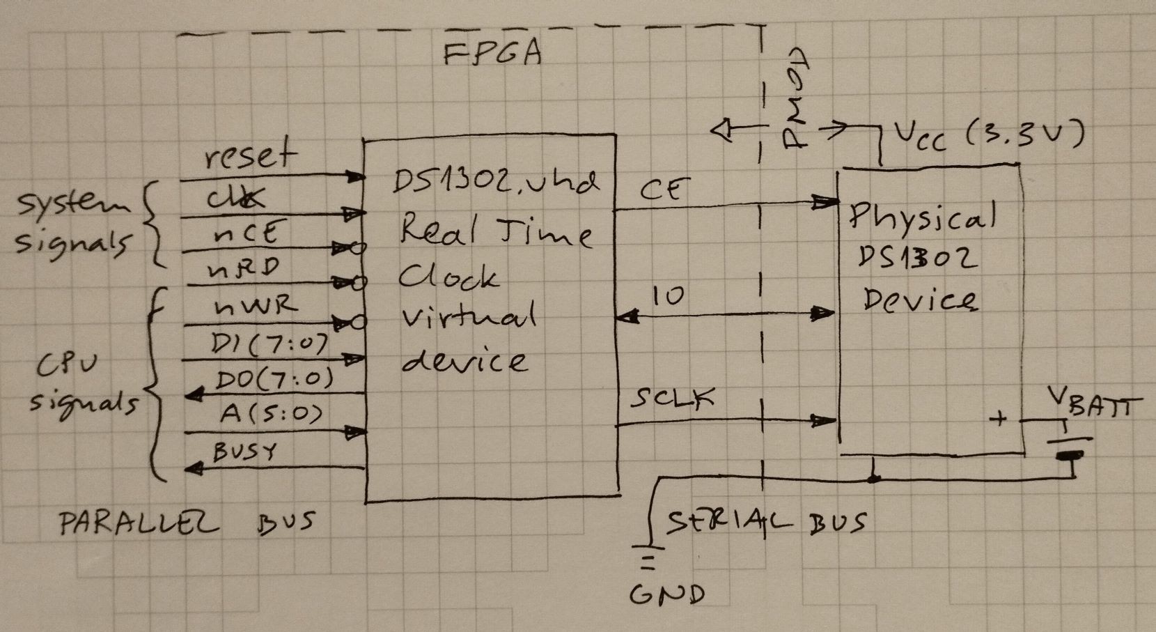

    Real Time Clocks are probably one of the most useful devices any computer can have. Many FPGA boards are equipped with PMOD connectors, so it was convenient to use the module with already integrated backup battery and 32kHz crystal.
    RTC module uses a very popular DS1302 chip, which contains in addition to clock also 32 bytes of non-volatile (battery backed up) RAM, handy for any value that should survive machine reset or loss of power.
    CPU interfacing - parallel vs. serial

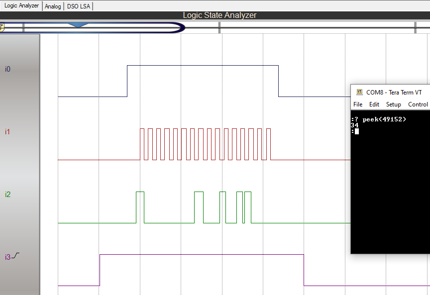

    Basic CPU is designed to use memory-mapped peripherals, which must appear as byte locations in the 64k CPU address space. The DS1302 IC is however serial. This means a component must exist that does the parallel to serial (write to RTC) and serial to parallel (read from RTC) conversions.
    I wrote the DS1302.vhd, which works a bit differently than similar components I saw online. The CPU can access the RTC by reading/writing locations 0xC000 to 0xC03F (49152 to 49152+63 decimal)

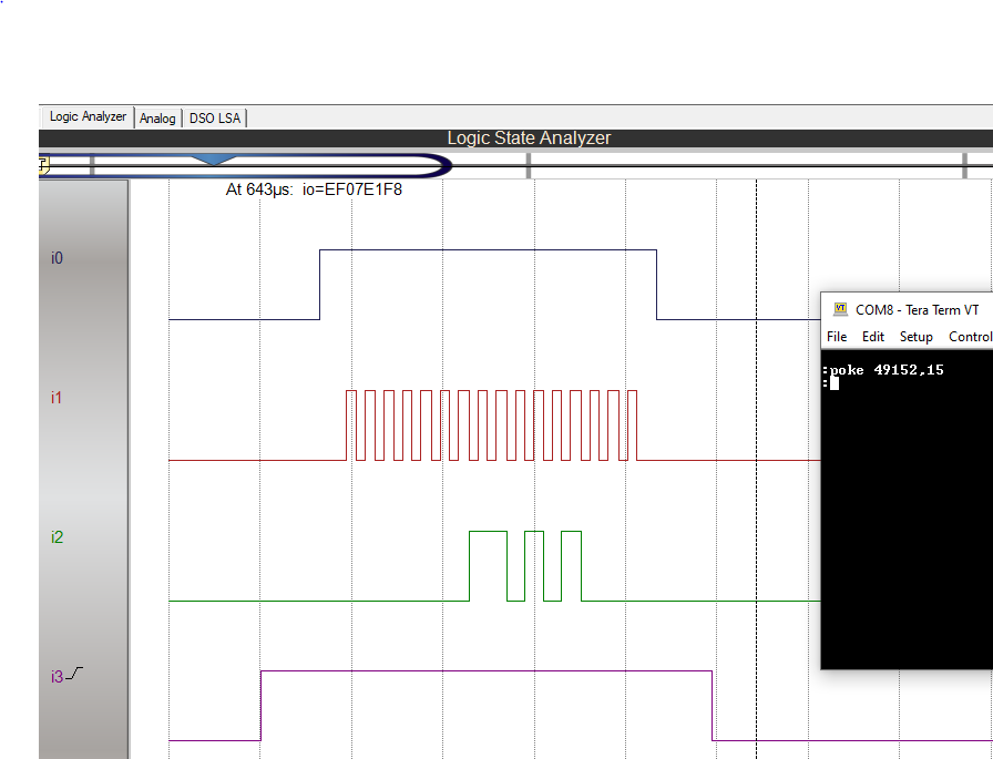

    Writing to RTC RAM:
    1. BUSY output is asserted (i3 in screenshot below). This holds the CPU bus signals in frozen state. This is needed because CPU clock can be orders of magnitude faster than DS1302 clock (set to about 50kHz)
    2. 24-bit word is assembled which contains data, address, R/nW signals, as well as enable for DS1302, data directions etc. Data part is middle 16 bits, and 4 bits on each side
    3. Control words are shifted on each falling edge of clk input
    4. SCLK (signal i1 below) is logical AND between input clk and internal enable
    5. control word are first 8 bits shifted out (signal i2 below) followed by data, LSB first. That's why 170 = 0xAA = 01010101
    6. after 24 bits are shifted, BUSY signal is set to low, CPU can finish the memory write cycle and continue execution of the program
    Writing RTC RAM
    Reading from RTC RAM:
    1. all the steps as in write operation described above, except:
    2. there is internal "reg_dir" 24 bit control word. First 12 bits are low (IO pin on DS1302 is input) then high - which puts IO pin into tri-state ("Z" in VHDL) so data from DS1302 can be read
    3. DS1302 also outputs data byte LSB first, so 170 = 0xAA = 01010101
